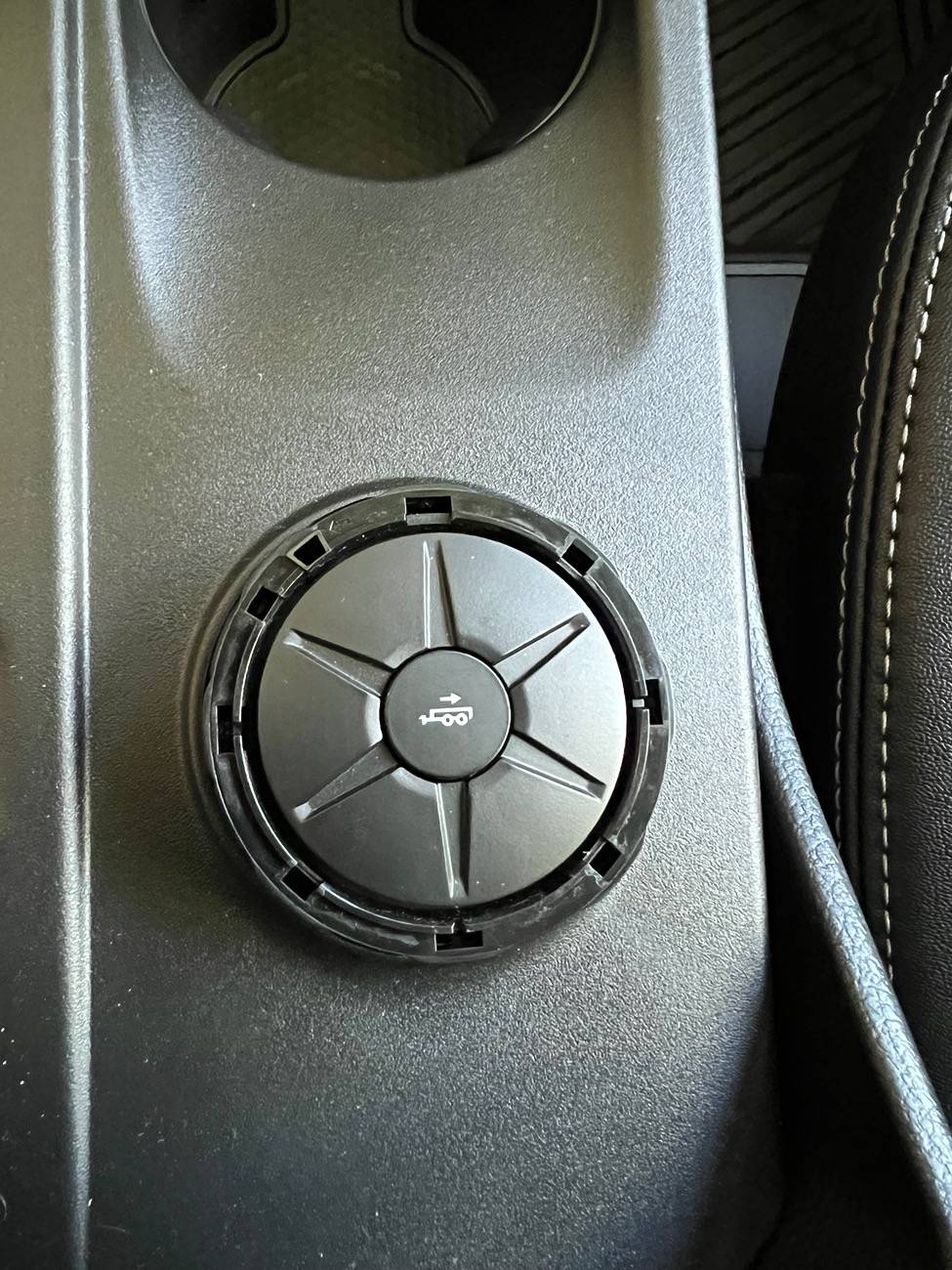

Last week I noticed the drive mode knob in my Lariat was looking especially cheap and ugly. Found some pics online and it appears the factory failed to install the bezel (see pic). My dealer jumped right on the problem and I’m dropping the truck off tomorrow to get the controller replaced. Meanwhile, my AC started blowing warm air last Friday. Temps are in the 90’s right now in Mississippi and the cabin never cools down during my 24 minute commute to/from work. Dealer is checking that out too. Anyone else having these problems???

Local dealer replaced the drive mode controller today and charged the AC system. No sign of leaks. Both issues probably from no process controls in production. Hope the AC thing is not going to be a recurring problem like @jrRaptor has.
