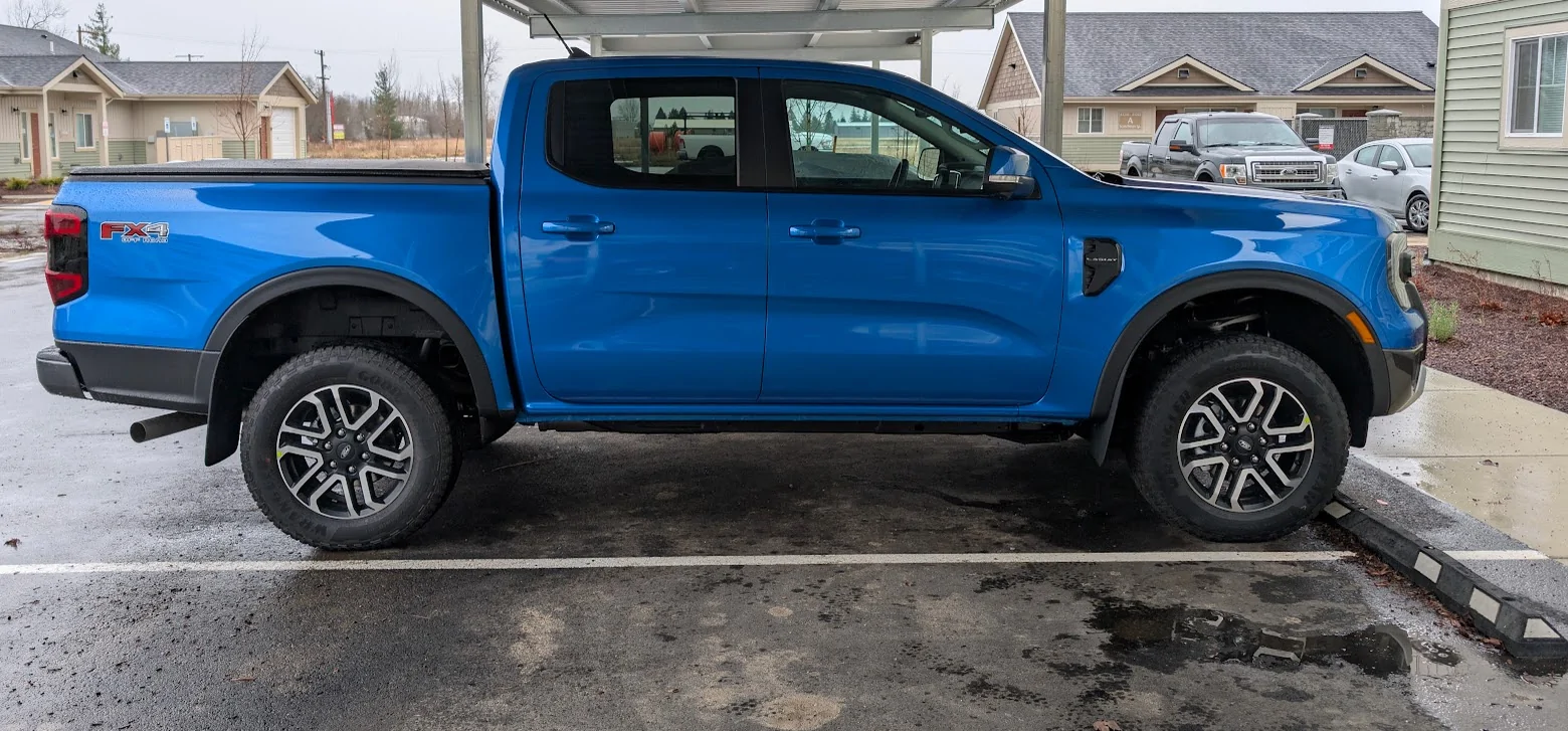

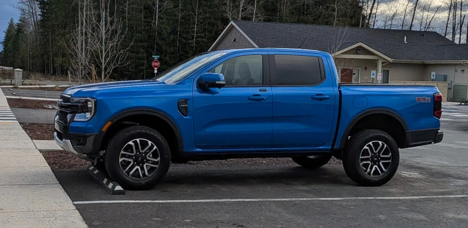

Photo: One Inch (Half Inch Spacer) Front Lift/Level
daytoncarter
Dayton
Sep 26, 2025
433
627
I don't see many examples of one-inch lifts on the Ranger. Not really a lift guy, so I wanted an in-between that preserved some rake while making the truck look better. Dealer wanted ~$700 + $100 alignment (gonna let them do that) to install, so I just did it, took about 4.5 hrs which was the dealer's stated hours on their quote. Figure they were overcharging some since I did it on the ground with basic tools versus what they would have.
BEFORE:
Ford Ranger Photo: One Inch (Half Inch Spacer) Front Lift/Level 1766686374760-gm
AFTER:
Ford Ranger Photo: One Inch (Half Inch Spacer) Front Lift/Level 1766685899307-x4
MY 25 Lariat FX4 2.3L
I used the technique where I disconnected the tie rod, sway bar link, and upper control arm from the knuckle to remove the strut assembly. I didn't need to disconnect the CV axles. Used bungees and extra care to remove strut to avoid accidentally dislodging the CVs.

I had a 1.5 inch leveling kit installed a couple of weeks ago and it cost me about $800 with alignment after. Looks great and worth it in my opinion. I would rather have a pro do it than try it myself but that's me. the alignment was an important factor in my having it done for me.
I definitely understand wanting a shop to do the work.
Overall, it was not a complicated job, just six total nuts to remove and reinstall on each side. I have had mixed results with shop work since the mechanics are all incentivized to do things as fast as possible due to a flat rate of pay.
I've got an alignment scheduled in a couple of days, so no worries there.
Thanks to @GiJoesGT for the $80 spacers. Total cost will be $180 with the alignment.
