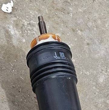

Is that orange/brownish rubber piece on the strut the only bump stop on the FX4 Ranger? I know the RR has a separate one that attaches to the frame. I guess I need to take another look around the suspension. If that's the only bump stop I think it will mean it should still work with a spacer kit. It doesn't look very heavy duty though, it might be a failure point for off-roading.

I did some more looking around and I don't see another bump stop on the front.

The raptor has lots of different suspension components than the fx4, kind of comparing apples to oranges. You can still do tons of off roading without a separate bump stop. Just my $0.02 but If you’re going so hard to be worried about the bump stops failing you’re gunna be replacing a lot on the fx4.
