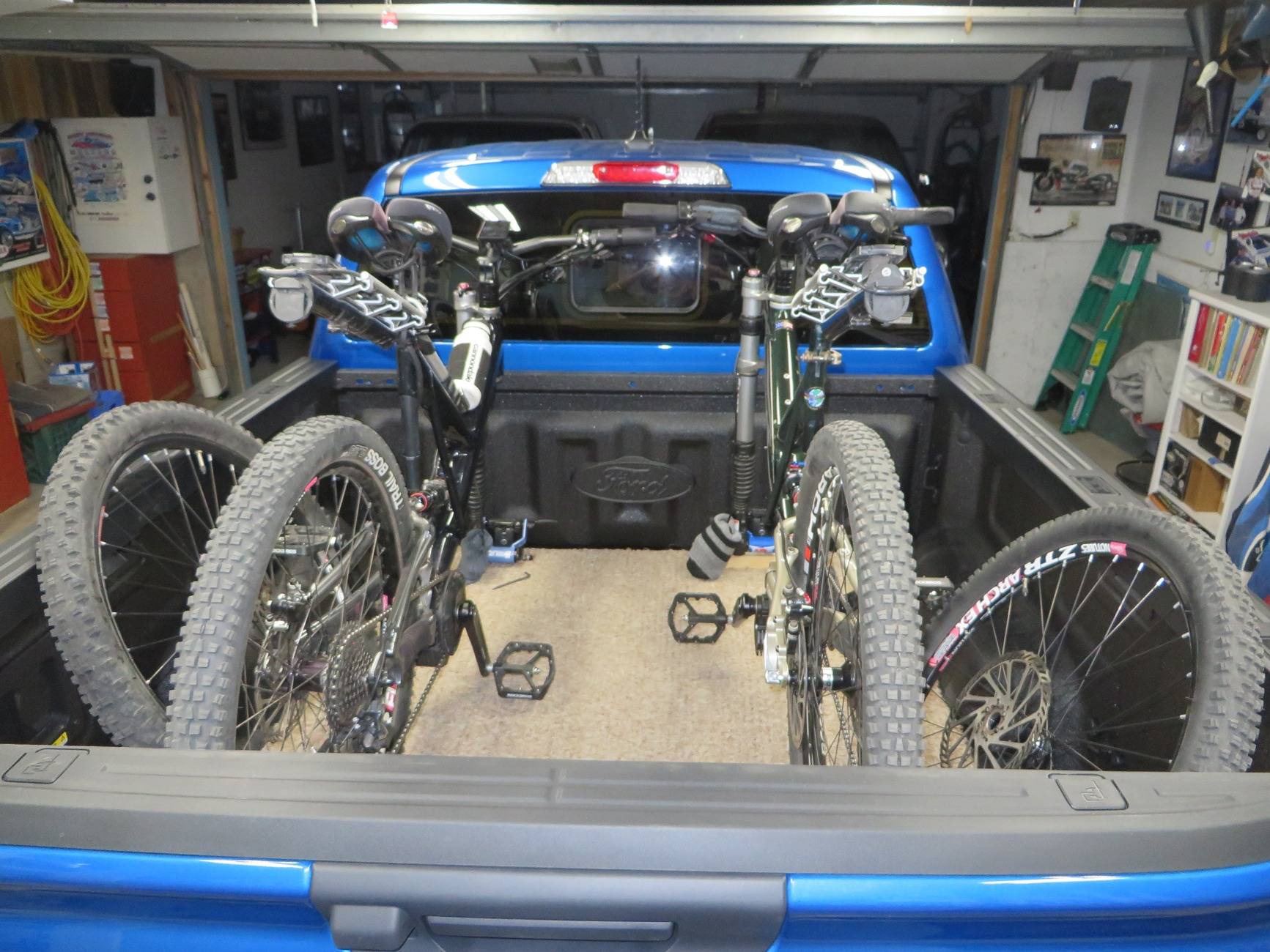

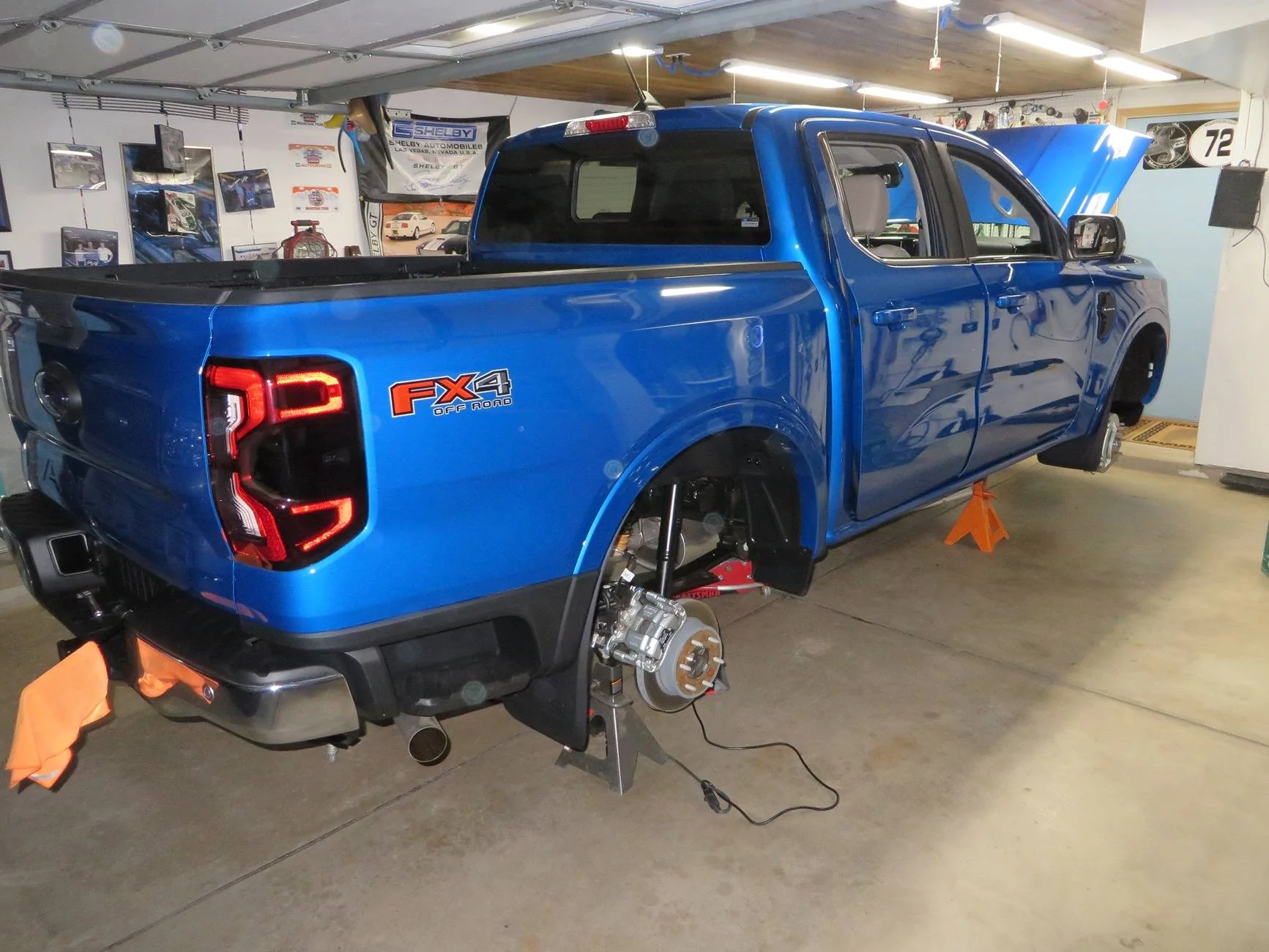

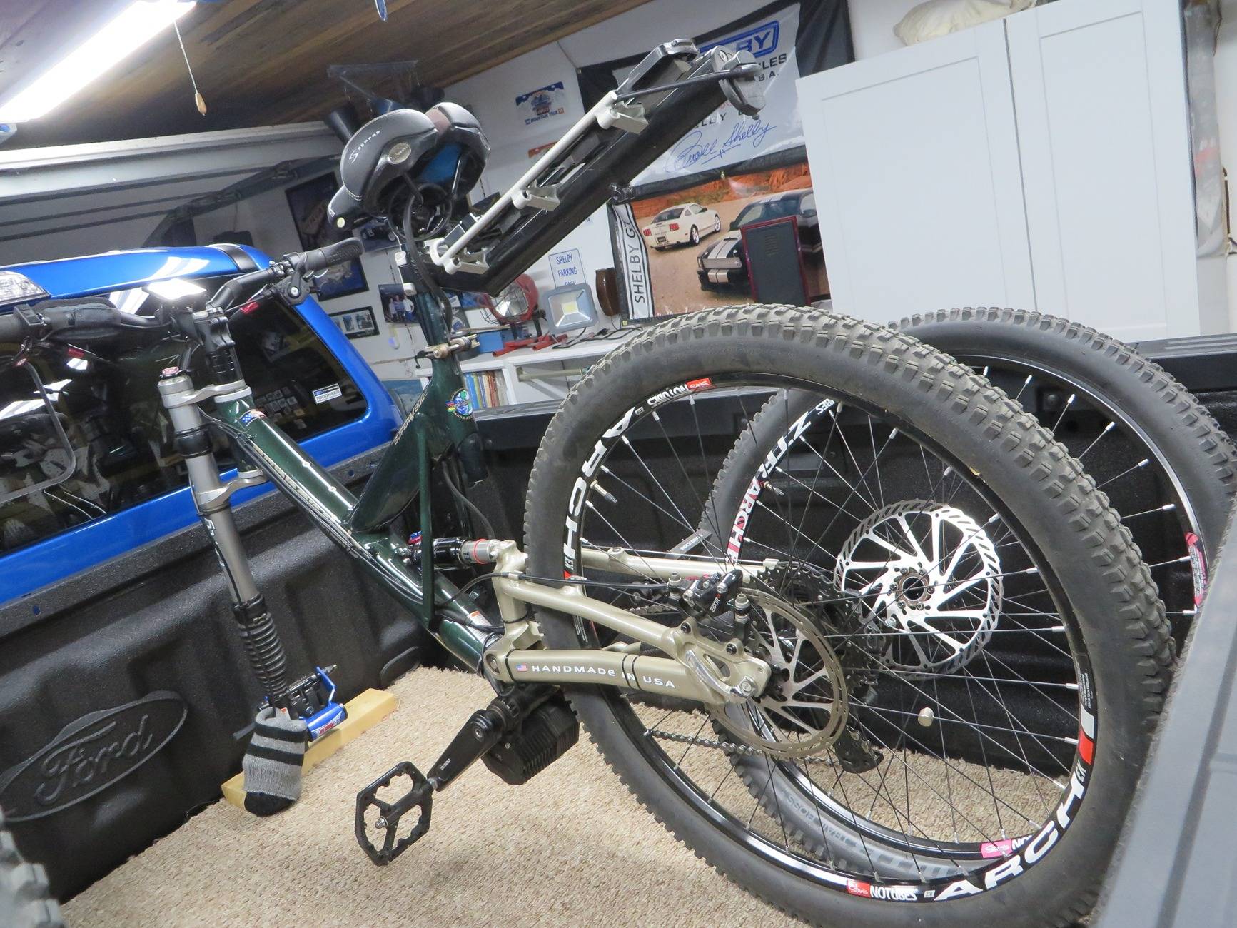

I LOVE modifying new rides and just got my 2025 2.7L V6 Lariat. First, got the all the necessary paint protection film installed in all the right places. My next order of business was to ceramic coat everything possible. Living in the Rocky Mountains at 9,000 and only going up from here, I need all the protection I could get. Inside the wheels and wheel wells is a MUST in my humble opinion.
It was on to installing 2024 chrome running boars as 2025 only comes factory-built in black.....and I do so love chrome. My Leer 180 topper is a must and is on order so I can transport the e-bikes I build for the misses and me. To prepare for the topper, I installed a tailgate seal kit....living on a dirt road does have its challenges.
Last but not lease will be a dual exhaust as soon as it is released. It was due in March, but still under development for the 2.7L. I'll post it when I get it and installed. Oh yea......rumor has it that Ford Performance will have a special tune late this year, or early 2026. Being a Shelby kinda guy, I need extra horsepower just to get to the grocery store....but doesn't everybody.

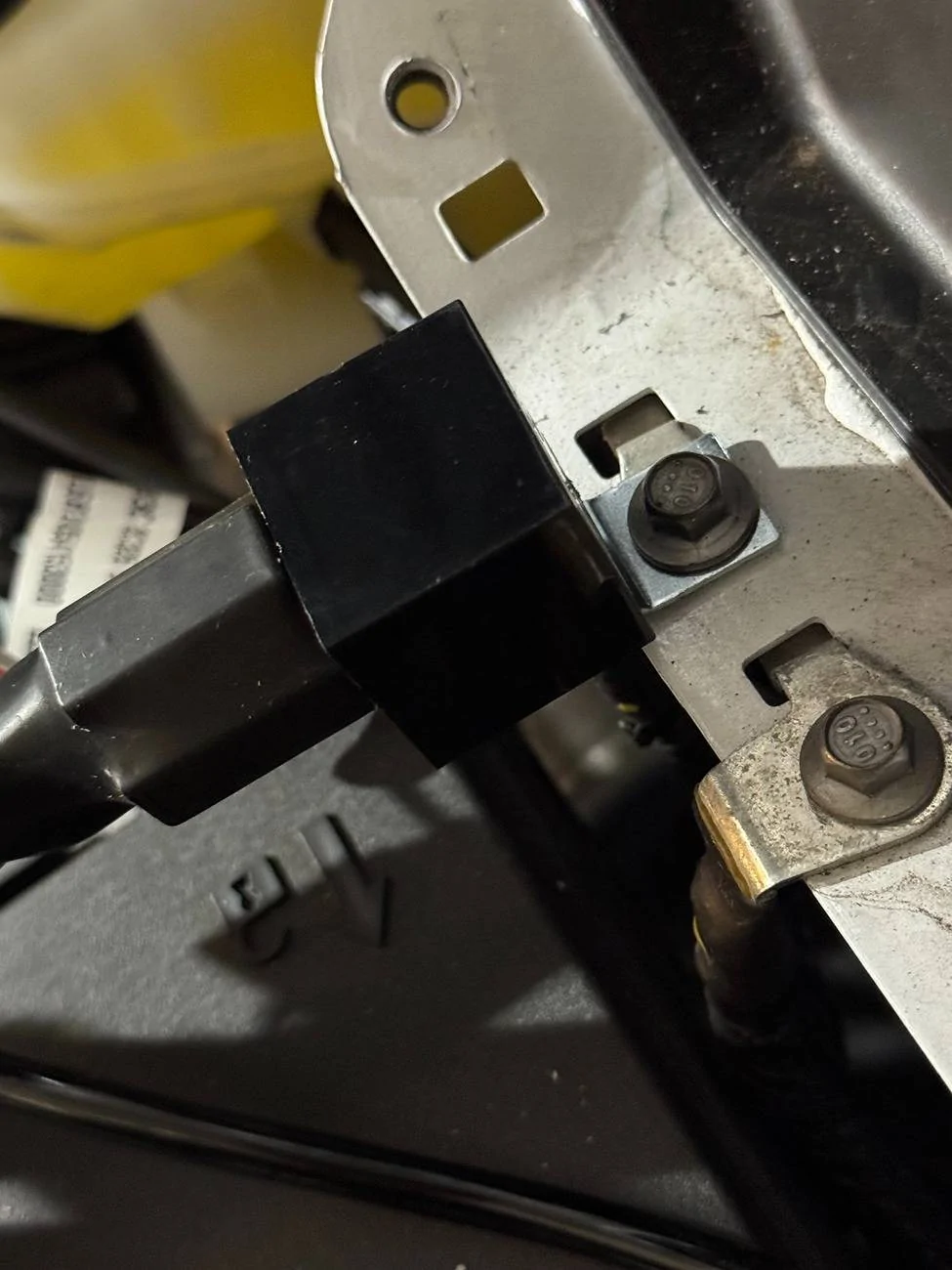

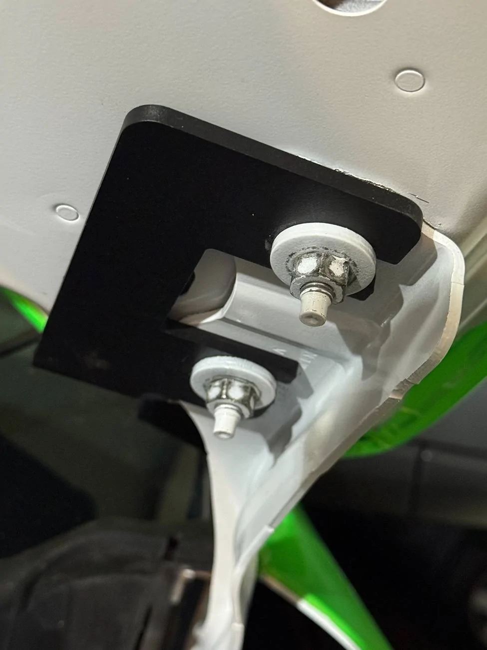

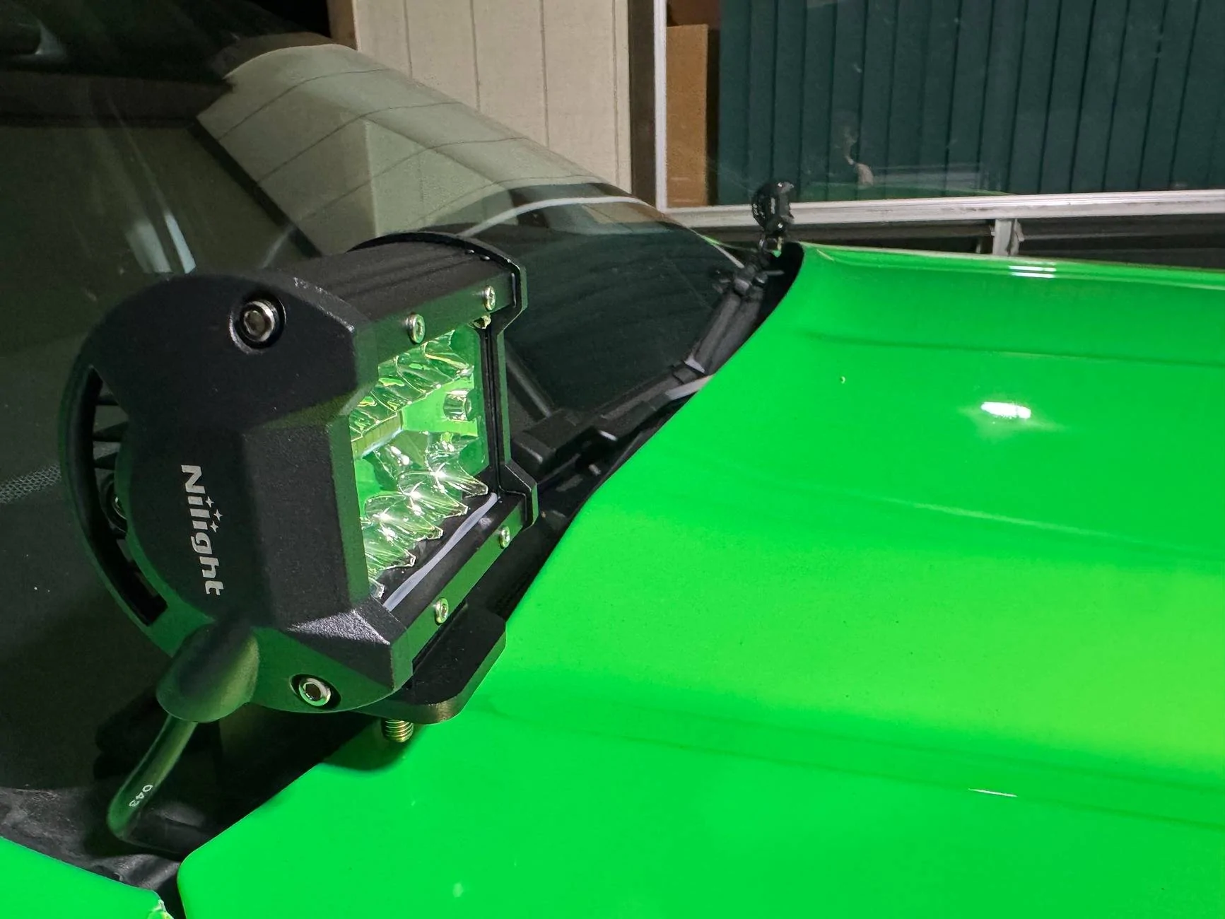

I installed some off-road lights not too difficult. I do recommend clamping the hood down on the lever where the brackets go so your hood doesn't move while installing hood brackets, ESPECIALLY IF YOU HAVE OCD i was there for an hour trying to line up the hood it like it was lol
Bracket:

I hooked the relay to an existing bolt near the firewall, Just to hold it.

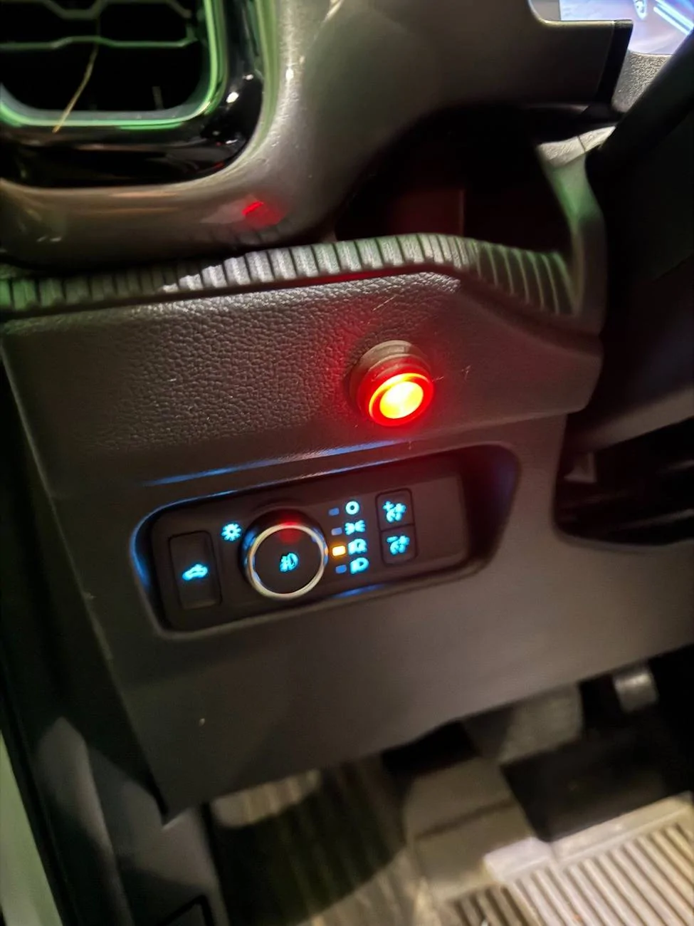

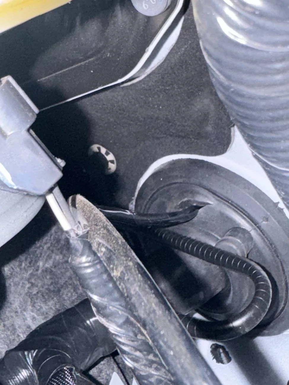

I cut a slit in the grommet into the cabin and ran the switch inside. I put something to protect from water after everything was done.
Grommet:
Ford Ranger Ranger FX4 2.7 Build thread : Nāhele Ranger 4

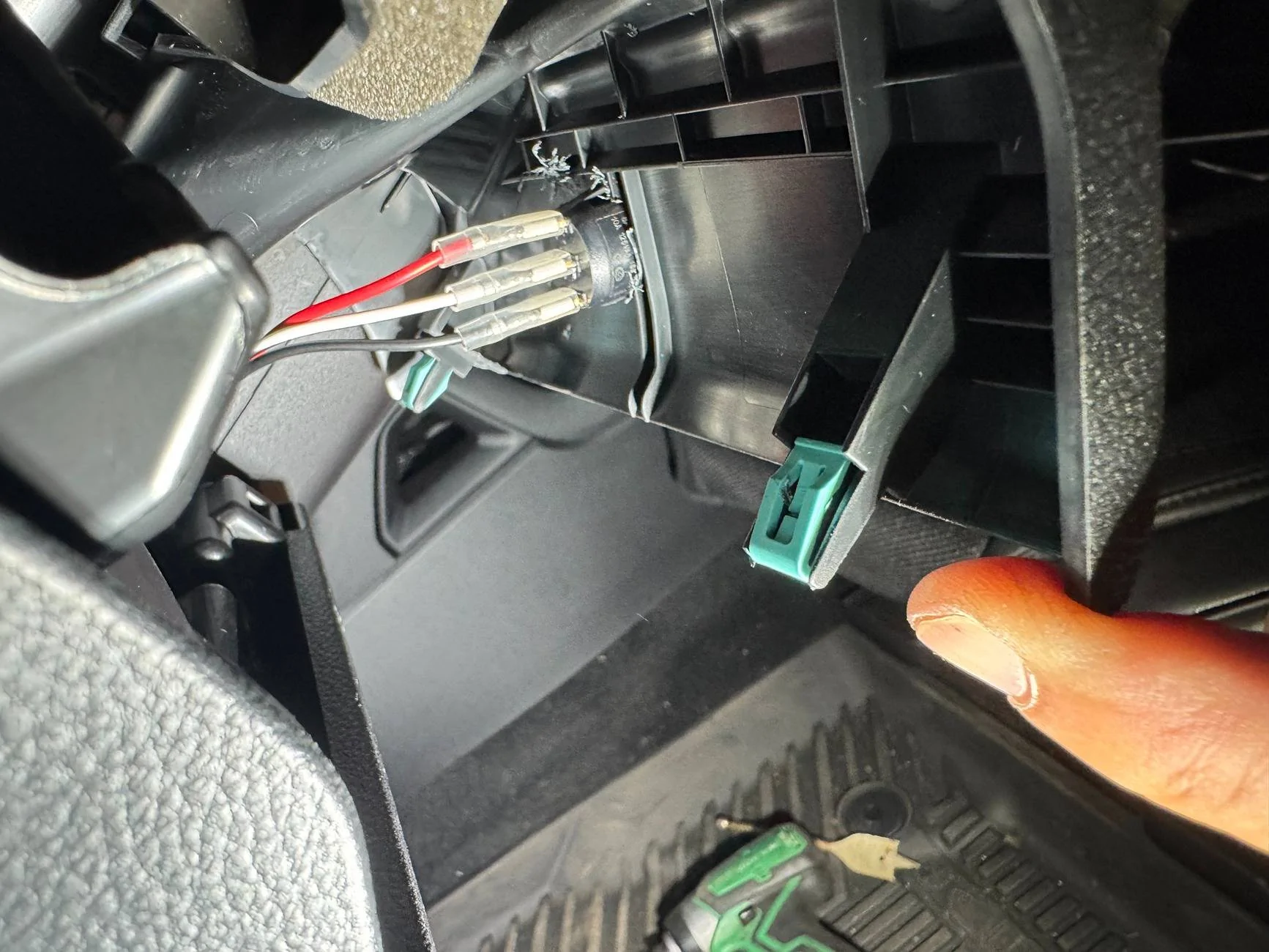

Here I have it installed. great location the panel pops up with just some clips holding it theres space behind just enough to fit the switch and the connectors that extend behind. Drilled a 3/4 hole and it slipped through and fit perfectly
Location and switch
Ford Ranger Ranger FX4 2.7 Build thread : Nāhele Ranger 6
Ford Ranger Ranger FX4 2.7 Build thread : Nāhele Ranger 7
here it is finished its great

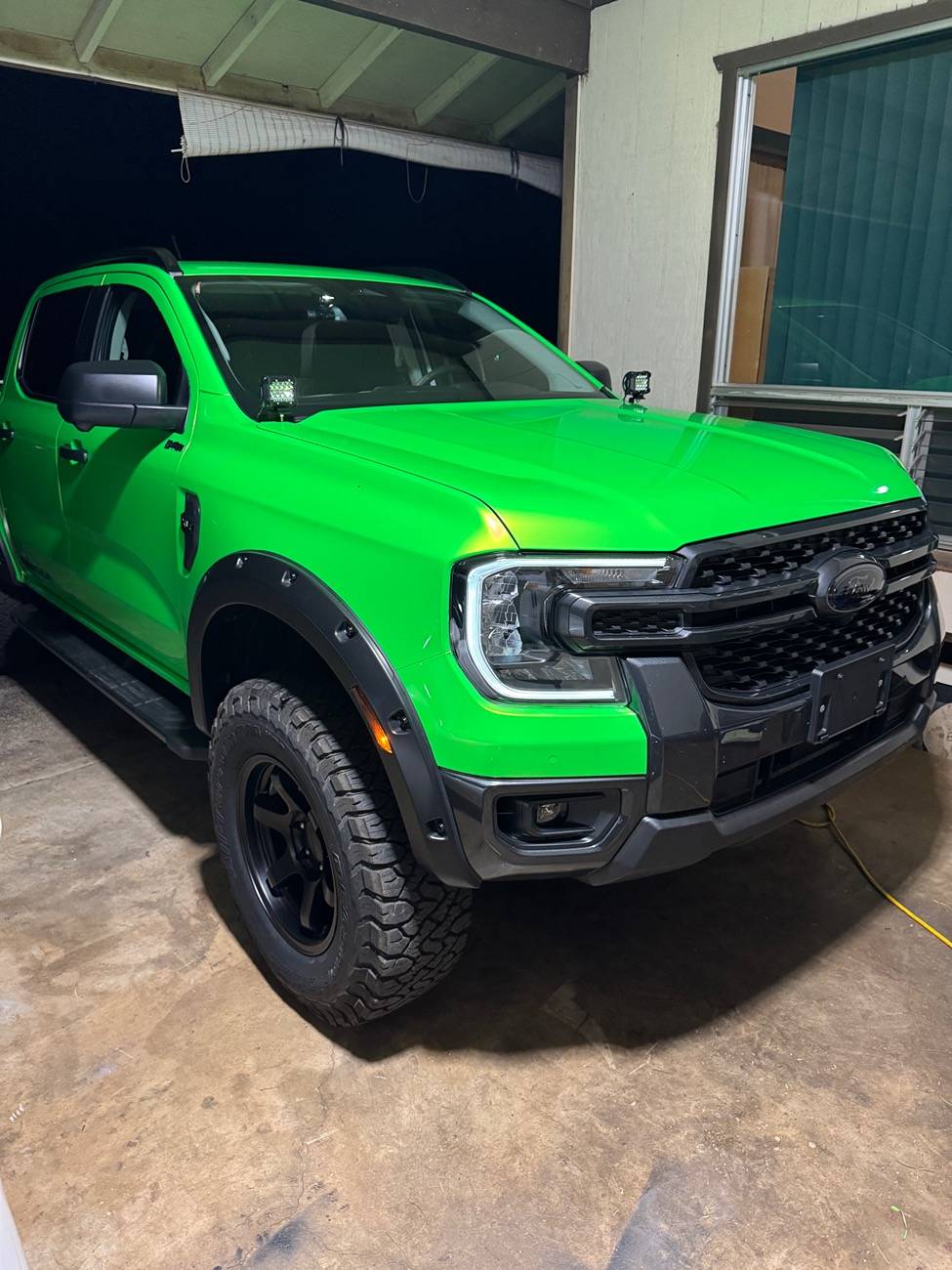

Howzit everyone! Named Nāhele Ranger
I’ve been lurking for a while, so I figured I might as well post up my progress and help anyone who has questions about mods or anything related.
Starting base:
2025 Ford Ranger XLT FX4
  • 2.7L
  • Tow/Tech Package
Coming from a 2019 Ranger, I actually did prefer the old design at first, but I wanted the 2.7. Over time, I’ve come to actually prefer the somewhat wider front face of the new one.

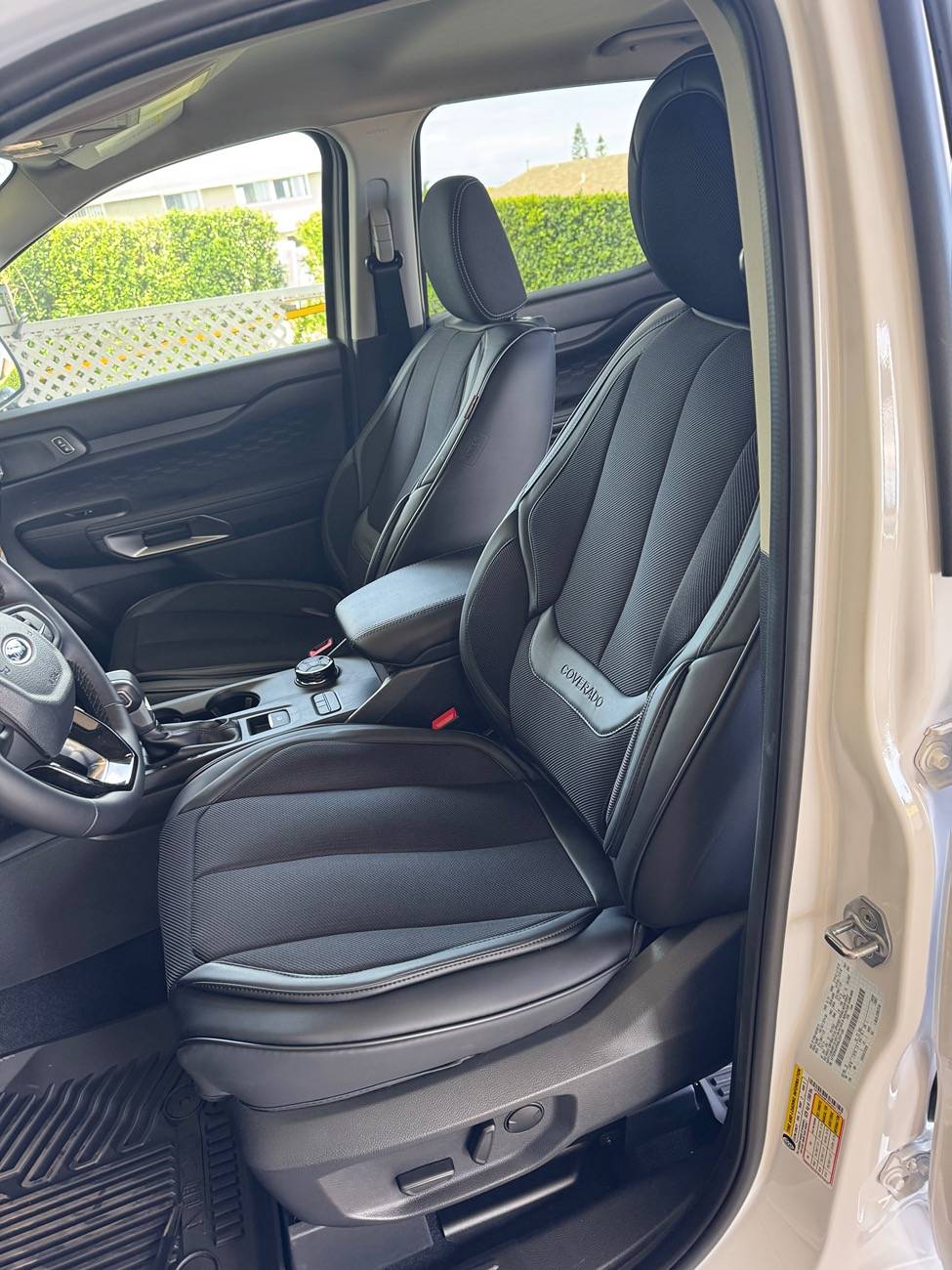

First mod: Front seat covers
I generally prefer cloth over leather since it’s more comfortable, but I wanted a little extra bolstering. I went with some Amazon ones called Coverado Front Seat Covers.
They’re okay — the lumbar support is wild. With the upgraded XLT that already has power lumbar support, it was too much, so I currently have the truck’s lumbar dialed all the way down, and it’s tolerable.
Unfortunately, I broke a clip during install, so the lower cushion slips, which is super annoying. I might toss these and get something different.
Second mod: Roof racks
I bought some racks off eBay. They didn’t fit properly (which, as I’ve come to learn, is a recurring issue with mods on this truck). I was able to trim them and eventually got decent fitment, but they’re just temporary — eventually, I’ll upgrade to full platform roof racks.
the wheels and tire setup is 295/70/18. 18x9 0 offset. also bought rough country fender flares.
Wrap and lift:
The wrap and lift pretty much happened around the same time. The lift is a Rough Country 3.5" kit. I plan to upgrade to a better setup eventually, but so far it’s been great.
Fitment challenges:
Making the rims and tires fit was a bit of a pain. I feel like I was a bit conservative with my size choices, but maybe not after reading other builds.
I trimmed the crash bars and the wheel well fabric and was able to tuck and cut enough to make everything fit — pretty much the same process I used when fitting 33s on my old Ranger.

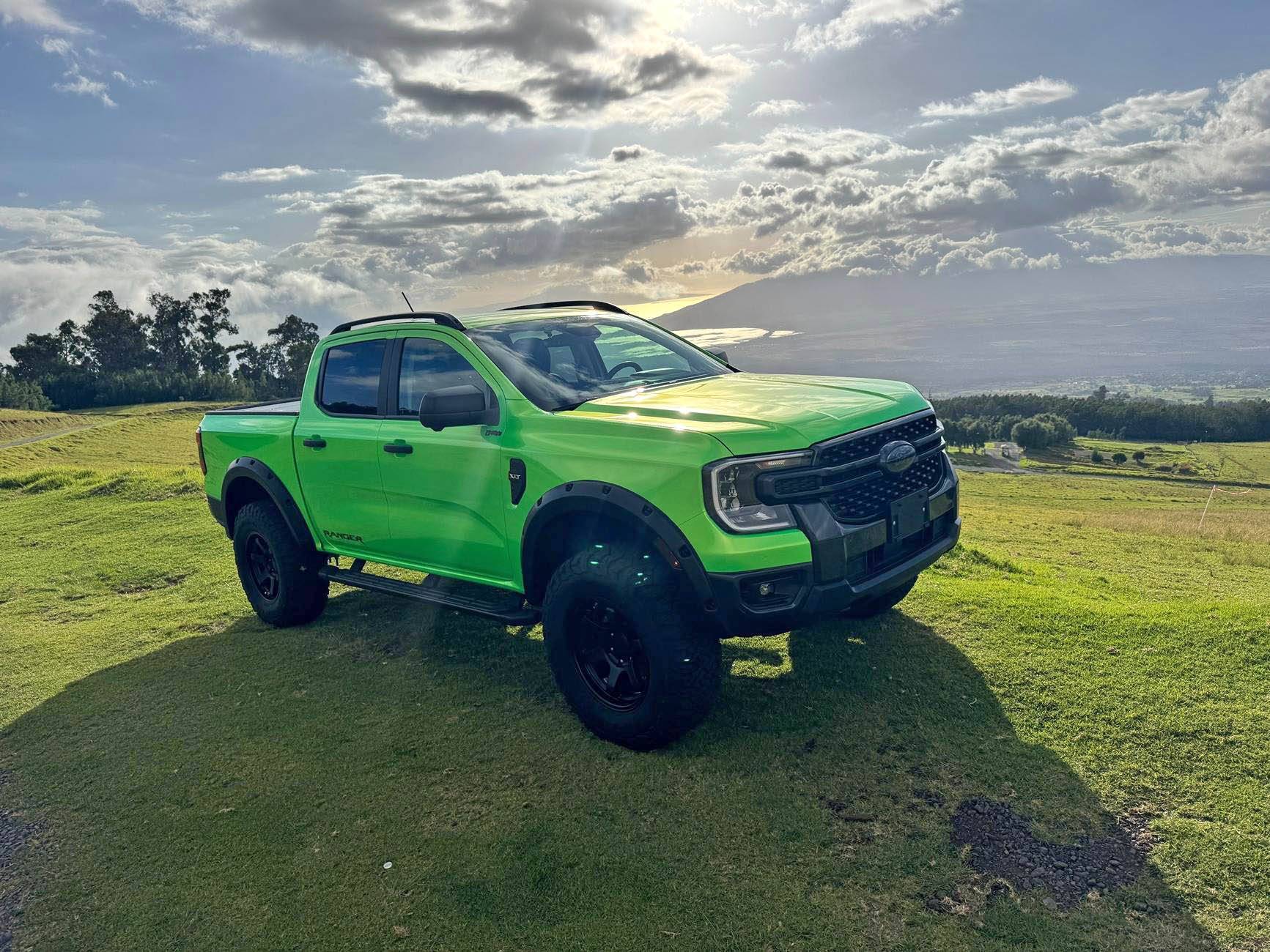

Heres how it sits currently. Loving it.
Lots more to do, Just waiting on a front bumper to add a Winch but it's looking like that'll take a while. I'm in talks with hamer4x4 to maybe buy one and see if i can jerry rig it and make it work but we'll see..... I also want to color match my fender flares but I didn't have enough wrap. I actually managed to wrap the whole thing with 5x59 feet of wrap and that's with not messing up at all.
That's it so far. if you have any question wrapping or fitment let me know. Plan to have this for a long time. Super excited to be a part of the community!
Hi, super curious to see how the fitment is for the fender flares from RC as well as how the black matches up to the plastic on the bumpers (rear) etc. please let me know how you’d rate these as I’m in the market!
Justdown808
Justdown808
Just
Dec 12, 2019
58
Hawaii
Ford ranger 2019
fitment is good. The issue is I have -10 offset and 34s so I had to trim a decent amount and make a new hole for the push clip. I will try to get a picture of the difference between the fender later.
if you have a setup not as aggressive me, you shouldn’t have any issues. Putting on the rubber trim is a lil tedious tho.
