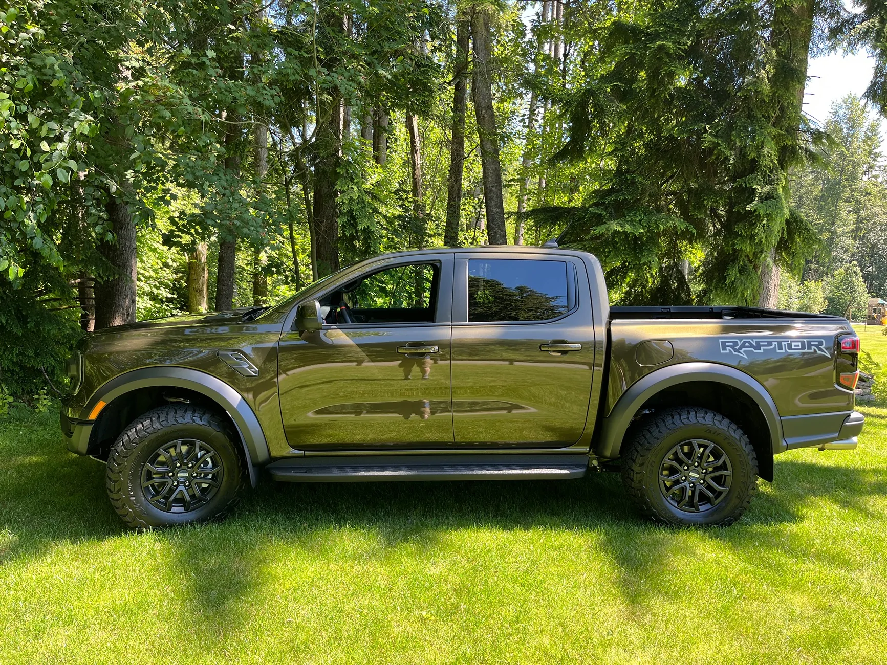

Chilling in the side yard while clearing out it's place in the garage:
Ford Ranger Steve_K's 2026 Shelter Green Ranger Raptor Not A Build Thread IMG_0235

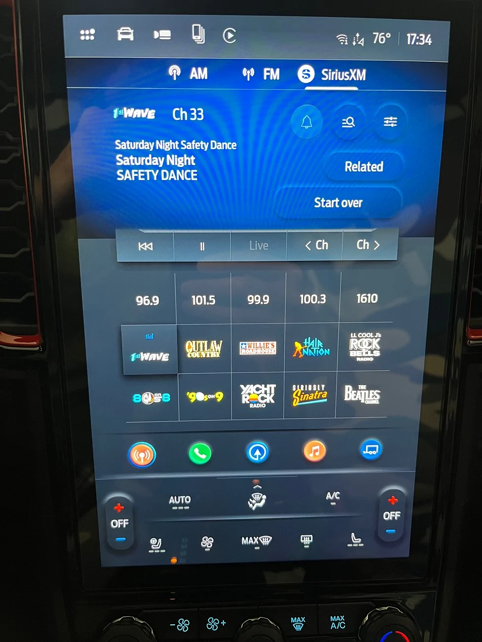

Screen protector installed:
https://www.amazon.com/dp/B0DLKWND27?ref_=ppx_hzsearch_conn_dt_b_fed_asin_title_1&th=1
Ford Ranger Steve_K's 2026 Shelter Green Ranger Raptor Not A Build Thread IMG_0259

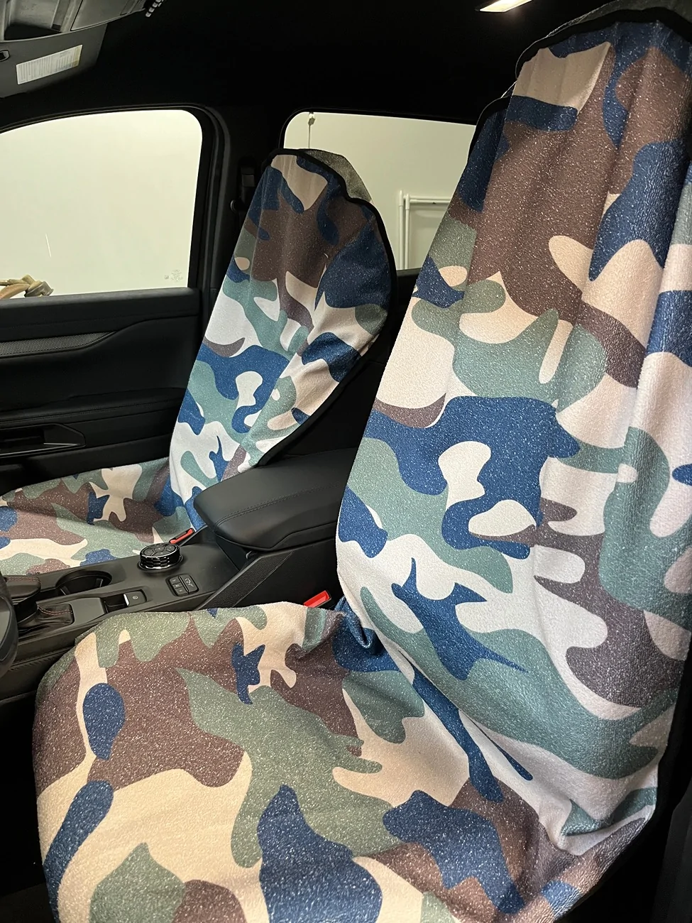

Front seat covers:
https://www.amazon.com/dp/B0CQJH1ZGS?ref_=ppx_hzsearch_conn_dt_b_fed_asin_title_1&th=1
Ford Ranger Steve_K's 2026 Shelter Green Ranger Raptor Not A Build Thread IMG_0278

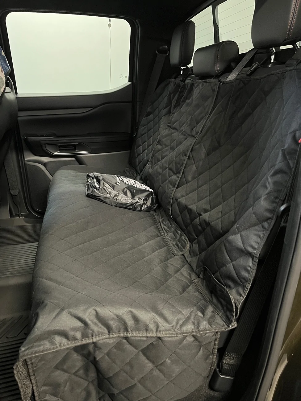

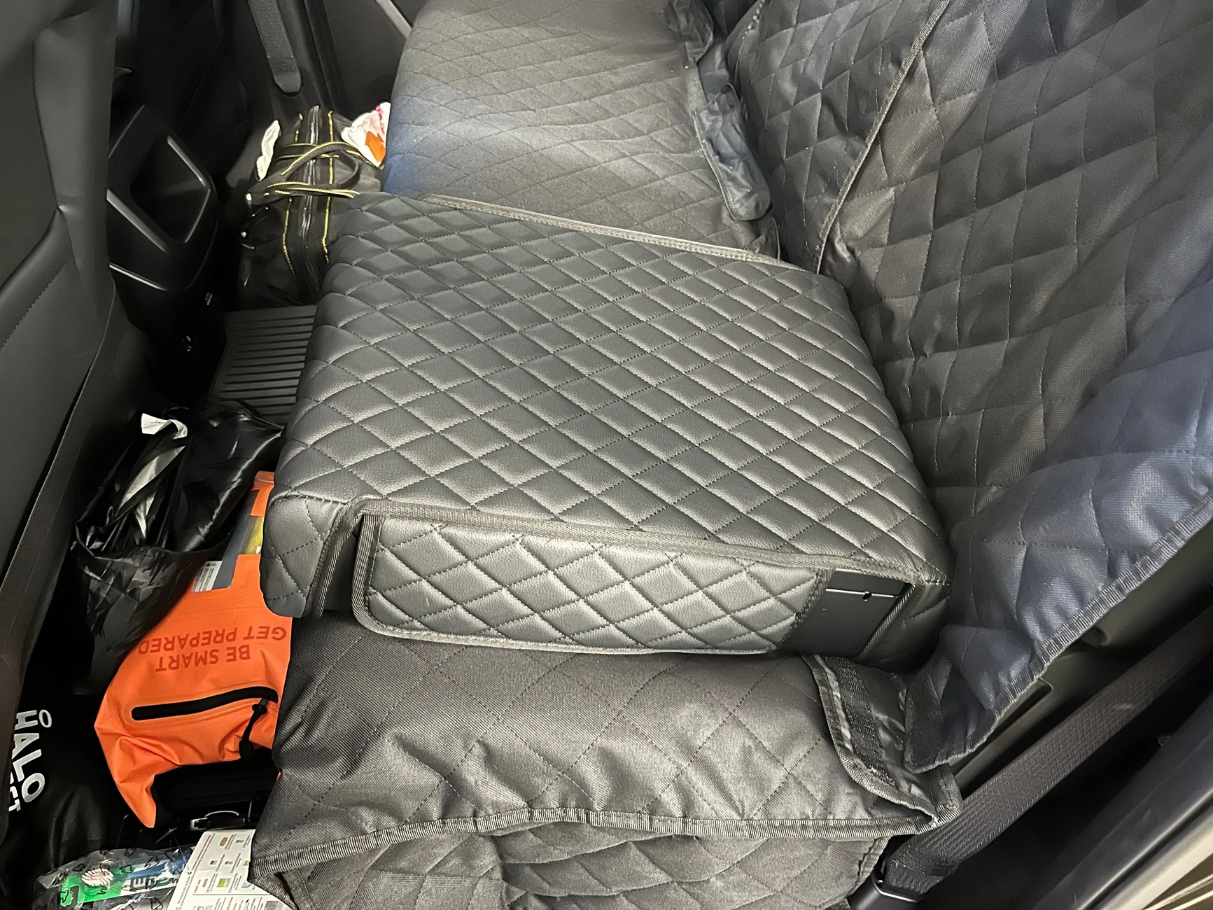

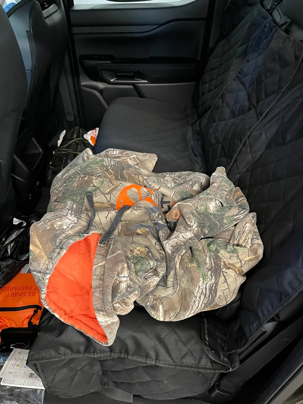

Back seat cover:
https://www.amazon.com/dp/B08SHWBMCL?ref_=ppx_hzsearch_conn_dt_b_fed_asin_title_2&th=1

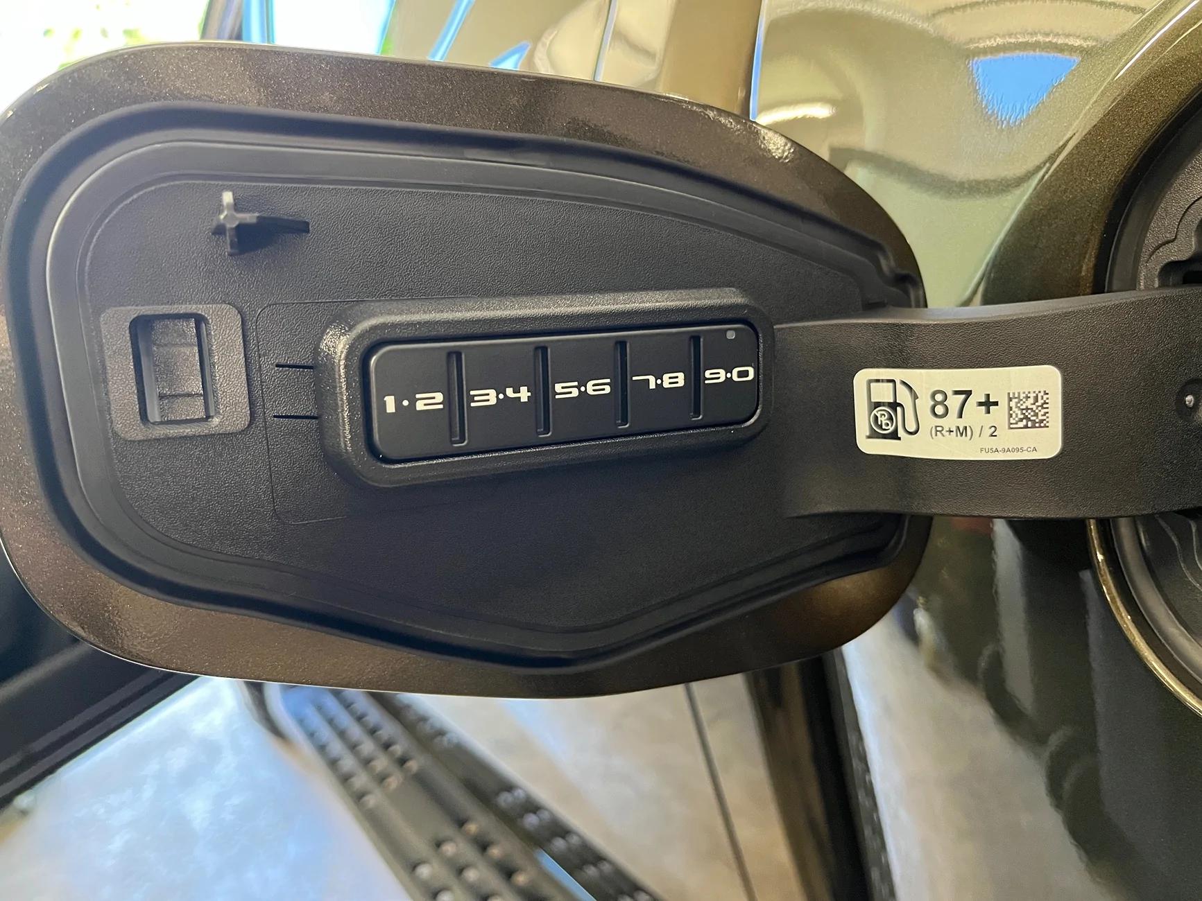

Keypad install:

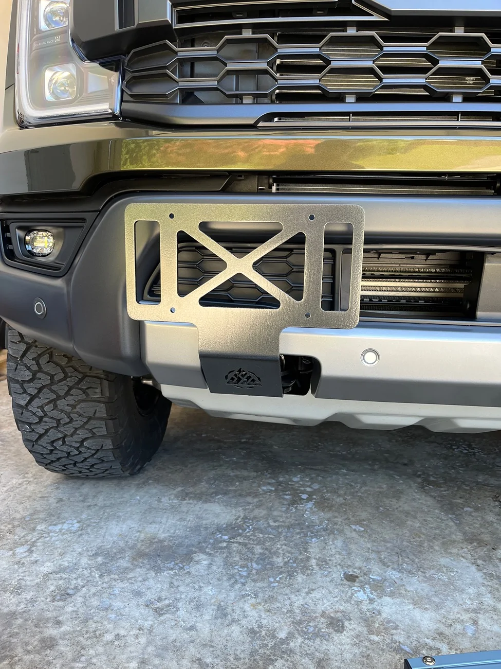

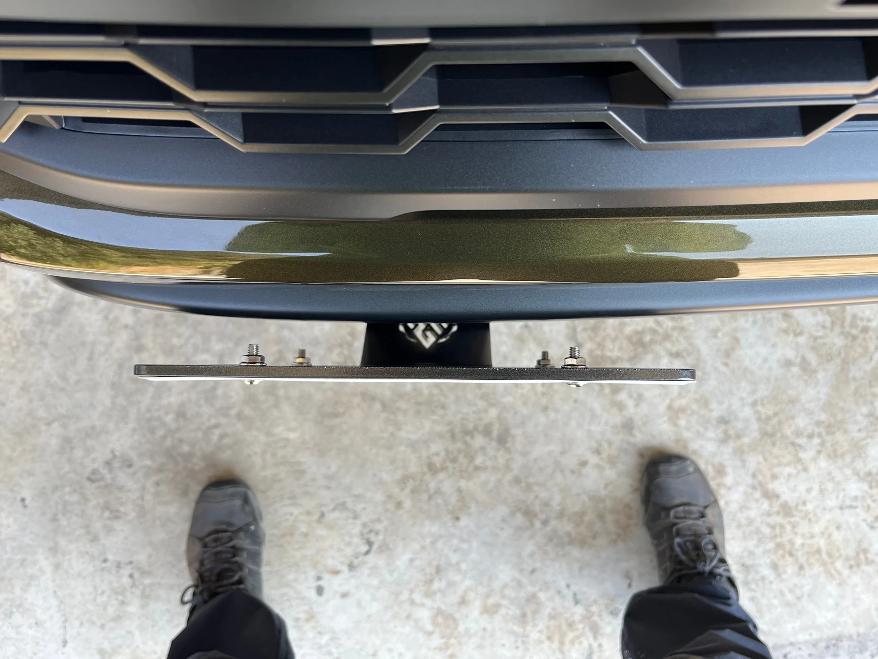

Front license plate mounting:
https://swarfworks.com/2010-2023-ford-raptor-front-license-plate-relocation/

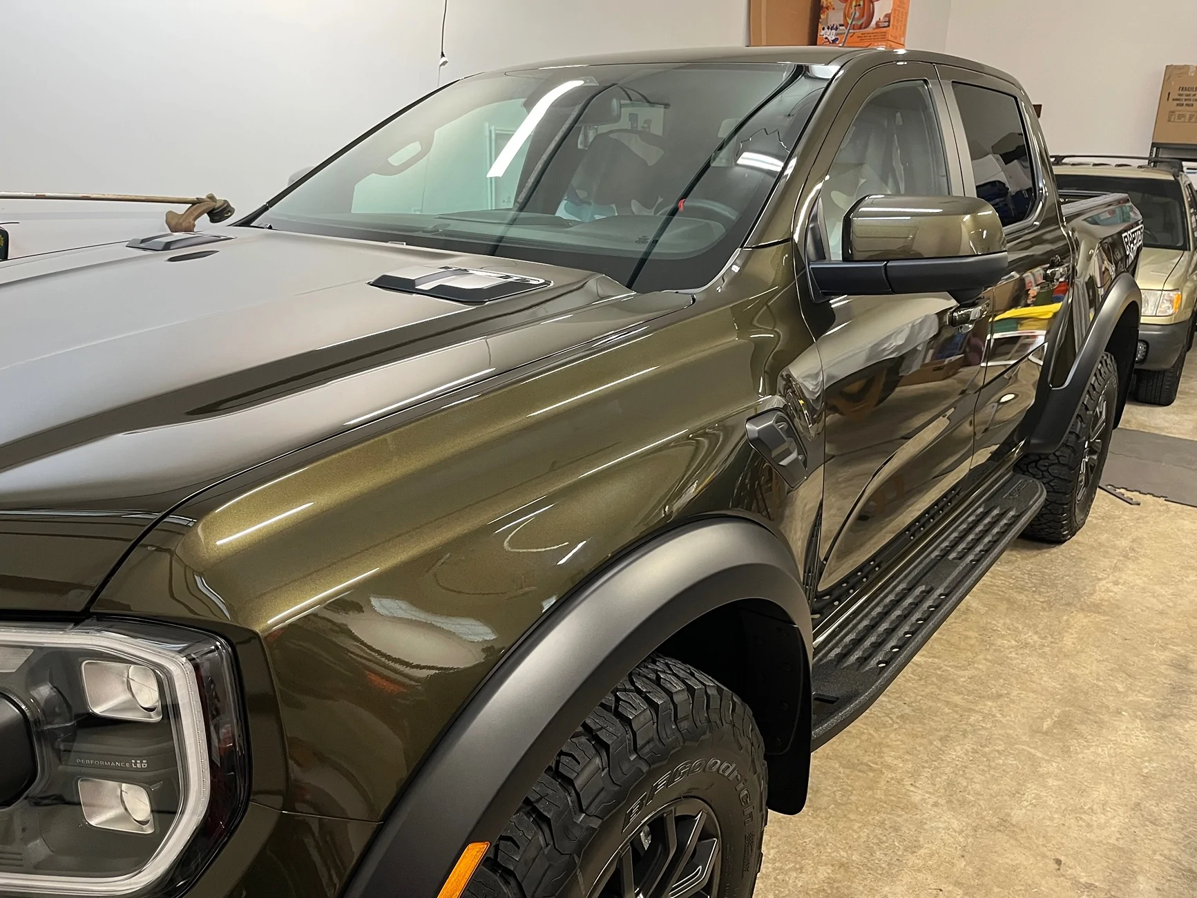

Ceramic coated the paint and wheels:
https://ammonyc.com/collections/exterior/products/ammo-reflex-pro-ii-enamel-coat
Ford Ranger Steve_K's 2026 Shelter Green Ranger Raptor Not A Build Thread IMG_0280
https://ammonyc.com/collections/wheels/products/ammo-gelee-pro-wheel-metal-coat
Ford Ranger Steve_K's 2026 Shelter Green Ranger Raptor Not A Build Thread IMG_0303

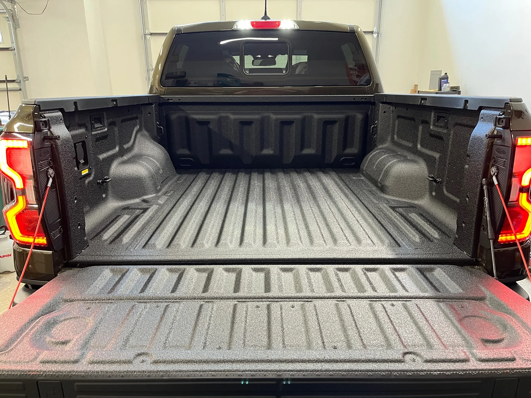

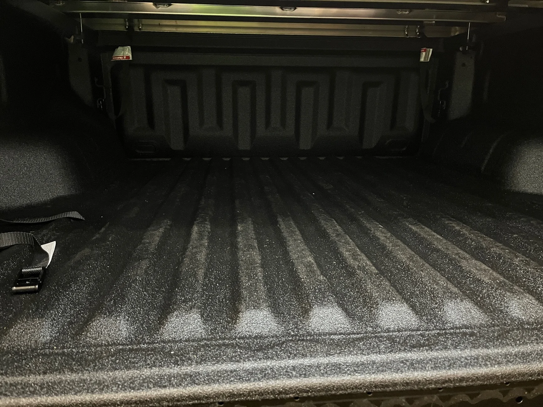

Line-X Bedliner
Ford Ranger Steve_K's 2026 Shelter Green Ranger Raptor Not A Build Thread IMG_0302

1 - got that taken care of a couple days ago at a Line-X dealer and it came out great.

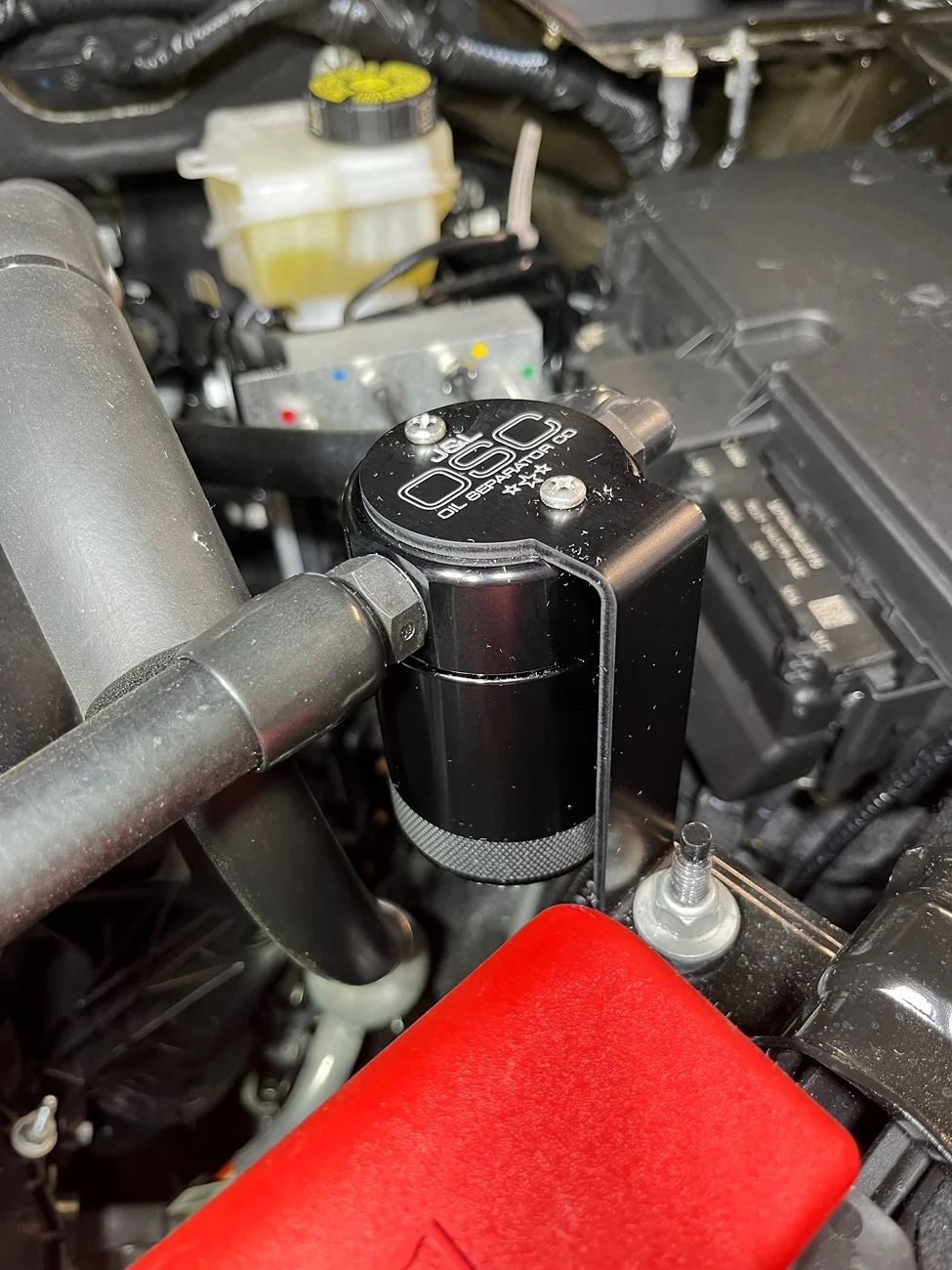

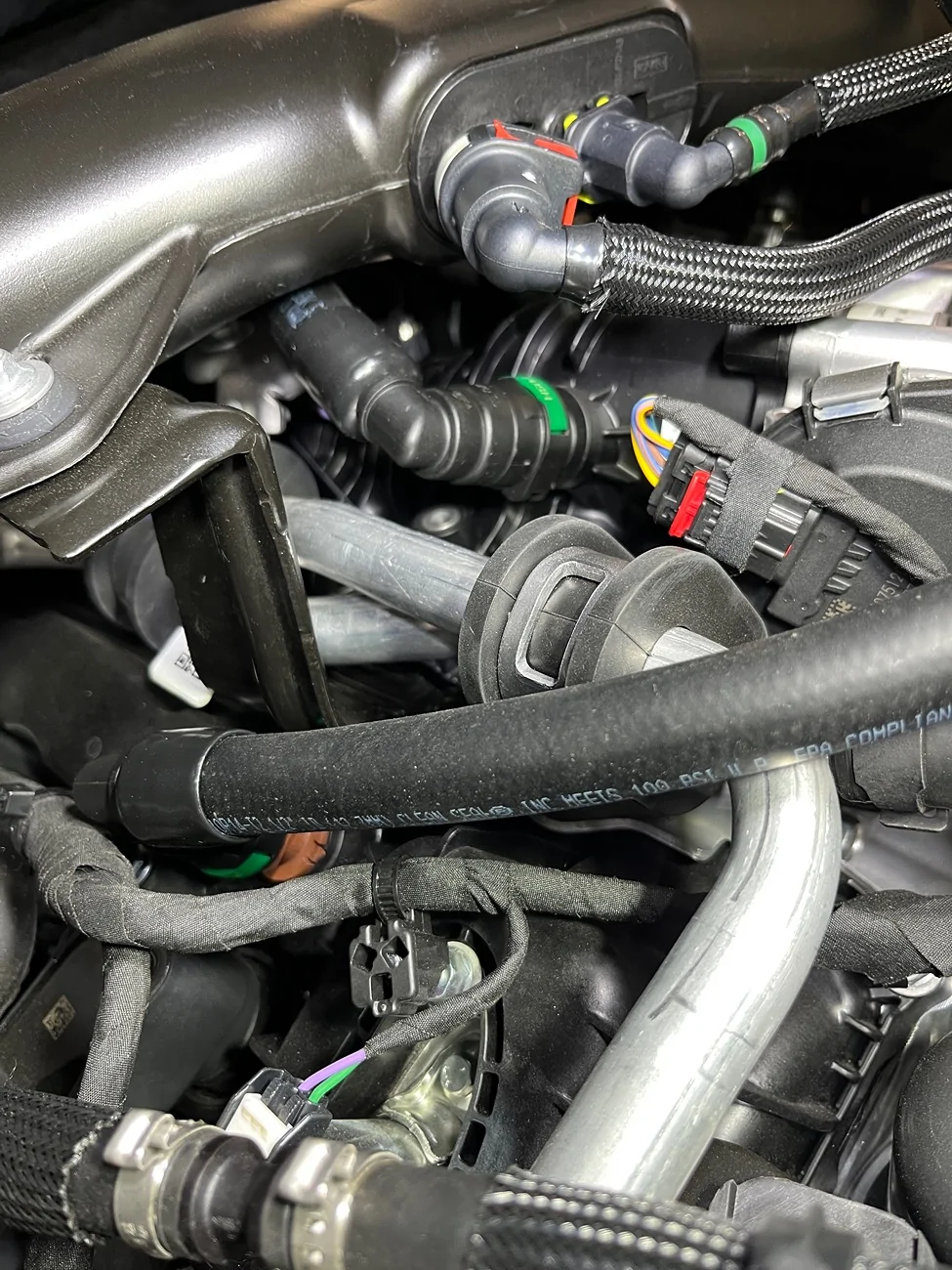

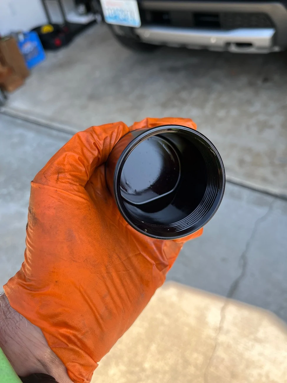

Squeezed in a little garage time this morning before doing some house painting preparation.....
First up was installing an oil catch can. Right now just doing one on the PCV side since I can remove it easily when going in for service, don't want the dealer giving me any crap on warranty coverage. Sometime in the future might switch one that can function while in boost, however those seem to require some permanent modifications to run. The install was pretty easy but would have preferred if the connectors had the same type of release mechanism as the factory ones since I found those easier to remove.
https://www.jlosc.com/j-l-oil-separator-3-0-pcv-side-2024-2026-ford-ranger-raptor-3-0l/
Ford Ranger Steve_K's 2026 Shelter Green Ranger Raptor Not A Build Thread IMG_0330
Ford Ranger Steve_K's 2026 Shelter Green Ranger Raptor Not A Build Thread IMG_0332

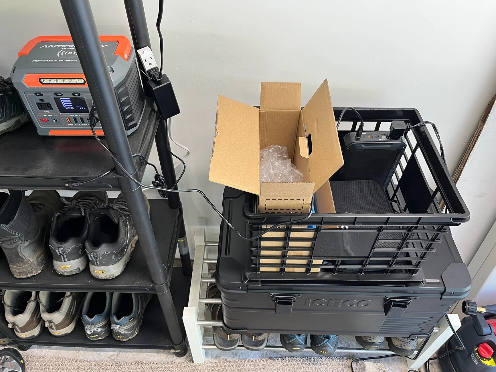

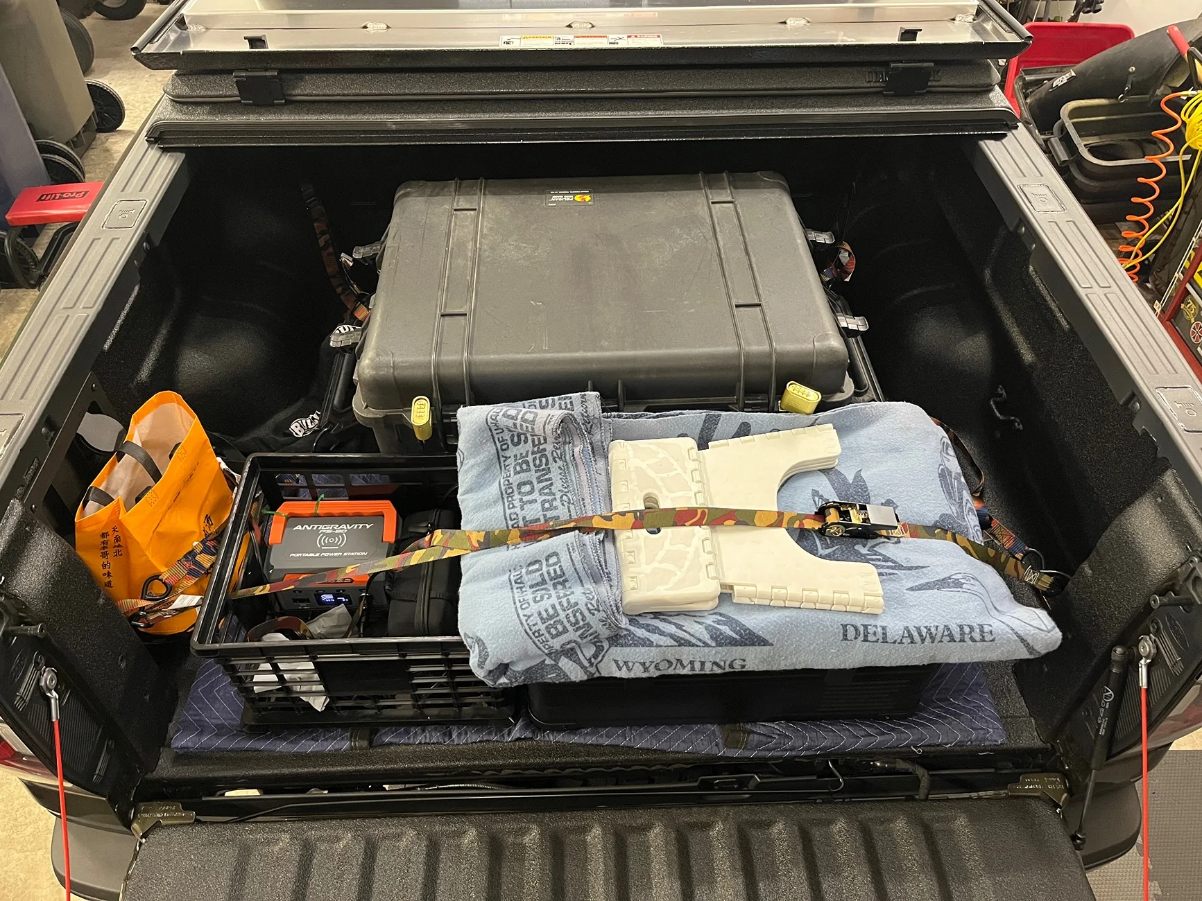

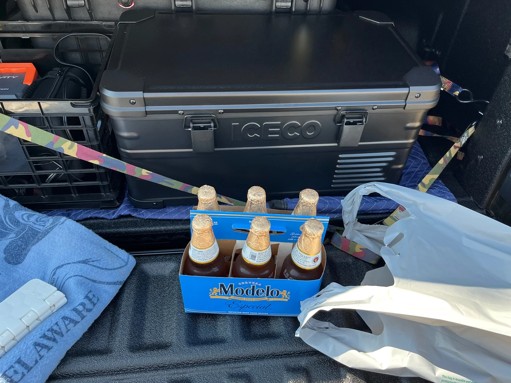

Next up was geeking out with my new electric cooler that I bought for my roadtrip to Raptor Rally 3. I picked up an ICECO APL20 that I'll be running from the outlet in the bed of the truck with a small 300W power bank and a 250W battery from ICECO. So far between the two batteries the cooler has been able to run for 72+ hours at 32F while in my garage with temps between 50F - 90F. Since I'll be driving around for about 2 weeks or so, I wanted a cooler to pack food in so I'm not eating too much fast food and didn't want to mess with hassle of having to buy and monitor ice constantly. Overall it's been pretty impressive with the run time while on batteries and pretty quiet too which will be nice for the few nights that it might be in a hotel room with me. Sometime in the near future I will zip tie the battery packs inside that black crate to keep things secure and organized with whatever other items I want readily available from the back of the truck.
https://icecofreezer.com/products/apl20-black-freezer

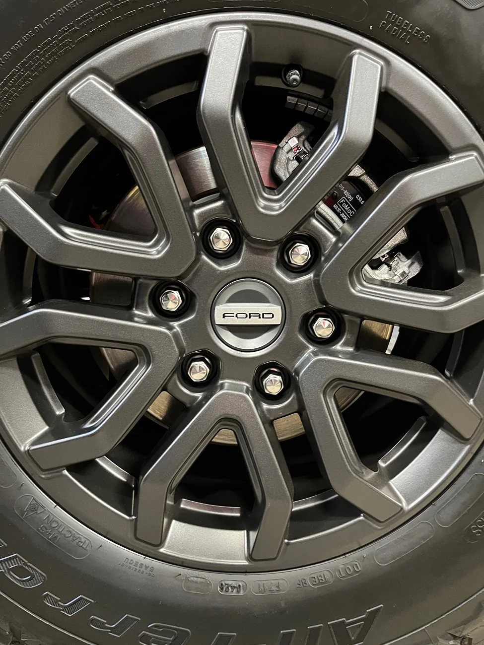

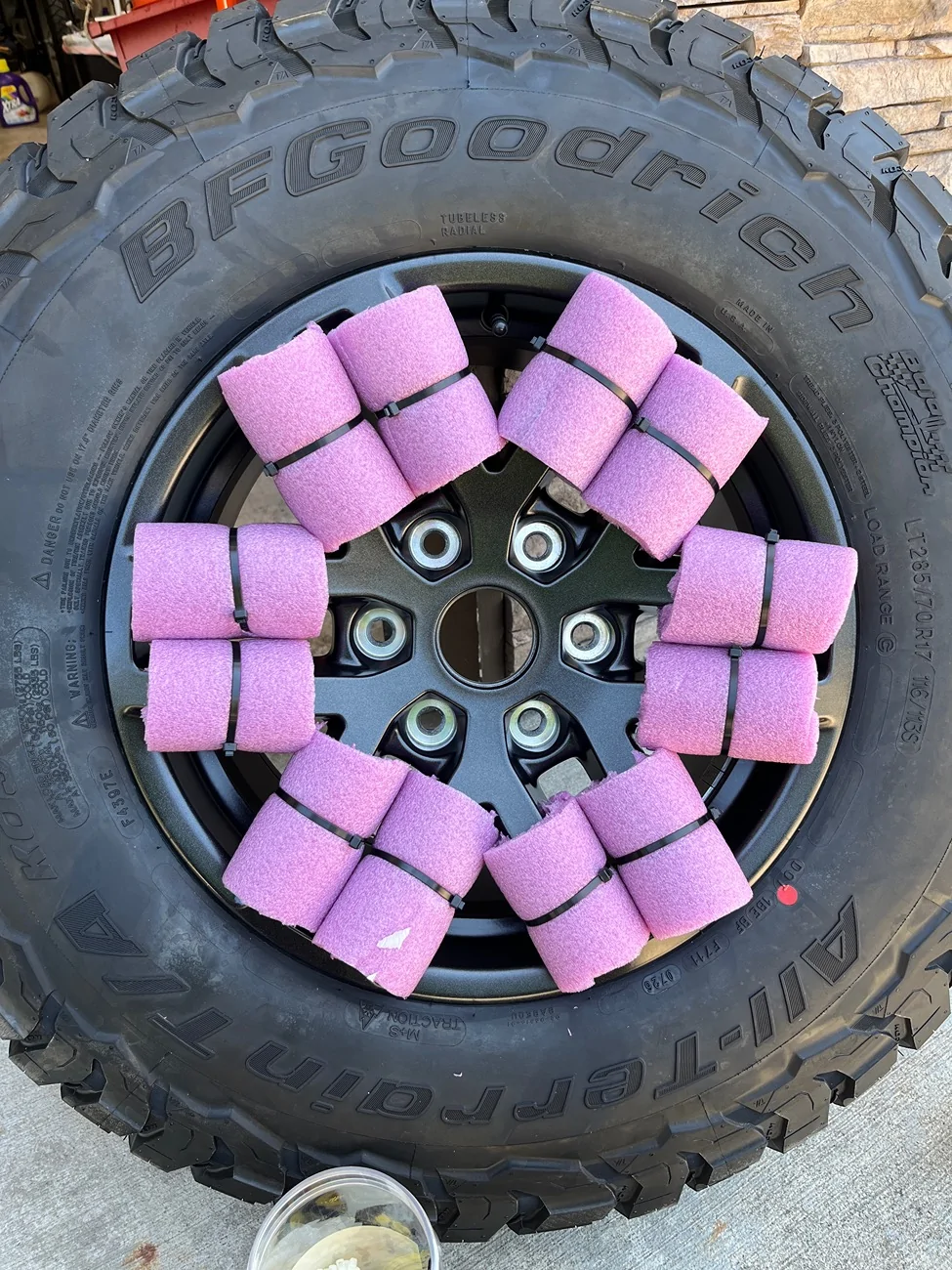

This morning I went to Discount Tire to have the spare K03 mounted to matching wheel. Ceramic coated the wheel, then got crazy with a pool noodle to protect the spokes of the wheel even though there is some rubber padding up in the spare tire mounting area.... Yes, perhaps I am a bit crazy.
Ford Ranger Steve_K's 2026 Shelter Green Ranger Raptor Not A Build Thread IMG_0348

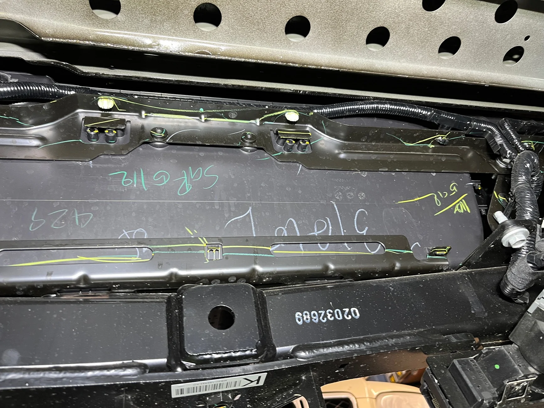

While checking out the spare tire area I remembered I had seen in a few YouTub videos that the back side of the bumper seemed to be an area that Ford factory workers sign for fun or maybe some sort of inspection check-off area.... A thanks to Lenele (???) for building my truck!

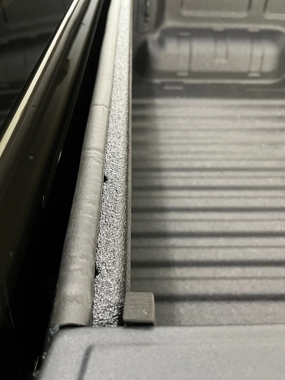

Sealed up the bed rail caps a few days ago since I had got that suggestion from @Dre' Dawg. Turns out the cover pretty much covers them completely, but still glad I did it:
Ford Ranger Steve_K's 2026 Shelter Green Ranger Raptor Not A Build Thread IMG_0405
Lay down the front bulkhead seals and also found some other holes that I sealed up with some silicone:
Ford Ranger Steve_K's 2026 Shelter Green Ranger Raptor Not A Build Thread IMG_0412

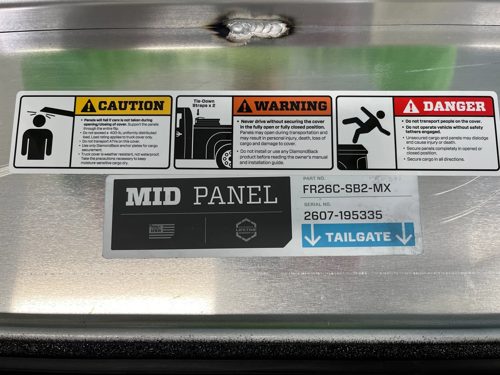

Placed the cover on the bed to start lining things up. This warning sticker pretty much ruined my weekend plans:
Ford Ranger Steve_K's 2026 Shelter Green Ranger Raptor Not A Build Thread IMG_0414

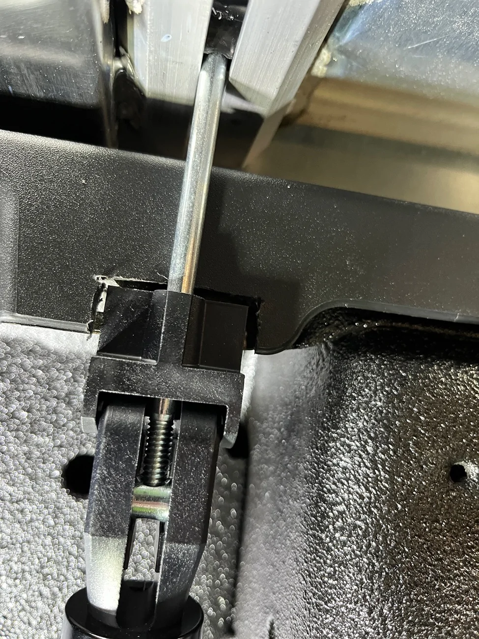

Had to notch out the bed rail covers at all 4 corners for the clamps that hold the bed cover down:
Ford Ranger Steve_K's 2026 Shelter Green Ranger Raptor Not A Build Thread IMG_0421

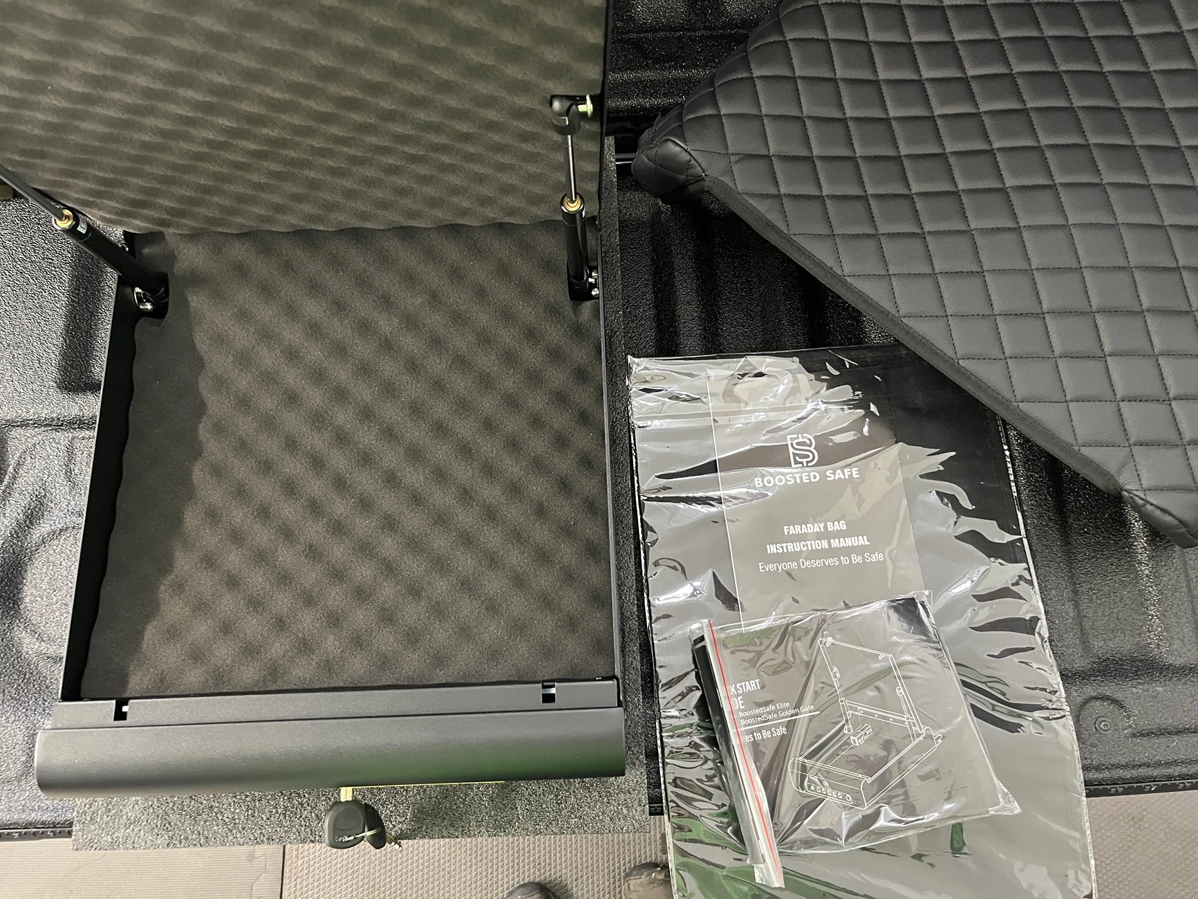

After yard work was completed I installed my BoostedSafe that arrived a few days ago. I probably won't need it on a daily basis but will leave in full time, but on road trips I have various Standard and metric ratchets, a plethora of freedom seeds, and various other accouterments. Overall the quality seems pretty good. Nothing is 100% theft proof, but it would certainly increase the time that someone would have to stick around and work on it to get open or out of the vehicle since it attaches to the ISO/child seat mounting points and requires the safe to be opened to remove it. I did the Elite version with key, fingerprint, and pushbutton combo lock, stores up to 50 fingerprints so I can have my wife added to it easily. Got if for $339 with a coupon I found online.
boosted-safe-elite-the-pinnacle-of-security-and-innovation
Ford Ranger Steve_K's 2026 Shelter Green Ranger Raptor Not A Build Thread IMG_0432
Ford Ranger Steve_K's 2026 Shelter Green Ranger Raptor Not A Build Thread IMG_0433
Ford Ranger Steve_K's 2026 Shelter Green Ranger Raptor Not A Build Thread IMG_0434

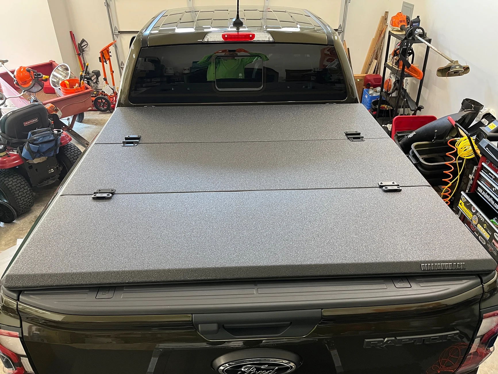

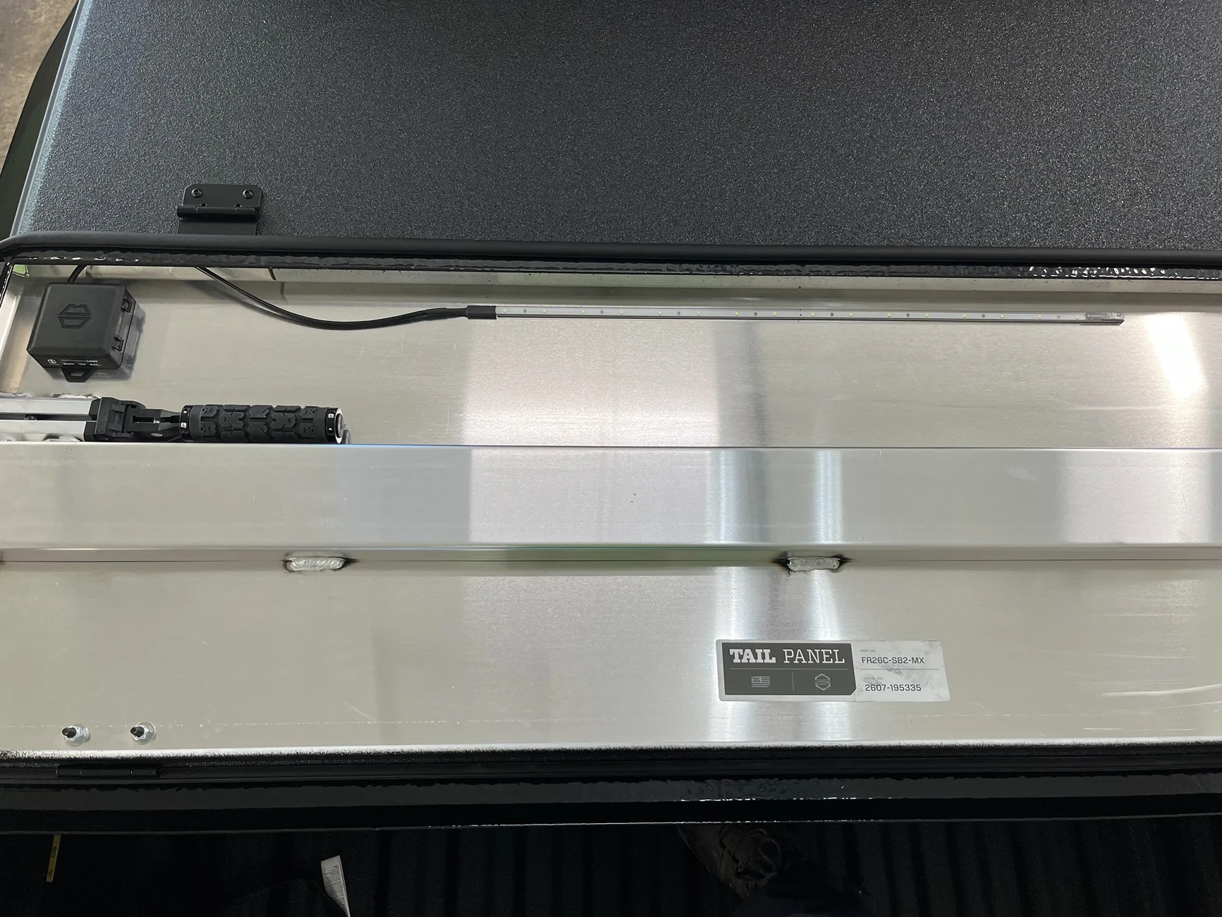

Added the LED light strip from Diamondback to my bed cover. Seems to light up ok even while in my garage during the day, but expecting it will be good in darkness.
Ford Ranger Steve_K's 2026 Shelter Green Ranger Raptor Not A Build Thread IMG_0436
Ford Ranger Steve_K's 2026 Shelter Green Ranger Raptor Not A Build Thread IMG_0437

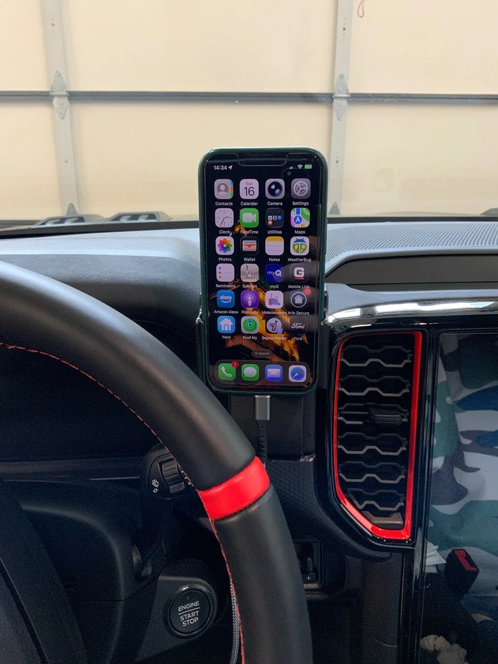

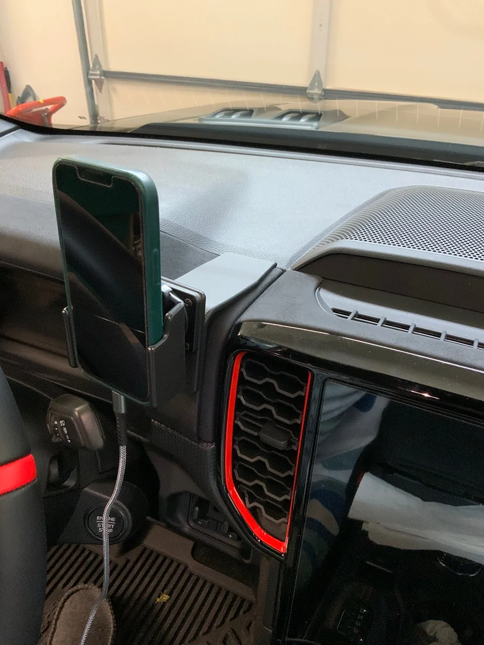

Today I installed the ProClip phone mount that arrived a few days ago. I like how it's easy view and out of the way since it's not taking up space anywhere in/on the center console.

First up was doing the front license plate mount again since I finally picked up some new hardware that was the correct length.
Ford Ranger Steve_K's 2026 Shelter Green Ranger Raptor Not A Build Thread IMG_0521
Checked the engine oil and the oil catch can even though it only has about 200 miles (200 miles on the catch can) on it. There wasn't much in there but wanted to get an idea of what was going on with that setup.

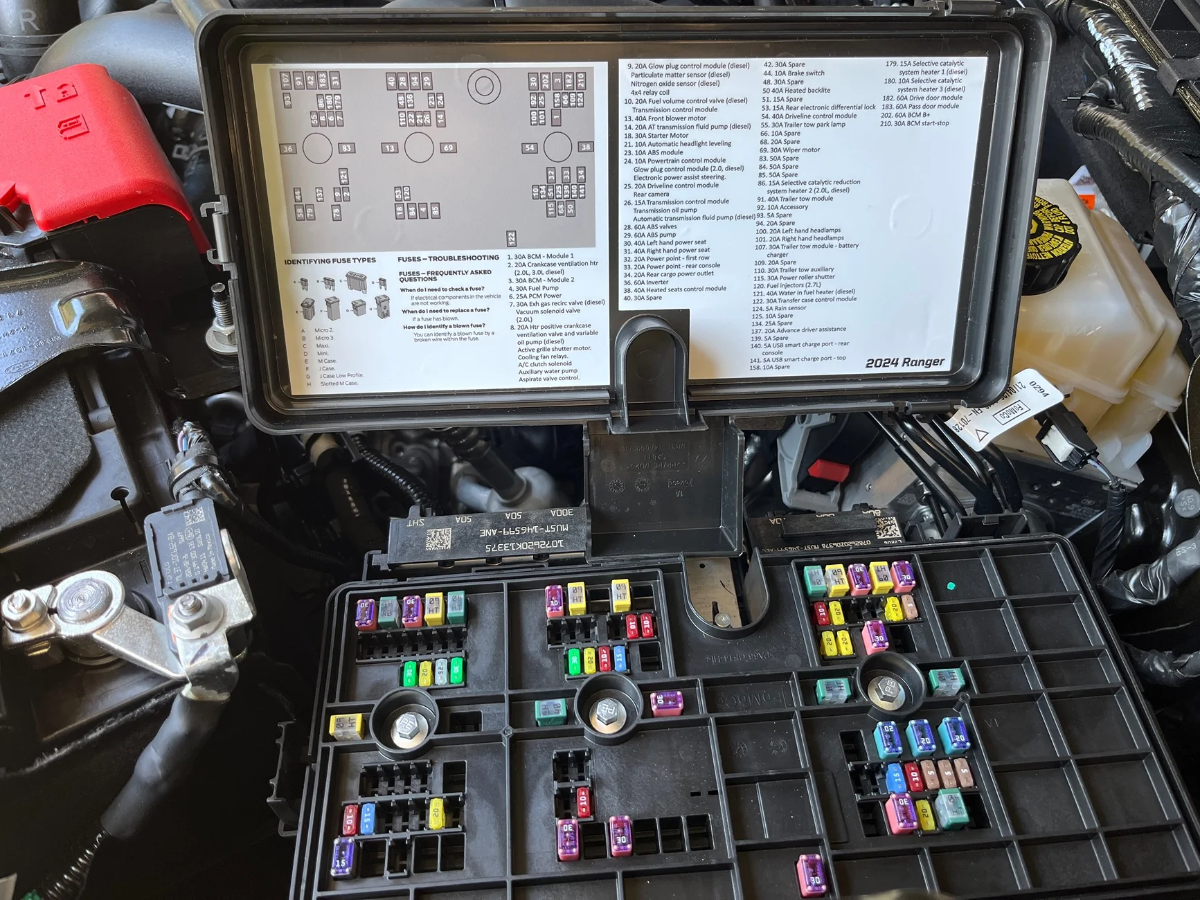

Installed the some stickers in the under hood fuse box since they are not labeled. Someone on here had suggested this from Sticker Fab. https://www.stickerfab.com/products...lid-labels-2024-ranger?variant=49441705427263
Ford Ranger Steve_K's 2026 Shelter Green Ranger Raptor Not A Build Thread IMG_0517

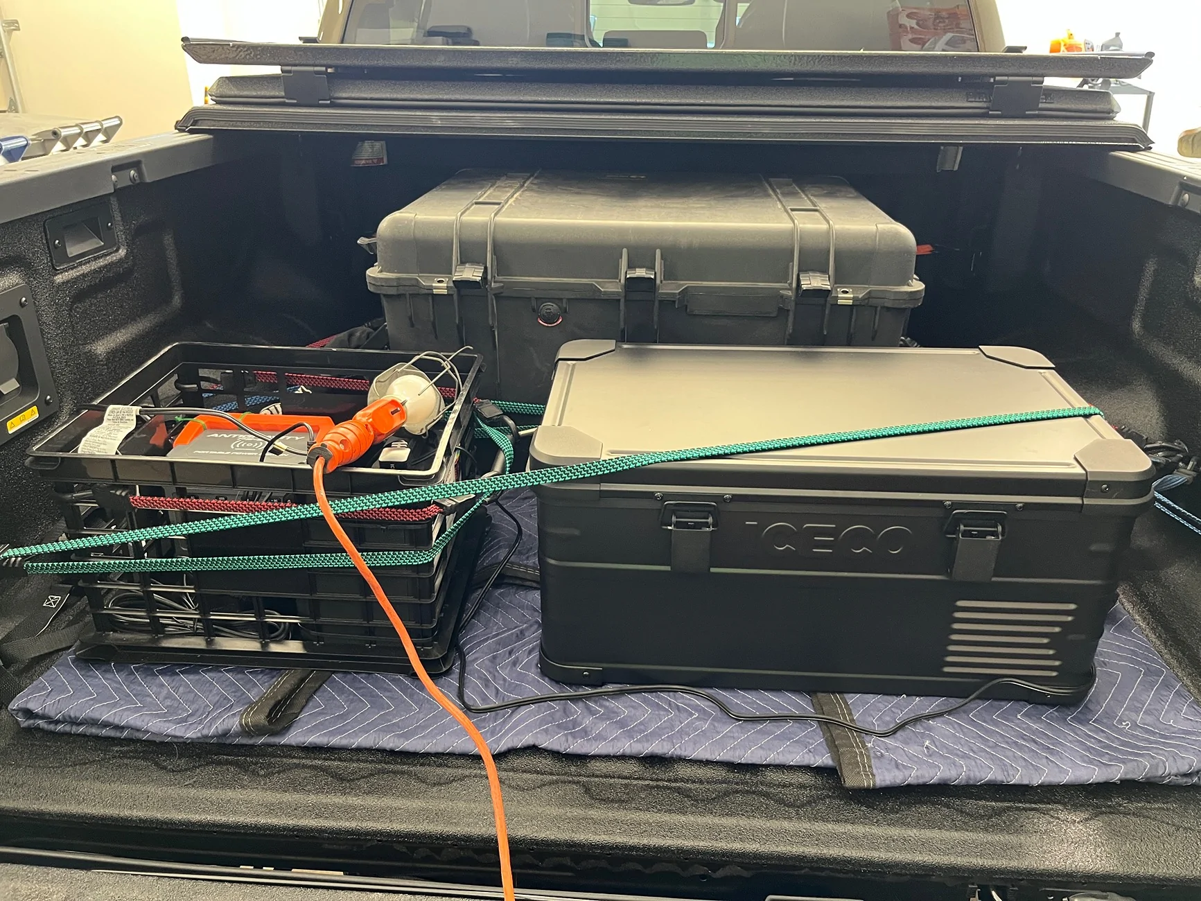

And up last was trial fitting stuff for the road trip. I'll try it out to see how it works and will pick up more tie-downs and bungie cords after I get back. But for now, everything will stay in place but Ill want to clean up its looks later
Ford Ranger Steve_K's 2026 Shelter Green Ranger Raptor Not A Build Thread IMG_0520

Had to complete the testing of the IceCo cooler..... the Modelo was quite refreshing when I arrived at my destination.
Ford Ranger Steve_K's 2026 Shelter Green Ranger Raptor Not A Build Thread IMG_0526

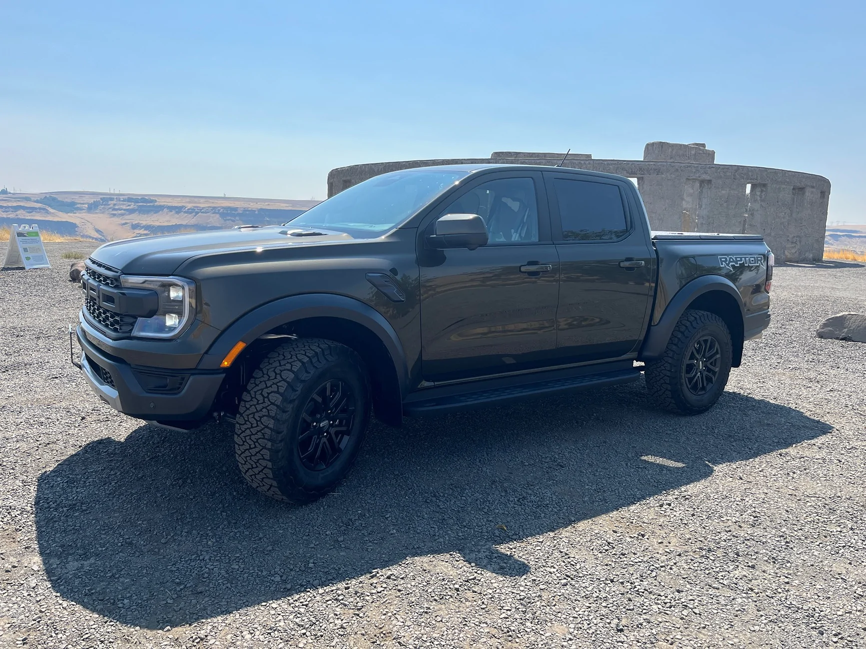

A quick stop at the Stone Henge WWI Memorial. I have only walked around inside it once, a little depressing but a great monument to those of Klickitat County who well in the war. Just need to stop by with my wife's CRV to finish having all of our vehicles photographed here.
Ford Ranger Steve_K's 2026 Shelter Green Ranger Raptor Not A Build Thread IMG_0530
Ford Ranger Steve_K's 2026 Shelter Green Ranger Raptor Not A Build Thread IMG_0531

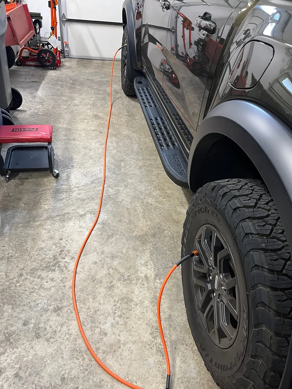

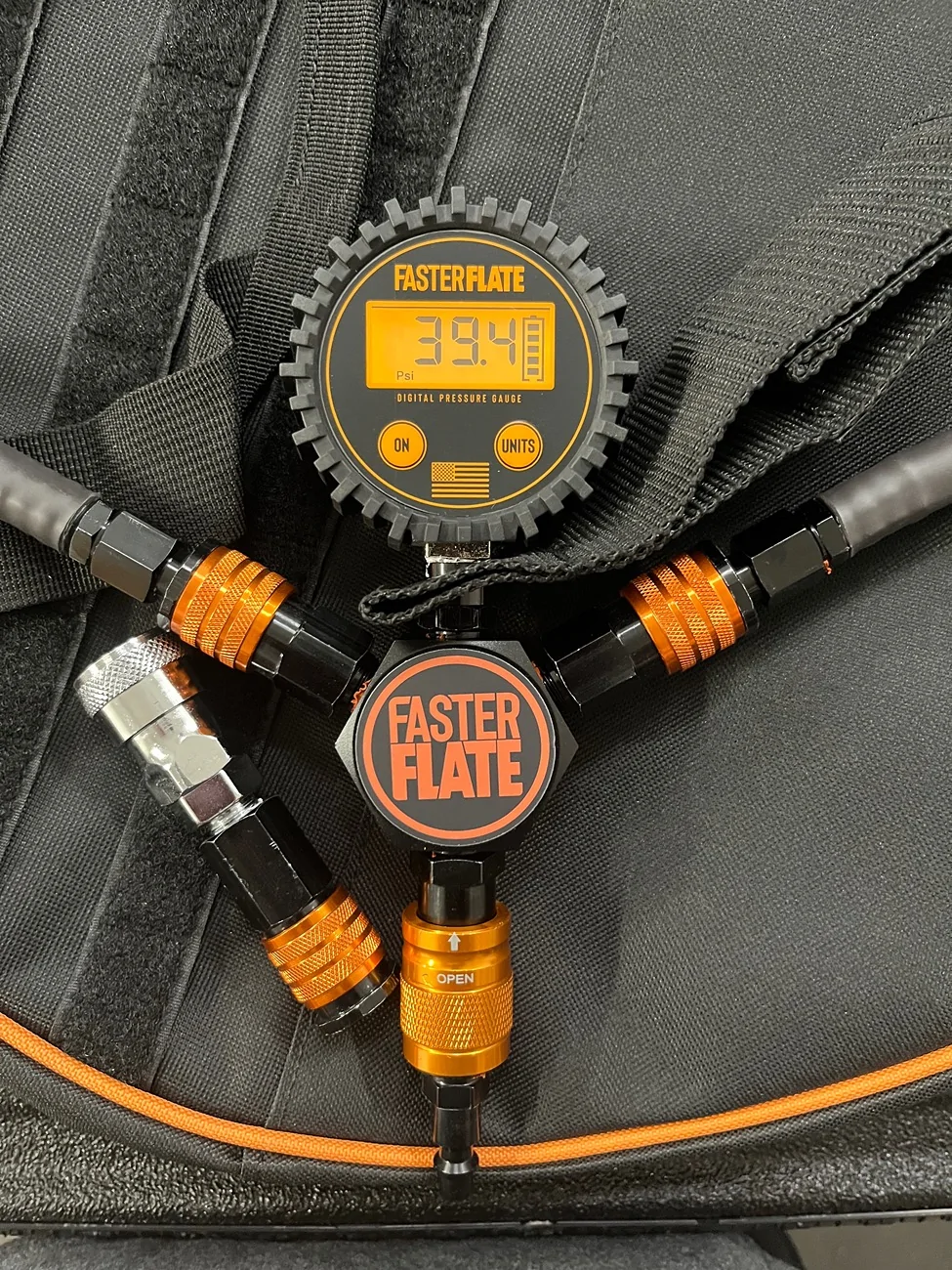

Tried out a 4 tire inflation setup from www.fasterflate.com today. This is something I have wanted for a while since my wife's CRV has a funky way of monitoring tire pressure and can be a pain in the a$$ sometimes after tire rotations or when going back and forth from summer to winter tires. After getting my RR with the tire pressure reading on the dash, I figured it was time to get one of these since it would drive me crazy if the pressure was several pounds off corner to corner.
It's nice being able to hook up all the tires at once and let everything balance out in a couple minutes! This will also be handy when airing down for trail use as well as filling back up.
Ford Ranger Steve_K's 2026 Shelter Green Ranger Raptor Not A Build Thread IMG_0572
Ford Ranger Steve_K's 2026 Shelter Green Ranger Raptor Not A Build Thread IMG_0574

Today I decided to get crazy and do my first oil change at about 1880 miles and will then will follow up at 5k intervals. Overall it was fairly simple and I also grabbed a sample to send to Blackstone as a baseline and maybe do every 20 to 25k miles, not sure yet.
After watching several videos on oil changes I decided to order up one of those vacuum pump kits so I wouldn't have the Valdez docked in my garage. Wow, it made things so much cleaner and easier! Although it did take some time for the oil to be sucked up through the dipstick tube, which was fine since I was also working on my wife's 2016 CRV at the same time.
It's a 15L capacity, so held the full (whatever capacity since every source I have checked has come back at 7qts, 7.5qts, & 8.3qts). Based on the fill line at the top and the number of indentations on the container I estimated at about the 3rd indentation and it was pretty close!
https://www.amazon.com/dp/B0CMTVB7SW?ref=ppx_yo2ov_dt_b_fed_asin_title&th=1
Some of the comments I had seen on here said there would still be a bit of oil coming out of the drain plug since the tube couldn't go all the way down into the pan, but this is all I got after 5-10 minutes.
I measured the dipstick length and marked the hose at where it stopped. 20" for the dipstick and got the hose in about 34". Used the handy-dandy tailgate to measure it!
Used a little trick to get that small O-ring on the filter cartridge. Put some string through the O-ring, loop on one side, the 2 ends out the other, wrapped the loop below where the O-ring sits, and gently pulled on one end of the string and gently worked it down and used a pick tool to pull it out.... Super easy.
And after all that drama, 8 quarts went in.... Although I am going to check it several more times before taking it out for any lengthy drive since capacity info is all over the place.
