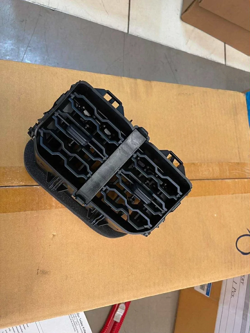

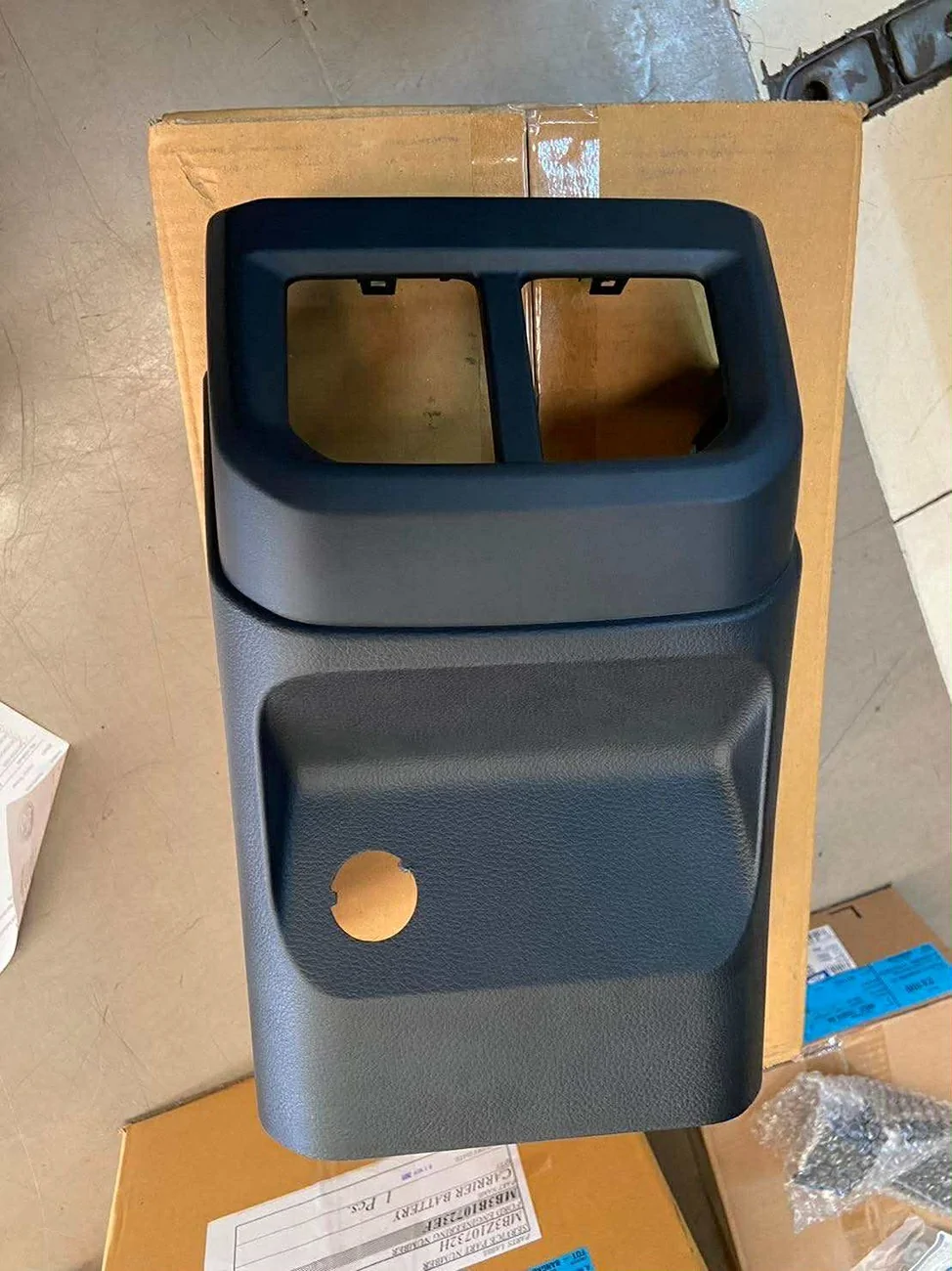

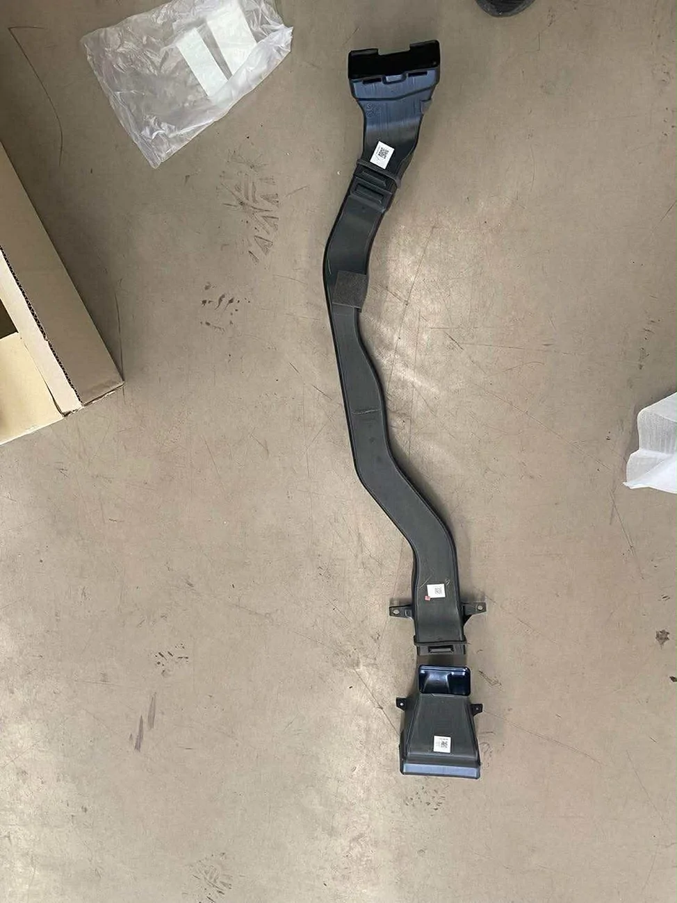

You can find the entire rear panel with register and the last angled vent tube on eBay sold as the rear vent register part number or just the rear panel without the other 2 pieces both will require cutting a hole for the 120v plug. The other parts I asked a Thai eBay seller to find and he responds back quick, about $163 total for the long tube and front angled connector. I need the 2 push pins and should find out if the parts are all that will be needed. Unknown if the underseat vent needs a cap or not. I have not seen anyone with rear vents check if they have them on their truck.
If you need help finding someone to order from overseas let me know, I have 2 sellers that I ordered other parts from and they seem willing to look them up.
