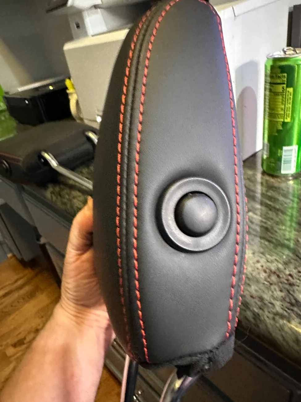

Will these ones fit the 2024 ranger xlt do you think?
I don’t see why not, considering there was no Raptor in 2020. Had to have come from XL, XLT, etc. You might have an easier time finding something that has the same color as your interior. I was forced because I wanted to keep the orange stitching.

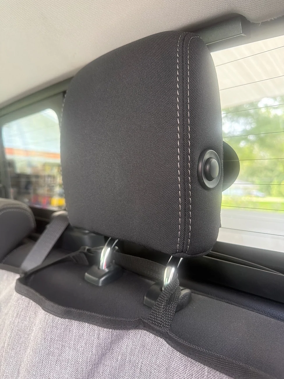

Followed your instructions. 45 minutes to complete. Important to keep the thin plastic bag over the foam. It's like a lubricant. It may seem too tight a fit, be firm with it,
Glad I could help!! Looks good! 👍

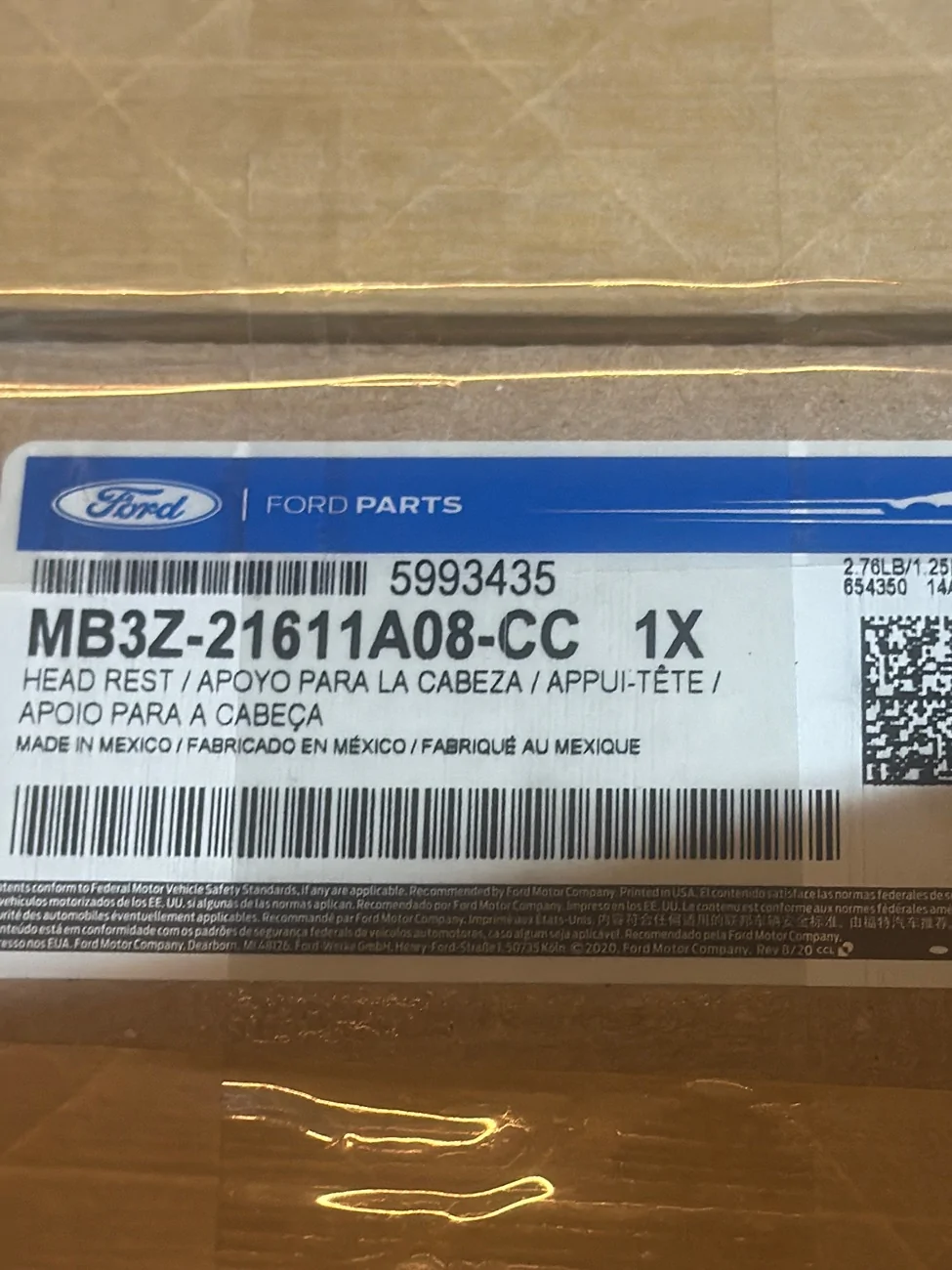

If your interior is black, these are almost a direct match. My wife, who is the Fine brush person in our relationship, said that the pattern was almost in distinguishable. I bought them from a Ford dealer. I think I paid $85 for the two including shipping. The part #s are the same for both sides
The buttons are on the driver side on both headrests which is okay by me.

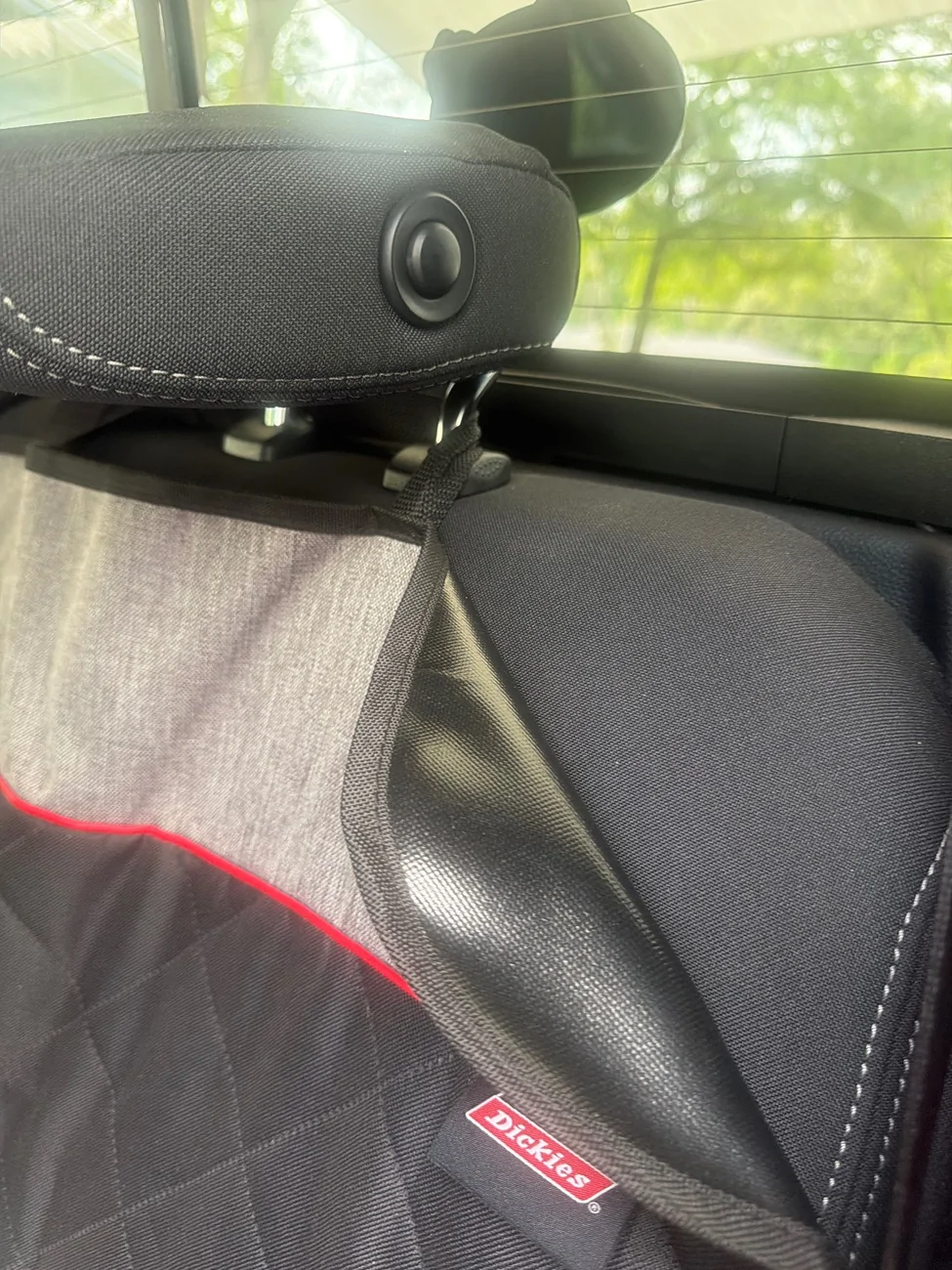

I may do this to my wife's RR at some point but for now since our Aussie is usually the only one riding in the backseat I just pull both headrests out and tuck them under the seat. Whenever a actual person rides back there, please don't tell our Aussie he's not a real person because he will be highly offended since he thinks he is, I put them back in. They go in and out really easy.

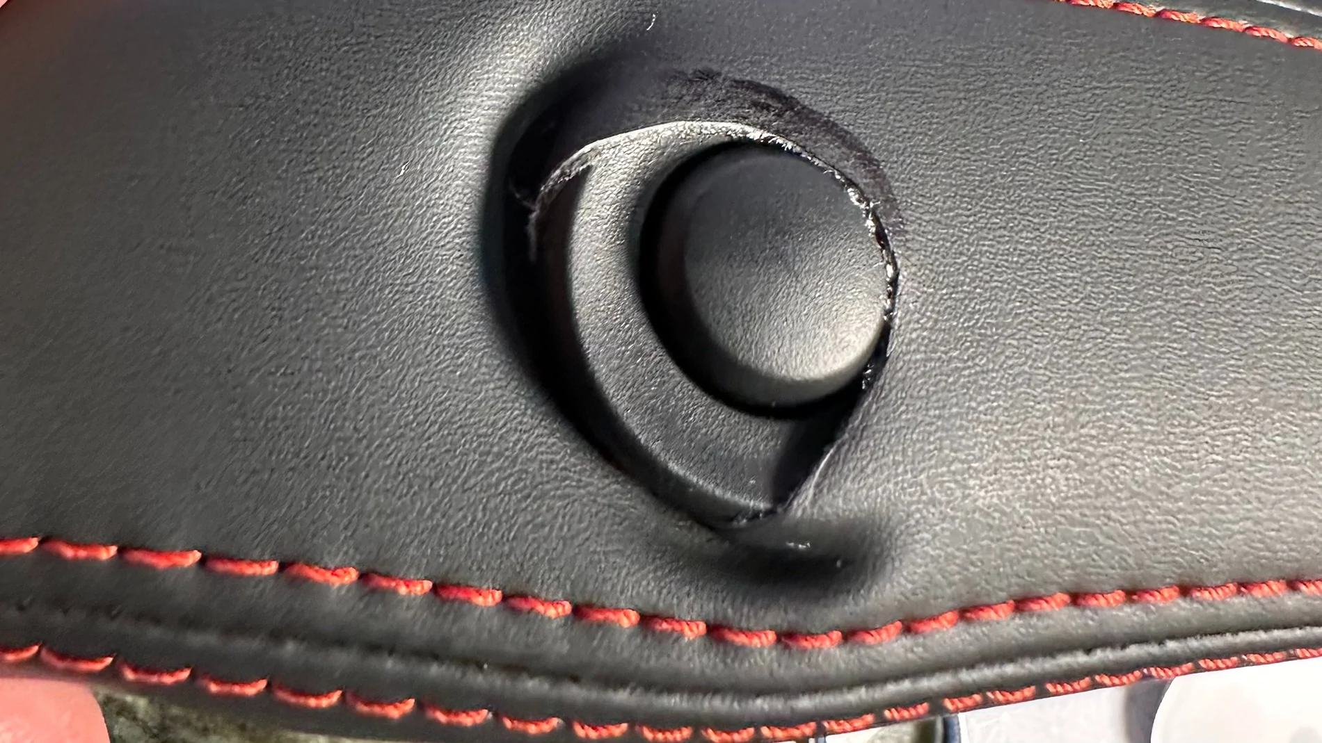

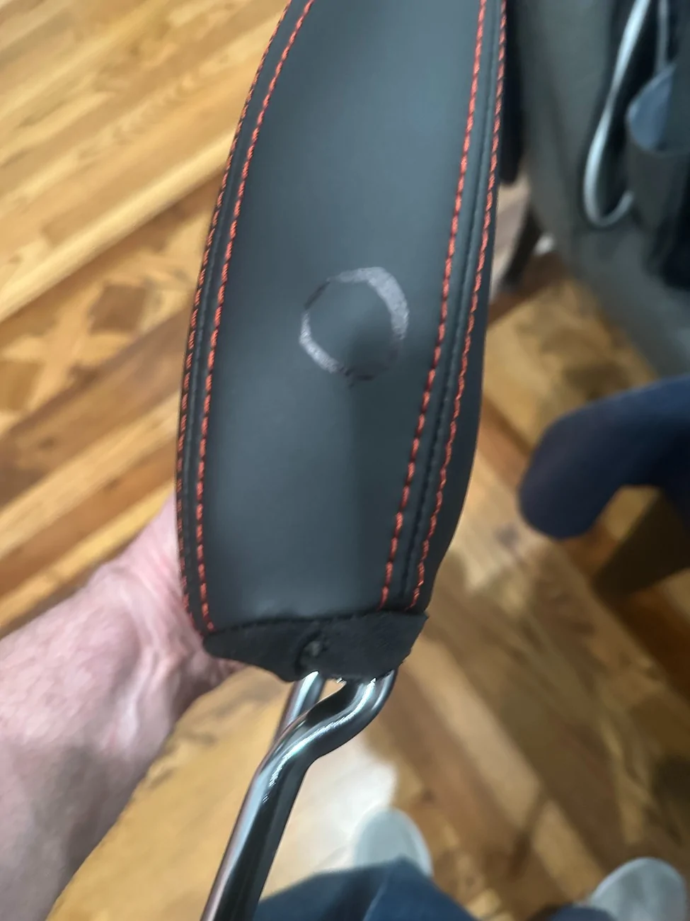

Thanks to the OP! This is a great mod. I got around to swapping my covers today. I used a different method to cut the hole. I put on the new cover, using the plastic bag. As noted it is crazy tight but goes on. I just felt for the button and marked the leather. I did not remove the cover. I just used a small pair of scissors to cut it out and worked the leather around the trim. These is plenty of stretch in the material to easily do this.
