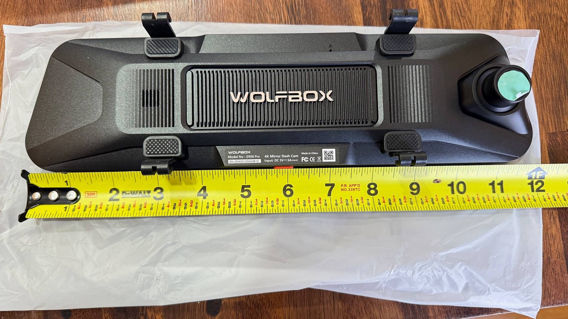

Hi I was reading your post and you said you have the the Wolfbox webcam strapped to the Raptor's mirror. I just bought a Wolfbox G900 Pro with a 12" mirror. When I strap it to the Raptors it doesn't cover the mirror. There is about an inch sticking out on the right side. Is this how yours is? Thanks

Are you sure you got the 12"? I got the 12" version and it covers the mirror completely and overlaps a good amount.
Make sure they didn't send you the 10" version by accident.

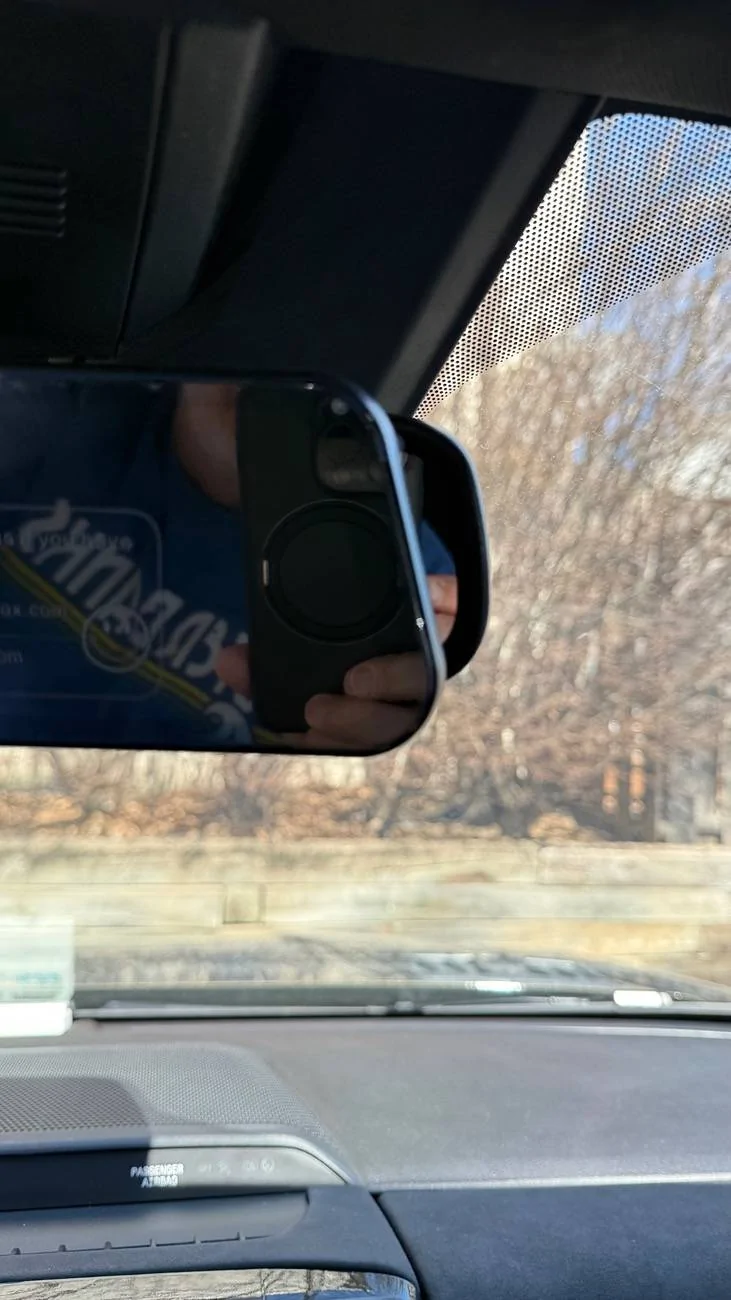

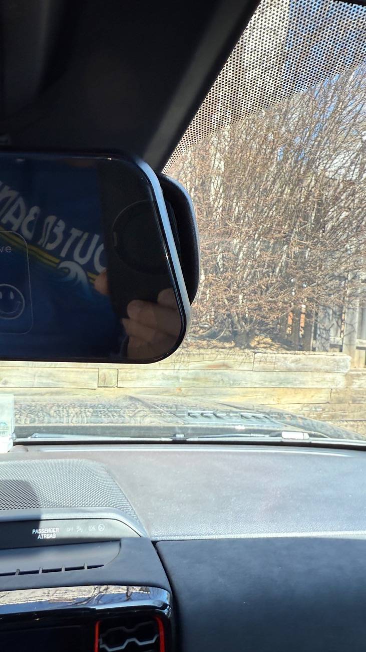

So I realize what the problem is. I bought the polarizing lens. Maybe you didn't. You can see in my photos that I did get the 12". The next photo shows it on my RR mirror with a little sticking out(which I still don't like) but the next photos show it with the CPL on the RR mirror sticks out more.

Interesting, and you aren't able to move it to the right anymore because it hits the camera? Maybe this is because of the G900 Model, I have the 840s...

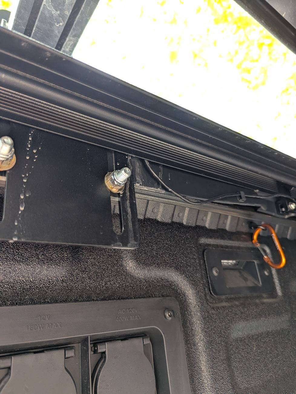

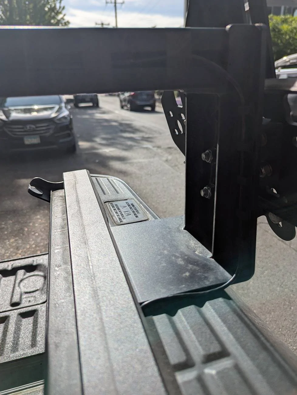

Sure thing. Since my Billiebars system raised up my tonneau rails by about 1/8" it was easy to have the wire under there, then I just ran it through the bar channel and used electrical tape to secure it. I'm sure you can use some zip ties and it would work just as well. Here are some pics

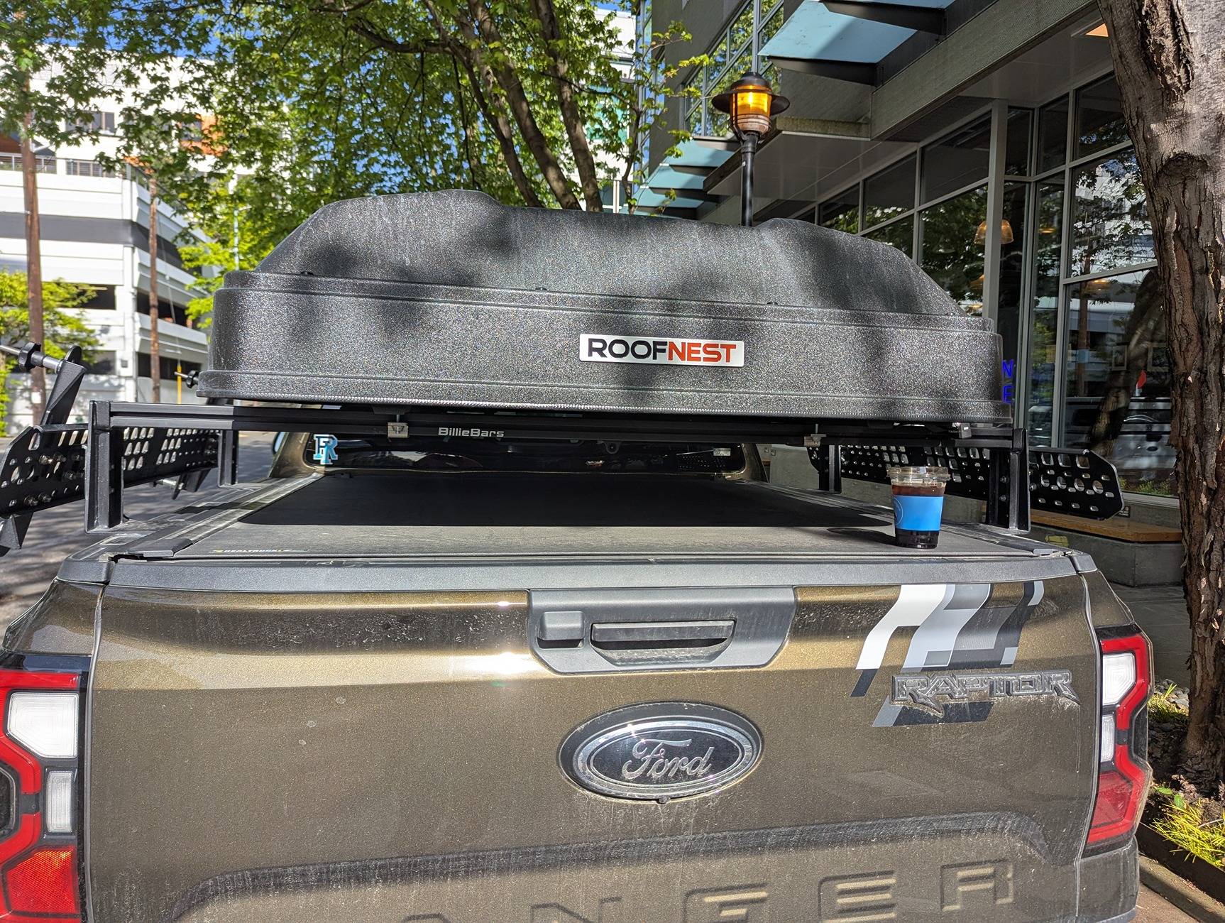

And for anyone wondering, here's what the camera looks like mounted with the tent on.
