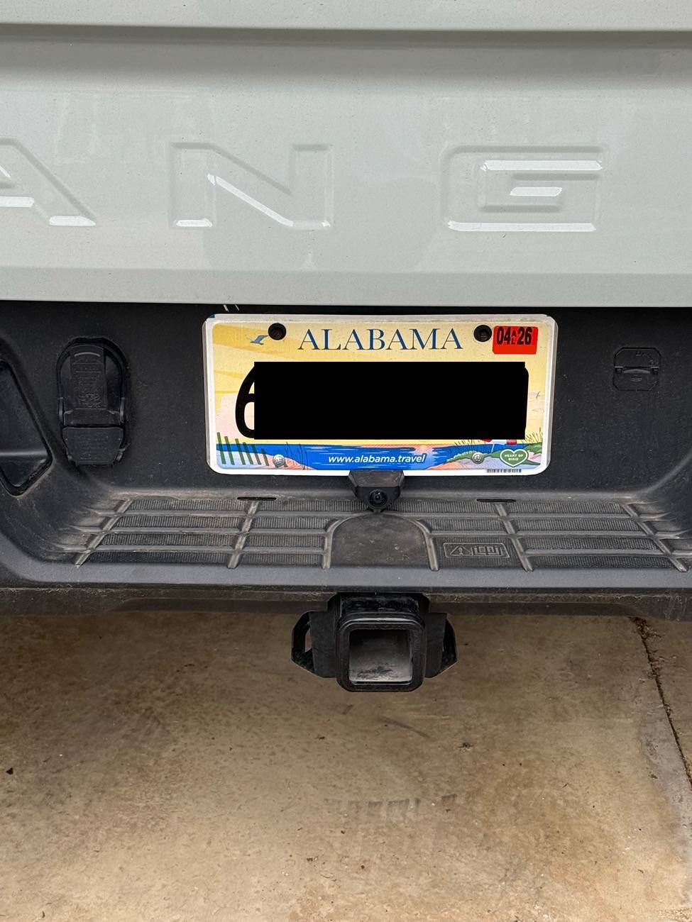

Has anyone mounted the camera on the license plate with the bracket?
I'm a little concerned of these these two things
  1. The tailgate will hit it when it is down
  2. the camera would cover too much of the license plate

I had my rear camera installed on the license plate on the top initially - it does not obscure the plate but did get hit when the tailgate was open. The installer flipped the tag bracket upside down and made two tiny holes in my bumper area (still need to replace with black screws)to use the bottom screw holes. It looks like this.

I hadn't considered that. Nice call!

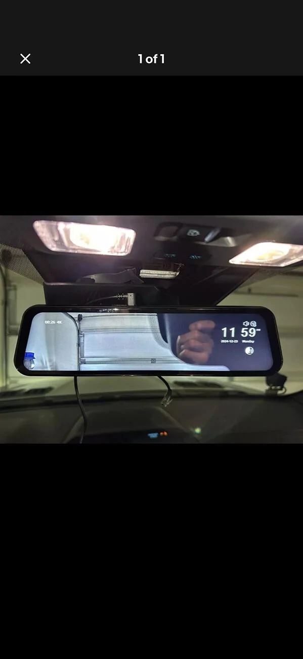

I’m also hoping these allow for a non obstructed front camera view being a different angle. This is what the front camera looked like with the Wolfbox mount and adapter looked like. I will report back once I try the other brackets.

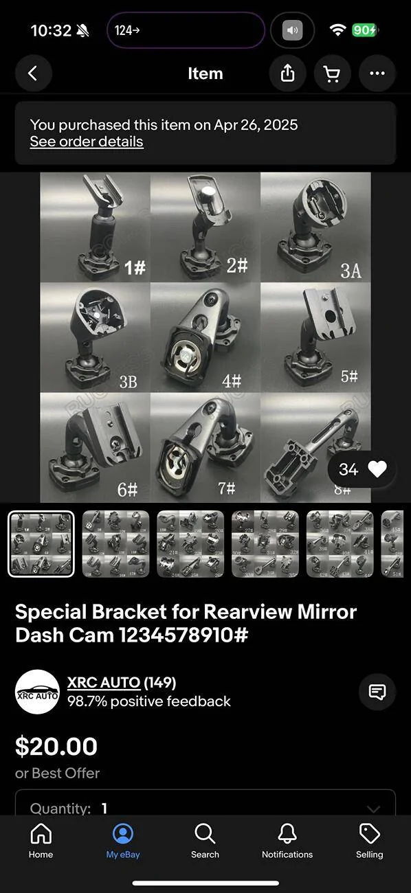

Can you let us know what the company name is and #48 bracket name so I can search for it? The link you post doesn't work now on Ebay.
It came from eBay - this is the ad from when I bought in late April.
