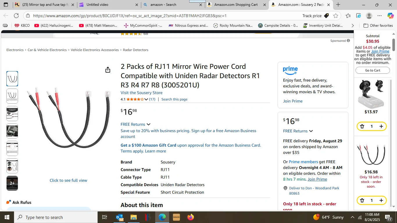

Any of you fine folks used an alternative to the Blendmount wire adapter. I have a Uniden R3 detector and 50 bucks for a wire.......? Amazon has a few more cost-effective solutions and just wandering any of you chose other than Blendmount?
Go to page 6 and you will see what I used $16

OK Don Vandyke.....you got me going on this fine Sunday morning here in the Rockies.
Just as a sanity check....here are my pictures:

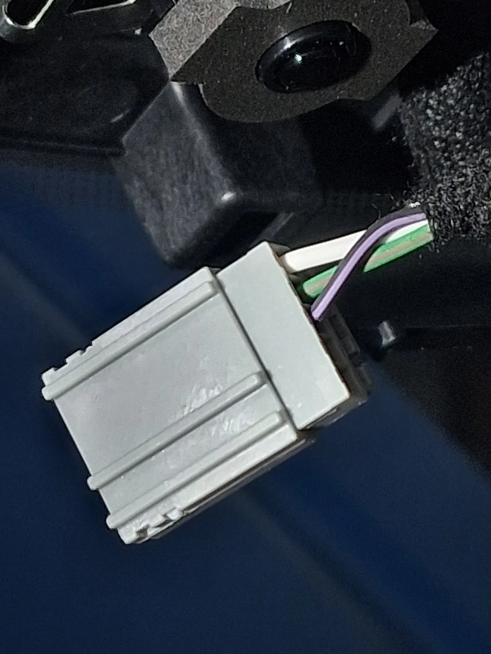

I have the right connector....yes (white= 12vdc positive and purple= ground)
Here is the cable I have chosen. Given your Amazon purchase and you have a Uniden....whatcha think? Hey......I'm a simple old man who needs pictures and all the help he can get.
I used it for my dashcam with a USB. Yes that's the right connector

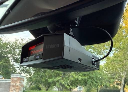

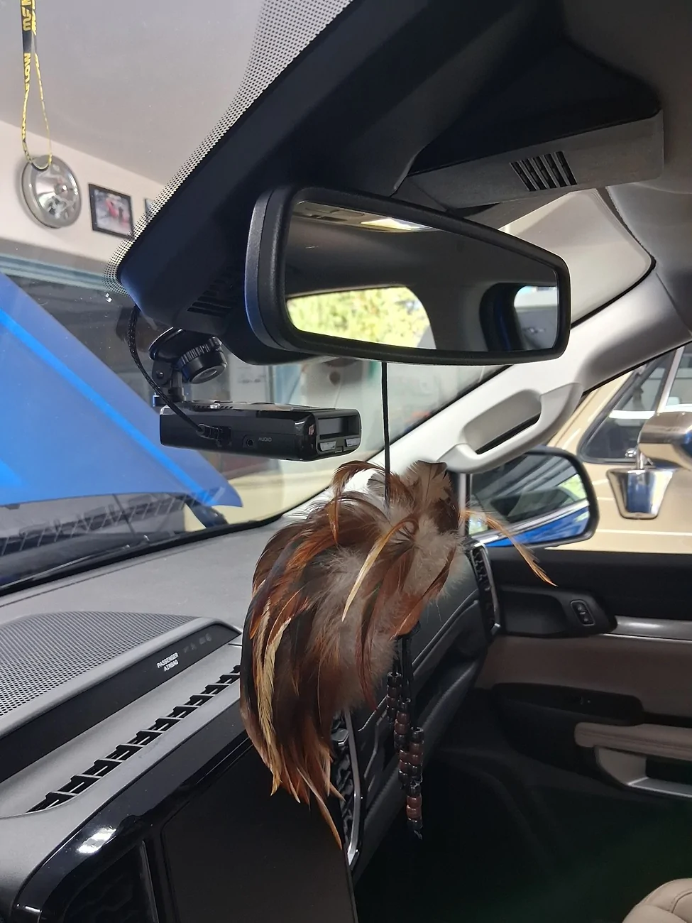

Mission accomplished and thanks to Mr. Vandyke for helping me along the way. The fuse tap worked flawlessly and accessing the correct power source was a breeze. I chose a suction cup mount for the initial installation as its design serves me well in all my other vehicles. However, it does have its downside if not constantly checked and y'all know what I mean. After researching all the mounting options available, I'm hopeful that someday a better design will come available. But for now.....this will have to do.

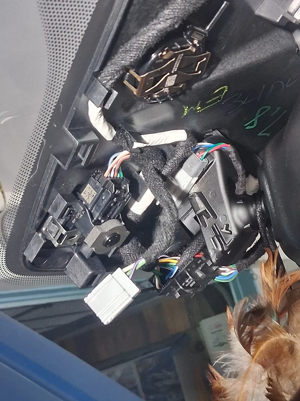

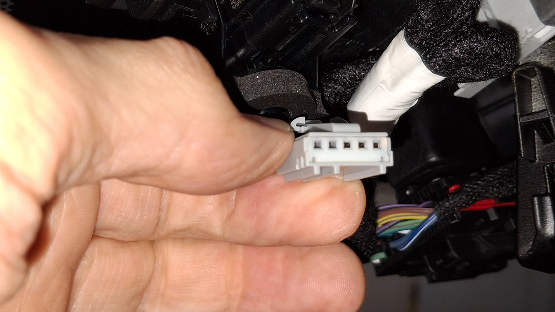

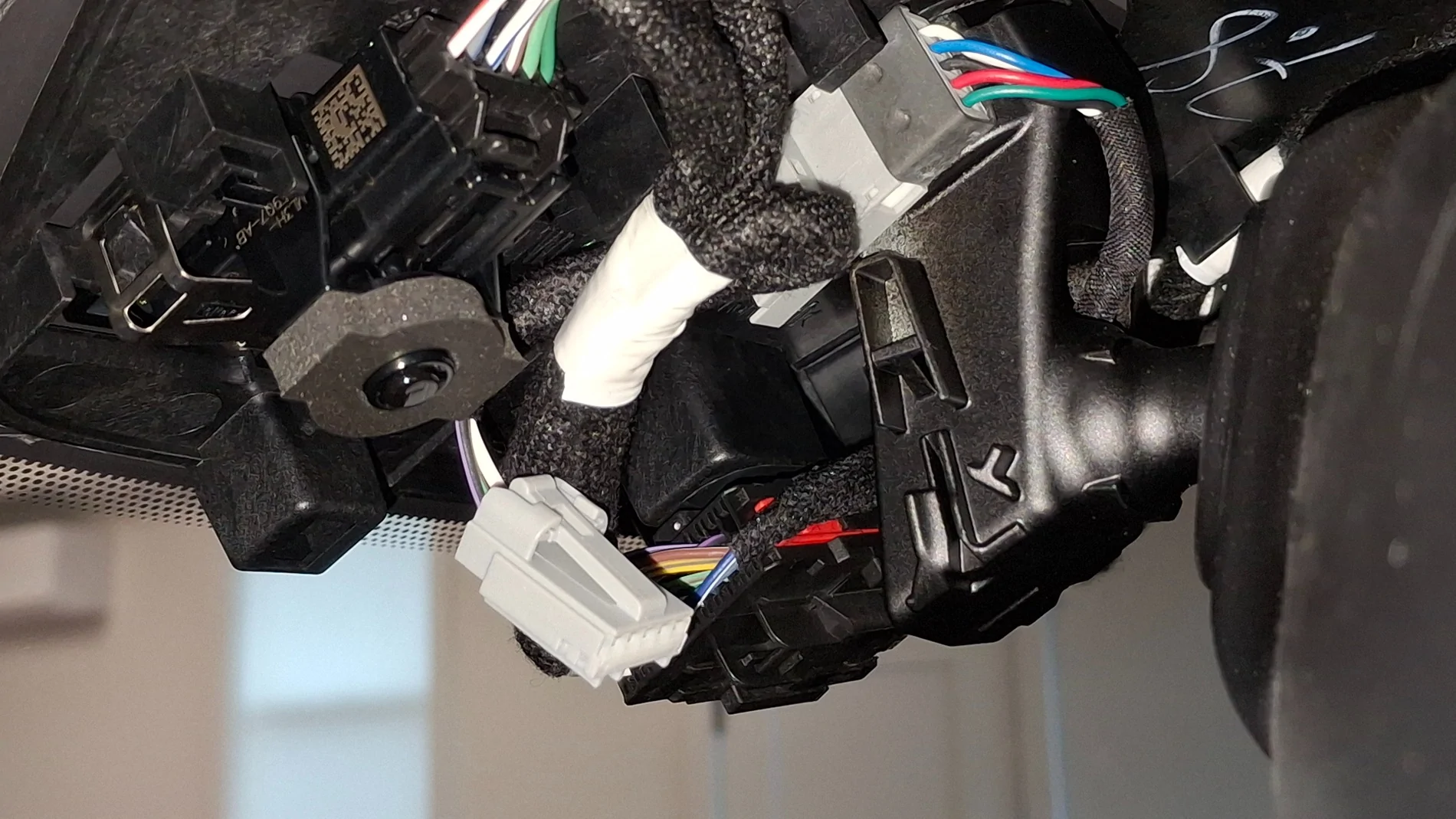

Hi, Great thread - I easily removed the 2 piece plastic mirror surround and located the 5 point pin on the left (drivers) side of the rear view mirror. My problem is how do you remove the plug/pin and secondly how do you get them apart. A bit paranoid about breaking, any guidance to achieve and fit the Dongar would be appreciated. I questioned Dongar on the correct model fit and they have asked for pictures of the 5 pin. Thanks, help appreciated!

I actually managed to get it off, I believe the right 5 pin end, here are the photo's.
