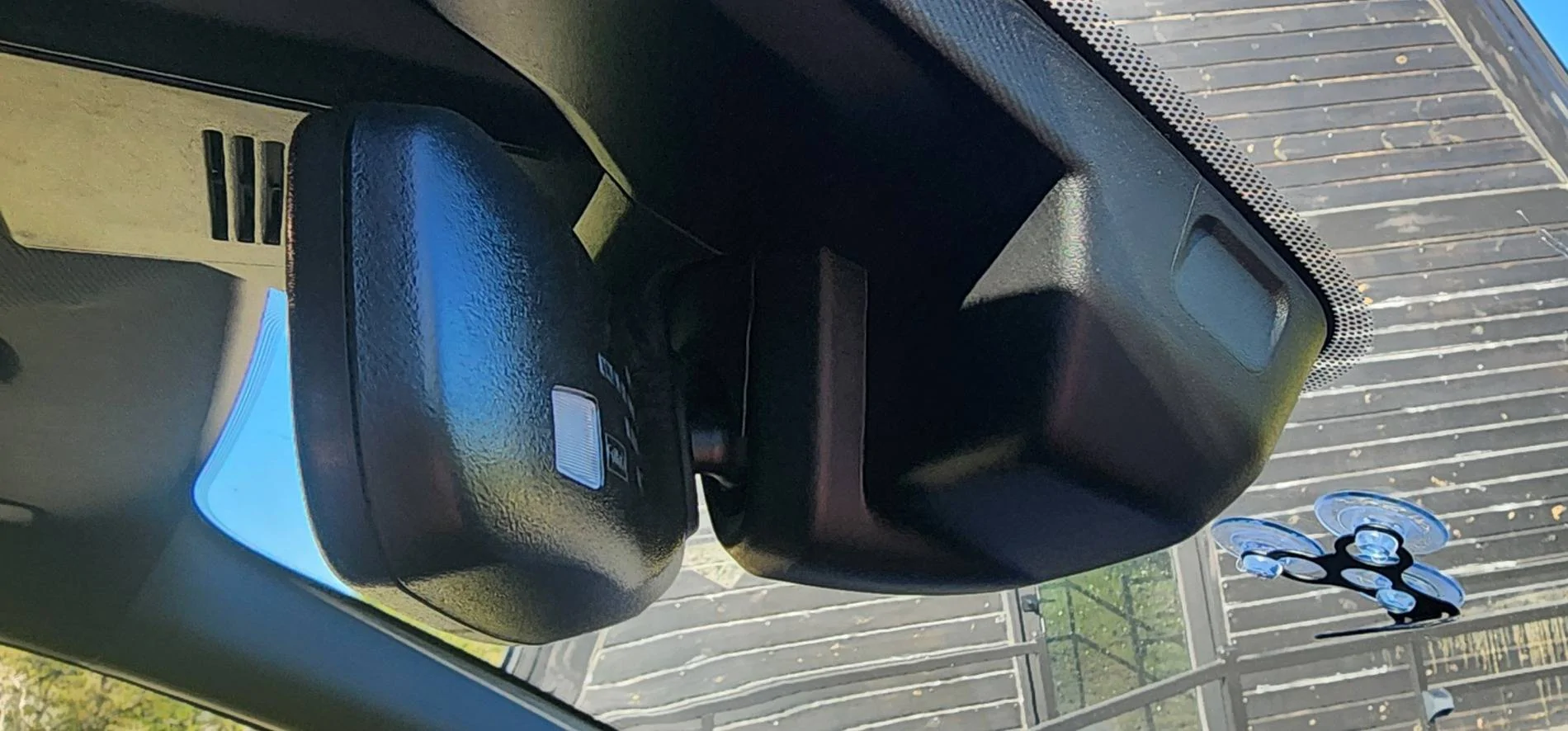

I'm new here and I know this thread is old...
I just wanted to say thank you for posting this helped me out with my new Ranger Raptor I purchased last week!
I have one question just how thin is the blendmount compared to the Amazon ones that are similar? My mount is only a few millimeters thick, but it's too thick to use the rearview mirror. The mirror is no longer adjustable...

I've been using a blendmount with 4 different vehicles now. I've never had any issues with being able to maneuver the mirror.

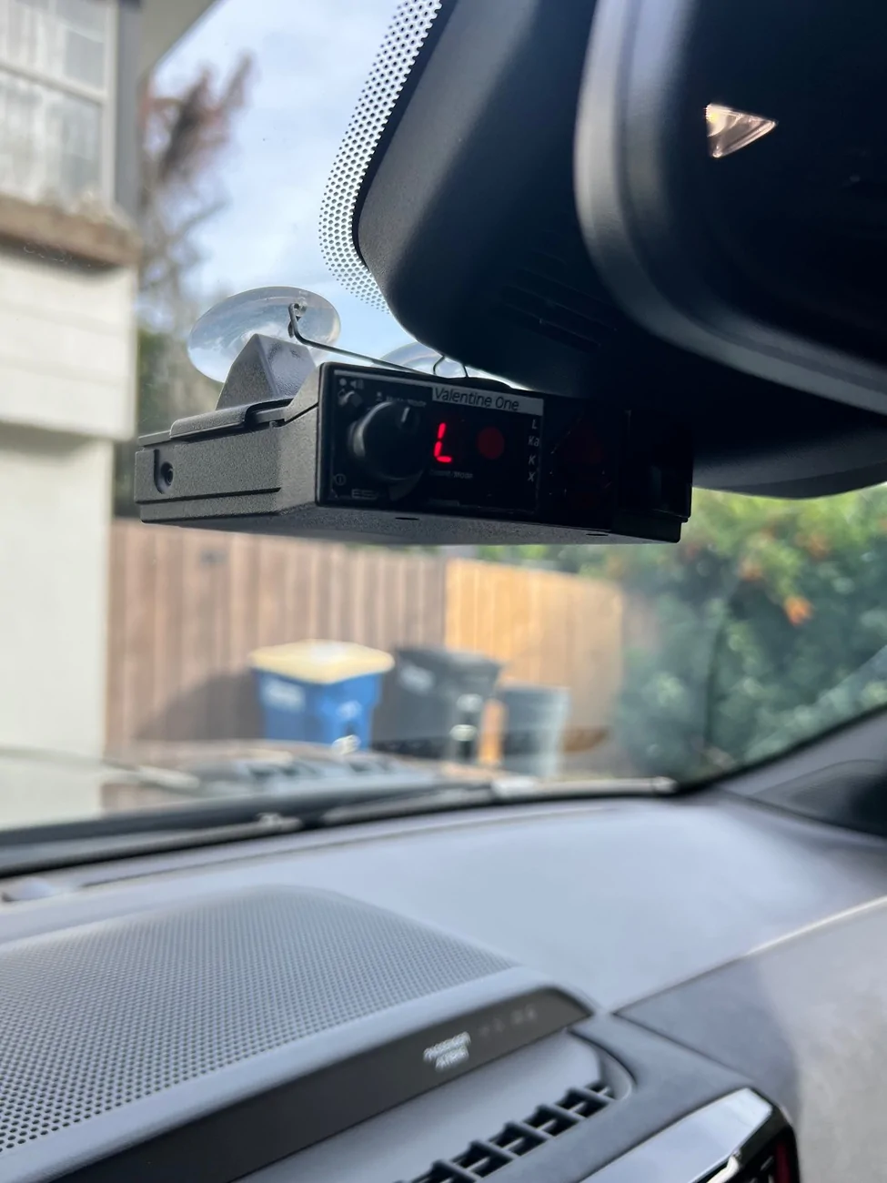

Thanks to the info on this thread installing my radar detector install went smoothly with one caveat.
That being until I get a Blendmount I'm stuck with my radar detector taking up my dashcam area. I have a mount similar to to Blendmount that I've been able to use in three different vehicles. Unfortunately my Raptor's mirror doesn't have a post to mount to. It looks like the mirror just has a ball joint with minimal space...

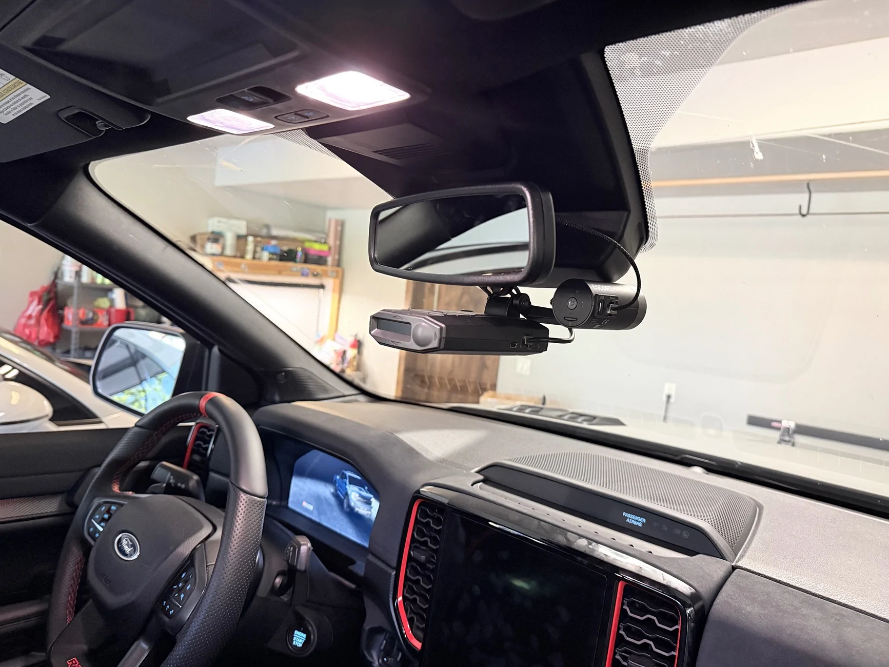

You can get a skinny blendmount in there, unfortunately only one. I custom spliced two blendmounts together so I could have both my dash cam and radar detector on the mirror. But I'll likely get a Trackform mount and move the radar detector to the dash.

I had a few Blendmounts from other vehicles and pieced together one that works with my Escort and cam. It sits out from the windshield a little further than I’d like, but I like that it’s pretty close to the mirror. Only took about 10 mins to get the shrouds off, wires tapped and put back together. Getting a mount to work was a pain.

Added a third blendmount section and now it’s in the perfect position.

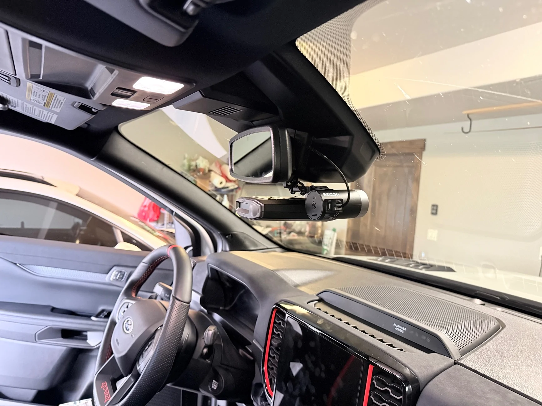

Appreciate you guys posting how/where you mounted the bendable rear window bracket from The Dashcam Store.
Combined that idea with a 3D printed bracket I saw someone made for a Tundra. There is a roughly 2" wide slot in the frame directly above the rear sliding window in our truck that looked like the perfect spot to hang a Viofo A229 Pro 2ch. I tested opening/closing the window with this in place a number of times, and I did not notice the glass touching or grazing the bracket at all.
It sits tight but didn't snap in place how I intended so I used a small strip of 3M VHB tape where the underside of the bracket sits on the top of the window frame. I hate rattles so hopefully this keeps it quiet.
I'll throw the model up on thingiverse if anyone is interested. It isn't the best or prettiest design, but I think it works! Printed out of PETG so I think it should last.

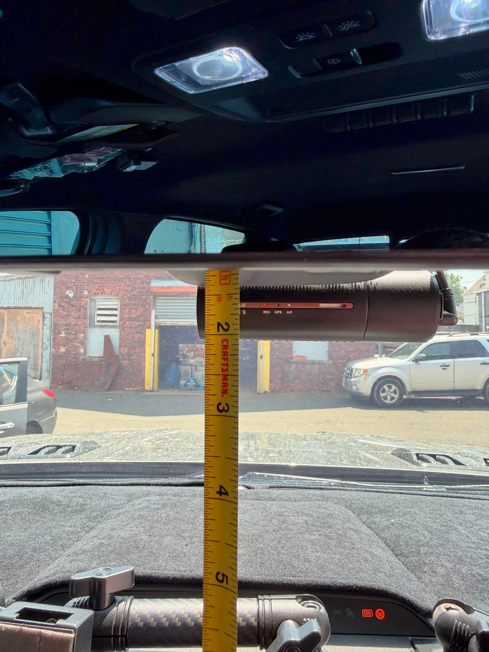

For those who have the blendmount for the radar how far down does it put the radar? I have my dashcam mounted on the windshield and it looks like the cam would block the radar view.
I put a tape measure where the blendmount would go and you can see two inches down my dashcam is there. I wonder if there is a way to extend the mount down for the radar.
