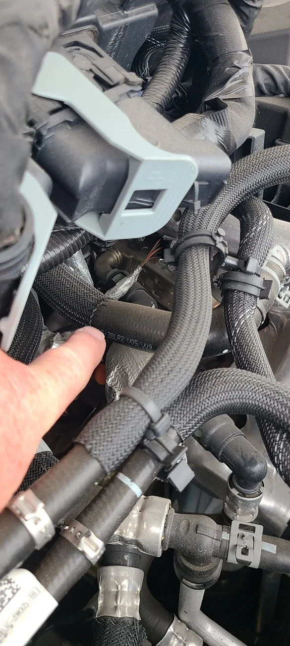

Ok. Got pics and shot it with a temp gun
147 on outlet hose
162 on inlet hose
Took pics to show exactly where to shoot.

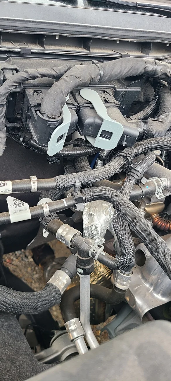

This.is how my engine bay is set up with hoses under the ecu
Ford Ranger Request for heater check on your XL? 20260122_105804
Here is where i shot the top and got 162
Ford Ranger Request for heater check on your XL? 20260122_105910

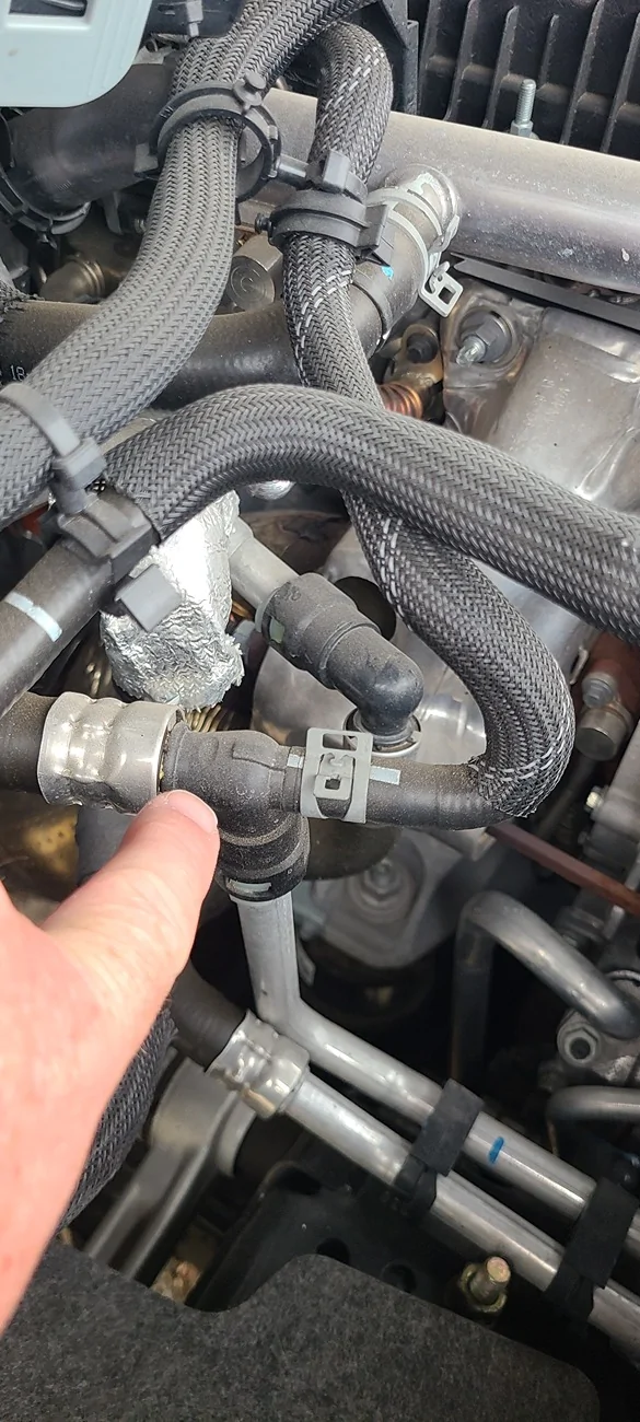

This is where i got 147 (lower hose at t)
Ford Ranger Request for heater check on your XL? 20260122_105905
My fingers are pointing exactly where to aim
