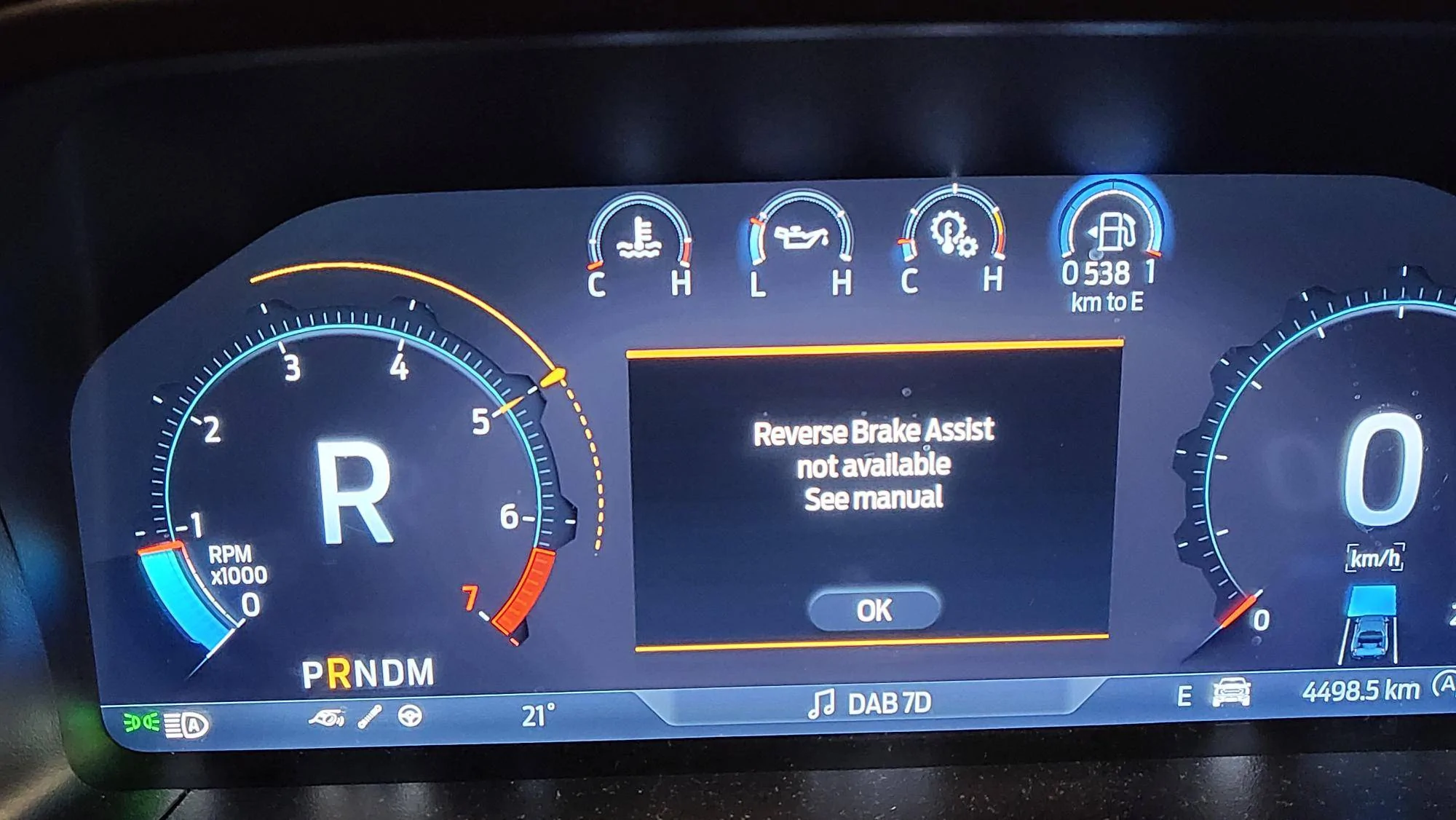

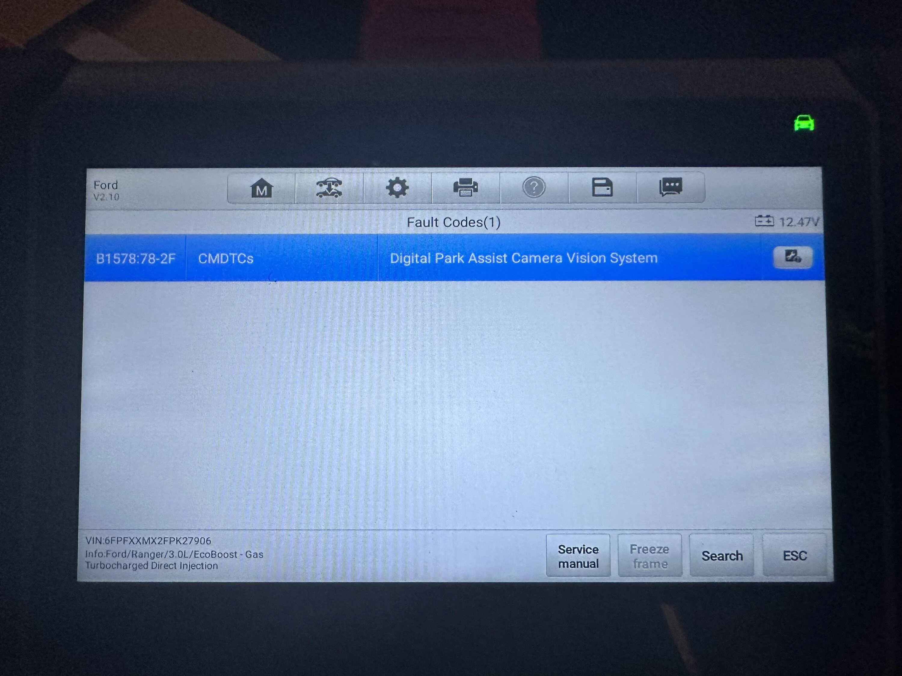

Just started getting this message on my new Raptor... there are loads of such posts affecting the F150 model. I have tried the drive at speed and all doors etc are closed. DTC code and info is attached...
It means the Radar on the rear does not work...
Any help appreciated..

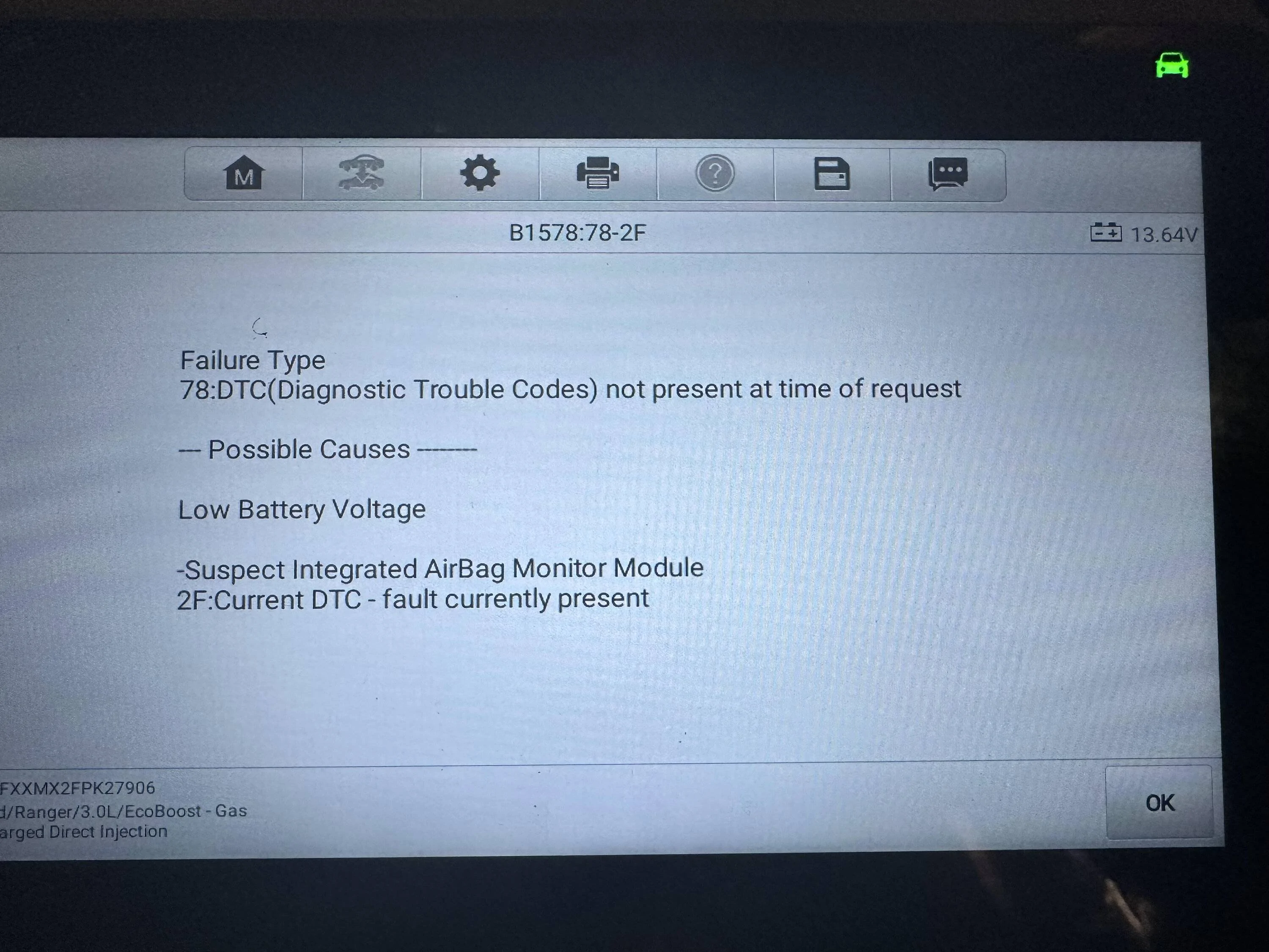

Be careful if using an Autel to read DTC codes…. The code was right on my scanner but the description was wrong…
