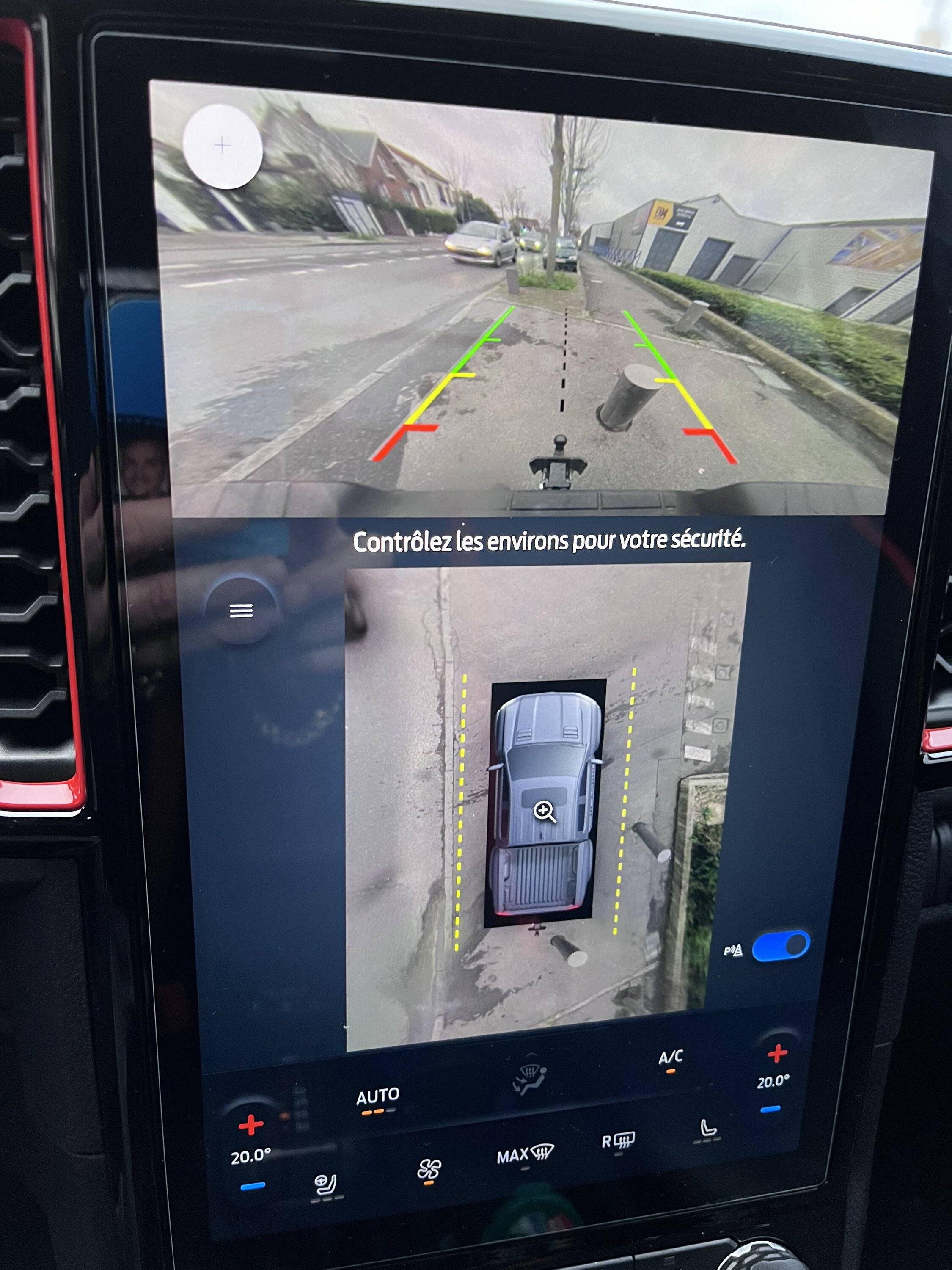

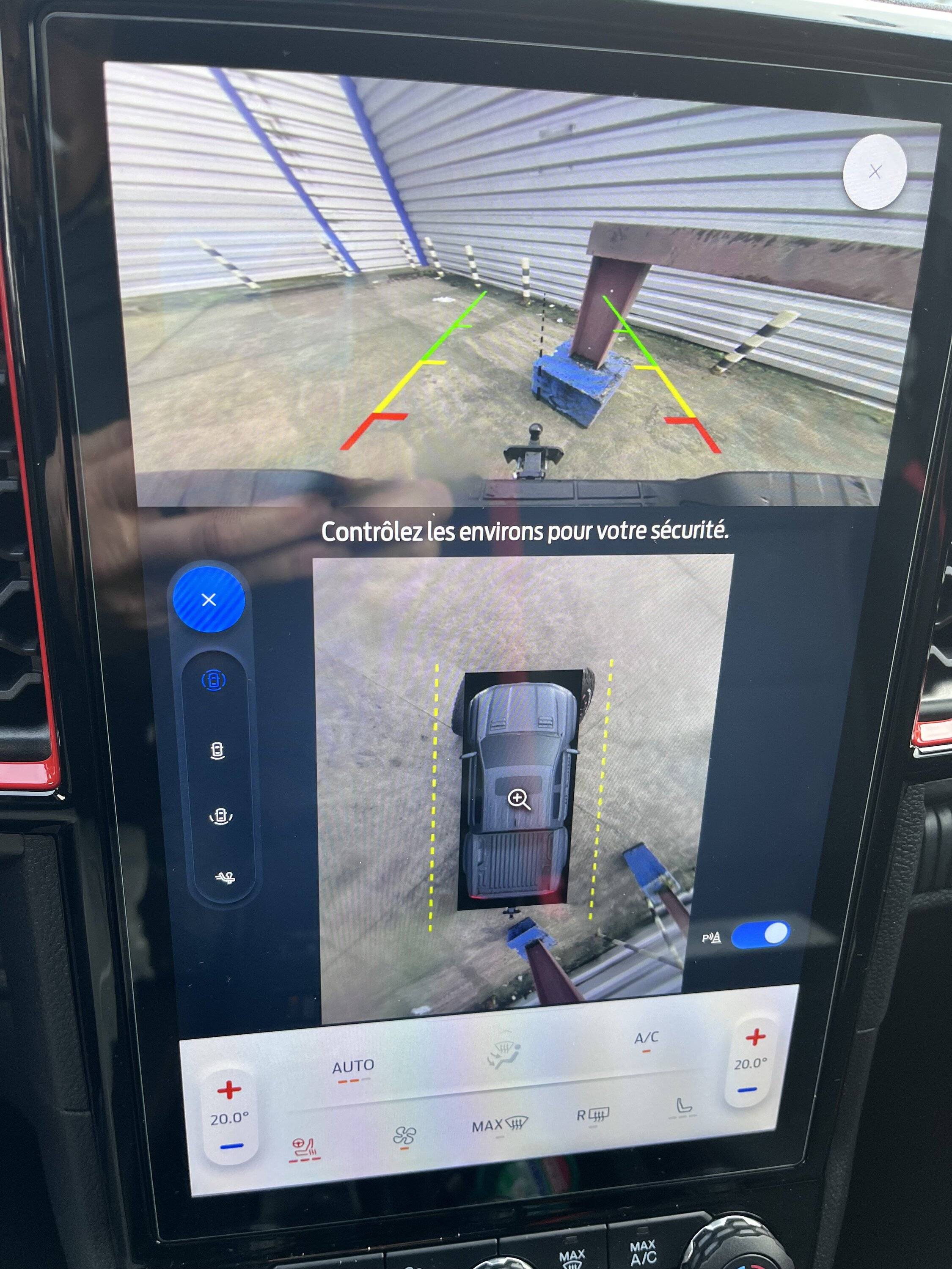

Hi everyone I am in France and I have the same problem with the rear active braking system but it is not only the problem that the rear radars often do not detect small poles and often also problems in the corners which does not detect from time to time the same with the front camera it works when it wants to park I don't think the problem is normal as soon as it rains it gets a little dirty and it no longer works it's not normal, even cleaning it doesn't work every time either

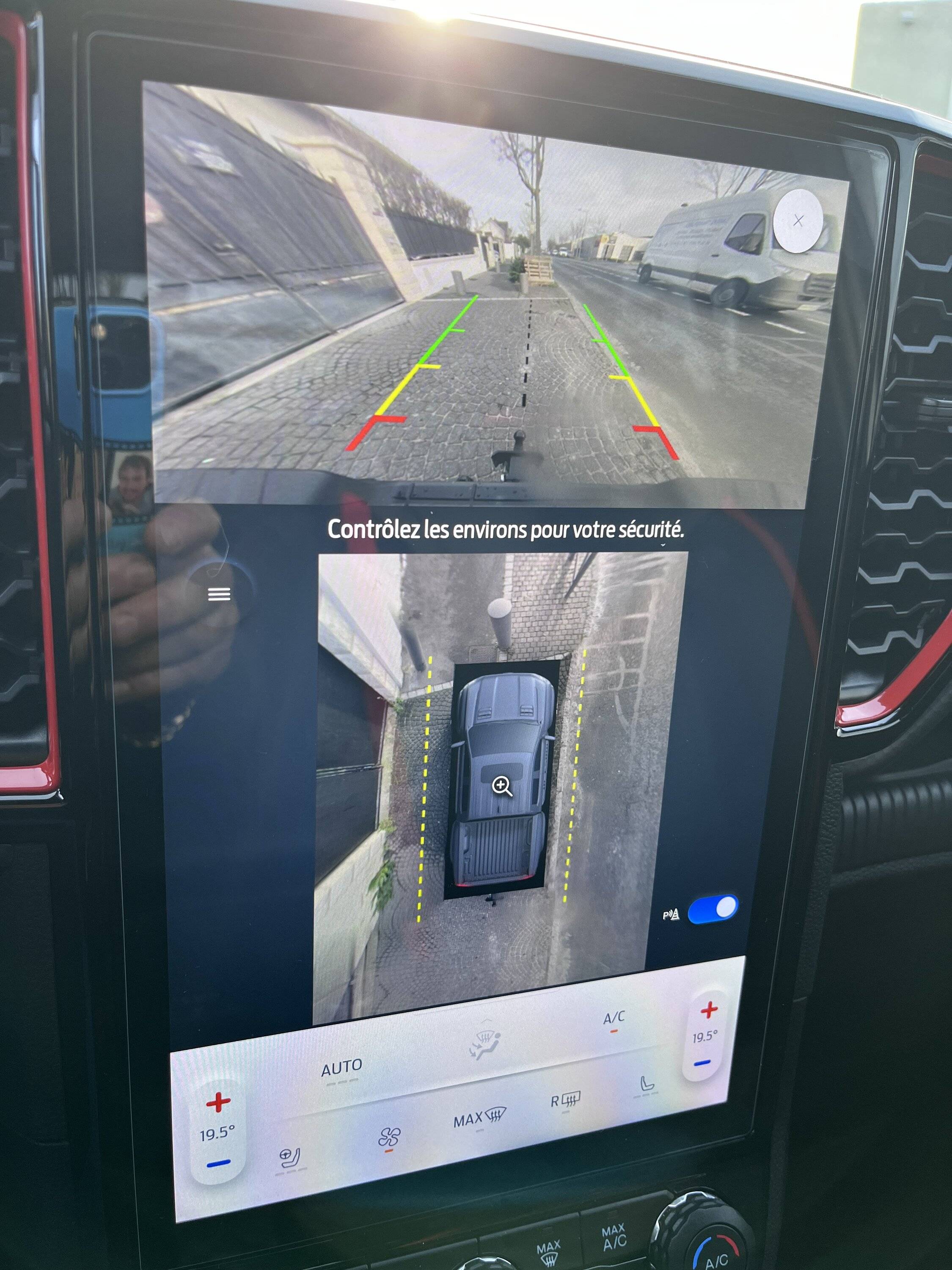

thank you for your answer I hope that in France we don't have any supply problems I must be one of the rare ones to have this problem I wash them this morning but it's always the same and I notice that the detectors in the corners don't work no, it's a shame that things like this are missed

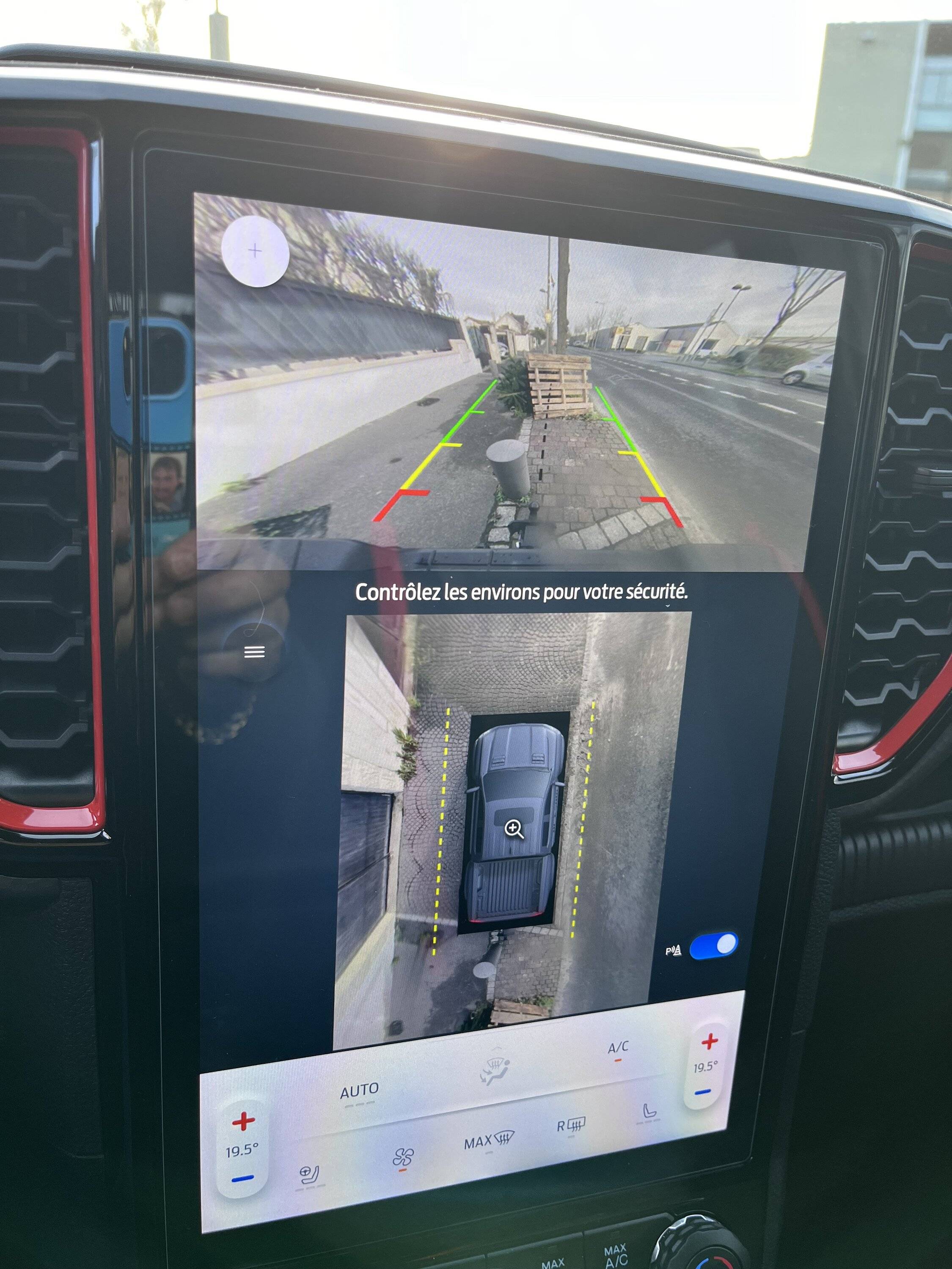

Good result
Ford recalibrated the rear camera
Partly it works
Except that the front and rear radars do not detect small posts
It’s frustrating to have radars that don’t detect small posts
Ford Ranger Reverse brake assist not available IMG_2640
Ford Ranger Reverse brake assist not available IMG_2639

hello Joules I have an appointment at the end of the month I hope they can recalibrate the radars themselves? I also have a problem with closing and opening the windows with the remote control. I always have a window that doesn't want to go up. It's like the ambient lighting. It often deprograms itself. I have to put it back on when I go. in the menu!!! finally lots of ridiculous little bugs my good I like when they all work my biggest problem remains these parking radars

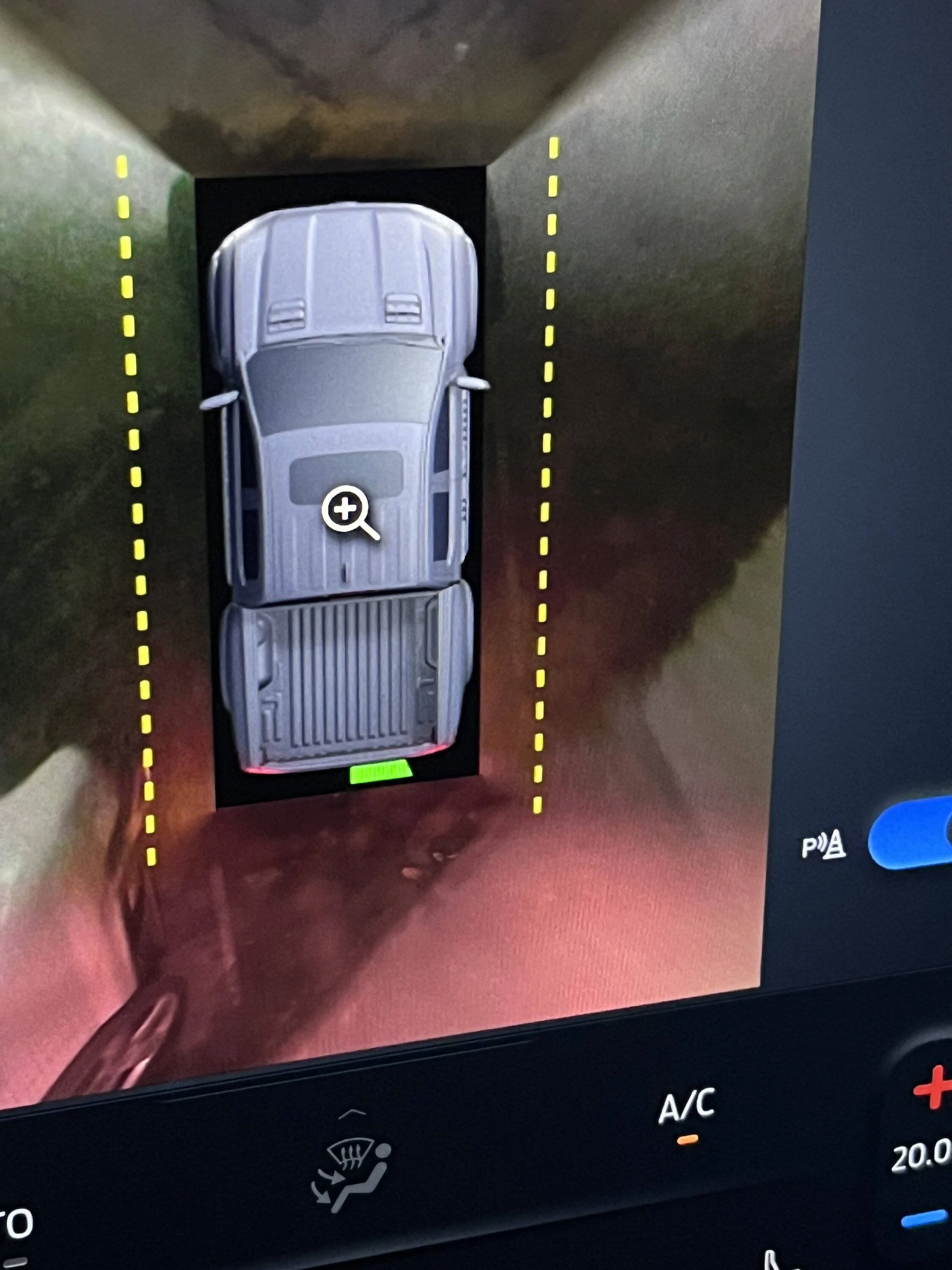

Hi everyone after visiting the engineer and different tests we noticed that there is indeed a configuration problem on the radars except those who cannot enter the settings for the moment the information must go back to the design office for which may have a fix afterwards either there will just be an update or an intervention by Ford I think it will take a few months before it is resolved so for new Raptor owners do tests with your parking radars center you on a small front and rear posts
