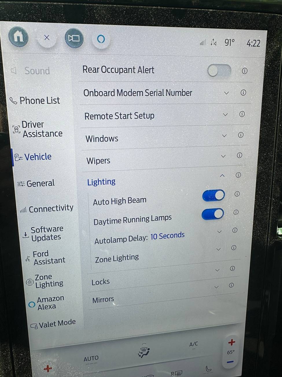

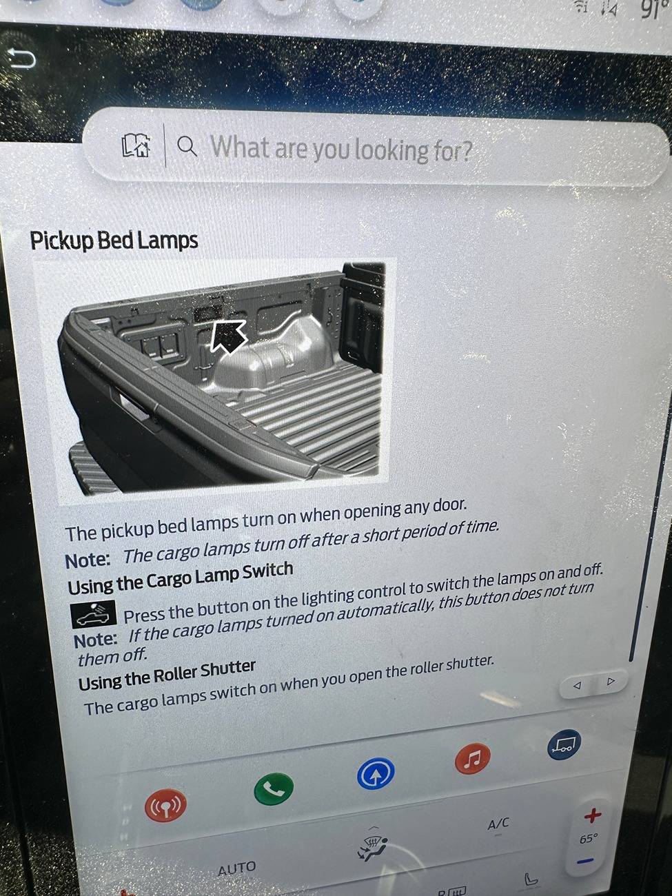

Yeah I just went through every setting in the infotainment system and there’s no mention of bed lights. Sucks because it seems like such an easy thing for Ford to program.
Agreed. this is pretty annoying. why have bed lights if the only way to turn them on is in the cab where you can't see them when you flip the switch. Wouldn't mind an after market switch since there seems to be no way to have it come on with the doors. It's not even part of the zone lighting, which would have been okay if it turned on the bed lights, except zone lighting too is gone from the app and who knows if they will ever put it back.
