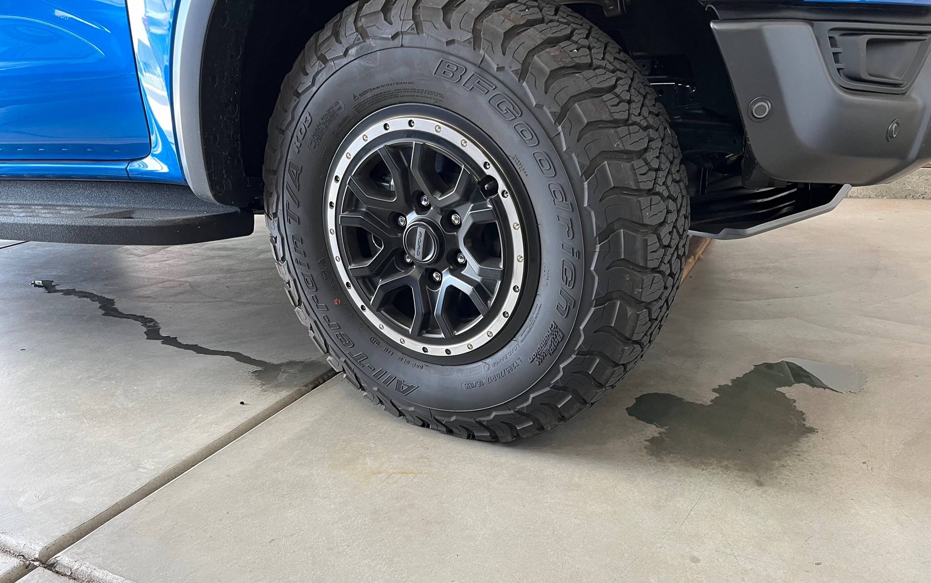

RR washer fluid tank leaks at the top when filled?

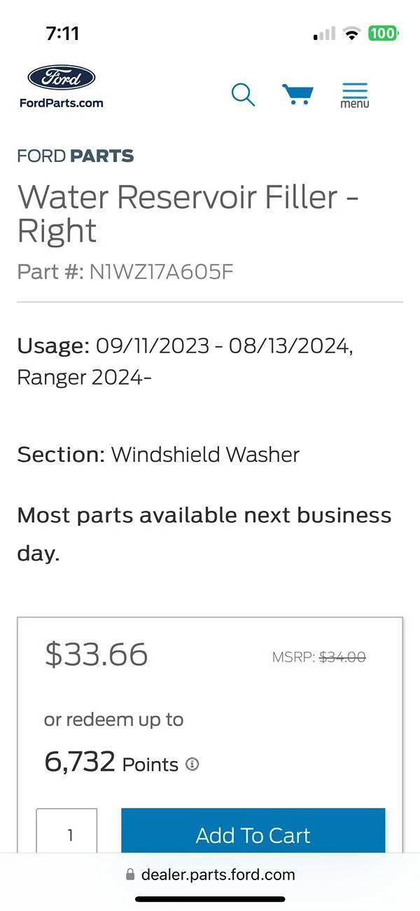

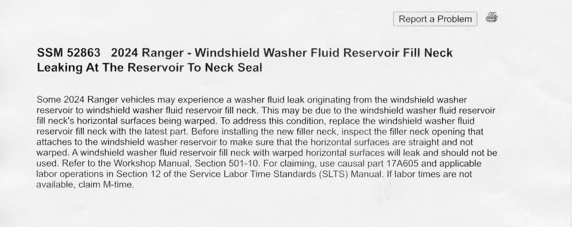

Because I have to go there, wait in their customer waiting dungeon while they actually install it, and drive home, a big waste of gas and my time. Like many RV repairs, if you aren’t willing to do small repairs yourself, you should never have bought it in the first place. The last time the dealer looked at the leak, it was during a scheduled service. It is simply not worth it to me to do this as a separate job. I could combine it with my next service, but the service guy will say, we will have to order it under warranty, and you can come back to get it installed.
I should call him and see what he says….. if I can actually connect. Their phone system is a mess..,,

As long as it makes sense to you i guess. Difference in Dealers matters. I called mine yesterday at 3.30pm about the leak and he said to come right in. Was there 10min later and they pulled it right in at 3.45. Sat in the owners office and shot the shit with him for an hour, drinking his coffee. Rolled it back out at 4.45 saying they ordered a new washer tank. Easy as pie and all paid for.
