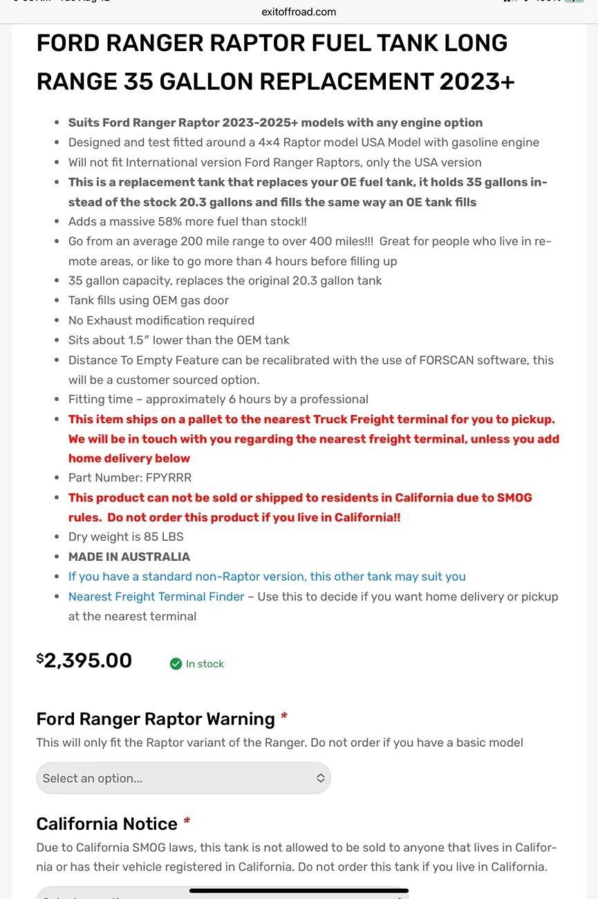

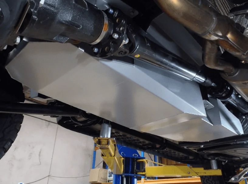

Has anybody installed a LRA tank yet? Looking at their site, they are emissions legal except California. They reuse all the original emissions stuff including the original fill location. They are very stout steel and internally baffled and do NOT require an additional skid plate. Considering the price of a replacement Ford plastic tank, the cost is quite competitive, if you install it yourself (six hours of labor!)
The weight of a full tank is considerable, the extra 15 gallons is 95 pounds, but obviously as you drive that goes down, and it is carried very low down. You can always partially fill it if you want to. You don’t have to carry all 35 gallons, except when you need that extra range…. I really hate carrying fuel in jerry cans. Does anybody know the weight of the Ford tank? I can’t find that spec - the LRA tank is 85 pounds.
Plus you can always sell your used Ford tank and get back maybe $1000.
FORD RANGER RAPTOR FUEL TANK LONG RANGE 35 GALLON REPLACEMENT 2023+

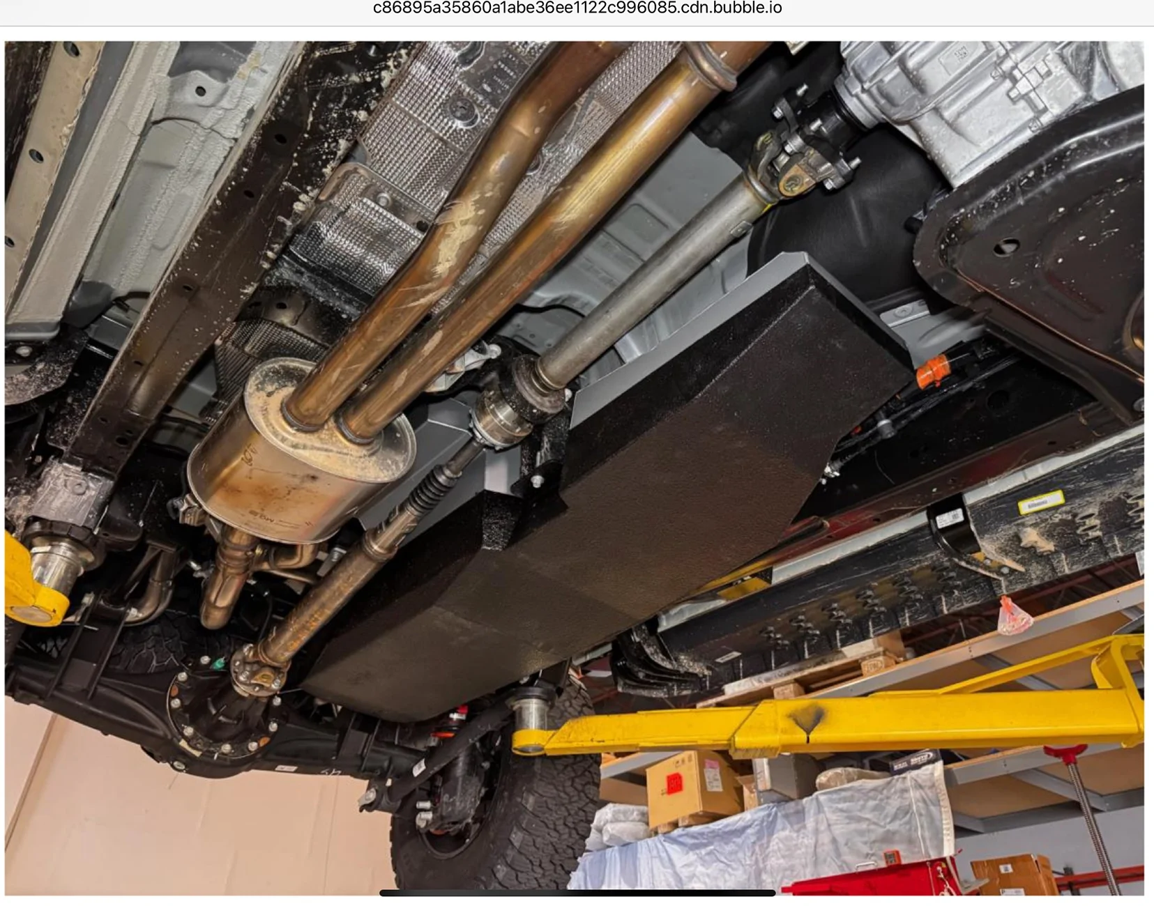

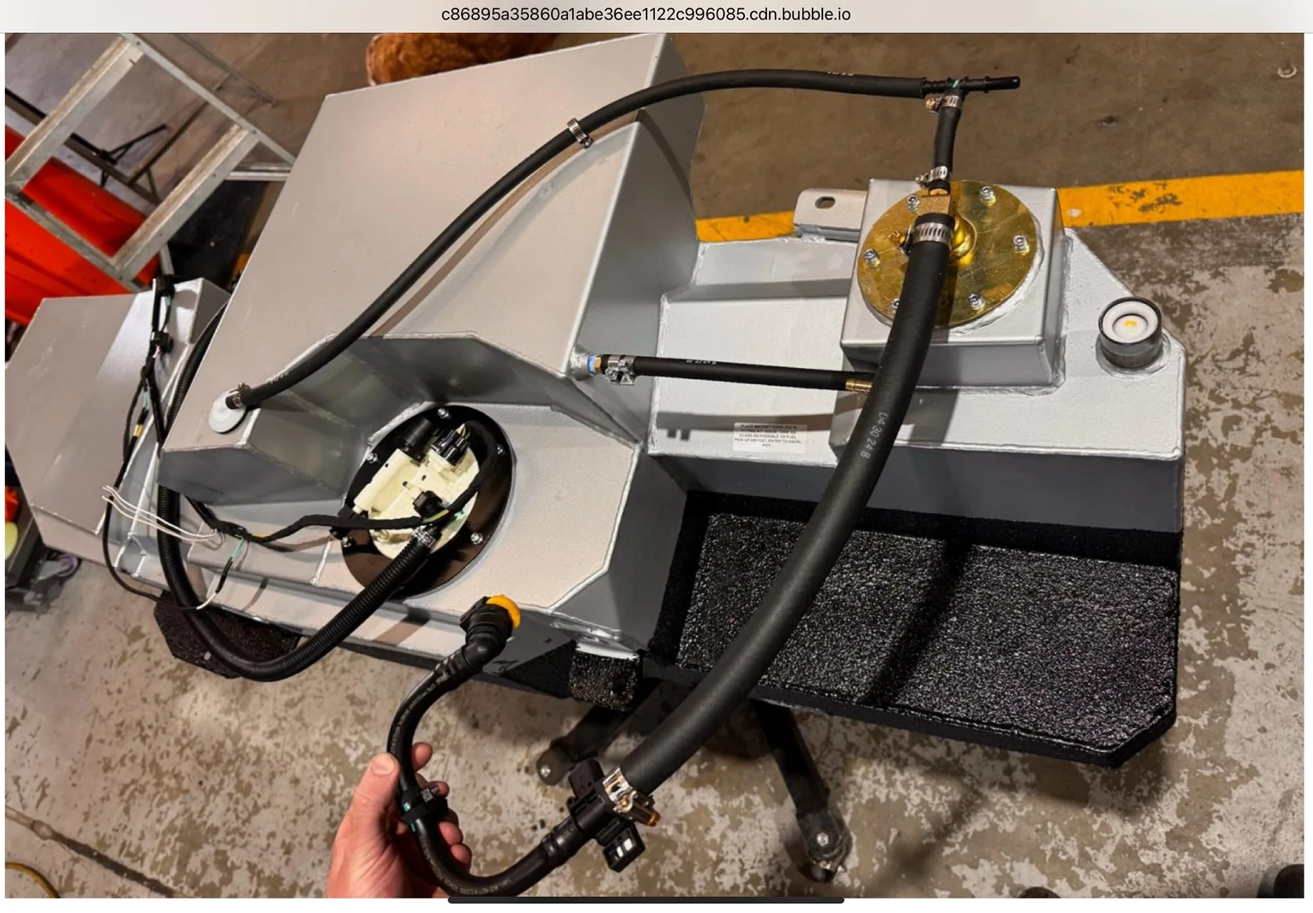

I emailed Exit Offroad, they sent me a link to the instructions.
2023+ Ford Raptor Ranger 35 Gallon replacement tank instructions Product Information/Install Instructions for Kit P/N FPYRRR 2
It appears that these ship with the bottom part coated in bedliner or a similar material.
I wonder how these handle a serious collision, I expect that they would take out the nearby components more than the smaller plastic tank would.
The next to last step before fully tightening the mount bolts is “fill with gas and check for leaks”. So if you do this at home, you need to have 35 gallons of fresh gas handy. That complicates things.

Nice touch adding the bed liner
