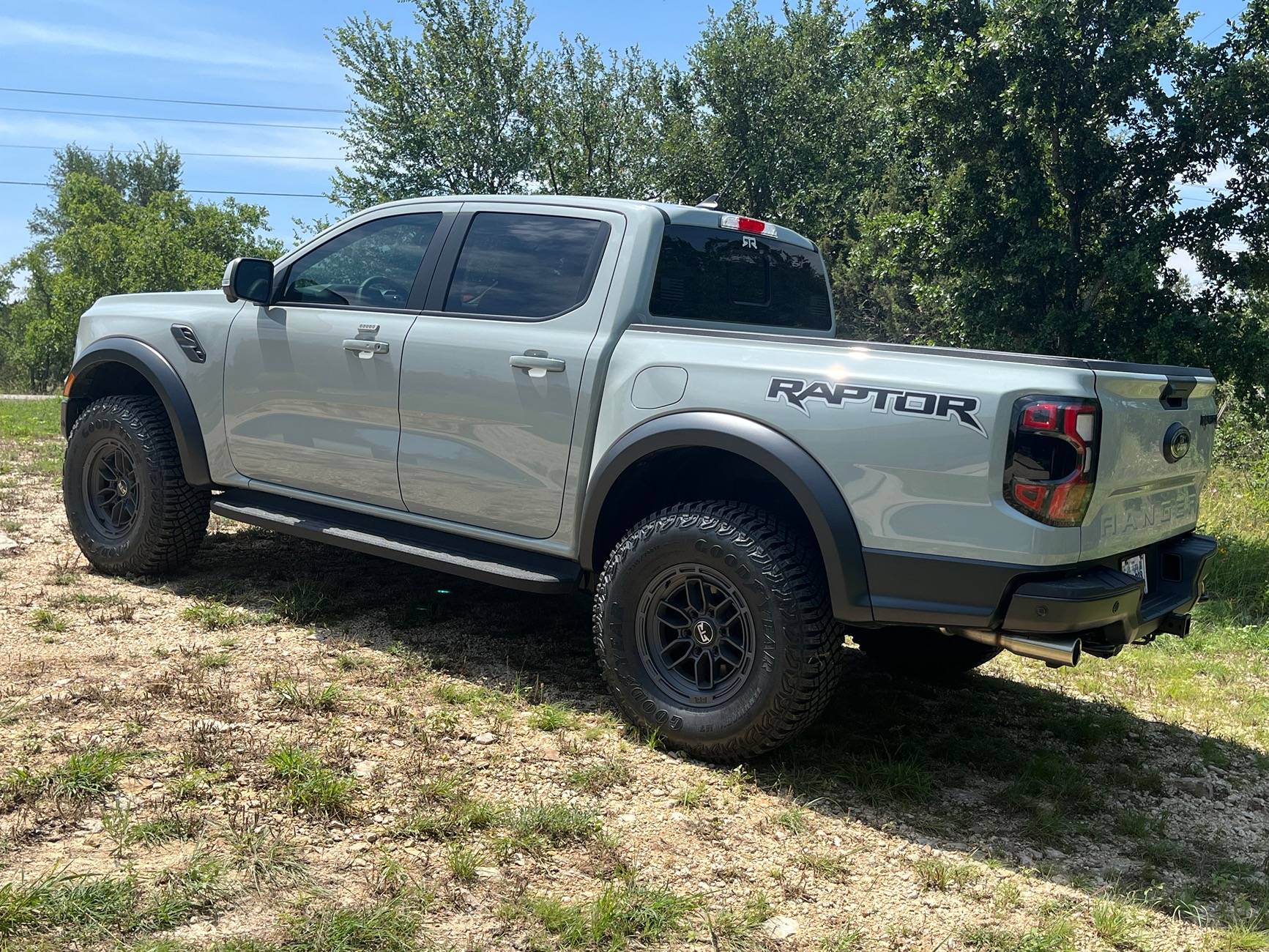

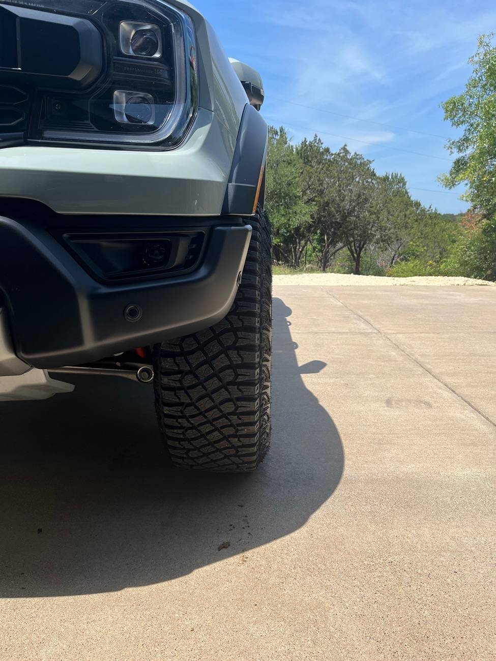

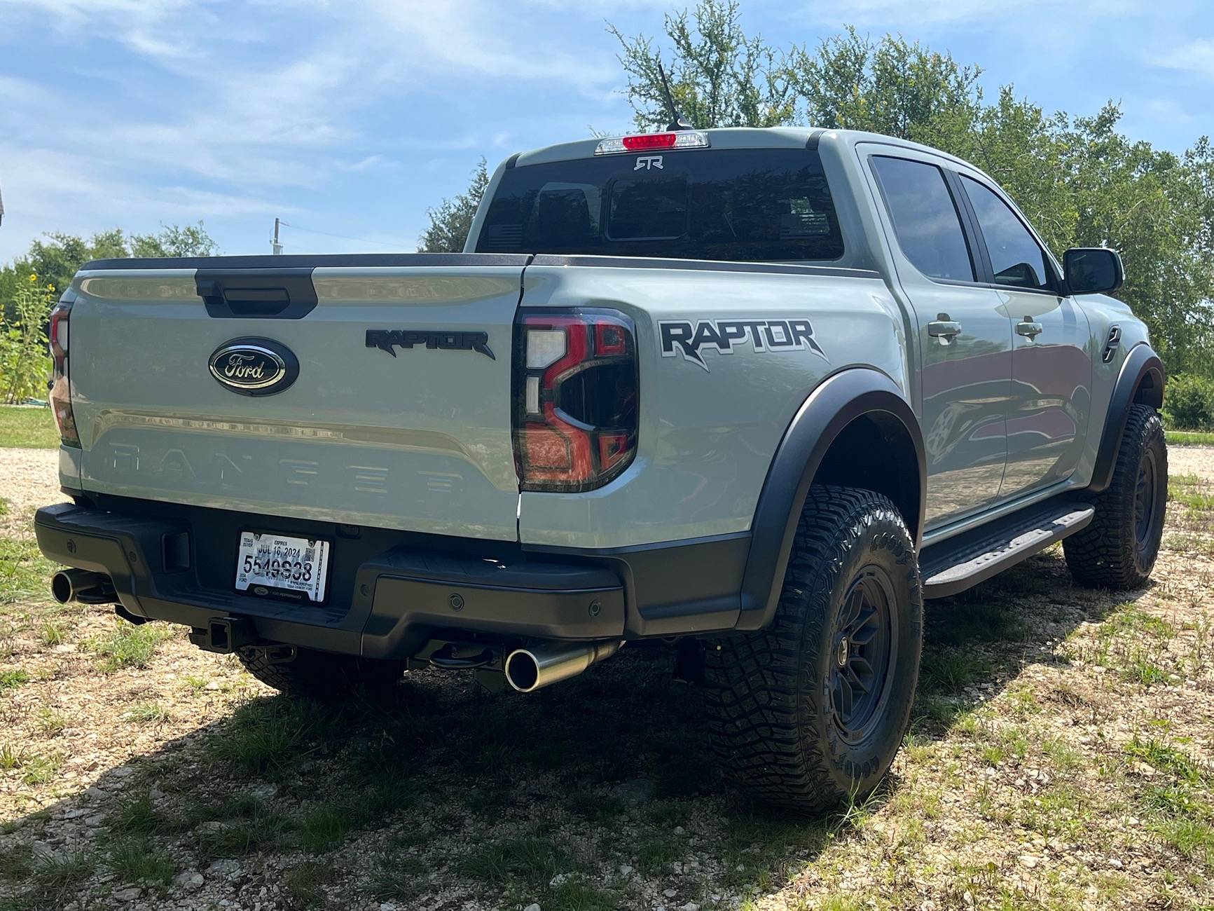

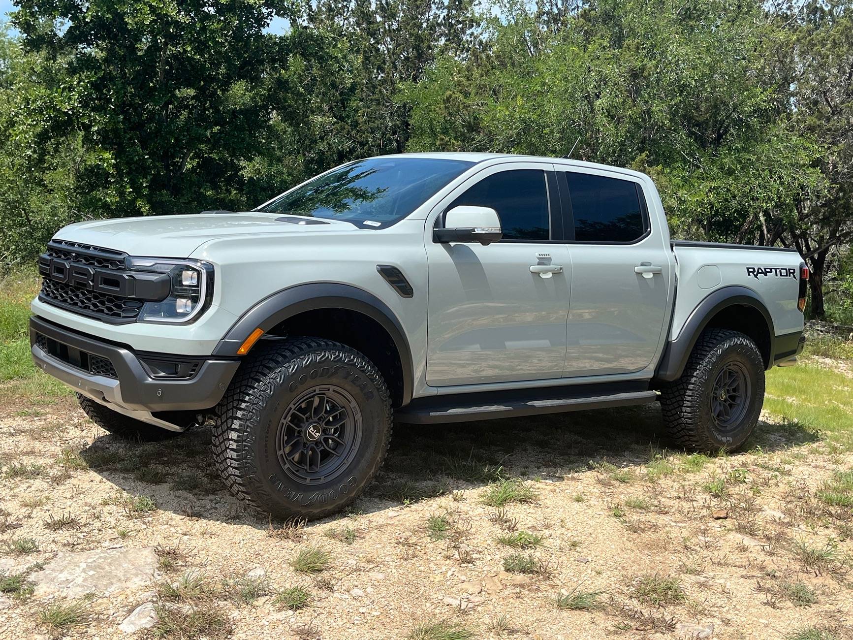

I finally got a chance to install my new wheels and tires this morning.
For reference, the RTR wheels (Satin Charcoal) averaged 22lbs each, and the Good Year Territory MTs (315/70/17 - load range C) averaged 54lbs each - 76lb total.
I did not weigh the stock beadlocks and K03s as individual items, but as a set, they weighed 94lbs.
I have not driven the truck enough yet to know how much differently it may handle. I’ll report back in a few days - I’ll also see if fuel economy is impacted.

Looks awesome! Did you raise the front end, and/or have to trim anything / remove crash bars?

Thanks!
I have 1 1/2” Foutz perch collars. The tires barely clear the crash bars at full lock…

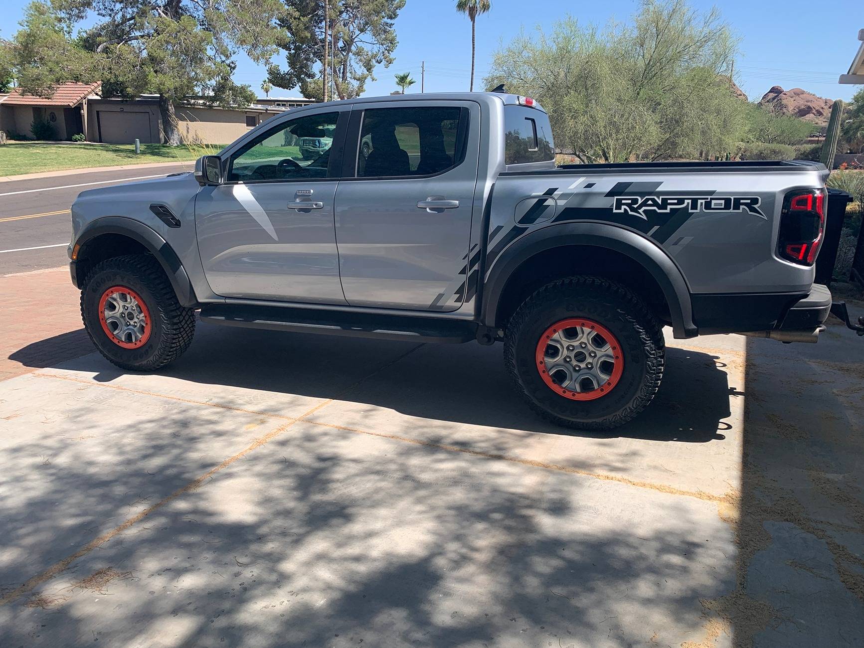

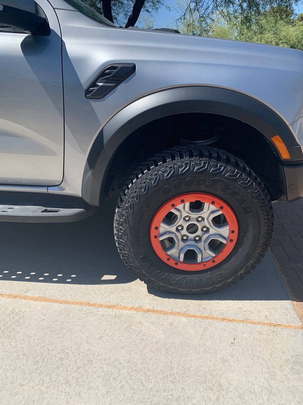

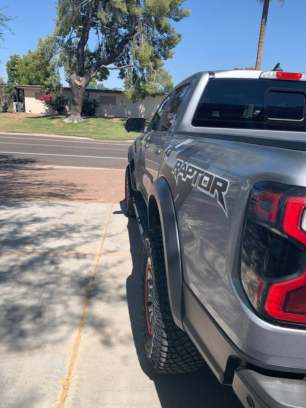

Foutz put the 2.5' perch spacers on this morning. Less than an hour. Bronco Sasquatch Rims with 315 Goodyear Territory Tires. No clearance or rubbing issues.
Ford Ranger RTR EVO 6 - 17x9 +30 wheels with 315/70/17 tires on Ranger Raptor IMG_3826.JPG
Ford Ranger RTR EVO 6 - 17x9 +30 wheels with 315/70/17 tires on Ranger Raptor IMG_3825.JPG
Ford Ranger RTR EVO 6 - 17x9 +30 wheels with 315/70/17 tires on Ranger Raptor IMG_3824.JPG

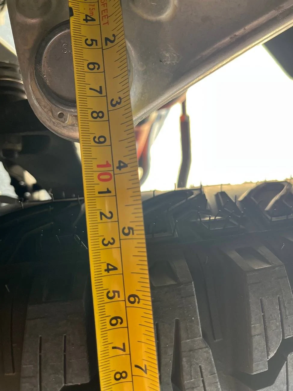

Would you have a picture of how close yoru control arm/tyre so I can see please? :D

It’s tough to get a completely accurate picture since the top of the tire and control arm aren’t at the same height. The tape measure isn’t really lined up with anything - it’s just there for reference. My earlier post indicated about 1.5-1.75” of clearance, but I think it’s more like 1.25-1.5”.
Again, if you put 35x12.5s or 315/70s on the stock wheels (8.5” wide and +55), you’ll be about 3/4-7/8” CLOSER to the control arm. That’s a no go for me on a tire with this much sidewall.
Ford Ranger RTR EVO 6 - 17x9 +30 wheels with 315/70/17 tires on Ranger Raptor IMG_2238

Amazing thank you!
I have 315/70R17 on factory beadlock and they are extremely close hahaha, so i will be looking at an +30 offset wheel
