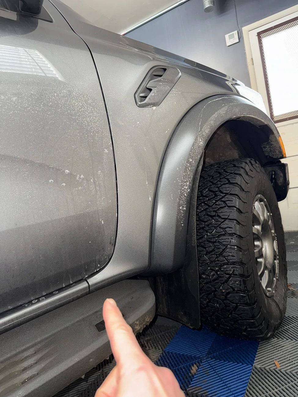

Me too! Also, there was one “nutsert” (threaded rivet) on the right side that was loose in the sheet metal of the pinch weld, and you could move the fender by hand and watch and hear it move. I squeezed the rivet a little with vice grip pliers to tighten it, and reinstalled that bolt with silicone sealer adhesive. No more squeaks!

Thanks to Topher & John for mentioning this. I had the exact same squeak sound and finally made time to troubleshoot. It was the rivnut/nutsert closest to the door that was loose in the sheet metal.
Went to the hardware store to make a cheap "tool" (6mm x 1 bolt, nut, & washer) and finished setting the riv nut so it was fully secure in the metal. All fixed!
The squeak was getting pretty obnoxious, glad it's gone.
