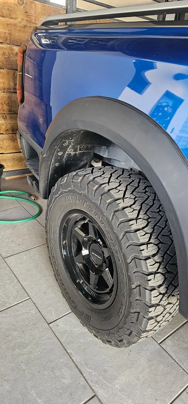

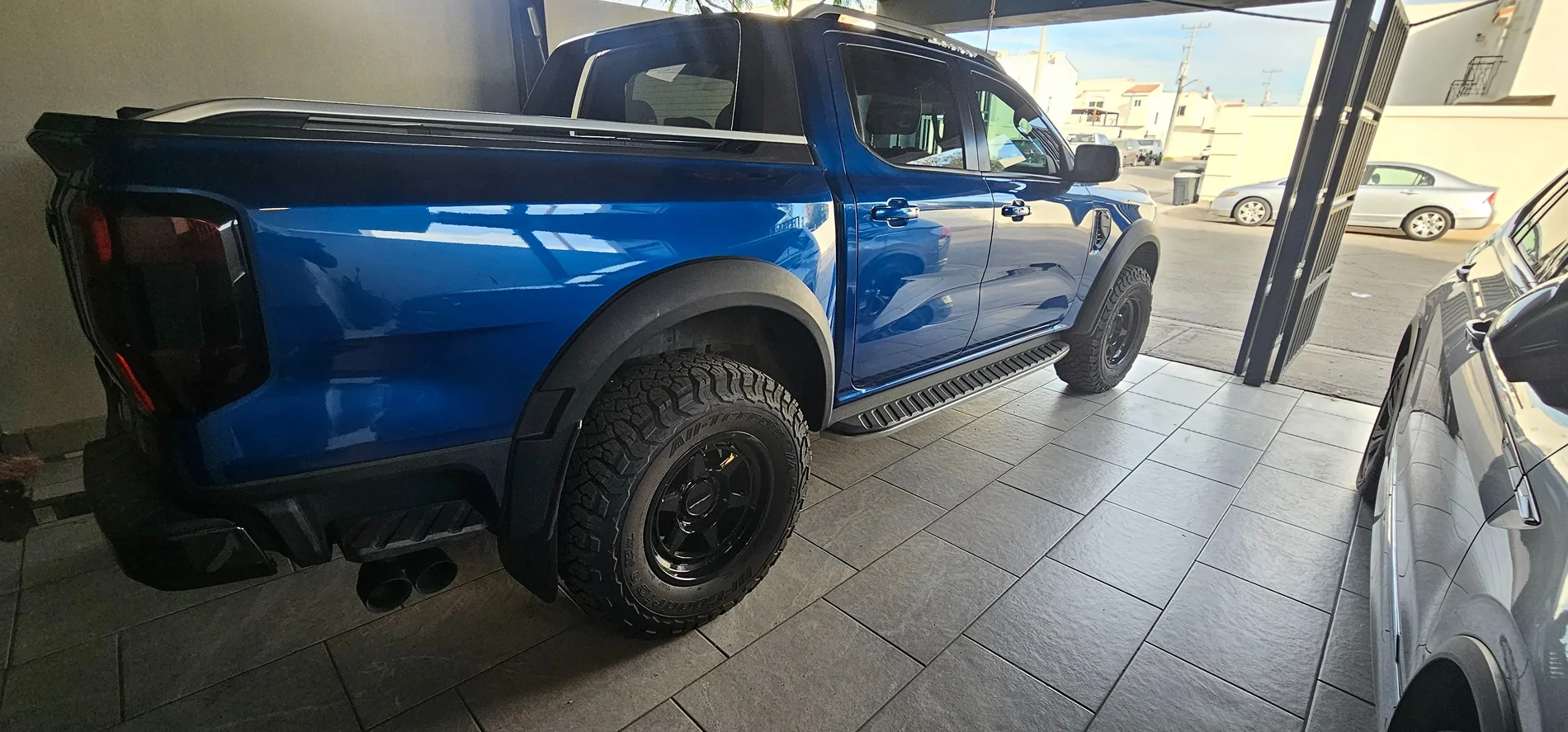

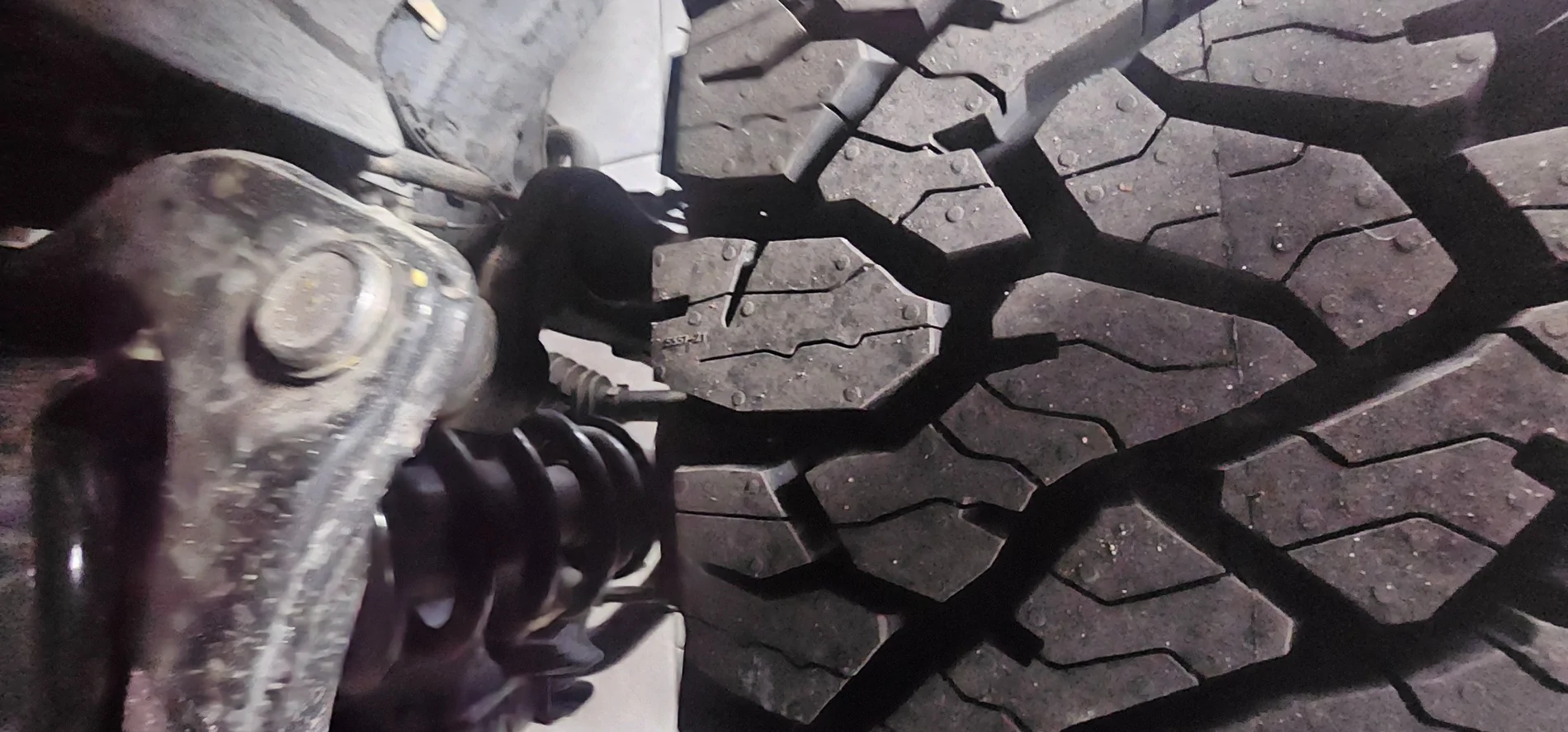

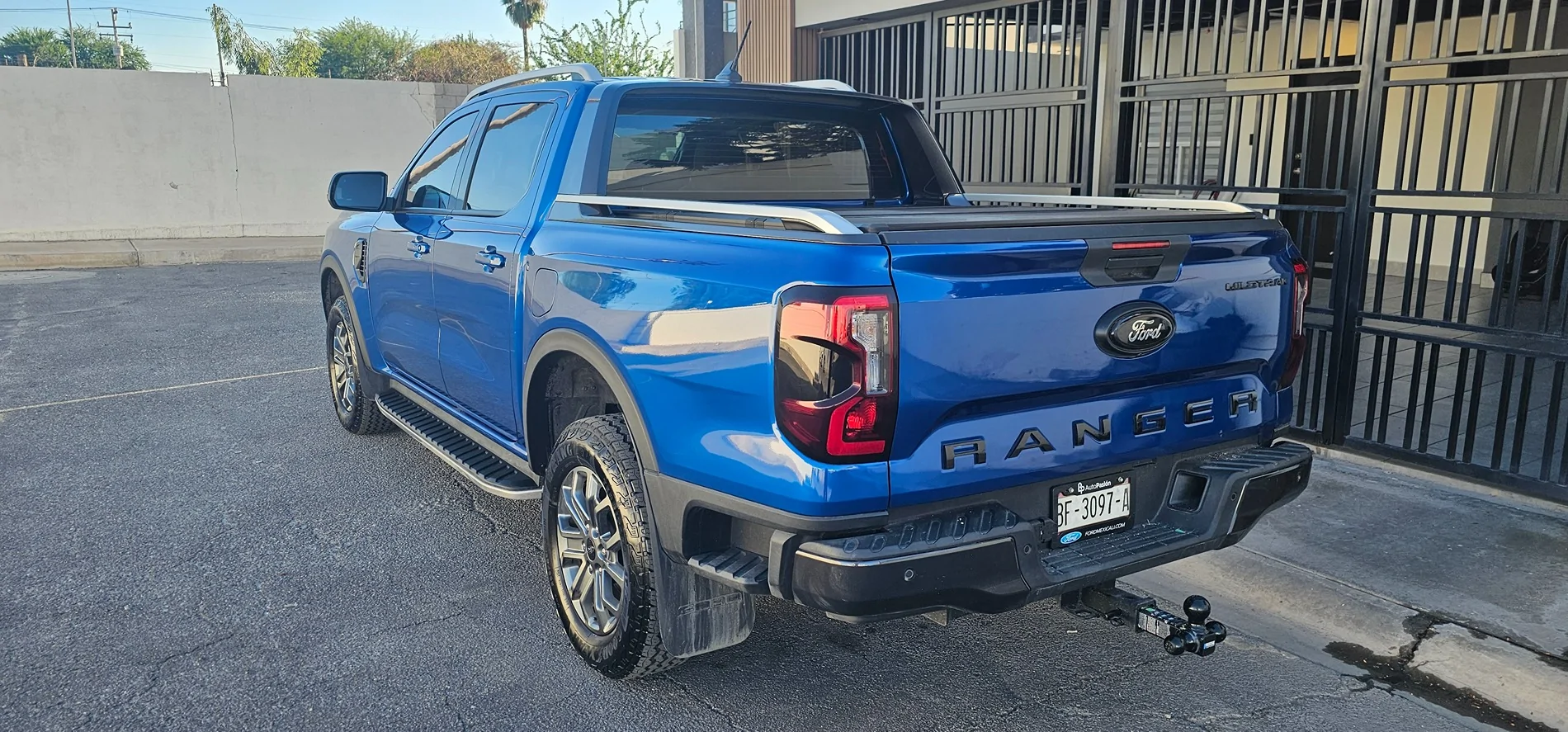

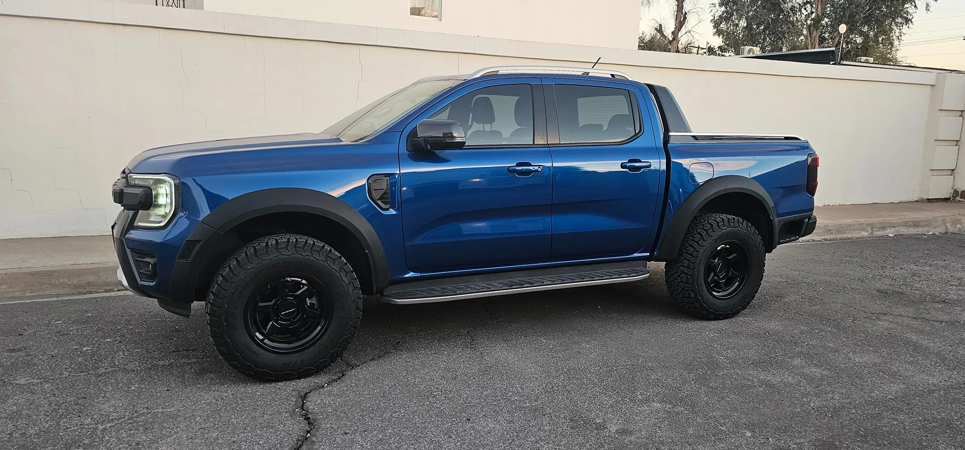

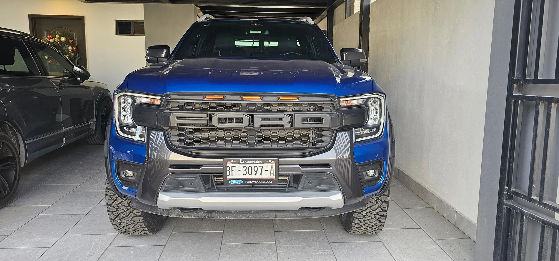

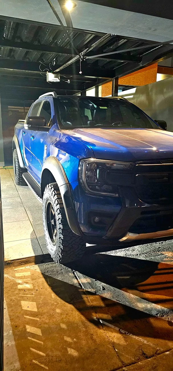

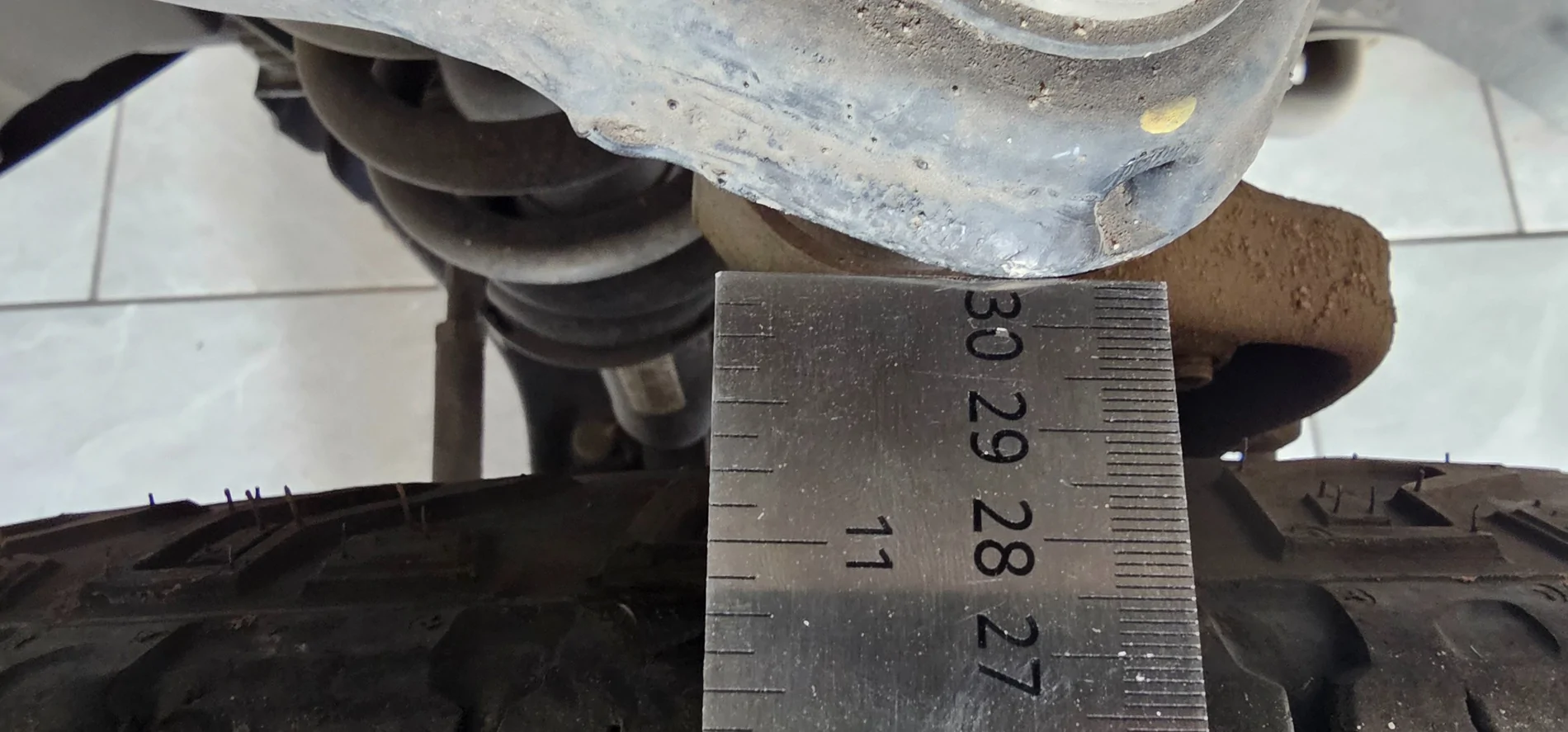

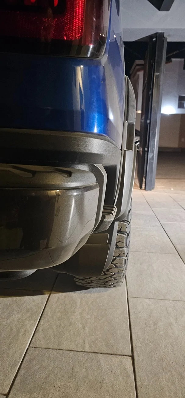

I went from 255/65/18 to 285/70/17 with methods 708 et 0 and BF Ko3 on a Ranger Wildtrak, I have to install a leveling kit (2inch), and trim a few of plastic, I dont have issues with the clearence of UCA (attached photo before and after)
