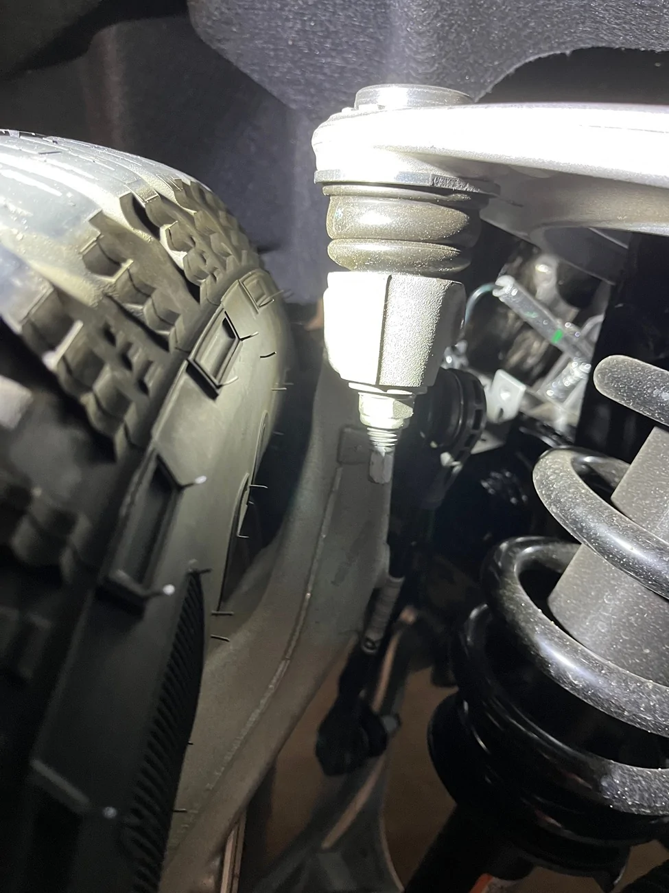

Tire Rack shows alternate tire sizes that will fit, you must enter your vehicle info and then register there for this to work. Hub clearance does not change - it is the front upper A arm and the fender opening that is a concern. A 20 mm wider tire equates to roughly 10 mm less clearance at both those locations. It probably won’t matter at all, unless you plan to fit winter chains there ;) ….

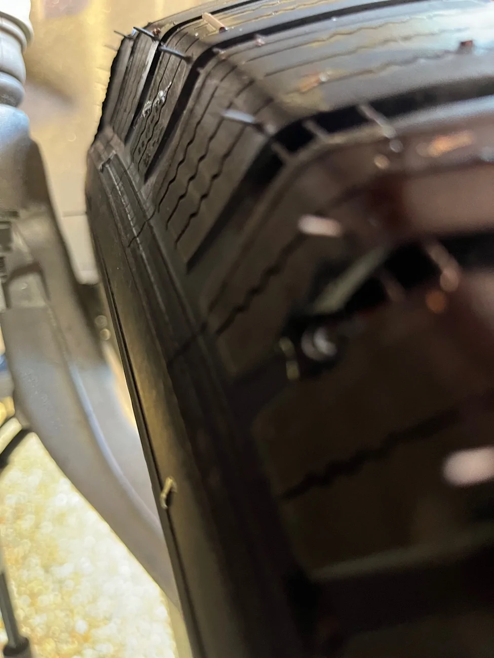

Appreciate the replies, but I know well tire fitment. I’m looking for actual experience with this size. Sizing can vary quite a bit from tire to tire, even with the same manufacturer. There appear to be several threads assuming that 275/65/18 will fit. Since this a taller tire, I can assume the shorter 275/60/18 will than fit. Would be good to have confirmation.
Clearance issue is not to the UCA. It is the hub, or knuckle, that is closest to the tire. I just used some clay to measure this gap and it is 14mm. So, again, in theory a 275/60/18 should fit With 4mm to spare. Tight.
My reasoning for a highway tire like the Michelin LTX of the same diameter is to improve all aspects on road. Better NVH, better dry and wet grip, and better rolling resistance/mileage.

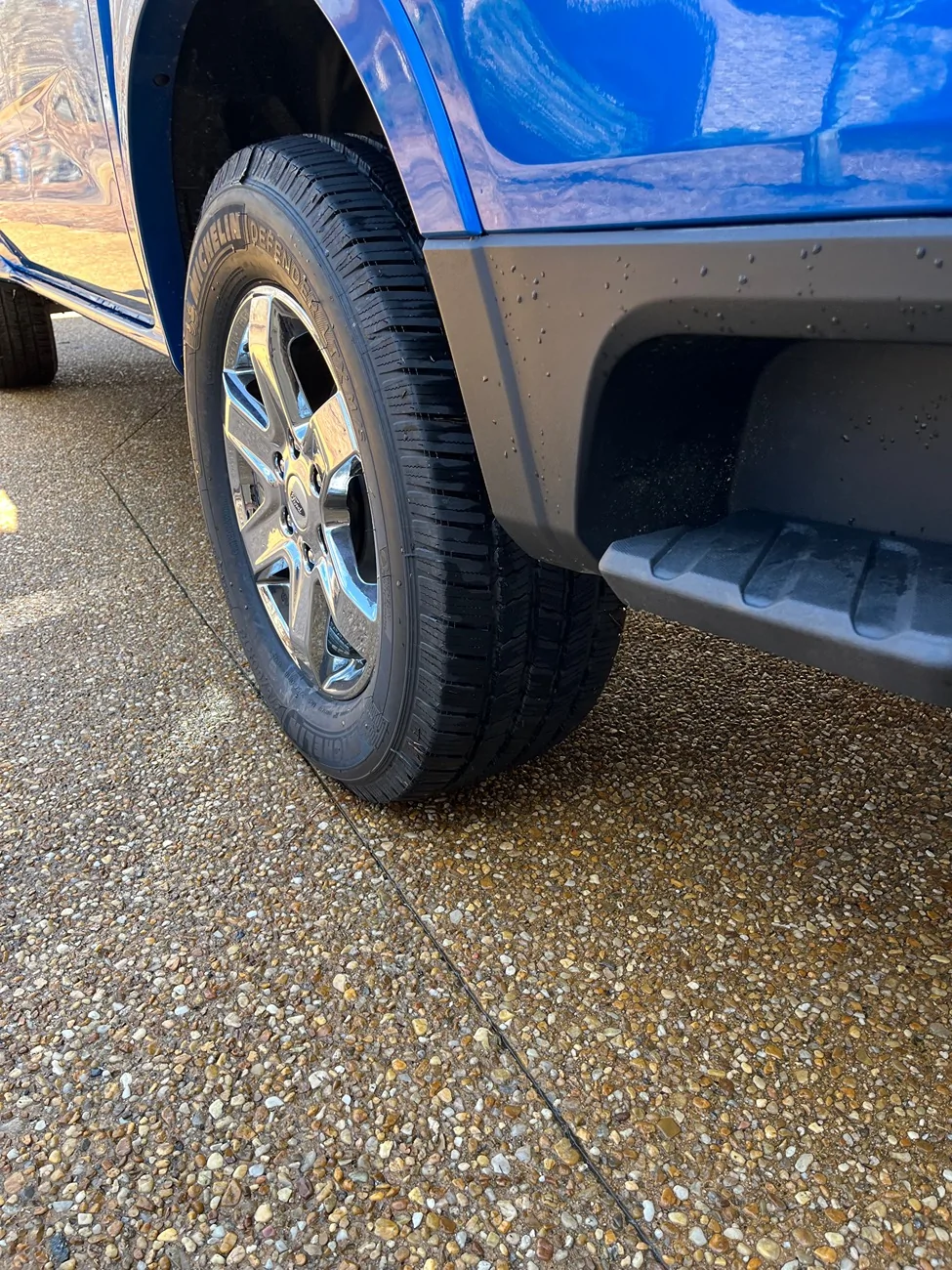

For those few interested in a better road tire, I’ve gone ahead and answered my own question and have verified that 275/60/18 do fit the stock 7.5” rim and clear the knuckle and UCA. Ride quality is significantly better with the Michelin Defender LTX tires and the wider squarer look is much improved.
