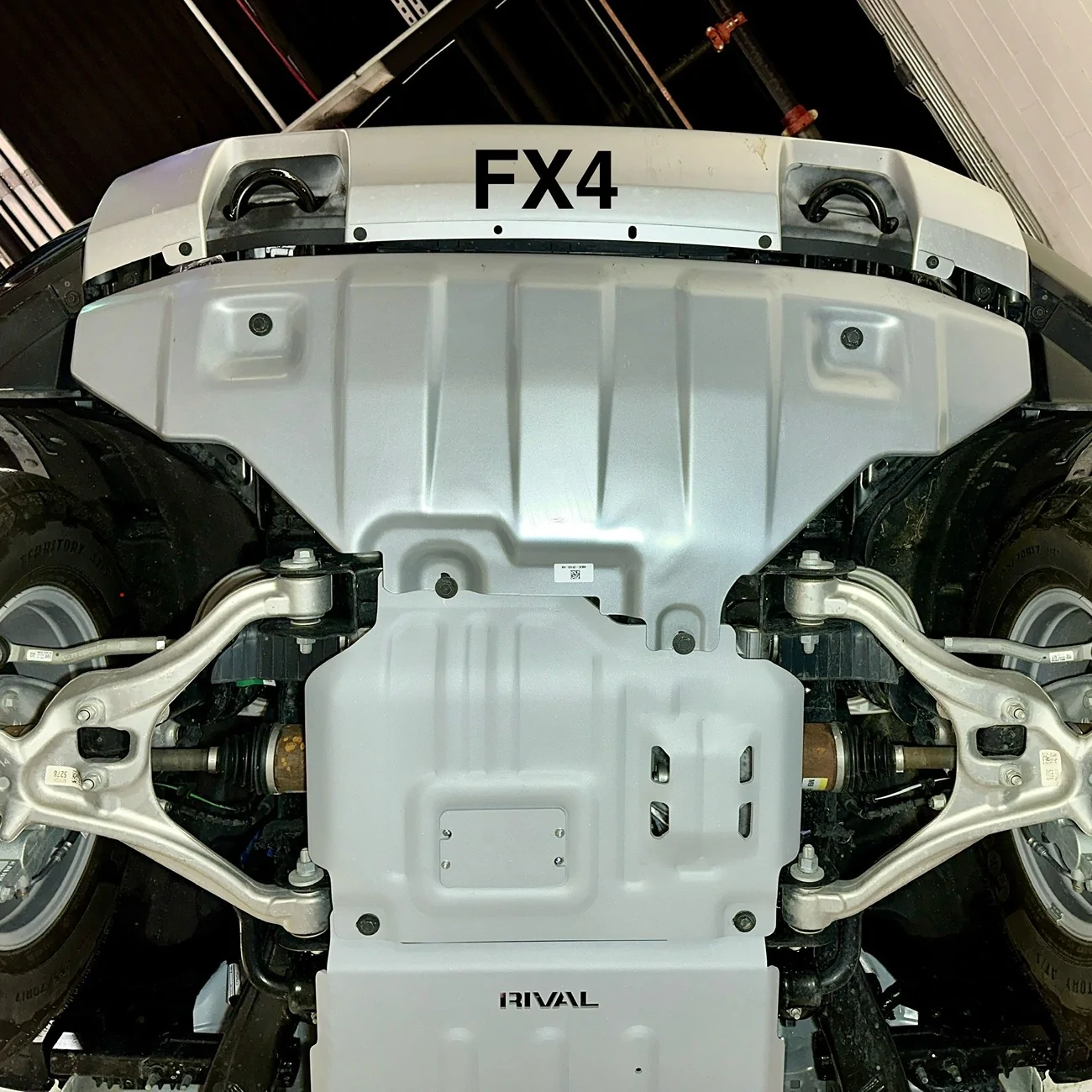

Just noticed this picture on the engine skid page, so looks like it is compatible with the FX4 factory radiator skid. That's a different transmission skid in the picture though (it's the one that's incompatible with the FX4 transfer case skid). Sounds like it's just a question of whether the two parts I mentioned are compatible with each other and whether Rival can do a bundle then.
Ford Ranger Transmission & Engine Skid Plate recommendations for FX4? 82589C6C-444C-4D40-A7B3-AF12C991467C
Edit: they confirmed the two parts I listed above should be compatible and extended the $90 bundle discount. Sounds like also no BF sale planned, so will come out to $780 shipped. Very curious to hear if anyone else has any other recommendations.
