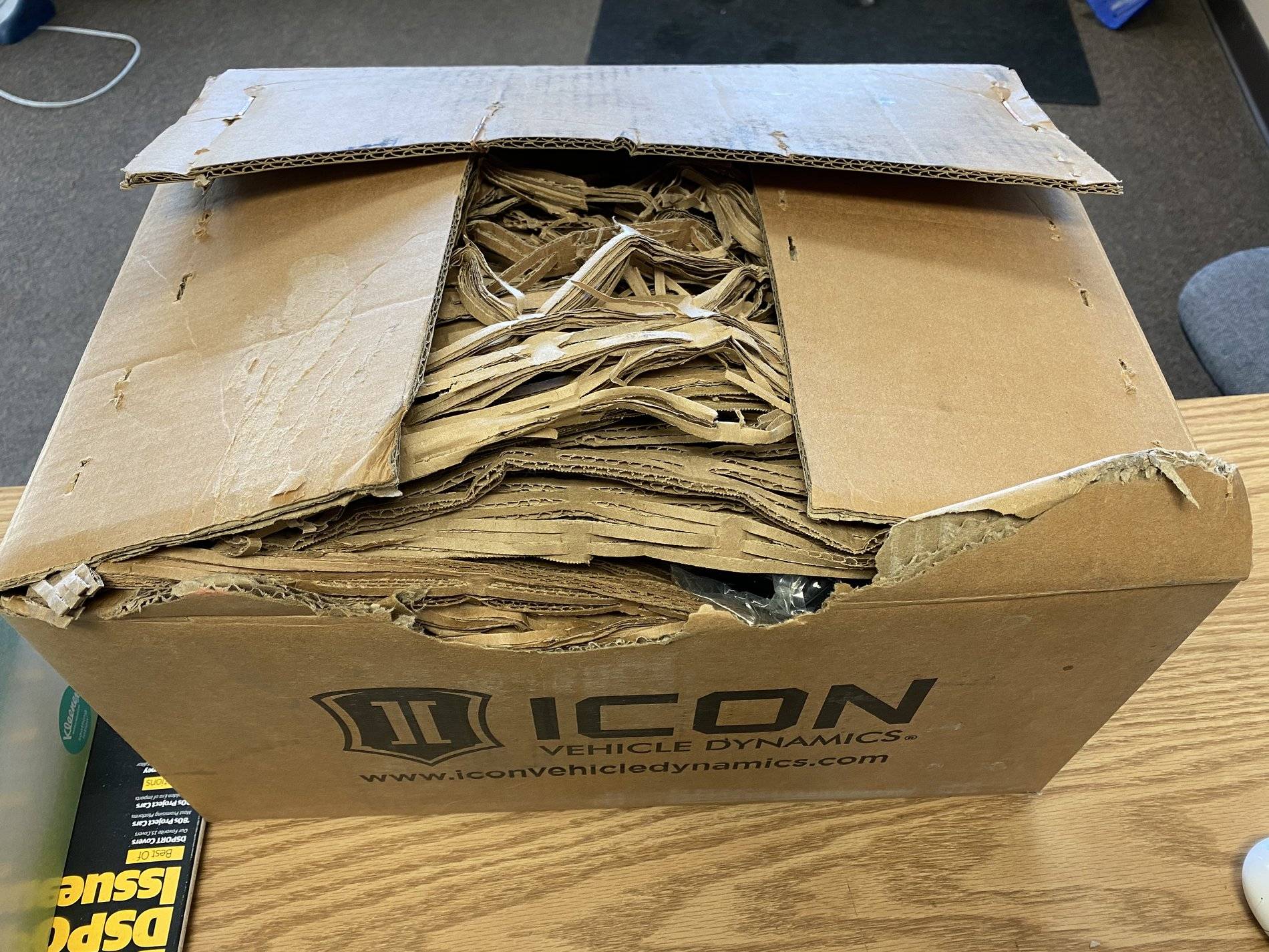

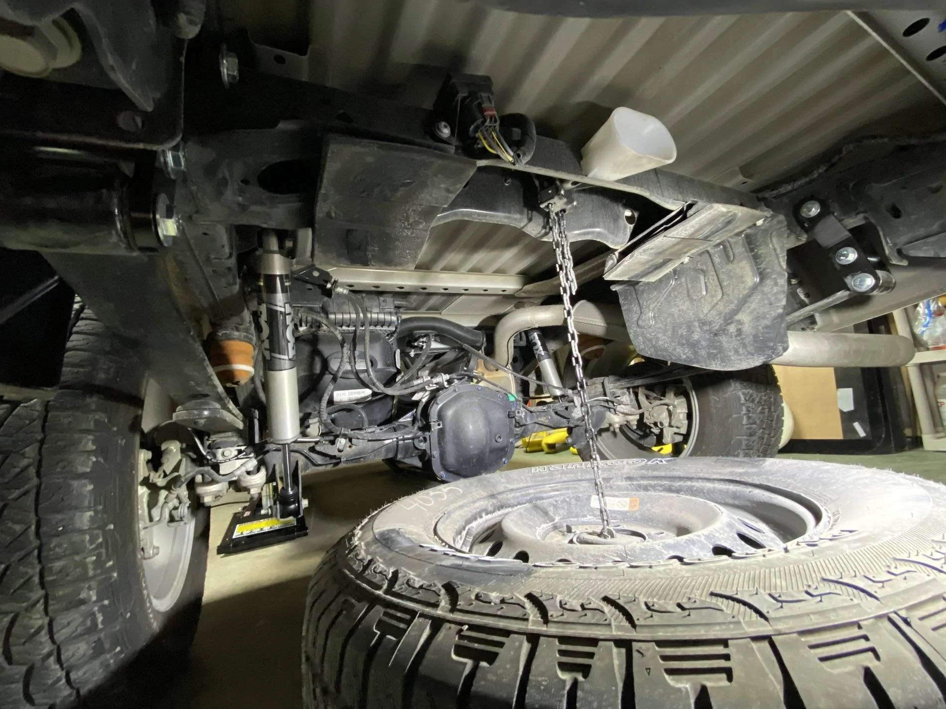

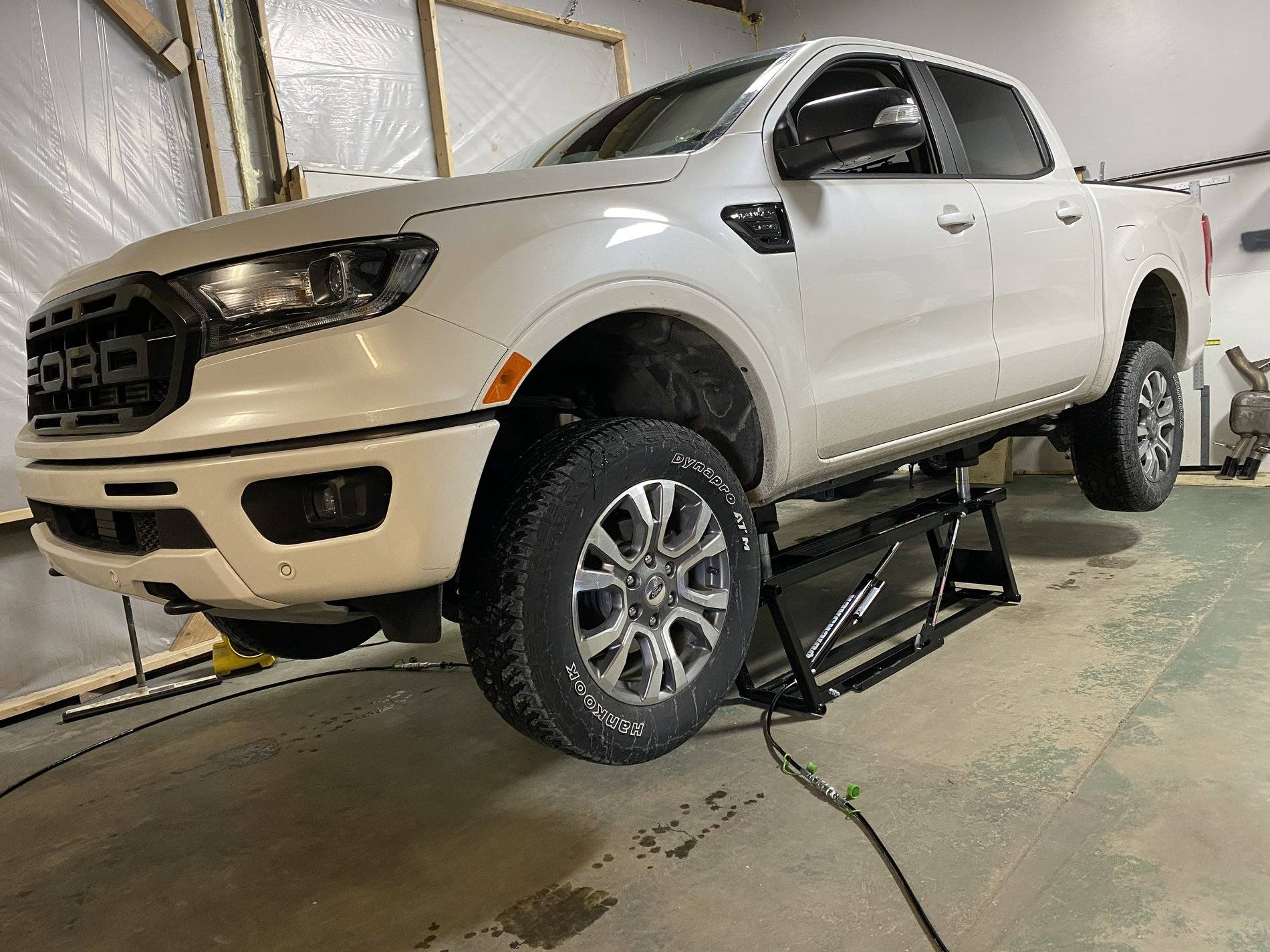

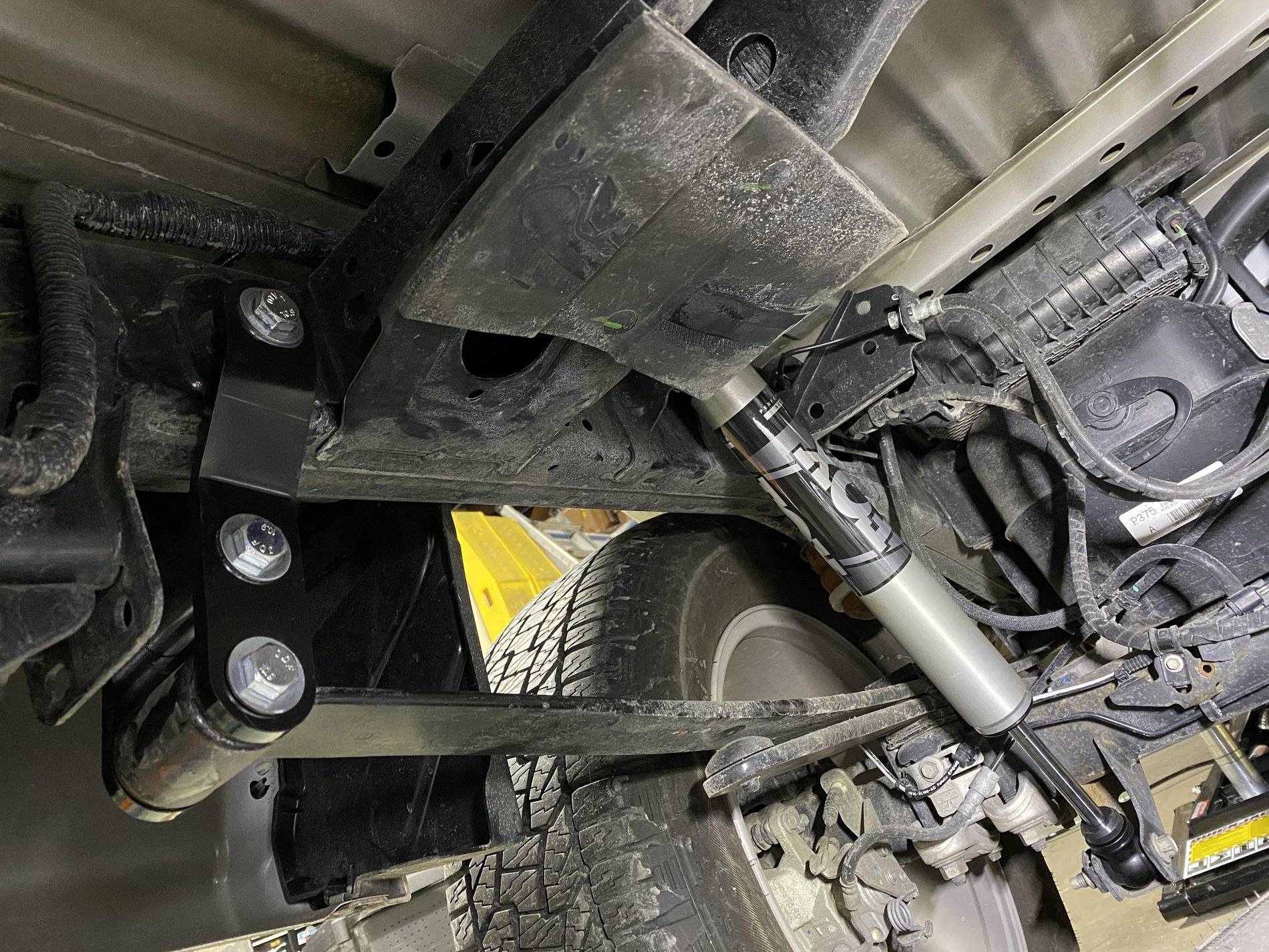

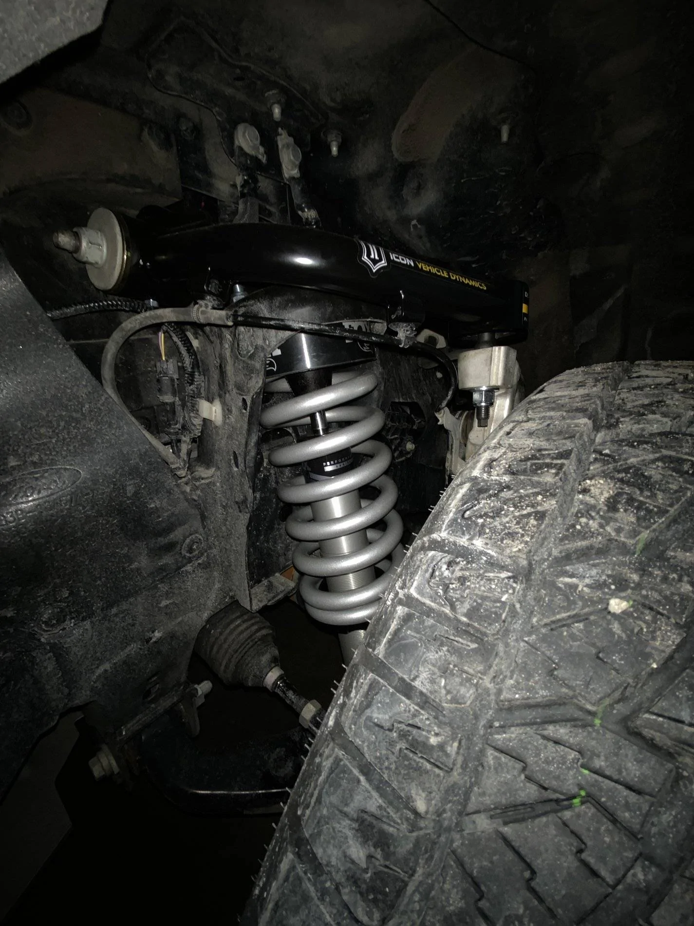

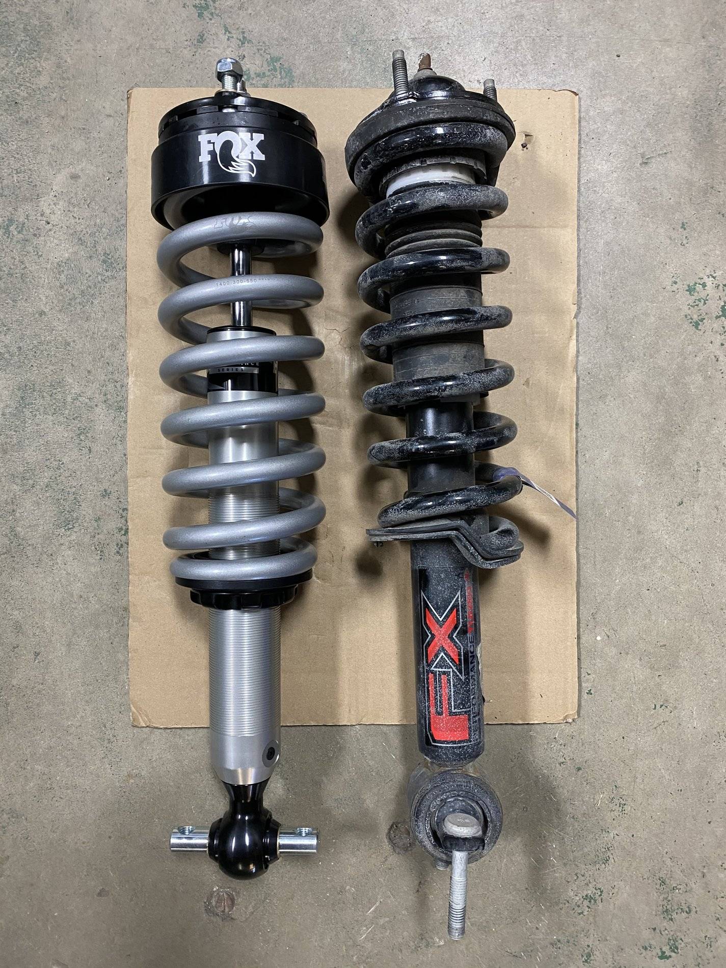

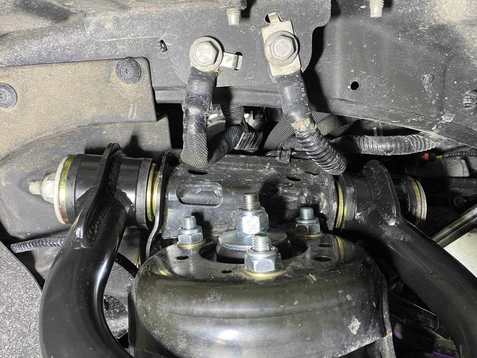

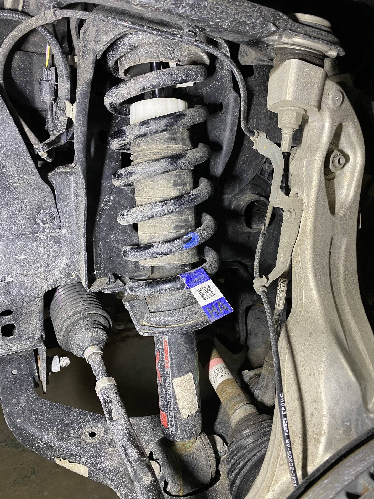

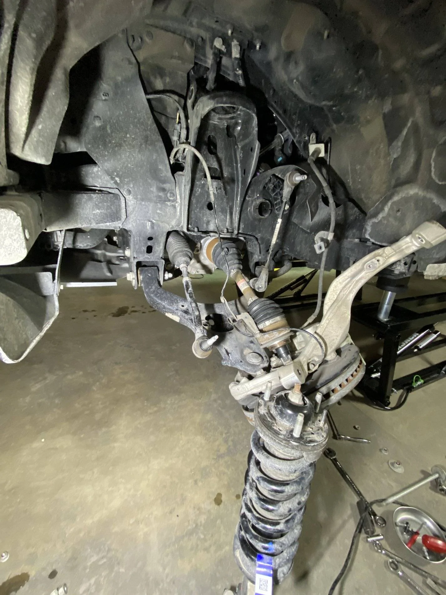

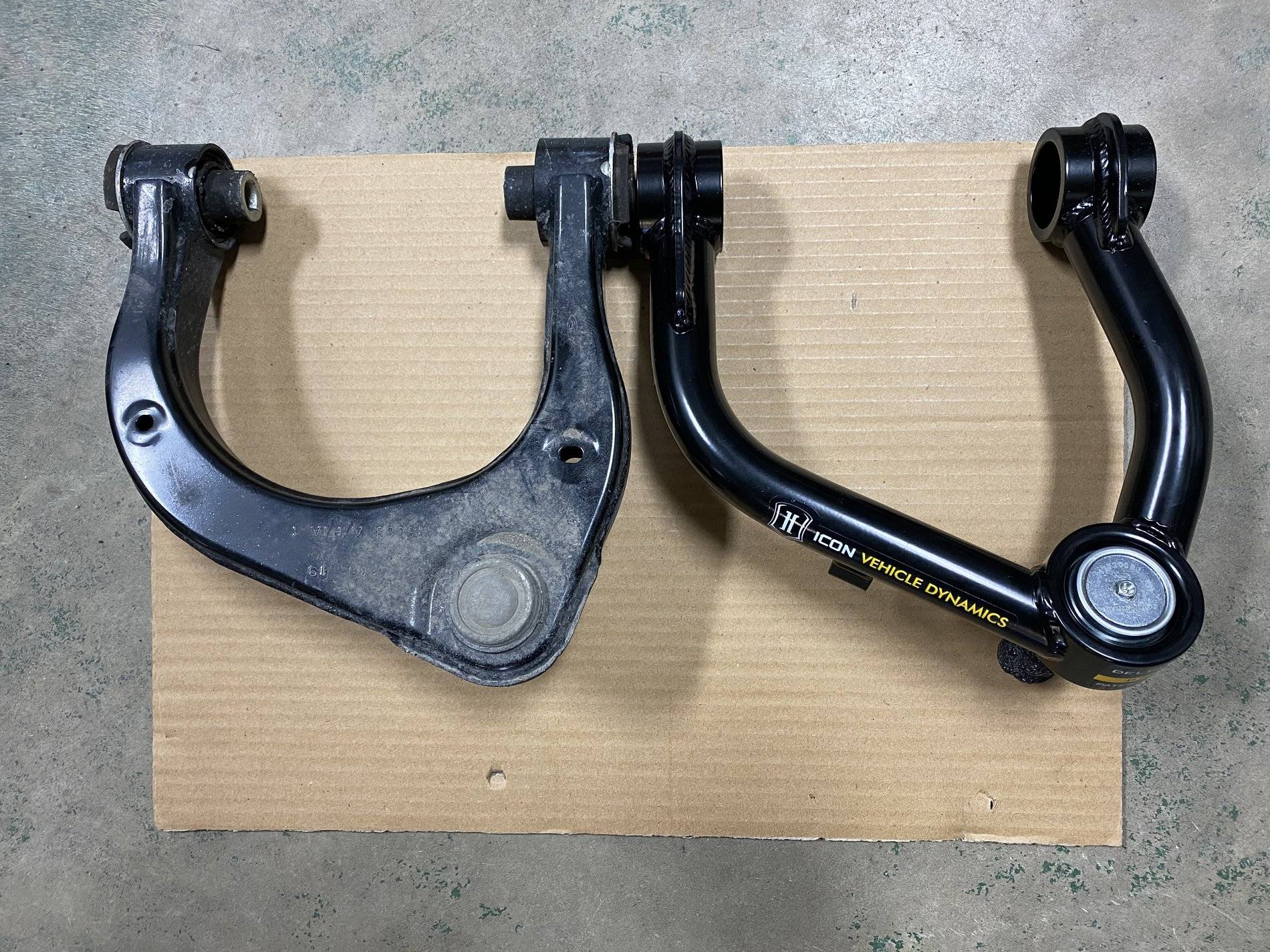

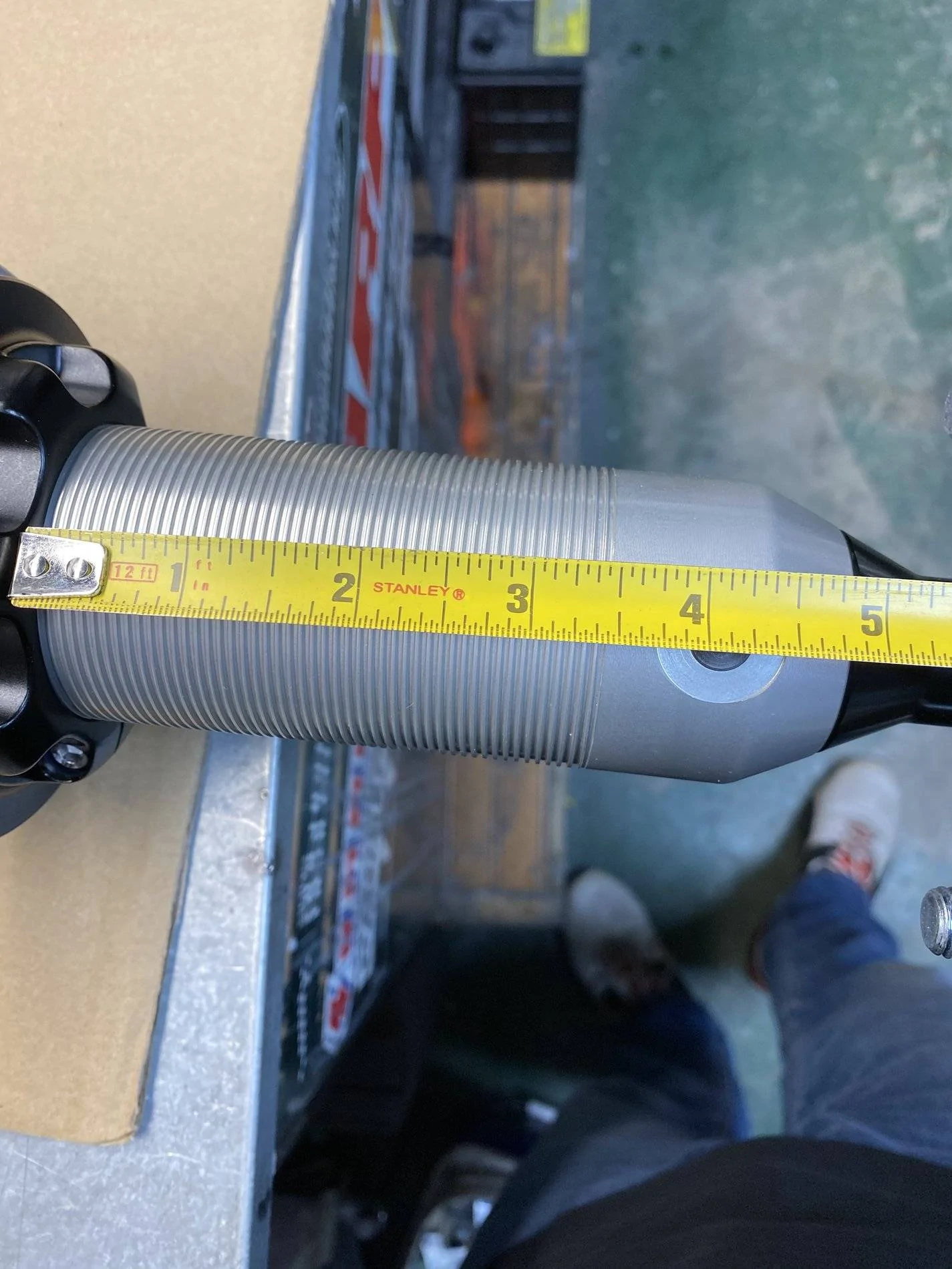

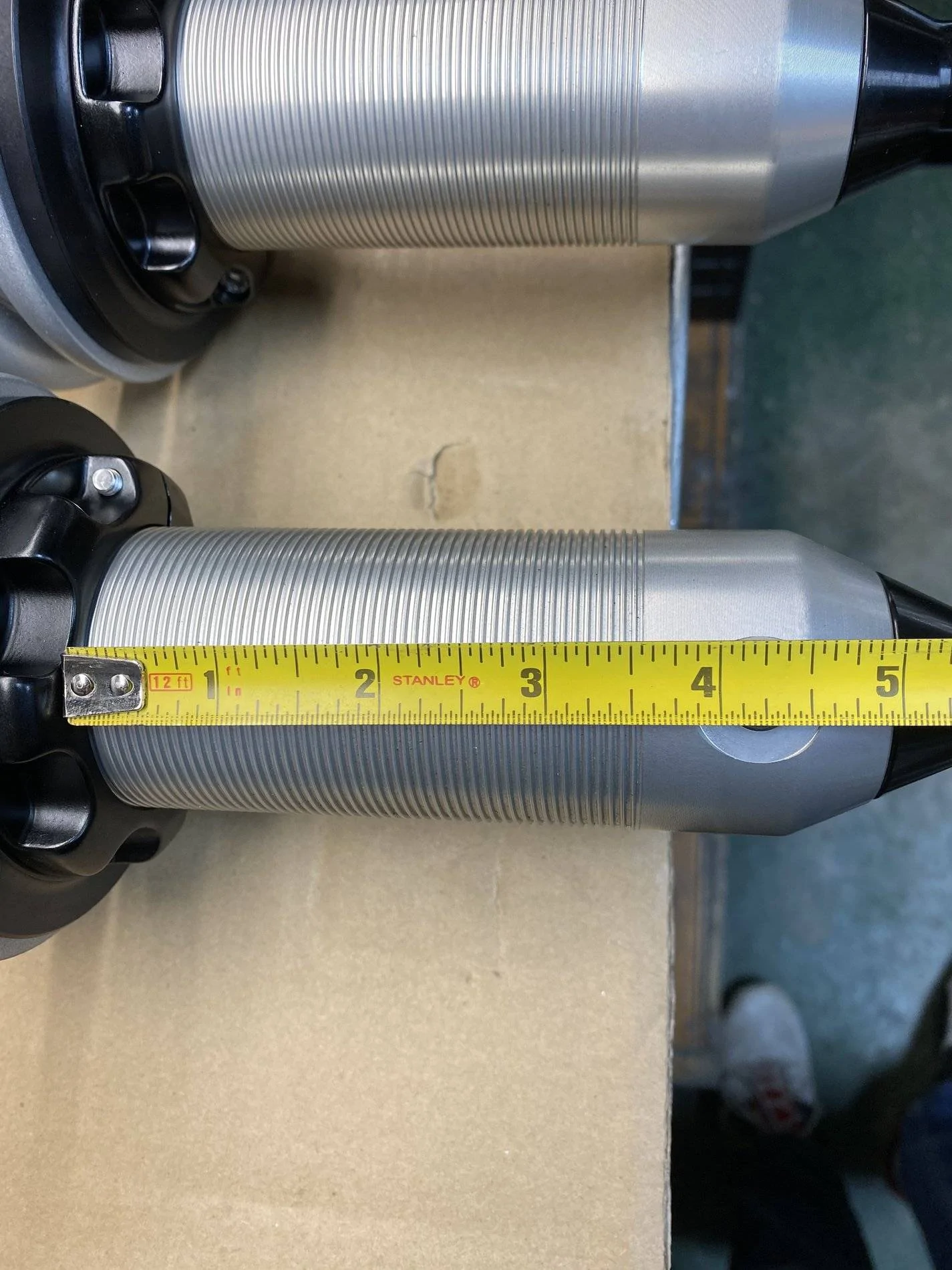

Finally rounded up (almost) all of the parts I wanted for the suspension. The Icon upper control arm box was busted open and a couple parts were missing but they’re sending them out. I went ahead with the install anyway and made it work for now. Fox 2.0 front coilovers and rear shocks, Icon Delta joint tubular front upper control arms, BDS intrusion beams and BDS 1” rear shackles. My goal was 3.5” with a level stance.
I added a little extra preload to the Fox front coilovers to add height, hoping for 3.5” taller than stock. If needed, I will adjust a little more once I take measurements of the ride height. Here are some pics but once everything is complete and aligned I’ll upload better pics.

Here’s how my UCA box showed up and how I had to add washers as spacers since that’s what was missing from the box. It will be an easy fix once the rest of the parts show up from Icon.

That’s looking great! What Quickjack are you using?
