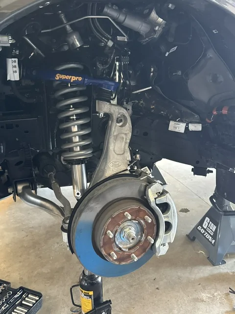

I finally got around to installing the front coilovers, UCA's and rear shocks/blocks over the weekend. The sway bar links keep getting back ordered further and further back so I decided to skip those for now. Everything went fairly smoothly other than a ratcheting wrench somehow seizing onto one of the upper strut nuts on the passenger side. It probably took me close to an hour to free that thing up but after I eventually got it off of there after a wrong tosses and banged up knuckles. All in all I got it done in about 11 hours taking a beer break hear and there.

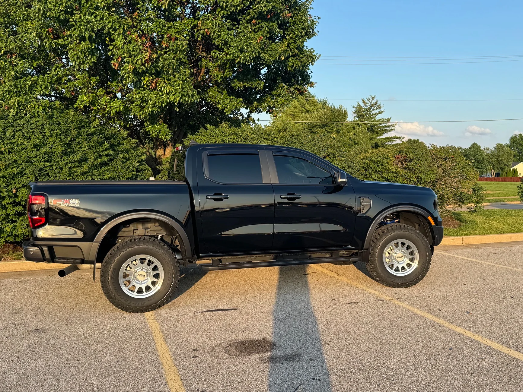

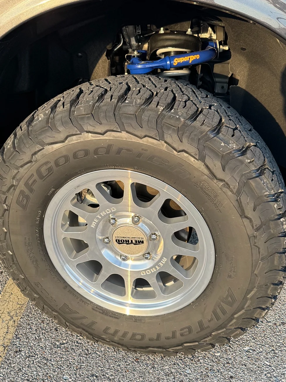

I finally got the wheels and tires on yesterday. Axleboy Offroad in O'Fallon, MO did a great job. I took it to them for the new wheels/tires, an alignment and an inspection/retorque of the front and rear suspension that I installed. Not being a mechanic and being very new to suspension work in general made that inspection well worth the piece of mind it offers. The tech at axelboy said my work on the install looked good and the truck aligned very well.
Here is the Danger Ranger's (girlfriend named it but I don't mind) full list of mods to date and a few pics of how it sits now.
1) Super Pro UCAs
2) Fox 2.0 front coil overs and rear shocks
3) 1" rear blocks by readylift
4) 17" Method 703's in machined aluminum and clearcoat with +35mm offset.
5) Hubcentric rings. 106mm OD, 93.1mm ID
6) 285/70R17 BFGoodrich KO3's
7) Sound deadener applied to all 4 doors
8) Door speakers and A-pillar tweeters replaced with Pioneer (forgot the exact models)
9) 20% ceramic window tint
10) Weathertech window vent visors. I got the in-track options and really like them.
11) Lasfit bed mat.

Looks Great. Out of curiosity why did you add the rear blocks? Aren't the Fox height adjustable?
Sighbot
Dec 15, 2025
Missouri
2024 Ranger, Lariat, 2.7, FX4
The rear for the fox kit are just shocks so they provide no height adjustment in the rear. I use the truck for some moderate towing and hauling so I wanted to keep a little bit of the rake.
