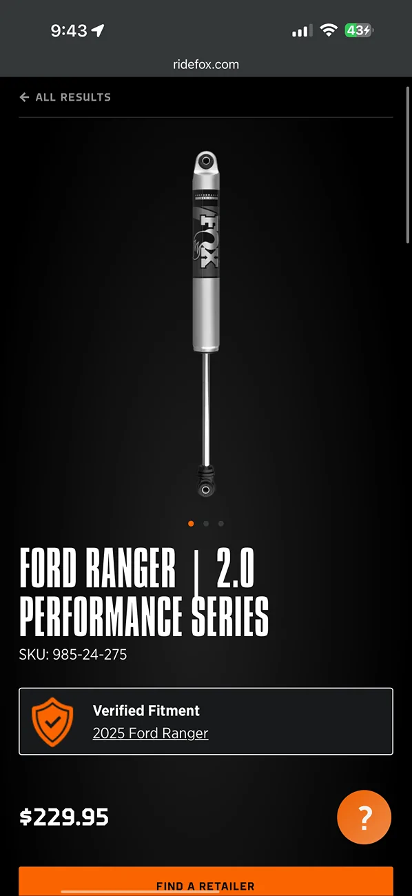

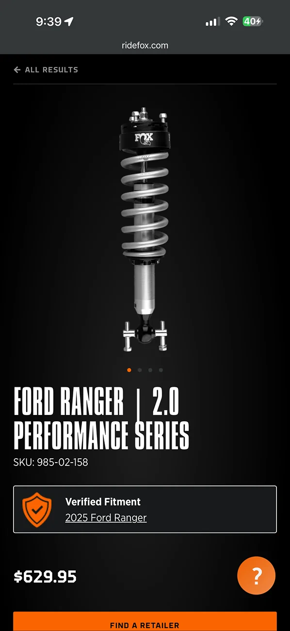

Hi,
Now that fox released the shocks for the non raptor I wanted to see if anyone has bought and installed them? I plan on picking up the 2.0s with a 0-3 inch lift (front) and 0-1 inch lift (rear)
I want to raise front the full 3 inches and make the rear level with that (I’m assuming the full 1 inch will do it)
Curious if anyone knows if the above info is correct.
Also curious if with that extension I will need new UCA’s
The description does say you can use them to “level” without straining ball joints or linkages and maintain OEM reliability but not sure

You're supposed to be able to run these with your factory UCA's. As you stated, it should be like a level setup.
Nathan DirtD
4,137
4,032
i think that everyone says the limit for new control arms is 3", though. i have a 2.5" level and ford was able to get the alignment in specs so i can vouch for that amount but 3" i am not sure
