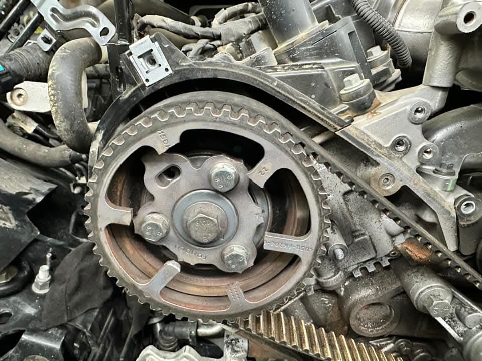

Ford Australia has recalled 13,500 Ranger and Everests fitted with the Lion V6 diesel, due to a defect that could cause failure of a camshaft drive pulley. This is not a new failure mode for the Lion engines, and has been occurring basically since the engine went into production in 2003.
