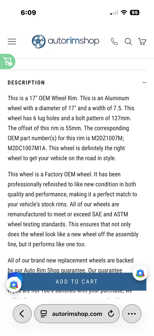

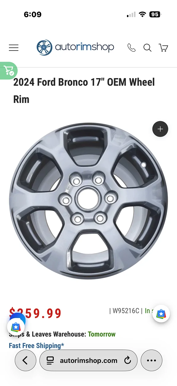

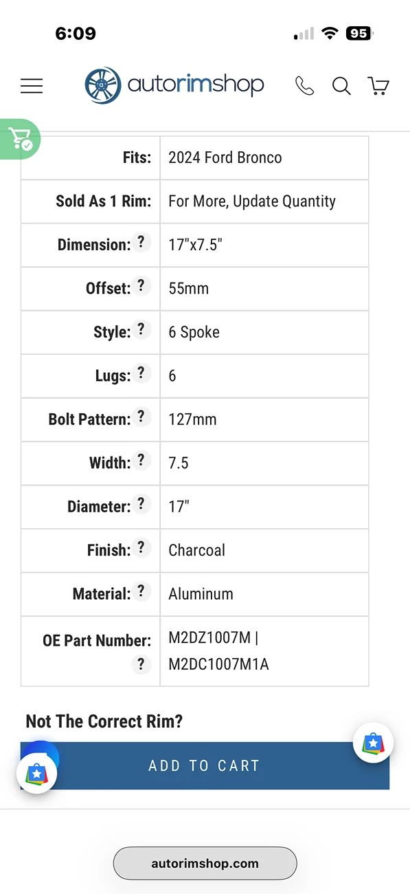

Slightly less than 24 pounds,, depending on installed wheel weights, see Posts 4 and 5. This is pretty light.... the BL wheels are about 38 with trim ring, and 34 without the ring.
Bronco M2DZ1007M; M2DC1007M1A. Can’t find the weight, any help would be appreciated. I am considering a set of take offs for winter tires, I am currently using my BL wheels and hate them, they are hard to clean and heavy, they would go up for sale and pretty much pay for the wheel swap. I prefer narrower width than my 8.5” wheels (curb damage) and do not plan to install wider tires. If know these are weaker, but I won’t abuse them and replacements are dirt cheap….
Thanks for any comments.

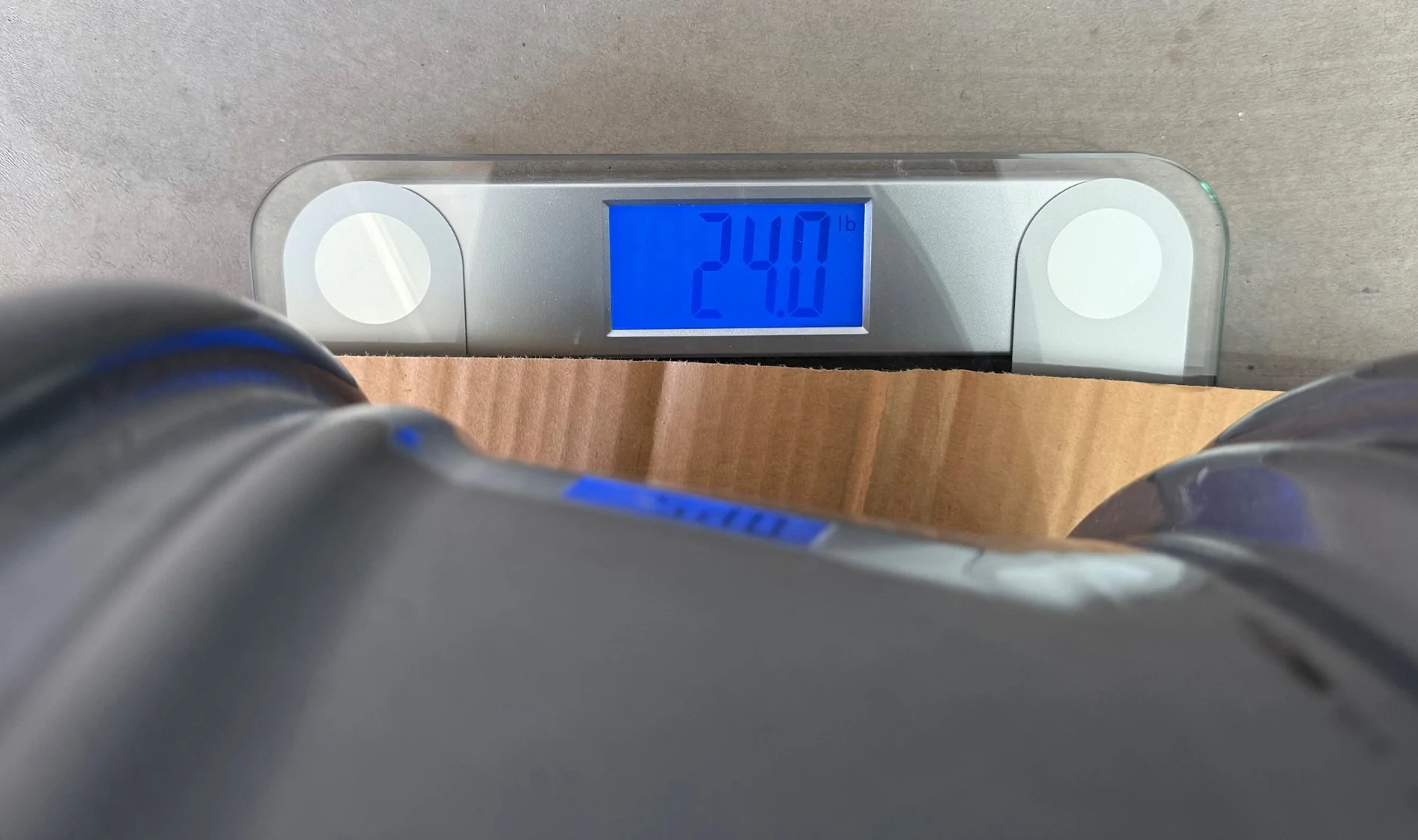

Just weighed a takeoff wheel with rubber stem (no TPMS or center cap) and a small amount of weights. 24.0 pounds.
This should give a total 56 pounds of weight reduction (rotating mass) compared to the BL "Battle Tank" wheels - that is excellent. FYI that is equivalent to 6.5 gallons of milk. Wow.... think about that the next time you go to buy groceries.
