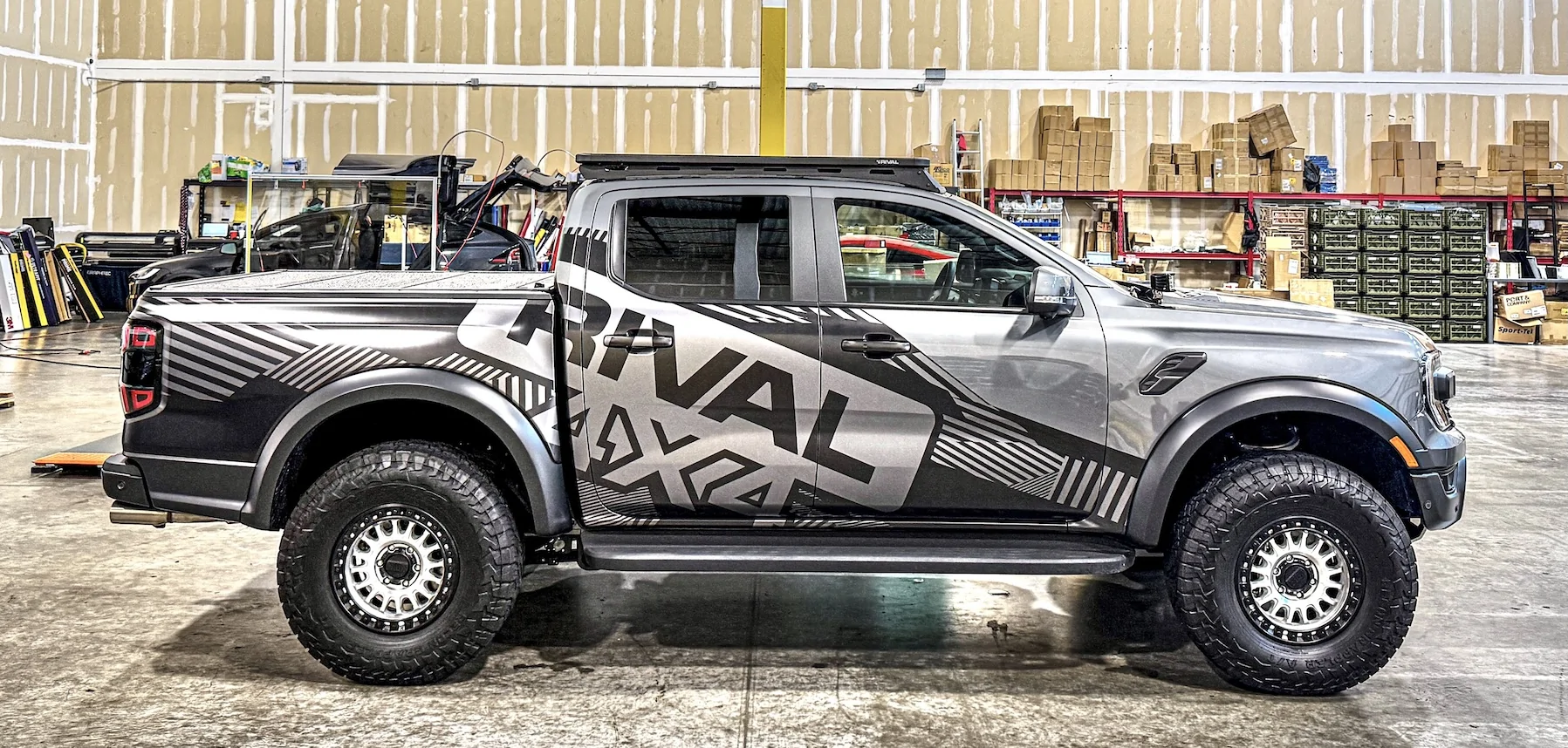

Visually well-leveled after installing only the 2.5-in FMI front collar leveling kit.
Off to SEMA right after.
Looks fine but performance is absolutely going to be worse since the 1-2" drop is spring compression, for a truck like this you probably only have 4 maybe 5" inches of compression at stock ride hight.
That means you're way out of the optimal travel range for handling impacts.
