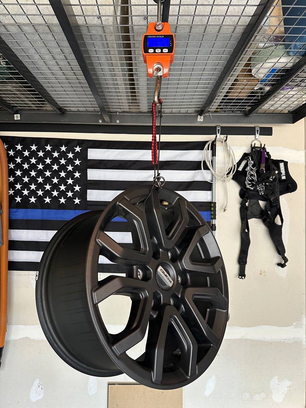

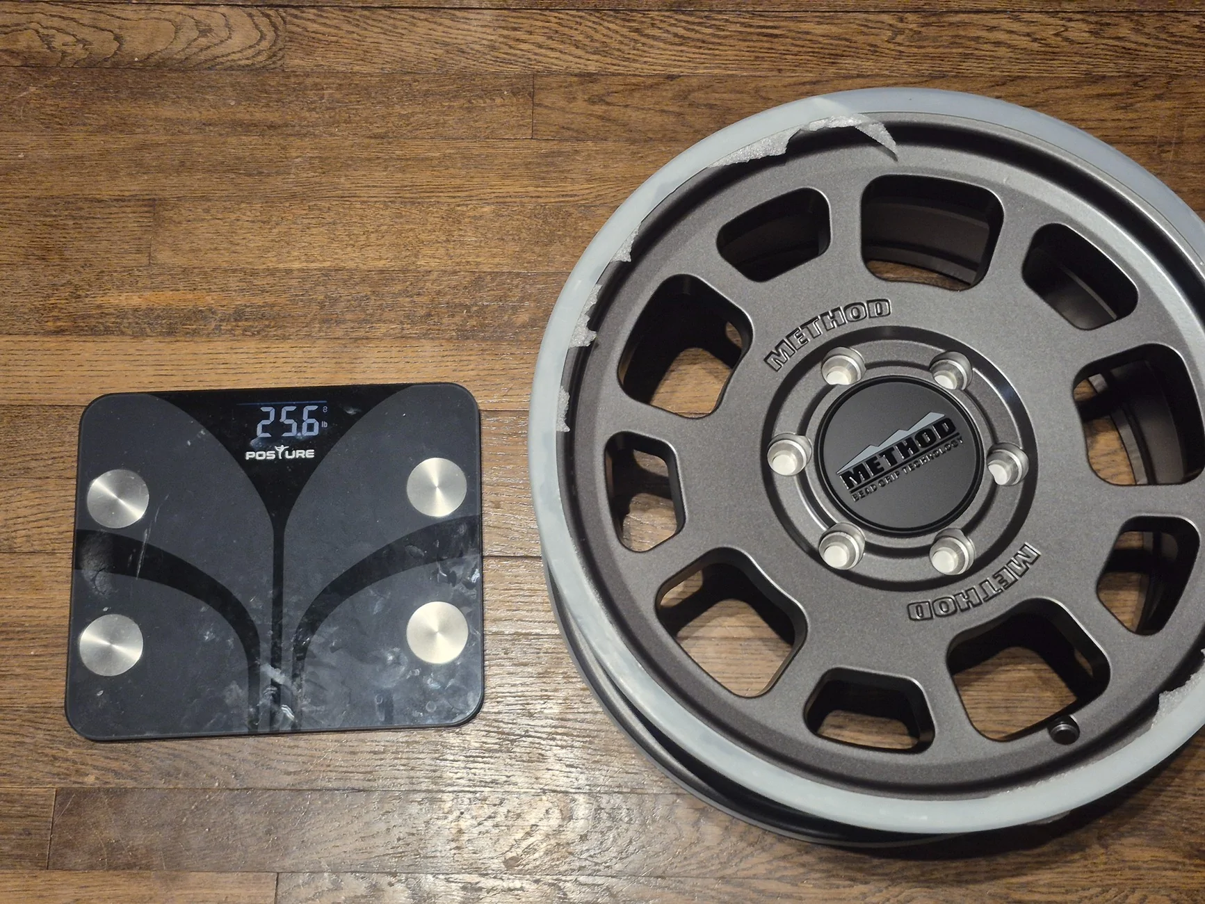

705's are 25.2lbs per wheel (my home scale measured close at 25.6lbs). I went with those over the RTR's (had RTR Tech 7's on my Mustang GT and loved them) because I wanted bead grip for sand running / trails and no more than +35mm off-set, so they fit the bill. Personally, I liked spoke pattern more than the 703's. No, I don't have any vibration issues even though they are not hub centric.
The ONLY purpose for hub centric wheels is so techs can be lazy during the install and not have to snug the lugs before they torque the wheel on. Hub centric has ZERO to do with load bearing as that's all by the lugs and taper on the lugs, so feel free to use non-lug centric if it makes your wheel choice broader, just torque them by hand yourself.
Ford Ranger Can I get definitive WEIGHT on OEM wheels please 20260116_194947
For me, the combination of bead grip, weight, off-set and factory width are why I went with the 705's. 703's were a strong second choice for me, but I wanted to save another 12lbs by going with the 705's.
