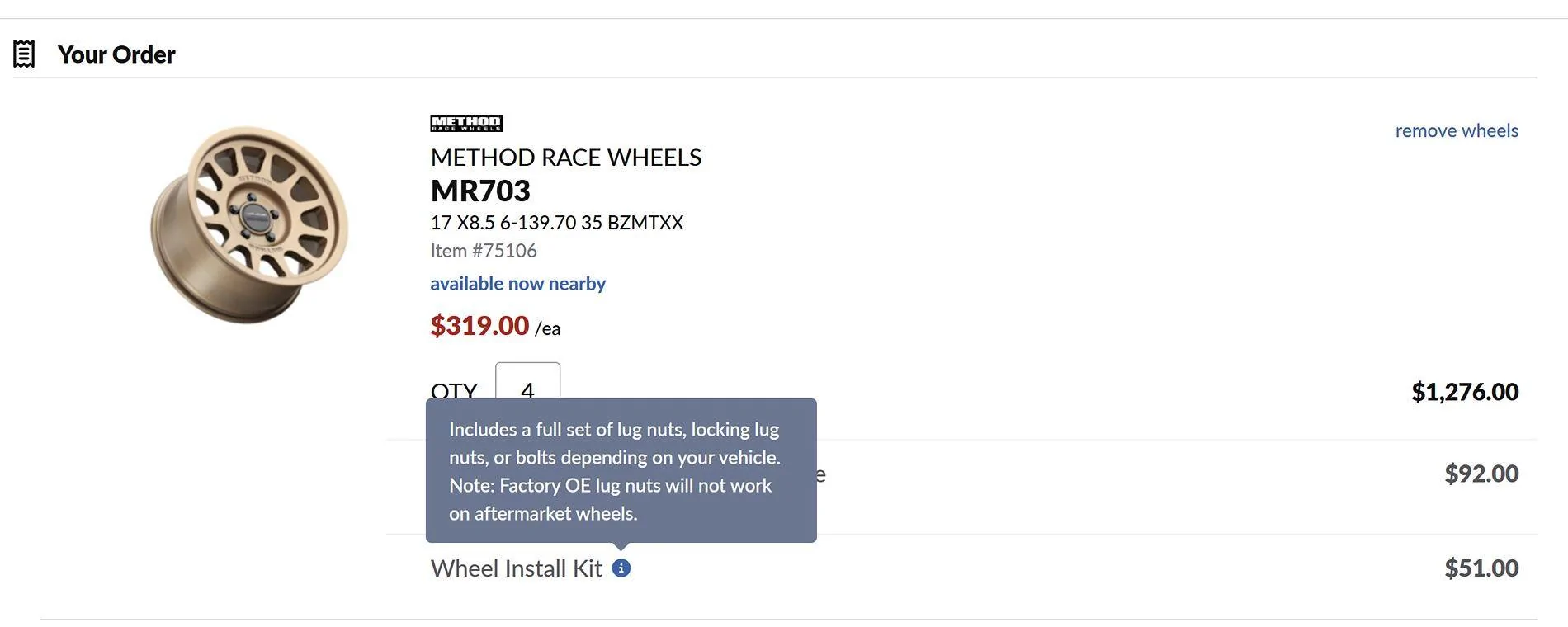

I'm not sure what the folks over at Method would say, but if you order methods through discount tire, they make you buy a wheel install kit that includes new lug nuts because OE ones "will not work on aftermarket wheels" (I've been considering these same wheels and noticed this the other day).
