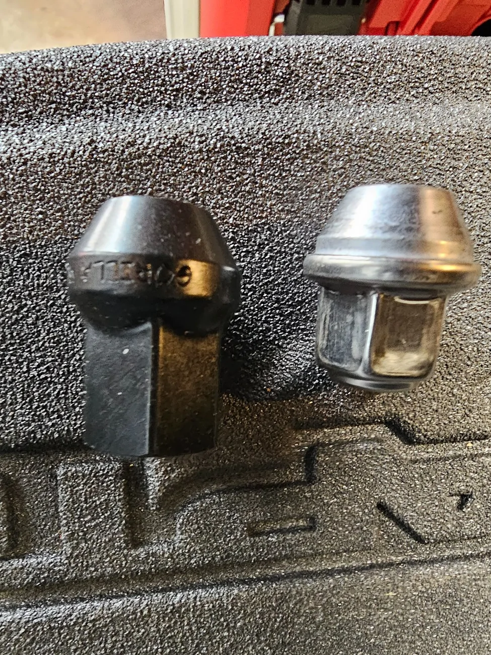

I just swapped over some '21 Tremor wheels on to my '25 Lariat, I got the Gorilla locking lugs mentioned in post #19, they're bulge acorn style but as the pictures in post #19 show the contact area diameter is slightly less then the stock OEM one.
In my mind, that can't be right, but I see others here have used them, just wondering if I'm over thinking this thing and should just bolt them on.

Interesting. When I purchased, it had the green box saying "These fit your 2024 Ranger". Even had that yesterday when I last looked. Now they do not. I did compare OEM and these side by side and they look identical other than color, obviously.
Are you still happy with the fit of these Gorilla locking lug nuts? I bought a set and as I posted above, kind of concerned because the surface area of the cone is a bit smaller, other than that, they look great.

I bought some McGard 64015 black lug nuts, but they were 1/3 the diameter of the stock ones when I put them on. Looked way too dangerous. Put the stock ones back on. Ended up ordering the black acorn bulge ones from Ford Performance Parts and they are exactly the same size as stock.
