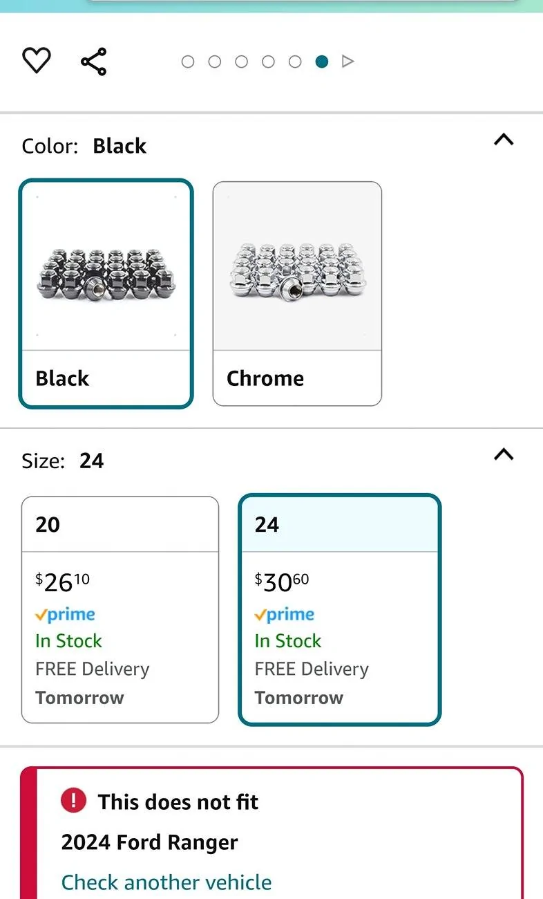

I know lol. Yesterday and the day I bought them it was green and said they fit. I did compare them and they look identical other than color, so I dunno.

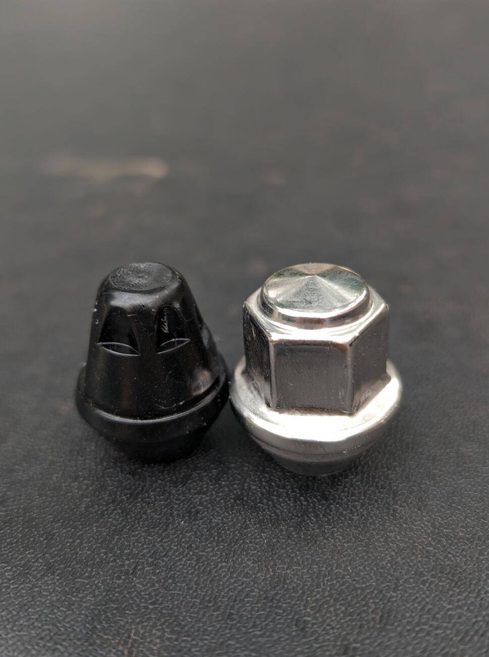

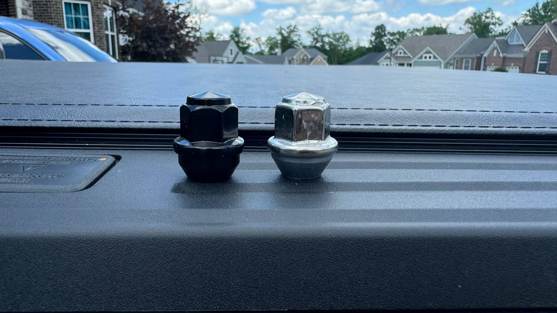

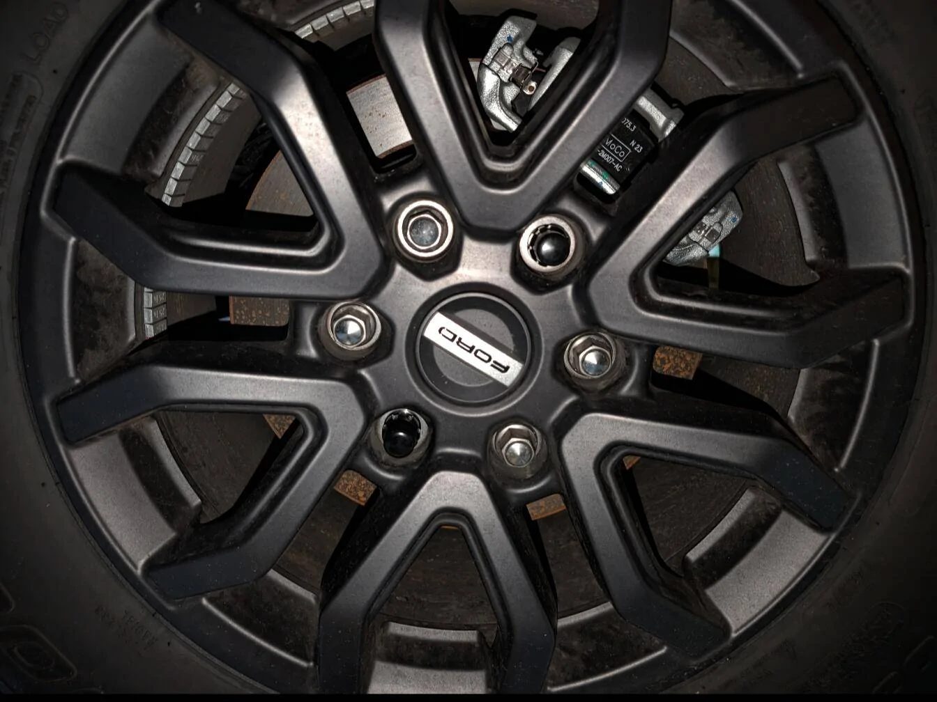

Just came in. Only made time to put a few on. Compared to OEM, they have the same surface area.
On a side note, does everyone have a foot long strip of damn wheel weights?

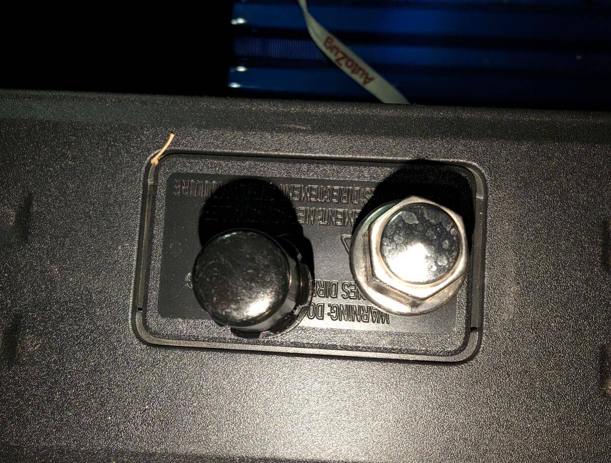

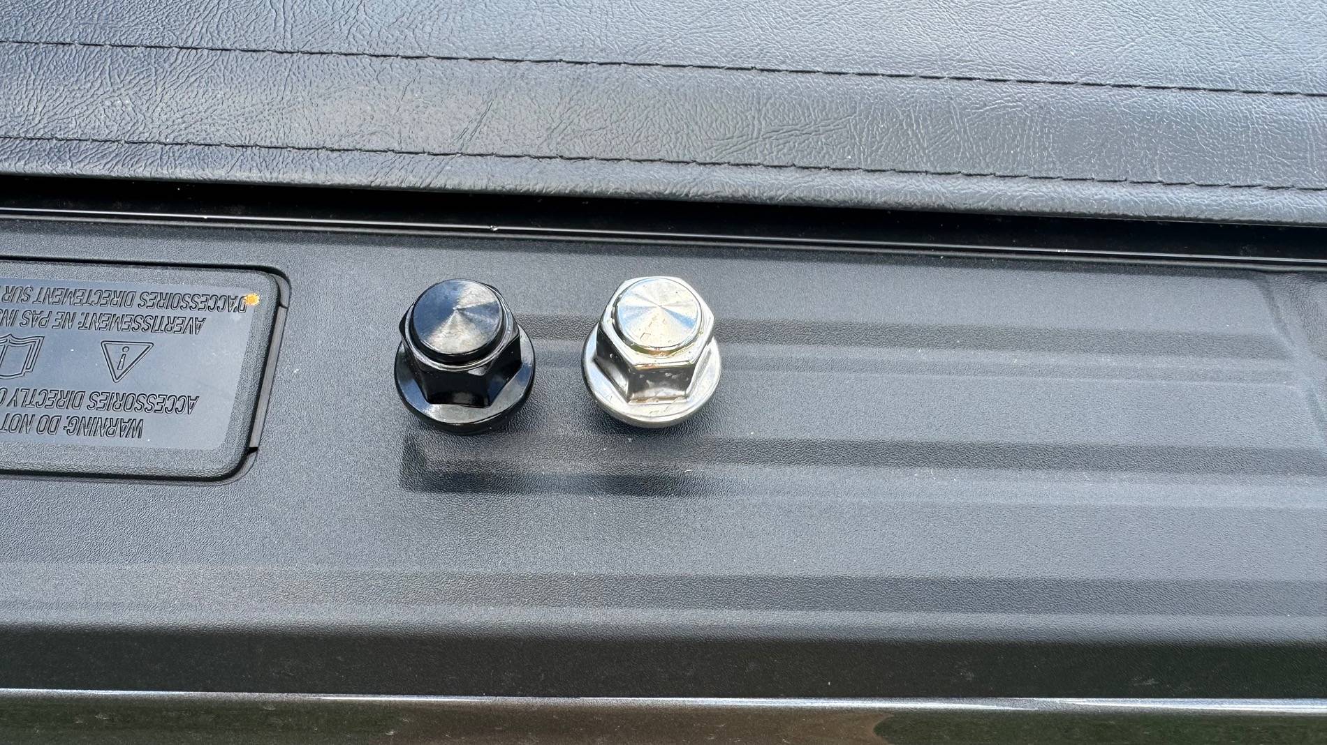

here are the amason ones linked earlier in the thread. Torqued to 150 lbs, great fitment.

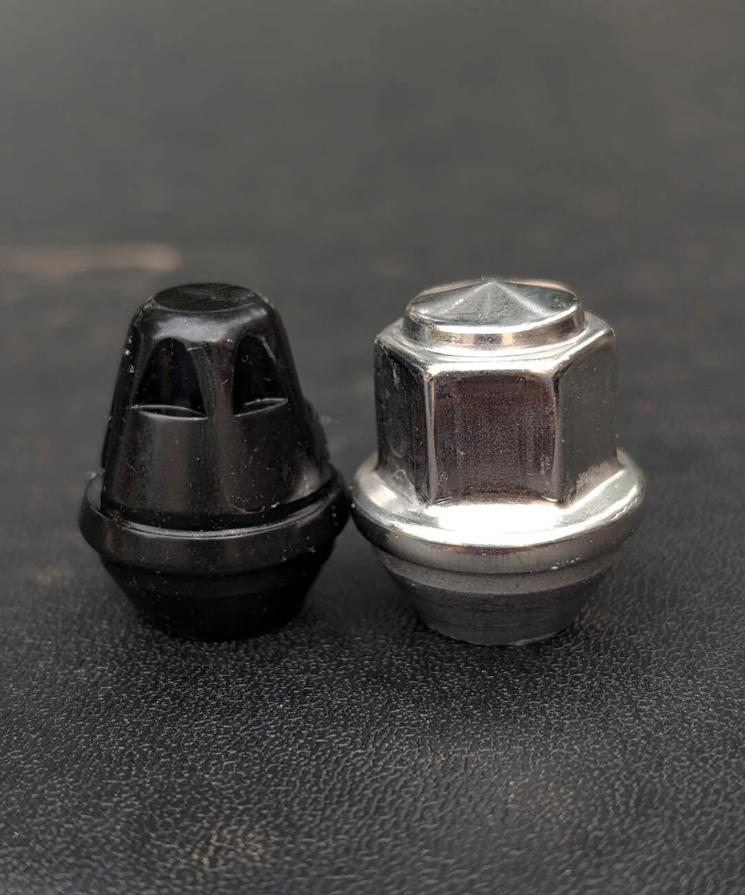

Hopefully. lol. we have factory style. can't find any in 12x1.5 that are locking like the gorilla with "factory style bulge"

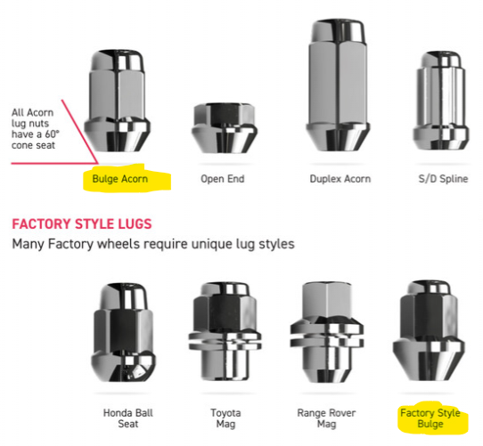

Factory lug nuts have more contact surface area than aftermarket lugs, about 30-40% more.
Would S/D Spline type at the proper angle and thread size work too? Or is the surface area that it’s lacking too important?
I did a deep dive into lug nuts for the R-Raptor.
(Short answer) Basically due to the sharing forces and wheel pressure/leverage you absolutely need a stock style for the correct surface area for off-roading/jumping/high speed cornering. Now- if you don’t plan on any of the above driving situations (I.e. your truck will stay on road all the time), then a thinner spline lug nut will be fine. If you have after market wheels you may not have a choice due to the diameter of the holes, but if running stock wheels the splines will secure the wheel to the bolts At about 1/3 reduction in strength.

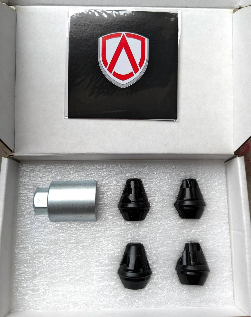

bulge acorn was the same surface contact area as OEM. S/D looks to be half of the that, but the most important is the contact angle which should be 60degrees. as long as they're torqued correctly they should be fine. These are like the ones I posted but a 24 pack. I ordered a 20 pack because I also ordered a different brand wheel lock.

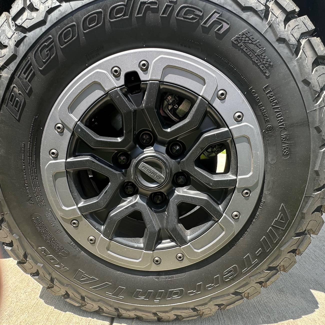

I go for extreme off-roading and wish to replace my bead lock wheels lug nuts to black instead of the stock/chrome.

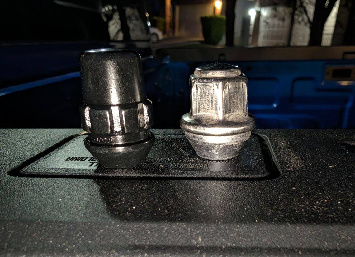

I swapped to Gorilla spline on my 350R as I wanted black and more theft protection for the carbon wheels. Very happy with the quality and would like to use them on the RR so an answer on the above would be helpful - looks to me like similar surface area that contacts the wheel so I assume that would be sufficient? The thinner spline part is not making any contact with the wheel, that’s just how you remove it so I assume it’s just as strong as stock?
