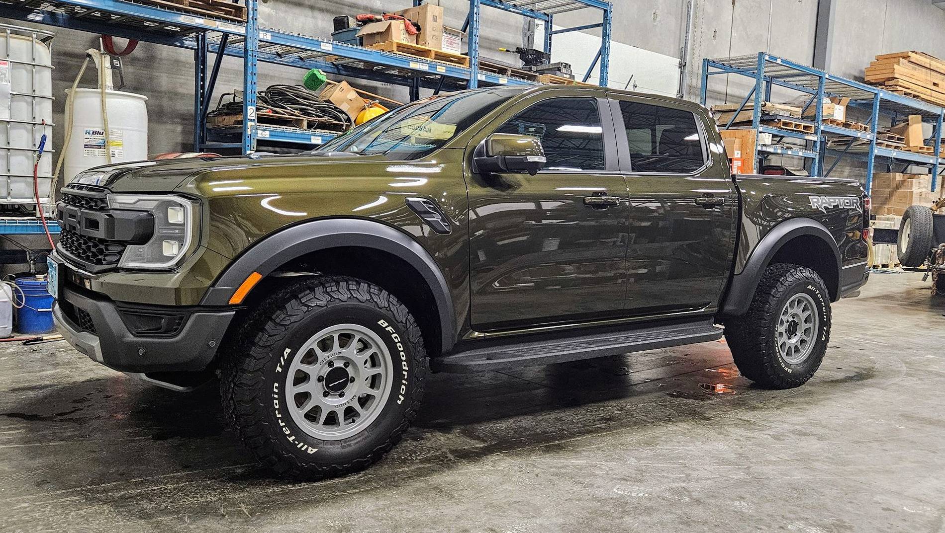

Method 703 17x8.5 +35 with Bfgoodrich K02 285/70R17
Any issues with the +35 offset? I bought a set of wheels and I thought were a -35 offset, but there are +35 offset, and I'm wondering if it's going to do any damage to my drivetrain?
Daweism
Jan 21, 2025
450
415
Austin, TX
No lol, you want the +35 offset, not the -35 offset. The minus -35 offset would have your wheels wider by 3.5 inches lol. You'd be hitting everything when you turn.
For reference stock is +55 offset, so you are going wider by 20mm (0.78 inches). With a -35 offset, you would be wider by 90mm (3.5 inches).

Thanks for correcting me! I thought I had that figured out correctly, for some reason when I read a different thread I got my negative and positive mixed up. Phew!!!
This is pretty close to perfect. I love the RWL, I love the factory rake, I love the wheel fitment and finish and I love the lack of graphics. Well done.
