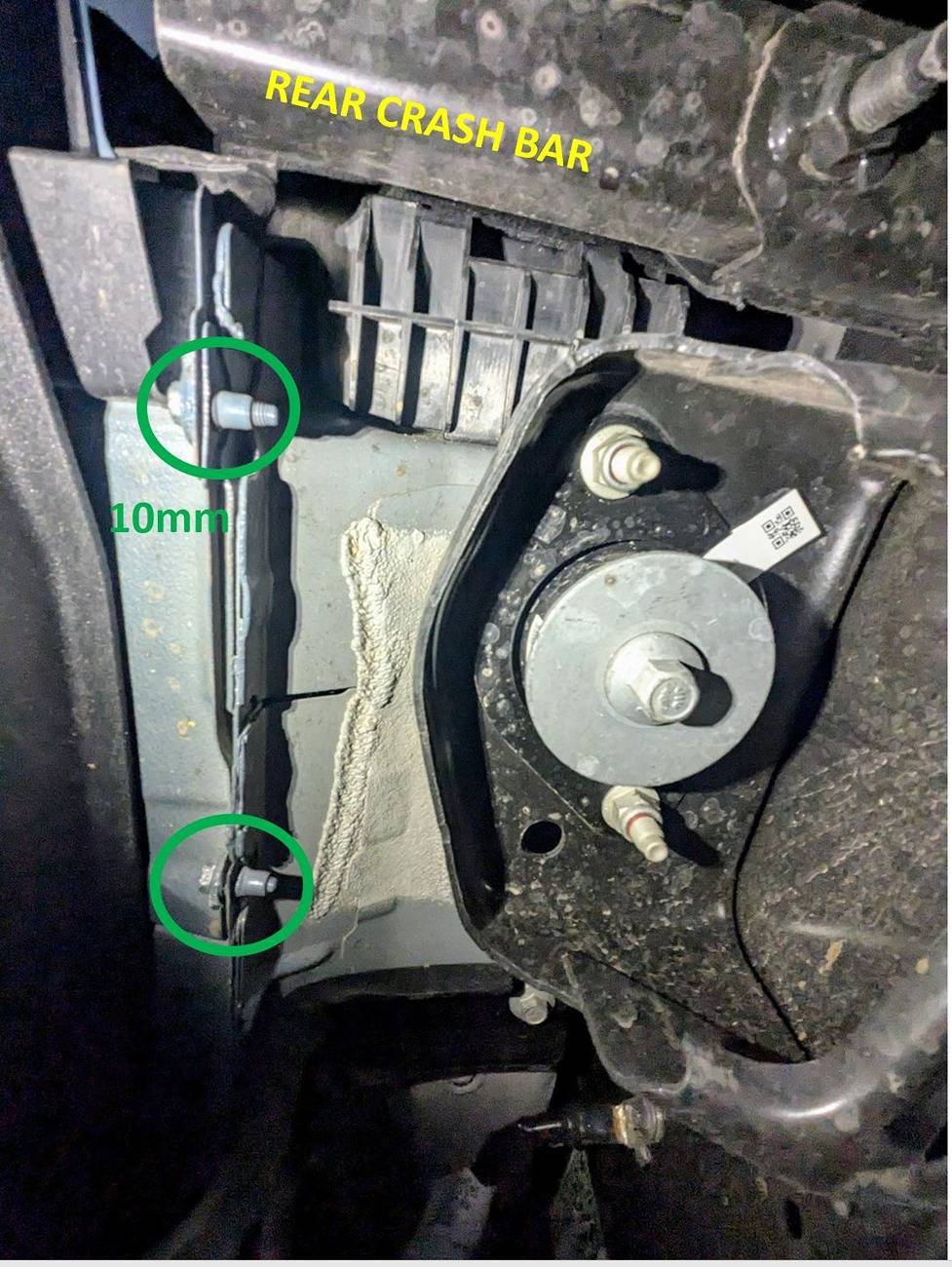

You can remove the rear crash bar also without cutting.
REAR CRASH BARS: If you remove these two bolts on the body panel, you can pull out on the panel just enough to squeak out the rear crash bar. Aim the rear crash bar towards the front as you pull on the body panel.
Good to know!!

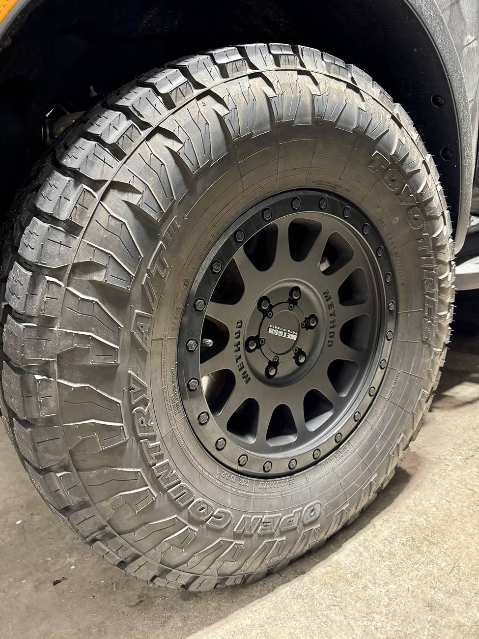

Looks awesome! May I ask where you purchased the rims and tires. I can’t seem to find a matte black with matte black ring.
Sure thing. Believe it or not, mine are the matte black wheel with gloss black ring. It’s not a high gloss though and matches my black truck perfect; between the semi-gloss paint and matte fenders. Plus, unless keep your wheels clean 100% of the time, the wheel almost always looks matte. ;)
Regardless, everything was bought on Tirerack.com. Don’t use the vehicle fitment finder, you’ll have to manually enter which size tires and wheels you’d like.
Pic of my very not clean wheel right now:

Awesome thanks brotha, any chance you know the metric equivilant of a 35x12.5r17 or what does it say on your tire?
315/70/17 is roughly the same, although, I think just the tiniest bit smaller than a true 35. Don't quote me of course, maybe someone can chime in who went that route!

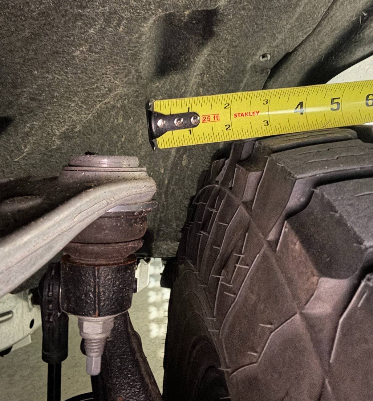

Your truck looks great!
I'm surprised your tire/wheel combo fit so well with minimal rub.
How close is the inside of the tire to the Upper Control Arm? How much clearance?
Thank you! Appreciate it. It fits great, and in fact, I believe it should have been this way from the factory. Fills out the wells much better, IMO.
In terms of how close the tire is, I've got a few inches. I've even aired down when off roading with zero clearance issues. Here's a horrible picture showing it, as I am too lazy to turn on my truck and turn the wheel for a better one. :)
