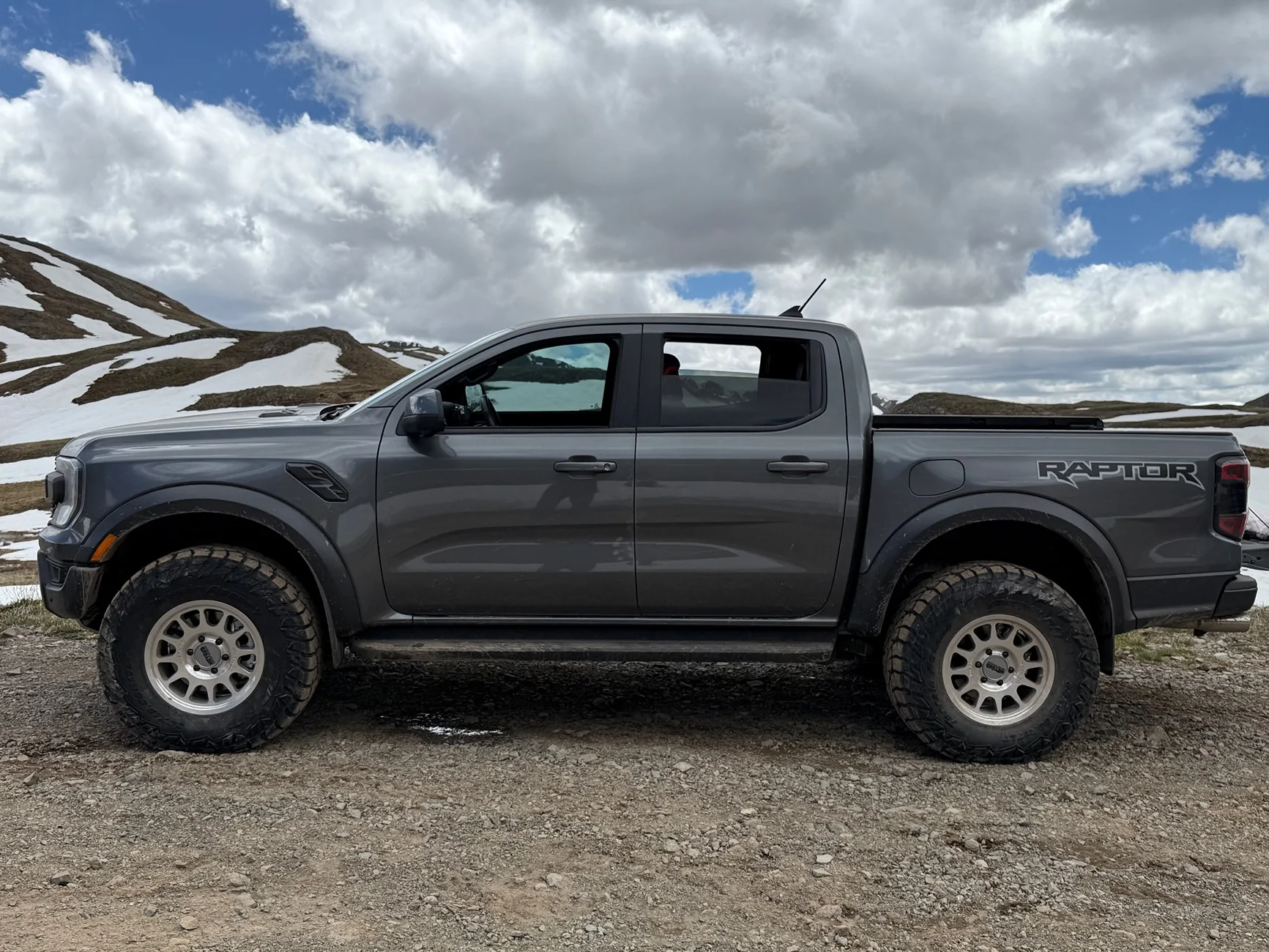

@PCDan1, I used the FordRangerLifts.com 2"/1" Kit from Robby Woolworth, put on AMP 12.50x35 R/T Tires (a true 34.8"), and wheeled this in Silverton for a week. I never had a rub and didn't do any trimming. I replaced the stock crash bars with the ReadyLift Anti Intrusion bars, and even added the Splash Guards and no rubbing on the fenders, body, or splash guards. Granted, we didn't do anything like Pritchett Canyon in Moab, but it was flexed on some of the trails on occasion. I was pleasantly surprised. Robby Woolworth is a decades long off-road racer and really knows about these vehicles, he will also take the time to talk to you if you call him, very refreshing in the age of AI.

So I had a local shop that has done a lot of Jeep work, but only a few Broncos, and he was going to do the install but backed out. I ended up driving to Vegas and having Robby install the lift for me so I knew it was done right. I did the same 2:1 lift you are discussing. Can't say enough good things about Robby at fordrangerlifts and his background and experience. If you call him, he will be more than happy to talk to you.
I used the Method 703 Beadgrip wheels with a +35 offset, and AMP R/T 35x12.50R17 tires. They are a little more aggressive for the off-roading I do which is a lot of rock here in AZ. I did remove the crashers and replaced them with the ReadyLIFT Anti-Intrusion Bars (69-2900). I think it came out pretty good, and I have no rubbing on-road or off-road.
Ford Ranger 35s on my 2025 Ranger Raptor Raptor at Silverton

Looks great!!
I believe the Sasquatch wheels have a +30 offset so I am hoping it turns out right.
