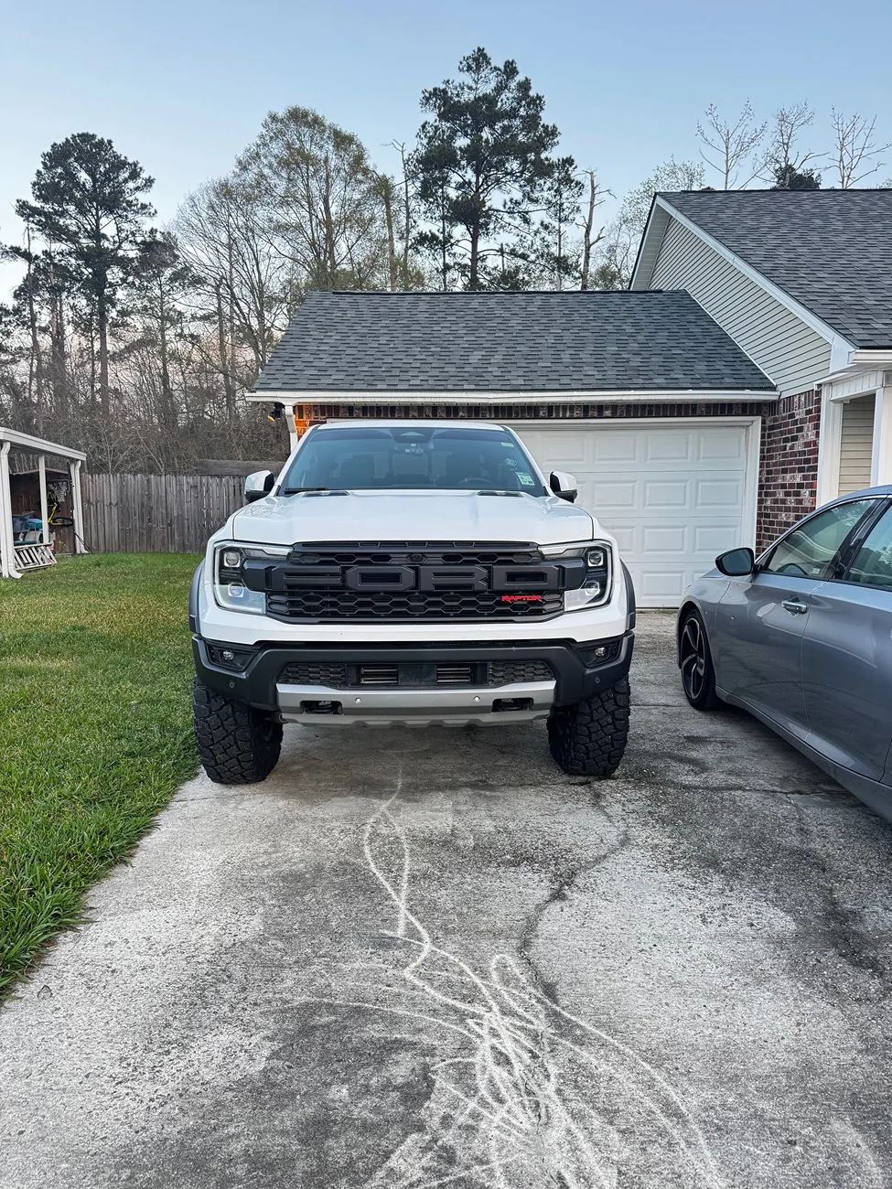

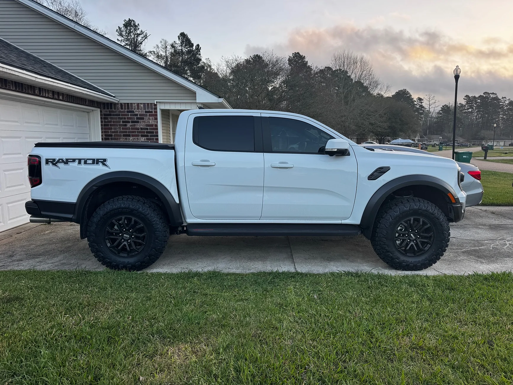

Thanks for those details, good to know how the truck handles that extra unsprung weight. I thought it had plenty of power for them, just wondering how much extra fuel it takes. I agree with you on the decals. A tasteful amount is good.

lol exactly! I had other decals on the truck before but it started to feel like a bit much so I took them off and decided to just stick with the red(code orange) accents and the 455hp decals.
I like the oxford white truck with black trim. ALso like the front "raptor" emblem. Where did you get them?

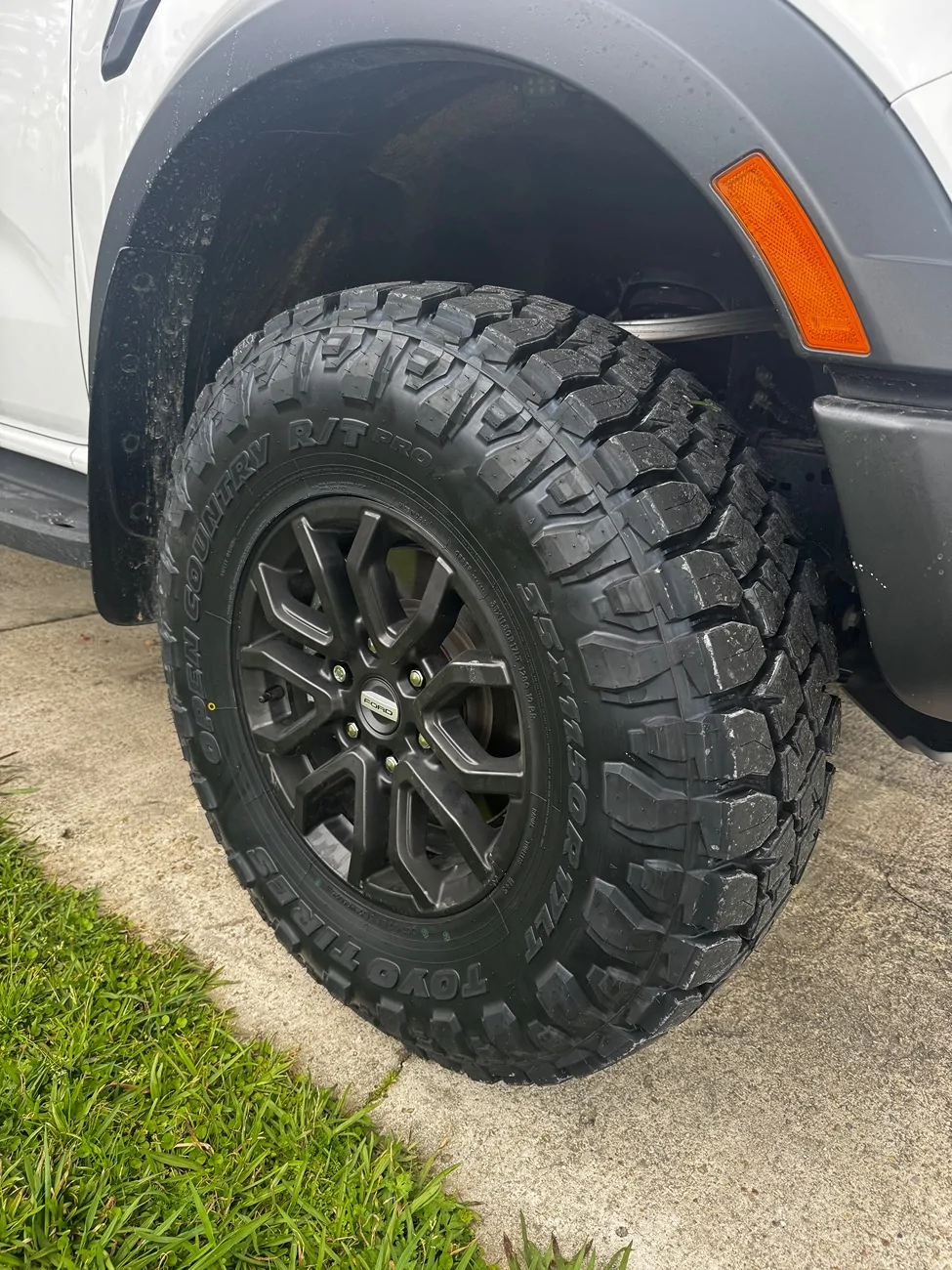

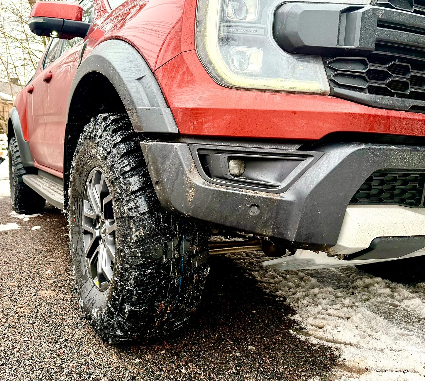

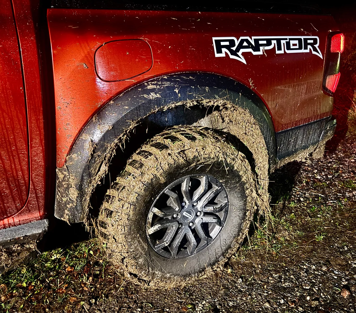

Nankang MT-1 315/70-17 with OEM wheels.
No other mods, but grinding stabilizer bar bolt head little shorter.
This RR gets to explore the world quite a bit outside of paved roads, no rubbing or any kind of other issue.

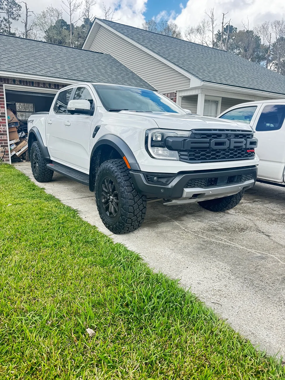

I put the 35x11.5r17 on the stock +55 wheels. So far I haven’t seen or felt any issues.
