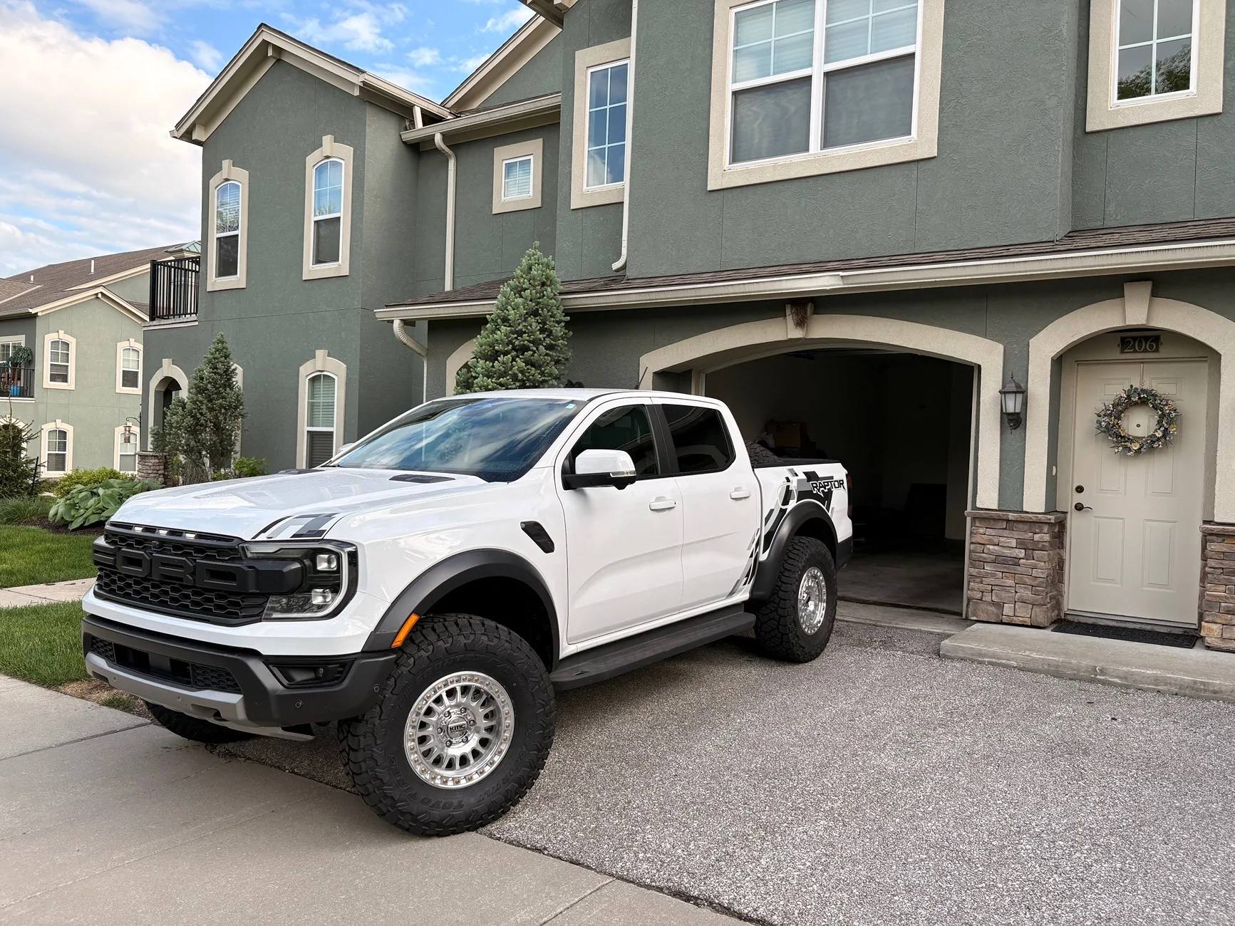

Decided to go ahead and move forward with mounting 35s on the truck. Went with 17” / +25 offset KMC IMS wheels, and Toyo Open Country Pros. Very minimal impact on acceleration, and no impact on drivability.
Slight rub at full lock, when reversing. Removing crash bars today. Haven’t dipped into FORSCAN yet, but hopefully adjusting everything in the trucks system soon.

Nice. Same setup. Removed all crash bars. Zero rub now.

Any spring bow?
