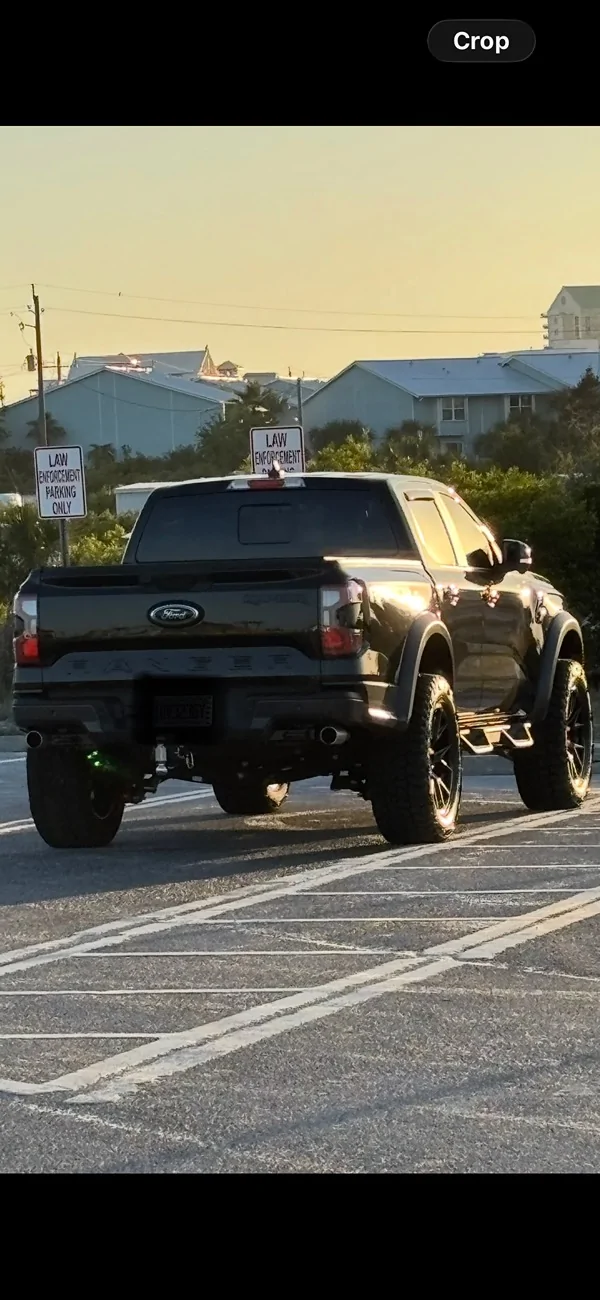

Mine did not hit with 34.6x11.6 I later added 1” to rear to get a little rake for towing…and mine are 20” but makes no difference of course
Thanks for the intel, @GiJoesGT. Your rig is looking good!

@nedmo, will 35x11.50s hit at full compression in the rear without any lift?
Currently, I'm running LT285/75R17 (i.e., 33.8"x11.2") K03s on stock rims and plan to use 1.5" spacers in the front to get closer to level (I want to maintain a little rake so when I have the topper and camping gear in the back, the nose doesn't stick up horribly high). But with that said, I'm thinking about increasing tire size to 35x11.50s when the current tires need to be replaced. Thanks in advance.
There is definitely more room in the rear, so its close but i prefer to have more clearance. But, you DO need the 2” lift spacer in the front, which then to maintain rake, you need the 1” rear. So thats why its our recommended setup for 35s.
