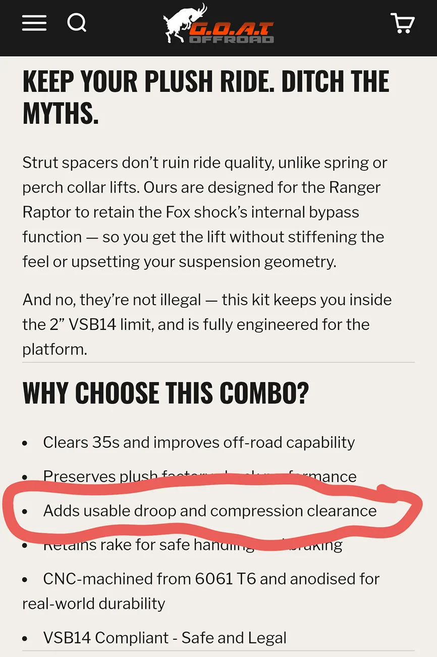

When I have the truck jacked up and them at full droop the uca is on the coils. So you would have to have this two. Beings we're both 2" spacer lift. Which makes more droop. It is even on their site. Which has me thinking I'm needing longer uca. But nobody makes them. 🙄
I didn't say anything about compression. I went puck lift because it retains the stock ride. Eibach coils and perch would make it ride like đź—‘
Not at all. I'm not sure what you've got going on. It's not even close using the strut spacers from goat offroad.
