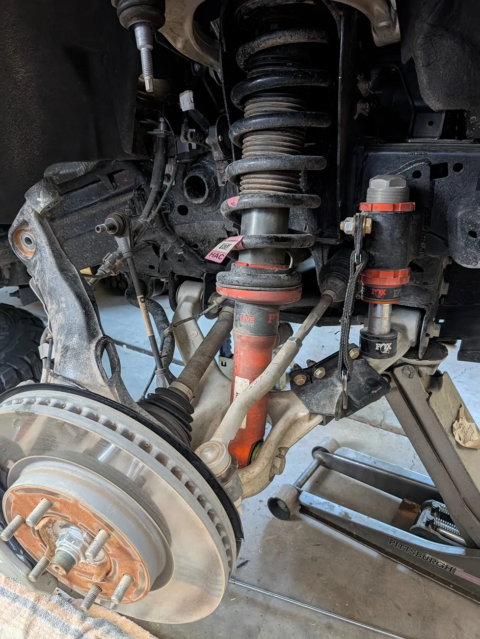

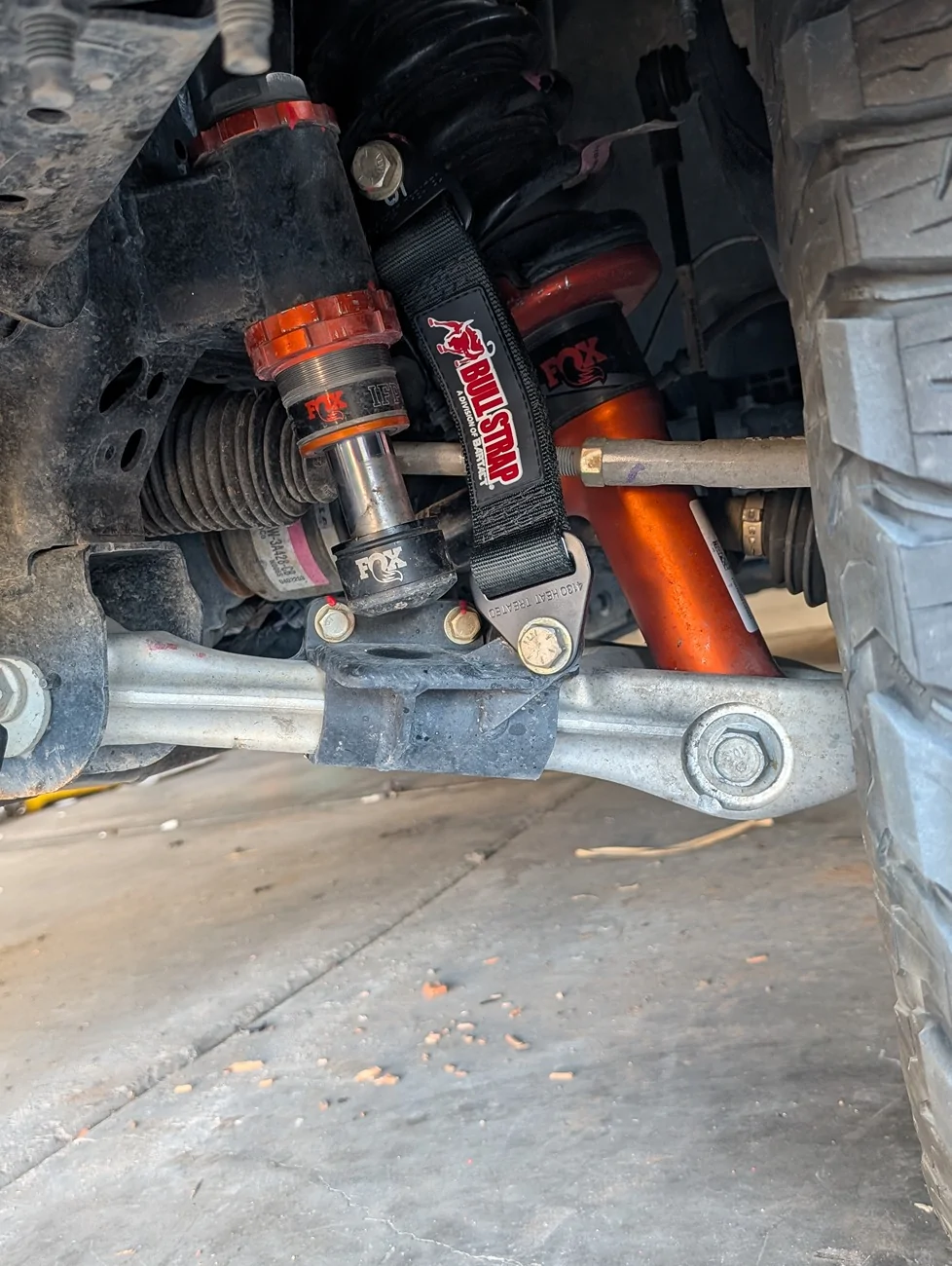

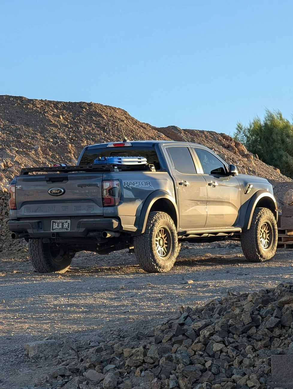

Took it off-roading this weekend. Man does that work good. I just need to add hydraulic bump stops in the back now. Front can take a better impact than the back can now. Foutz
Ford Ranger GOAT Off-Road strut spacers installed PXL_20251012_154748168
Motorsports hydraulic bump stops incoming.

When you did the leveling kit did the matrix lights need to be adjusted?

That happens when you do the Ride Height Recalbration
Yes, I followed the link to instructions how to do it on goat off-road.. if you look up nedmo you'll find it.
Instructions on how to do it on forscan I should say. It's not hard. I bought a 1-year license for $20. 35-in, tires are going on hopefully by the end of this week and I will need to adjust for the new tire. Circumference also on forscan

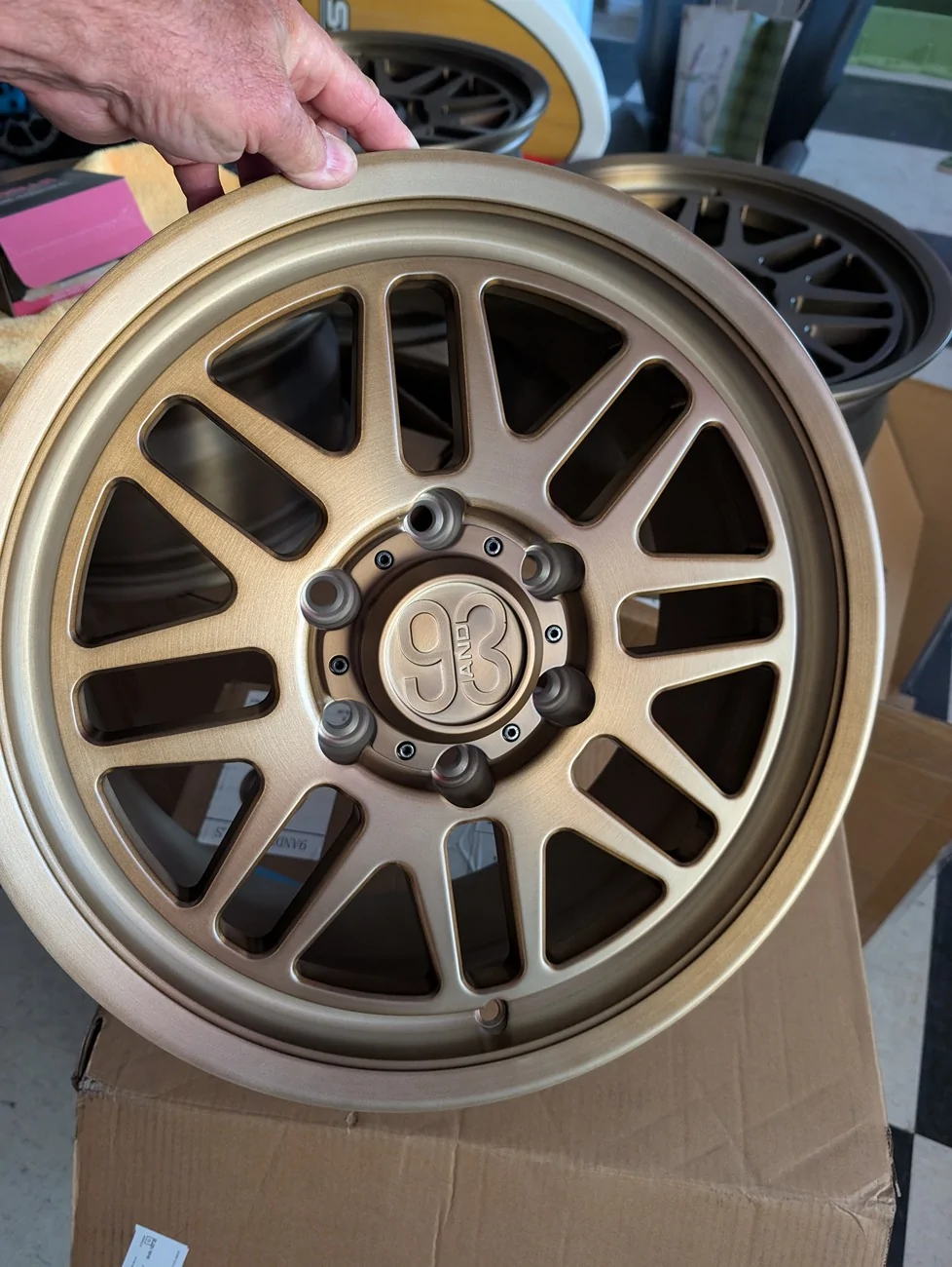

What are the specs? I’m looking for something in 17x8.5 with a +35 or +40
These are 17-in by 8 and 1/2. Plus 30 offset.
Moves the wheel out. Just about 1 in. Tires are arriving today so I will post some pictures with them on. And then this weekend I will be bombing it through the desert.

Wow, now you're socks have way more preload on them, I bet that rides rough, Are you gonna adjust the suspension sensors? reset ride height in forscan?
Yeah that's not how these work.... They ride the exact same as factory as long as you update the ride height sensors in FORSCAN.

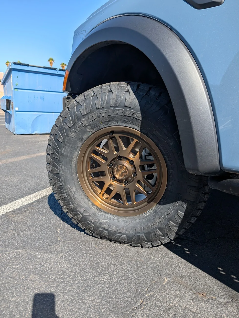

I do like those wheels.... After checking out the 9and3 website, Were they an in stock wheel at the time or did you custom order them to your specs? How long was the wait to get them in? Seems like a great option to get the offset wanted and hub centric wheels.
Daweism
Jan 21, 2025
457
425
Austin, TX
Super nice wheels, but also super expensive! Hard to find a nice gold color like that!
Havasu RR
Craig
Mar 9, 2025
255
295
Lake Havasu, AZ.
Entrepreneur
They take about 8 weeks to get. They offer quite a few styles and powder coat treatment. So they are custom ordered. It's a forged and machined wheel so they're light and strong. I am 1.6 lb heavier on 35s than I was on the stock setup on 33s.

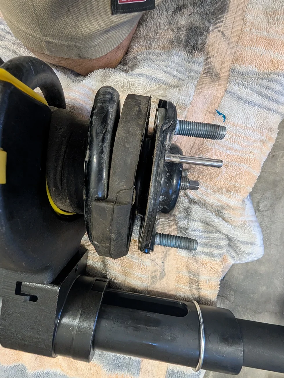

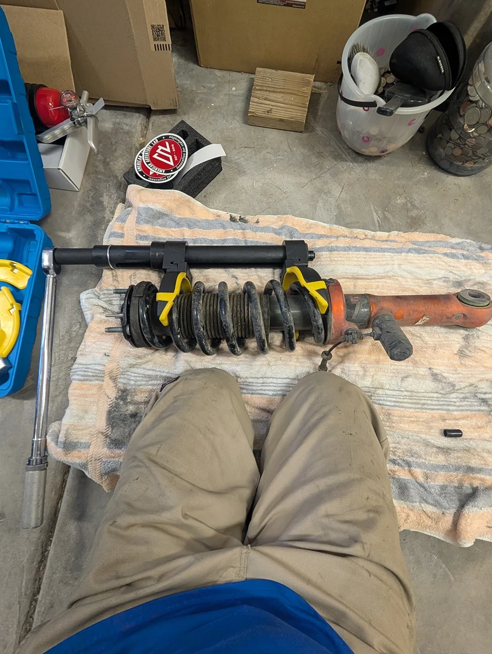

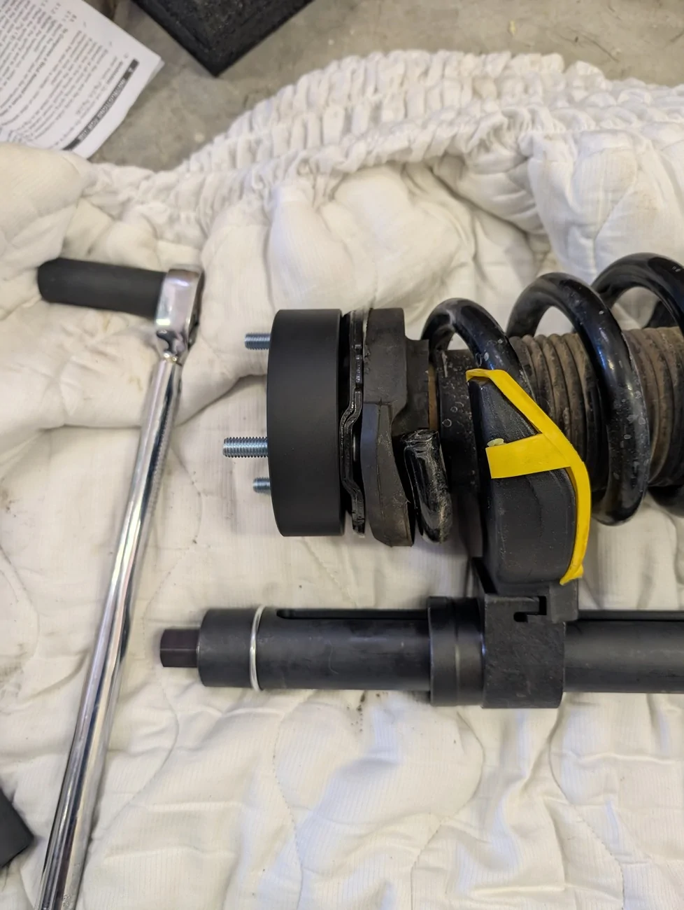

Why did you have to compress the spring: the after pic looks like the stick top plat and bushing are still there?
Yes, you only have to remove the top plate in order to press the stock studs out because they are too short. Supplied with the kit are longer bolts that go through the bottom of the top plate and thread into the strut spacer leaving room to put provided nuts on when you reinstall it in the vehicle.
