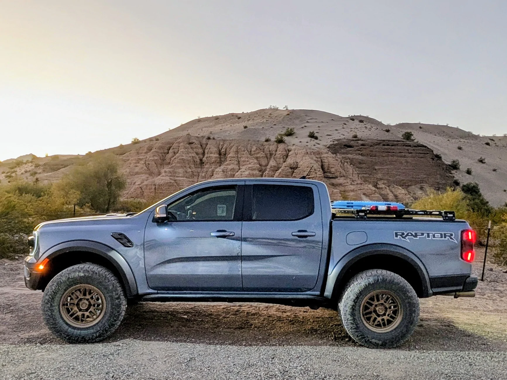

Super nice wheels, but also super expensive! Hard to find a nice gold color like that!
They are not cheap that's for sure. Combination of lightweight and strength. I just bit the bullet.
I believe they call that a triple bronze color.

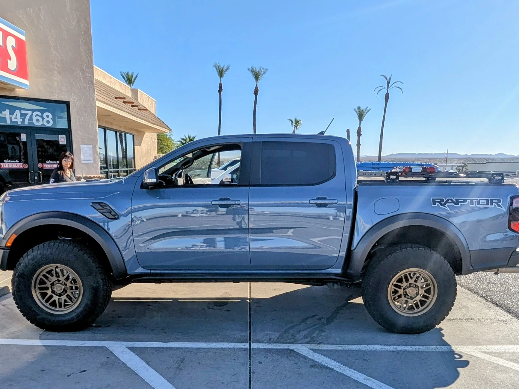

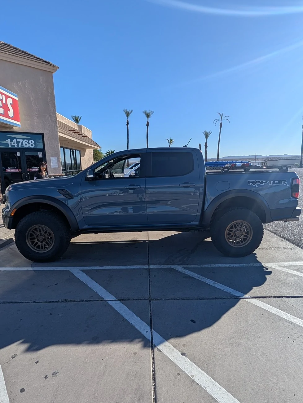

I did the 2-in front and 1-in rear. When I get home from work today I'll take some pics and post them. It's still on stock wheels and tires. I'll have new rims and tires on it by the end of the week. 35x11.5x 17
Nice. I'm looking into switching over to the same setup.
Were there any mods that you had to make to get the 35's to not rub on full steering lock?
I'm trying to get an idea of how the stance rake will look after the install, would you have a side view pic available to post? Thanks 👍

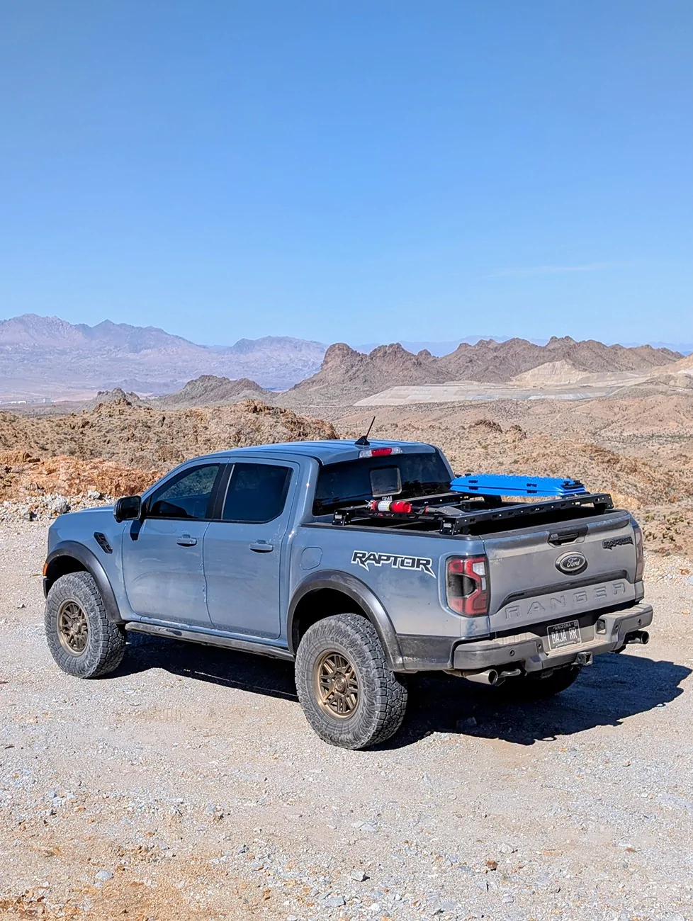

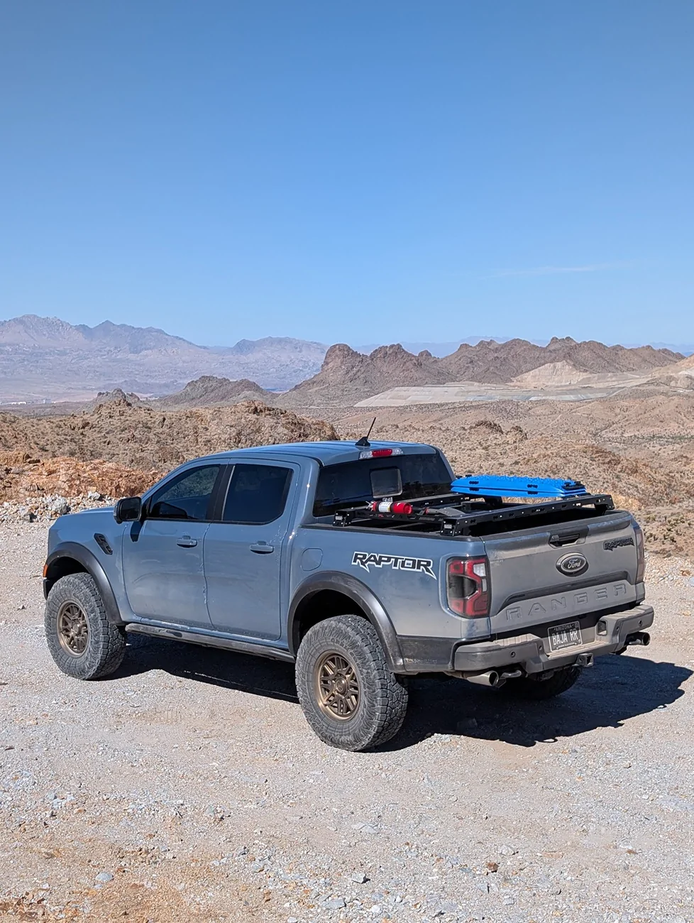

I'll take a picture and post it. By going with the 35 x11.5 I have made absolutely no modifications. Full lock either way and forward or reverse. Nothing touches. I also offrode this machine hard. I've had it at full droop meaning catching air. And I've had it fully compressed on landing and nothing touches.

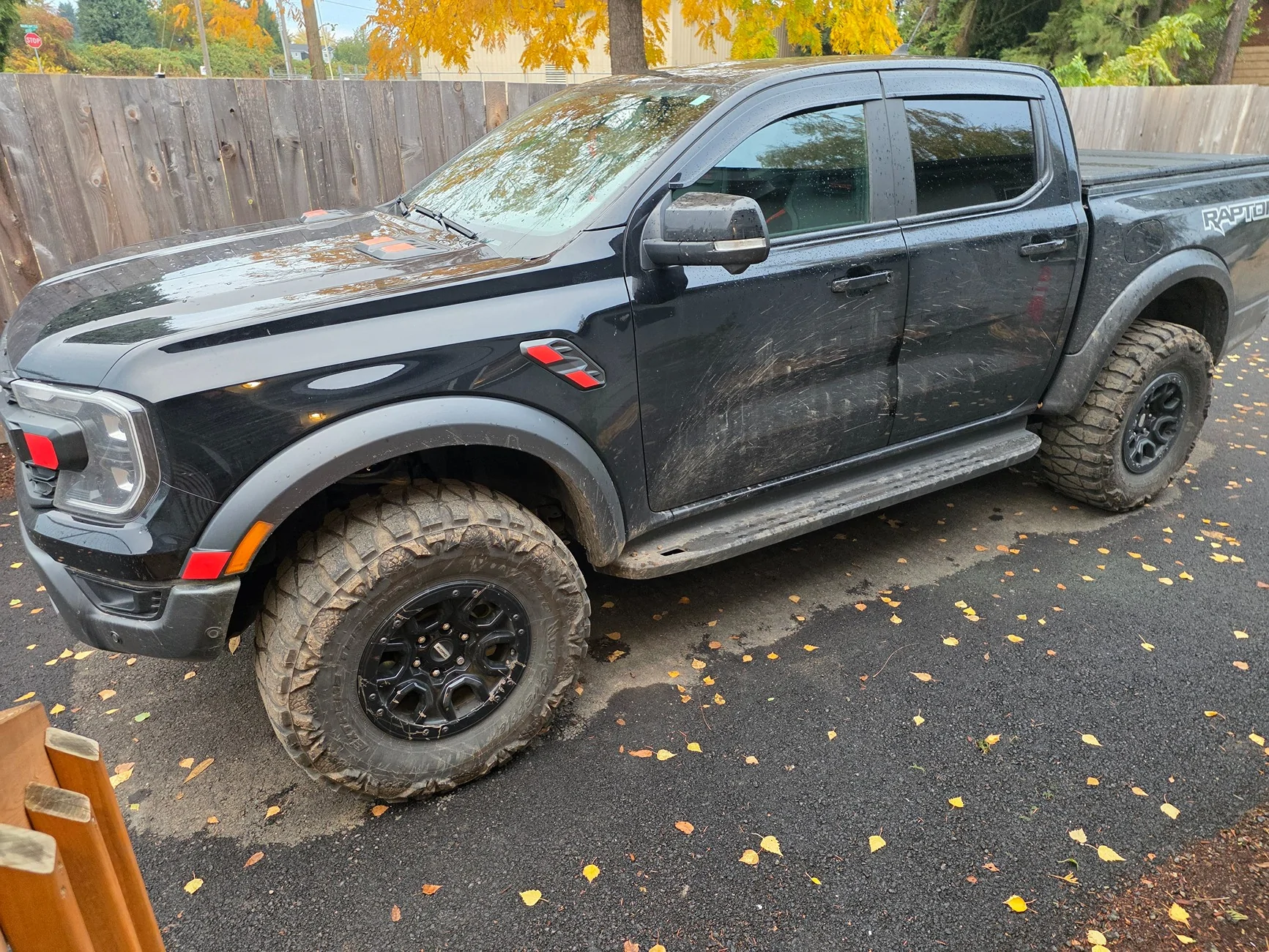

It rides exactly the same. It's not a preload on the spring. Yes, I zeroed out ride height using Forscan.
Uh yeah it is, anytime you add to the springs compressed rate, the spring rate IS CHANGED. Let me say it in a different way under full compression your spring is now compressed more than OEM. In my opinion the OEM shocks have a too stiff of a spring as it is already the last thing I would want to do is make them stiffer. That's why I chose to use the top hat spacers instead. The spring rate stays the same throughout the whole cycle it just moves the suspension down by one inch with the same amount of travel.

Brother, thats what GOAT sell, strut top spacers. Your rant is aimed at perch collars, which yeah we agree, suck.

Shit your right!!!, SORRY I missed the picture and took off on a rant....my apologies. Very nice looking Ranger Raptor you have there! the bump stops look very functional.
