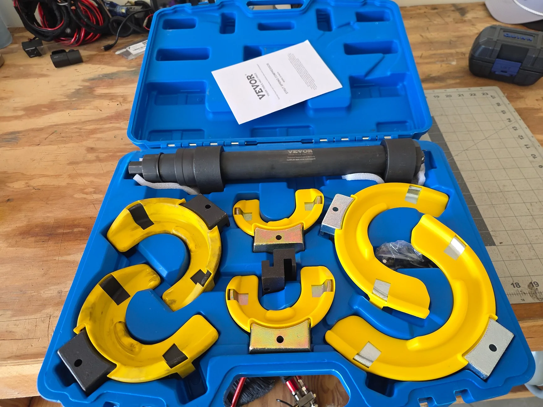

I am gonna attempt to install strut spacers this weekend on my own and I think I have all the tools mainly just worried about torque specs. I am trying to follow both the goat offroad instructions and the rough country instructions. Any advice for while I am down there?
also I have a good spring compressor dont worry.

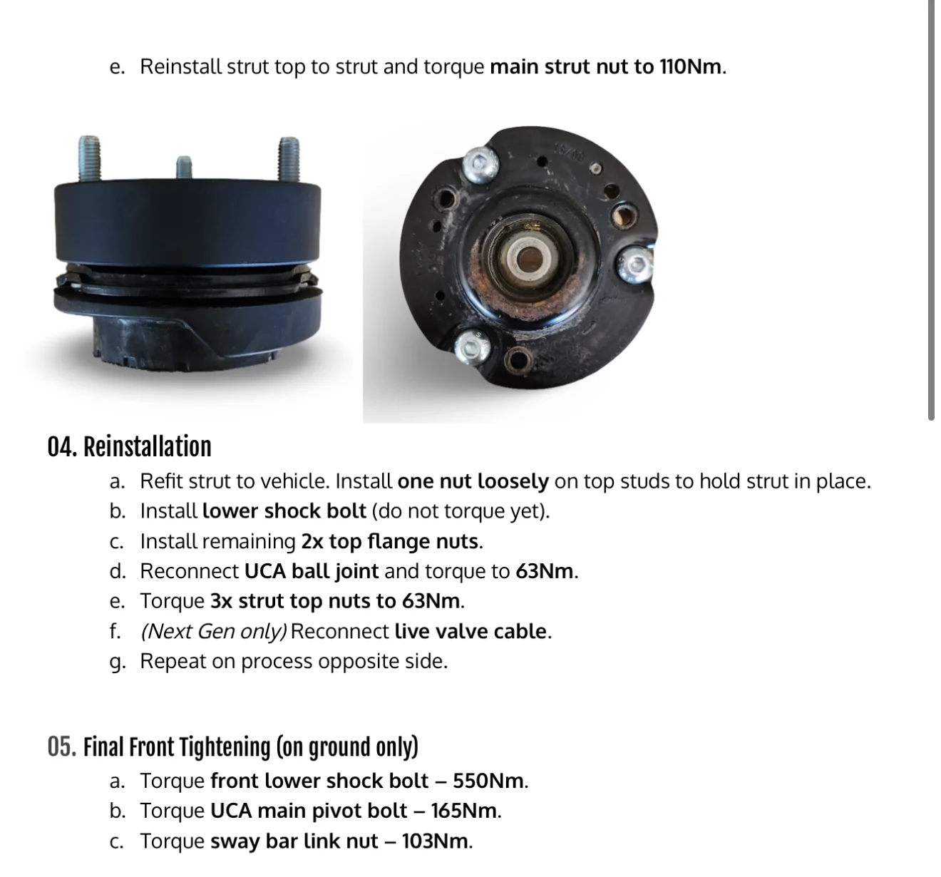

That was another difficulty I was thinking it would be tough to get a torque wrench down there but my 3/8 wrench is not that big I am mainly worried about my 3/4 for getting to 550nm. These are the torque specs I was able to find I am just hoping I got them right.

Yes, those are the right torque specs. The biggest challenge on tightening them is you are supposed to torque them down while the suspension is loaded( on the ground). To accomplish that I put the nuts on there somewhat loose and then lowered the truck and drove it up on ramps. Once on the ramps I torqued it down using a long cheater bar on a 3/4” racket and torque adapter that could go that high. It was difficult but I was able to do it. Without the ramps I don’t know how you could torque those down while the truck is on the ground. Just no room to work. I did the same thing you plan to do (using both sets of directions). It worked for me but figuring out how to torque everything down while the suspension was loaded was important. I didn’t do that at first and I had some clanking noises. I loosened and retightened everything while it was loaded and that fixed my noise issues.
Thanks for the advice hopefully my torque wrench can fit and i can figure something out but its like 42” long or something so i might just do what you did if it doesnt and find a torque adapter at harbor freight day of.

Yep, that is what I did. Harbor Freight torque adapter and their cheapest 3/4” drive ratchet. I used the handle off of a floor jack as a cheater bar for it.

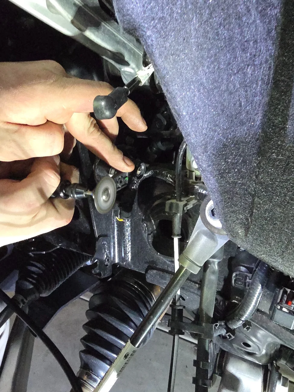

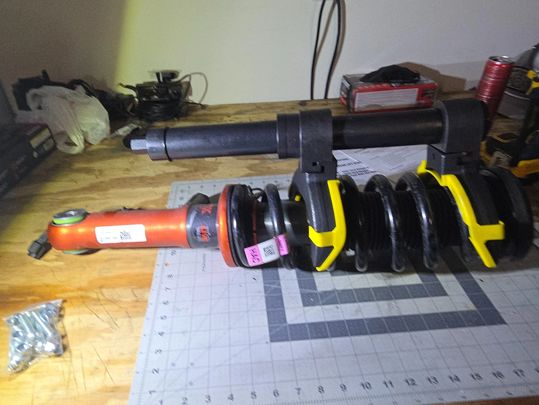

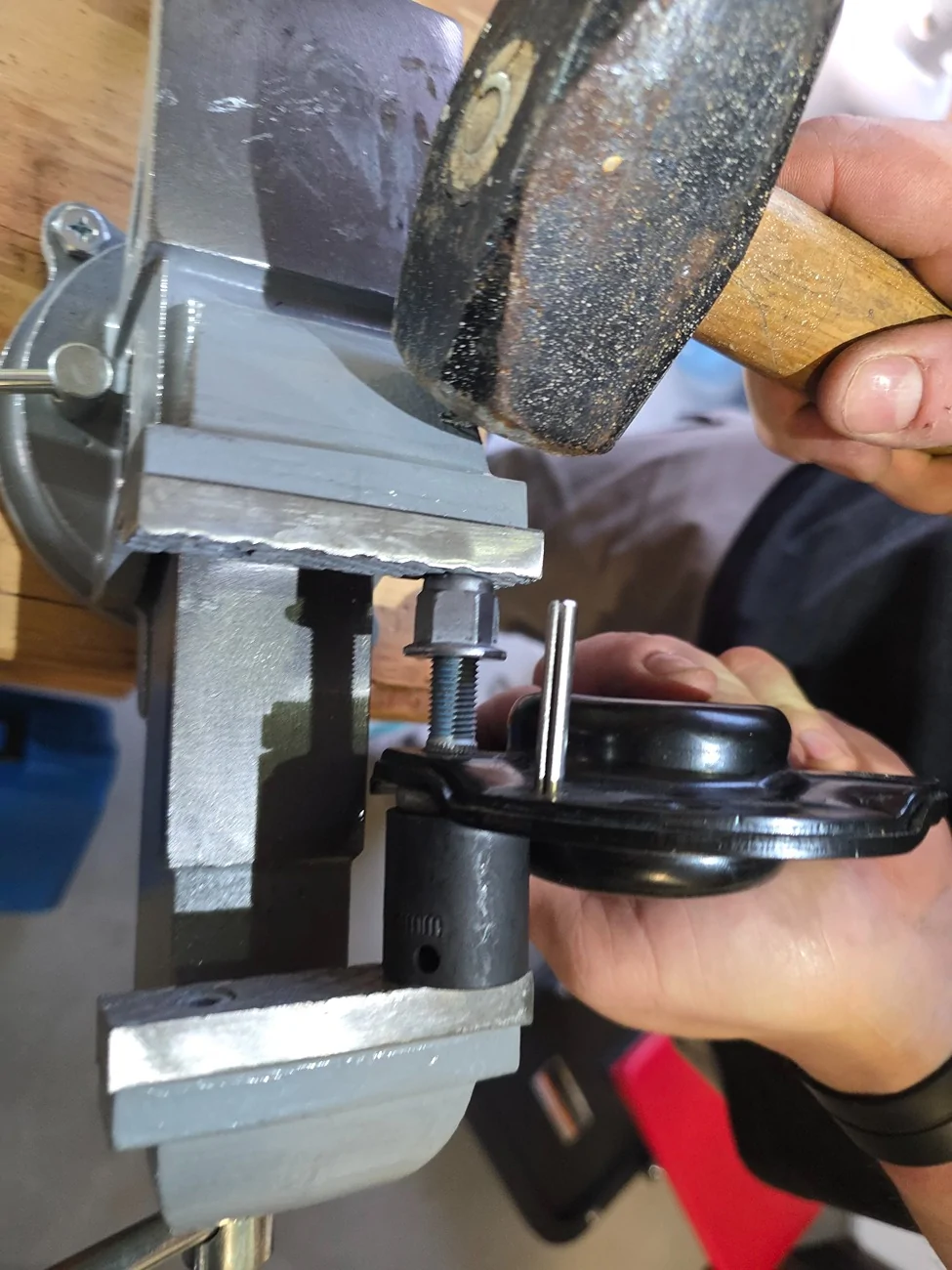

I just did mine Saturday. Fairly straight forward. Things I'd say are worth noting. The cap instructions they refer to on the rear shock top bolts is only on the driver's side and is there to protect the has tank rubber line. Used stock nut and socket big enough to go over the press bolt to press out easily using a vice. Used dremel tool to cut off the ride height sensor ball. (if you bought the upgrades) torque for lower shock bolts I hit with an impact and just asked the shop that did my alignment to make sure they are at spec and they did it for me. Got that spring compressed on Amazon. Much better than the cheap scary ones. Ride height calibration is easy following there directions.
