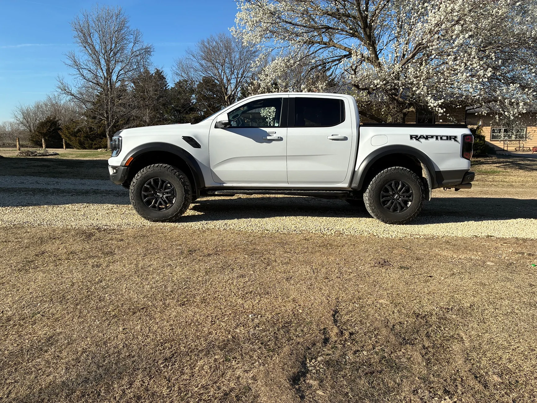

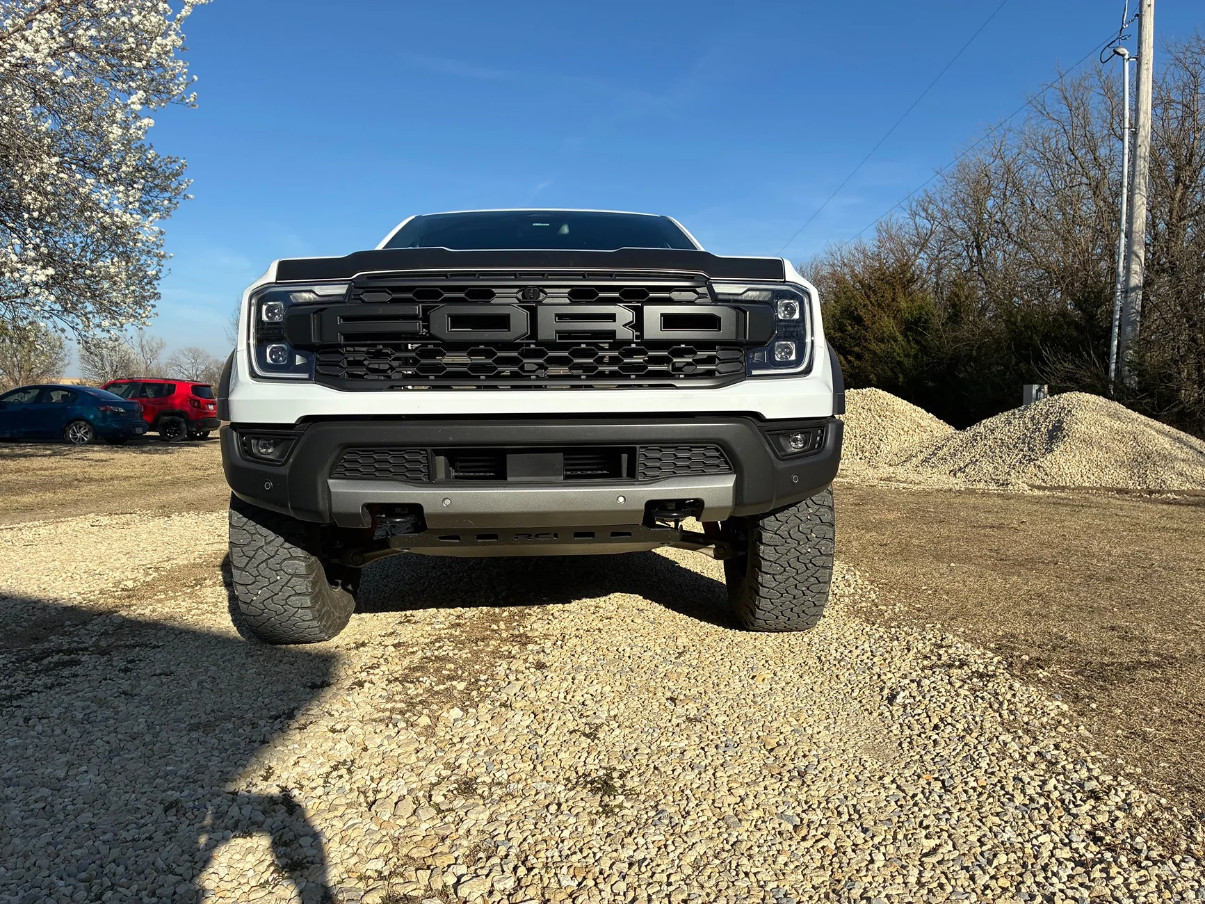

Anyone install the GOAT Offroad 2/1" strut spacer and keep OEM wheels and tires? Just curious as want to see what that looks like on a truck. Would love to see pictures if anyone has!
Here you go. I have installed the 2” front and 1 inch rear. I am going to run the stock tires until they are used up and then plan to put Toyota RT pro 11.5” wide 35s on the stock rims. This is what it looks like now though. Keep in mind previously I had a 1 inch sag in the front due to steel skid plates and rock sliders.

That actually looks pretty good even on stock tires.
Thank you! That looks really good. Think that will be my plan as well. Getting my lift installed tomorrow!
