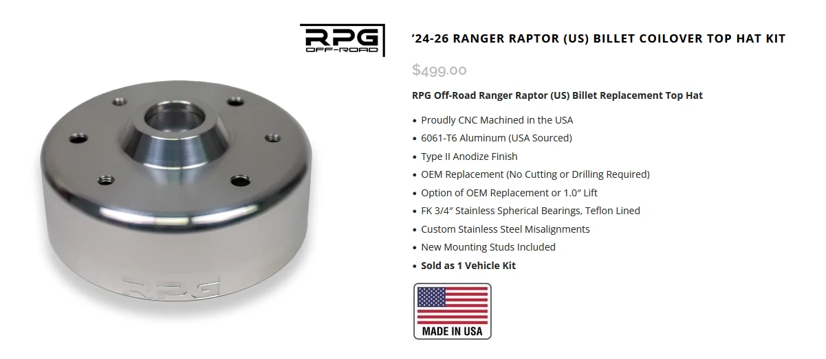

RPG has released one, OE replacement or with a 1" lift, if this is what your looking for: RPG Top Hat
Ford Ranger Trying to find a happy medium between lifting and off-roading 1771578823140-81
I wish RPG (or someone) offer at least 1.5” lift option. That would've been perfect
