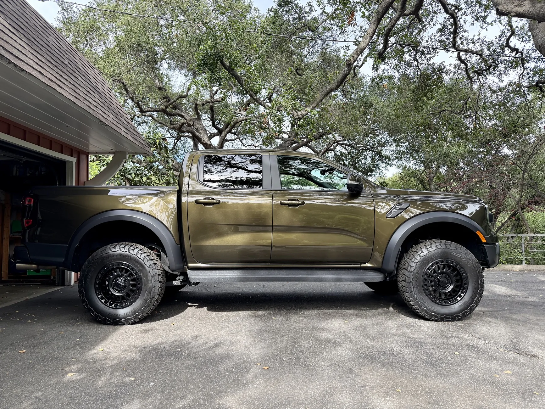

Truck looks great.. so just to verify only installed 1.5 in the front ?
Sure! Pic is a little cramped but more flat. Again I wanted to leave a little rake (dont like nose-up, will be adding MOLLE panels, stability, etc.). Happy with it! Rock Krawler kit is perch collar style like GOAT.
Thanks man! Yes 1.5" only in front, but I just noticed I totally typoed my post before, Rock Krawler are strut spacers like the GOATs, I think I wasn't paying attention when I wrote that.

Ok thanks.. again love the look of your truck.. time to do mine.

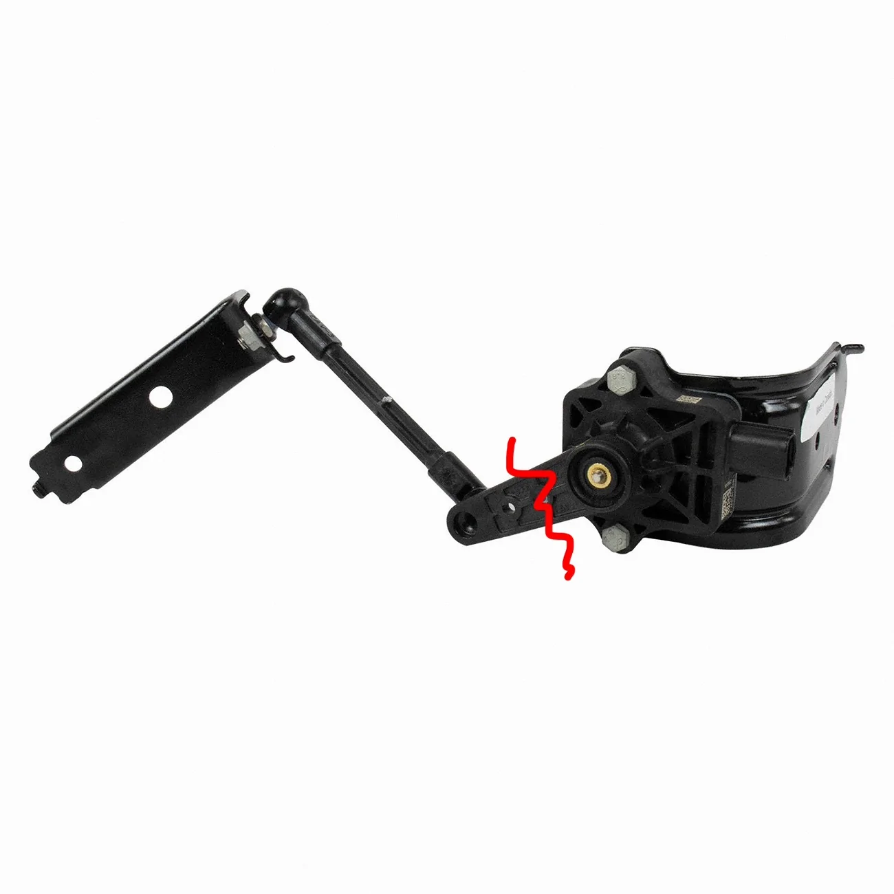

Do the ride height sensors need to be calibrated if you replace the entire sensor? My front right is broken at the arm on the sensor itself, not the linkage. Debating how much hassle the warranty would give, the truck is stock and has seem relatively minor offroad use. Sensor itself should be easy enough to replace. If its just a part swap I'll just DIY, but if it needs some calibration I'll probably just let the dealer handle it.
Which part broke?
