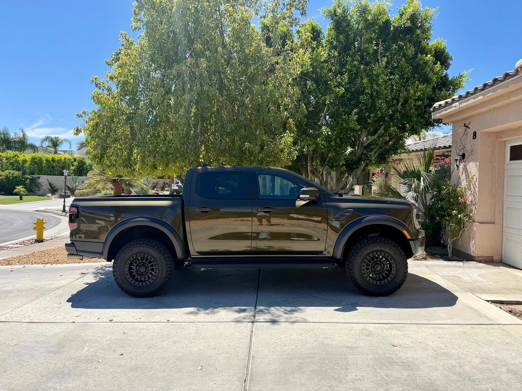

Looks great! Any chance you a pic on level ground (looks like the driveway is slightly sloped up). Thanks!
Sure! Pic is a little cramped but more flat. Again I wanted to leave a little rake (dont like nose-up, will be adding MOLLE panels, stability, etc.). Happy with it! Rock Krawler kit is strut spacer style like GOAT.

Sure! Pic is a little cramped but more flat. Again I wanted to leave a little rake (dont like nose-up, will be adding MOLLE panels, stability, etc.). Happy with it! Rock Krawler kit is perch collar style like GOAT.
Thanks a ton!!! Again, looks great!
