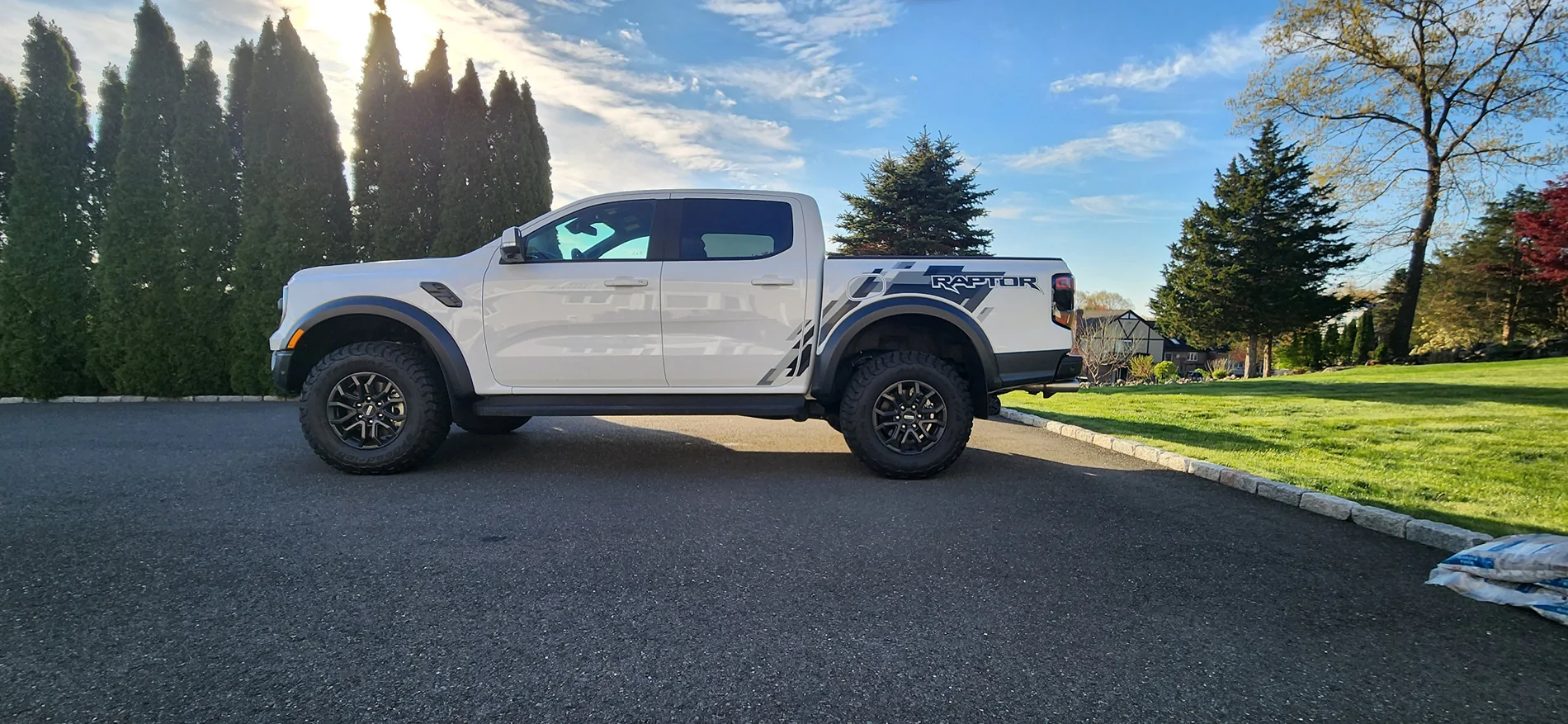

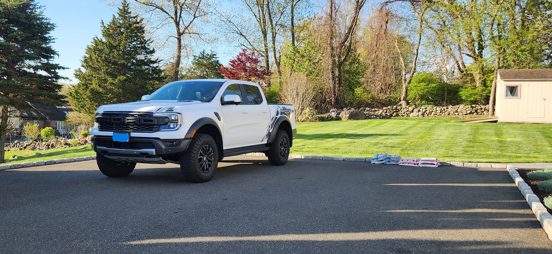

Just added about 70 lbs in skid plates and curious after reading this thread about where to measure ride height. From the middle of the hub to the fender; top of the hub to the fender?

You can measure it however you want but, probably the most accurate is to measure from the middle of the fender down to the middle bottom of the rim and the subtract half of what the measured rim diameter is. Some just measure from the middle of the hub up to the fender which is fine to. Still other measure from the ground to the fender, but that isn’t that accurate because of the varying degrees of tire pressure and temperature that can affect things.
