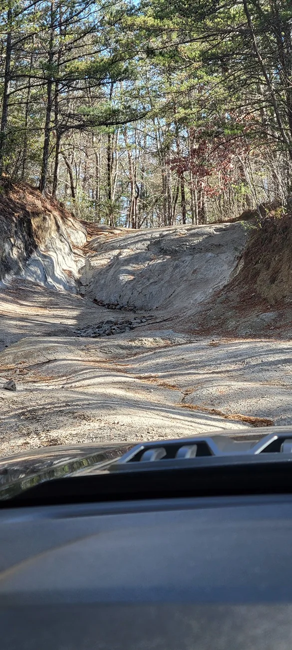

Month and half in and I took the truck to what I'd rate a moderate trail. Looking for feedback, what PSI do you lower tires to for a trail with plenty of rocks? 2nd thing I am curious about... everything was going great until I hit a rock face I didn't have clearance for... so with the Ranger Raptor, what options are there to get the extra clearance? With those options, how do I retain the ride and stock feeling of the truck as it is? Overall, the truck did great and I wish I could of took it longer on the trail.

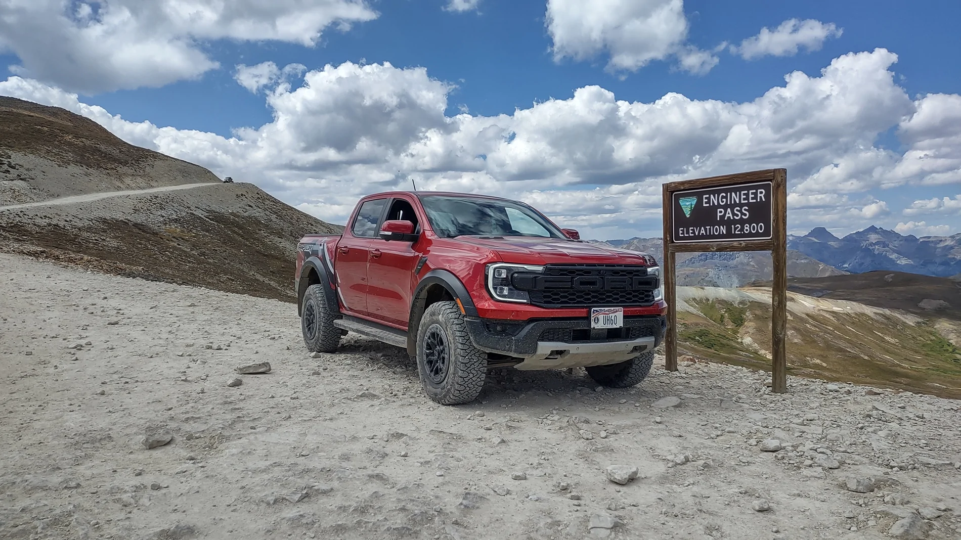

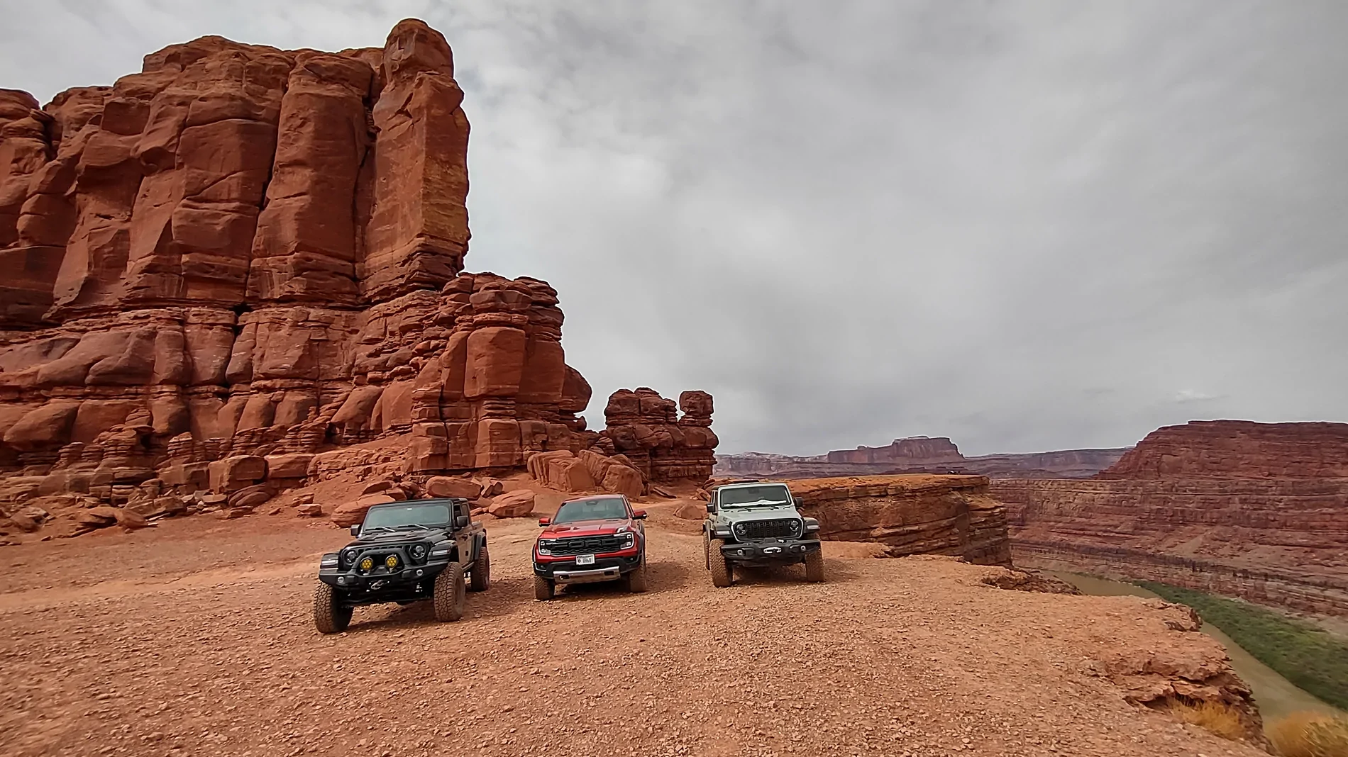

This past September I was out in Colorado and Utah (in my former JLUWX) with an ol' Army buddy who brought his RR. He did not air down initially, and it did not take long and he was at roughly 25psi for the rocks.
Stock RR. The front skid, side steps, three wheel rings, one wheel, and one exhaust tip took rock hits. It's happens.

IMO it’s not worth modifying the RR just for the occasional offroad trail. Rock hits are going to happen, try to avoid larger rocks when possible. Otherwise bumps and scraps are expected when off-roading and is why you have underbody protection.

Thats what my buddy said... give a few months or a year.. you'll try it again.. I really dont think I could of came back down the rock face... I was betting I was gonna trash the front end on the way back

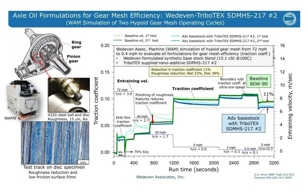

These two really capture the capabilities (the Wedeven test is very difficult test to pass for lubricating oils due to the extremely high torque loads, it was developed by MIT for the Auto industry and is the go to test for heavy duty lubricating oil performance testing):

Here's another one to "wet your whistle":
Ford Ranger Took the Raptor to the Trails - First Time. Tire PSI and clearance? 1767020166649-bf
The link above has the bulk of the information, you can decide if you think it's beneficial. It's not going to magically transform your powertrain, but it will enhance its operation (even newer vehicles), if you decide to use it, you're using it with long term in mind which is where its greatest benefit comes from.
