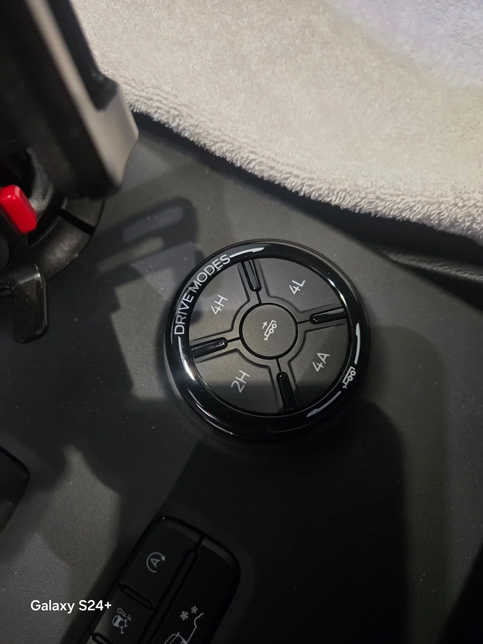

Is the "tow haul mode" in the center of the round transmission dial?
Any other thoughts?
I'm not familiar with tongue weight. Is that something I tell the Uhaul people when they hook up trailer?
Thank you!

Tow/Haul is accessed via the drive mode wheel (twist the outer ring counter clockwise a couple of modes from "Normal").
https://www.futurefordofsacramento....n-drive-modes-of-the-2025-ford-ranger-raptor/
The button in the center of the drive mode wheel is trailer backup assist, which probably isn't helpful unless you go to the trouble of outfitting the Uhaul with the stickers.
https://www.fordservicecontent.com/Ford_Content/Catalog/owner_information/24MY_Ranger_QSG_ENG_V1.pdf

The trailer icon isn't to select tow/haul mode. You use that dial, but you have to "spin" the outer dial to find your mode among eco, sport, etc.
The center trailer icon is a button to enact the advanced towing/backing features.
