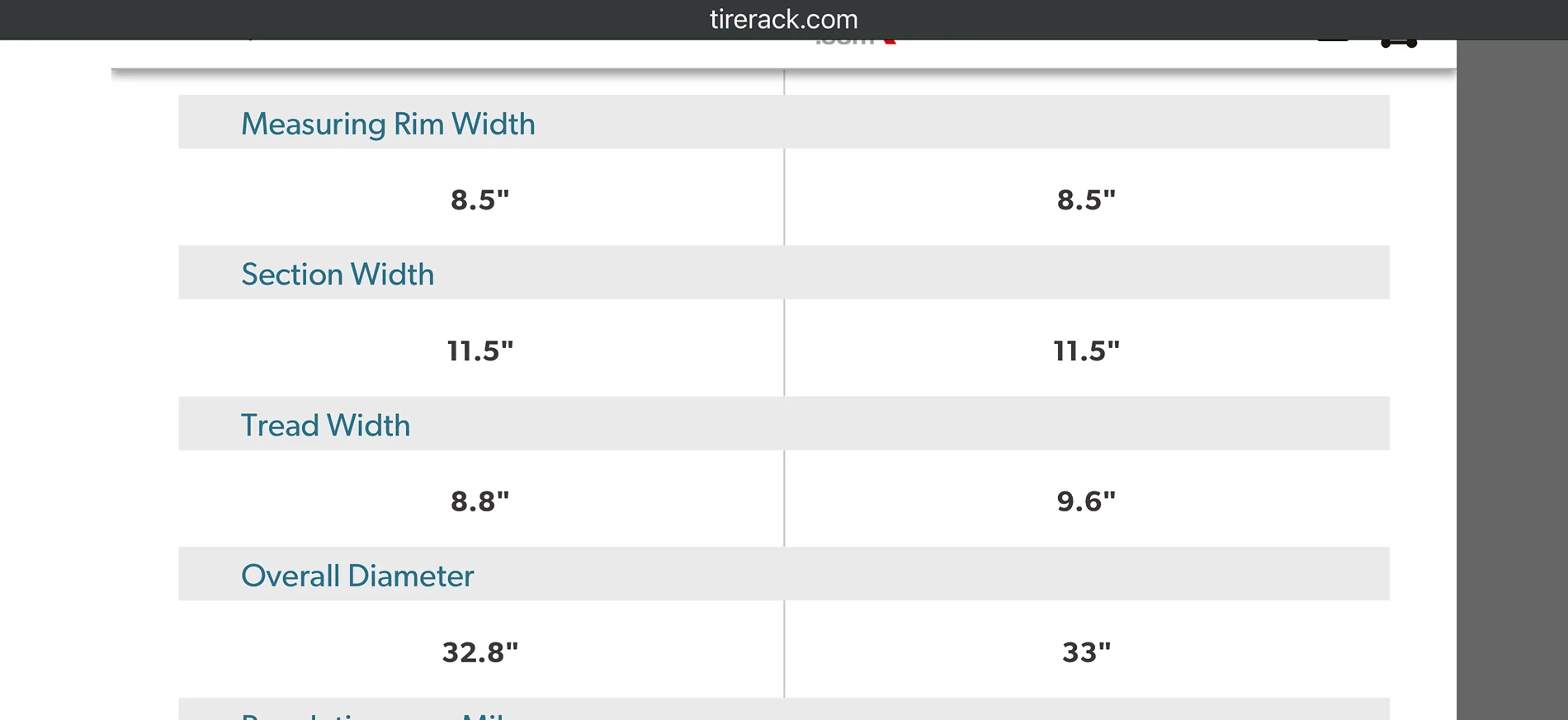

if you go with a taller tire or wider than OE 285/70 17 with the ford performance tune it will void the warranty from Ford Performance, so I think alot of guys stick to OE sizes until that runs out, assuming because a taller and wider tires means it wont slip and puts alot more stress on the driveline, sh1t rolls up hill so if the tires dont slip then something upstream is next in line.
going from the OE BFG OE the Falken in the same size, the tire ends up 1" wider at the tread and around .5" taller (True 33") in the same 285/70 17
I think thats part of the reason the OE spec tires are awful in the wet, they are alot narrower on the tread to help with fuel economy

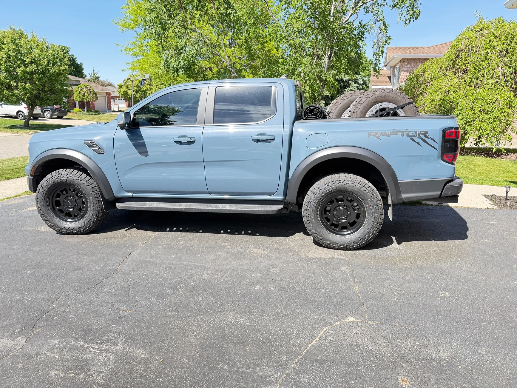

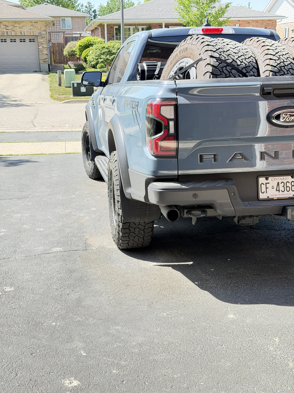

the method -35 offset push them out 20mm or close to an inch which gives a pretty flush look.
any more and i think youll be slinging snow and stones.
so in my case the method wheels push the wheels out 20mm, and the tire is around 1" wider at the tread, so overall the outer edge moves out about 25mm (1") and makes the wheel well look much fuller, while the tire itsel is only .5" taller (because the OE BFG 285/70 17 runs so small)
